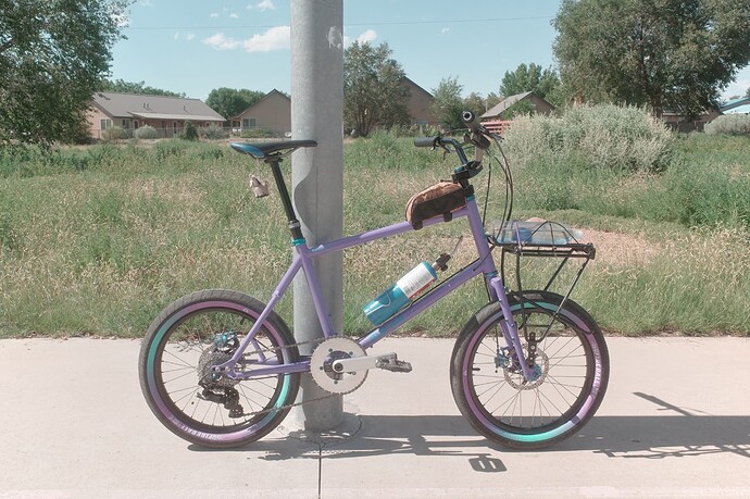

marino of marino bikes (https://www.marinobike.com/product/custom-chromoly-crmo-4130-bike-fork/) will make you a fork starting at $80 plus tax/shipping. i know he’ll do long steer tube 20" forks too cos he built my 20" wheel minivelo frameset.
Wow thanks. Will check him out!
another option is to get a normal 20in fork and extend the steerer.
I have extended steerers before and it’s not hard at all. That would be what I do next if I ever build another minivelo.
