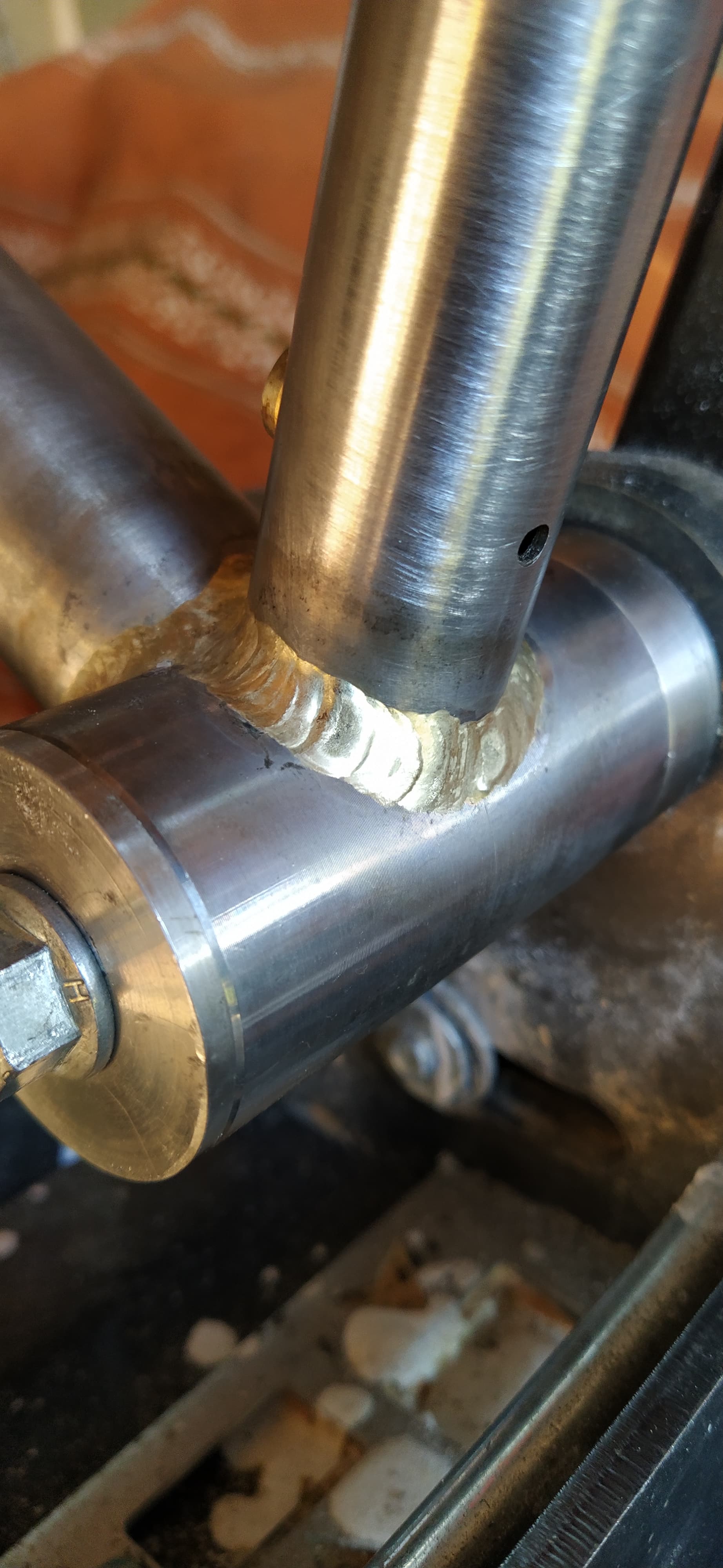

Look, I’m not stopping anyone from making bikes with raw fillets. Have at it. However, there are a lot of beginners on here whose fillet brazing trends to the very lumpy. It’s my opinion that if those lumpy edges aren’t filed smoothly there’s an increased risk of tube failure.

All good. I just felt finishing fillets smooth was more a traditional process for aesthetics more than anything. Myself, I always strive to get as even and consistent a fillet when I’m doing brass fillet brazing so I don’t have to spend forever sanding my fillets smooth afterwards.
I can sometimes cause an unfinished brazed joint to fail in a way that bronze shears off of the tube leaving bare steel with almost no bronze remaining on it. I’ve attributed this to less elongation than steel, but maybe ductility is the wrong word, plasticity? I might just misunderstand what’s happening.
It’s usually very thick to thin scrap pieces, like a tube belly to a steerer.

that’s what I aim for when filet brazing
Generally I reckon filed fillets look better but I wouldn’t touch those either. Nice work ay!
