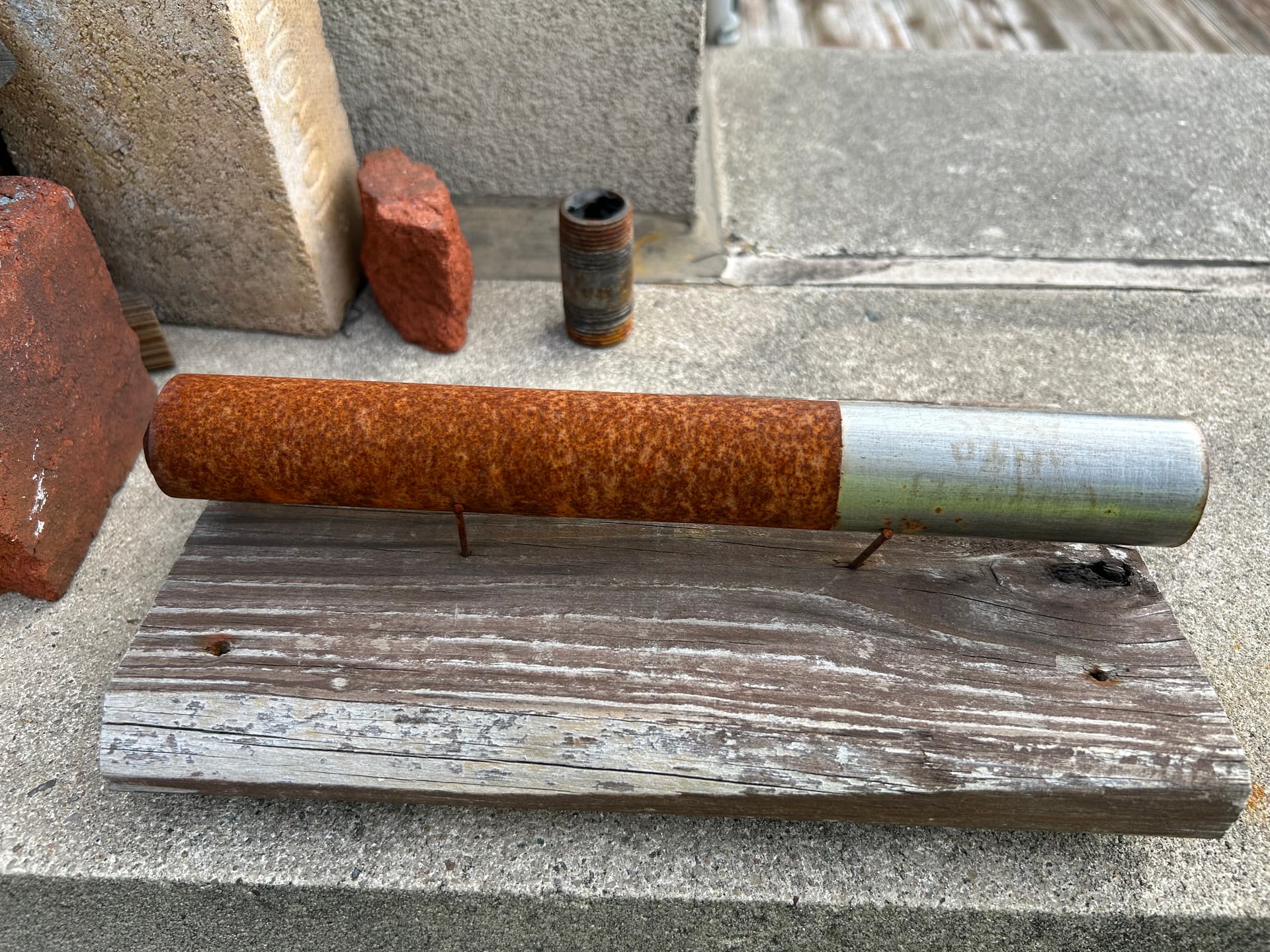

I wanted to try WD-40 to see what the residue would do in terms of rust prevention. Turns out, not much. Clear Rustoleum is working great, though. This is ~2 months outdoors, on a piece of 4130. Left to right, regular WD-40, nothing, clear Rusto.

Here we are at 4 months with the WD-40, nothing, and clear Rustoleum, living outdoors on my roof through the winter:
1 year mark on the clear rustoleum test piece.
There are some small rust spots where the piece sat on its holder. The downside of rattle can paint is durability, but clearly (hah) it prevents rust well.
