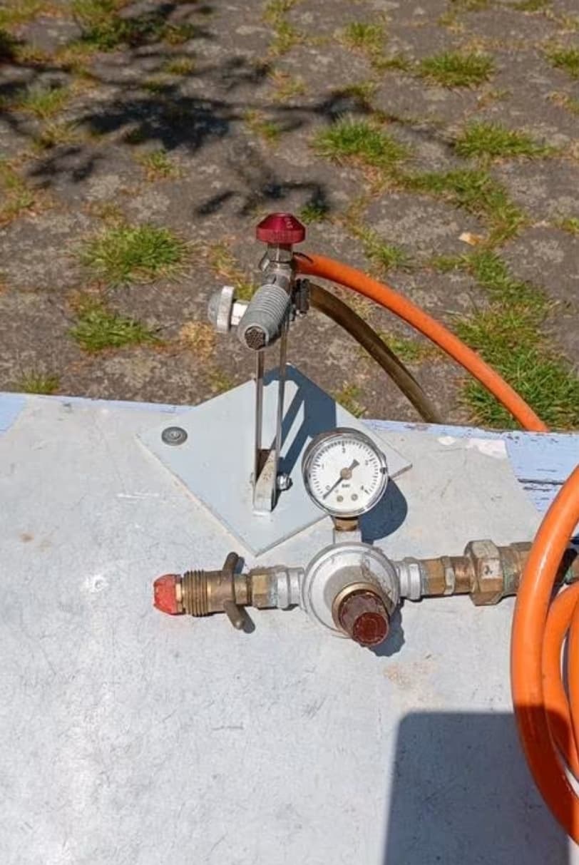

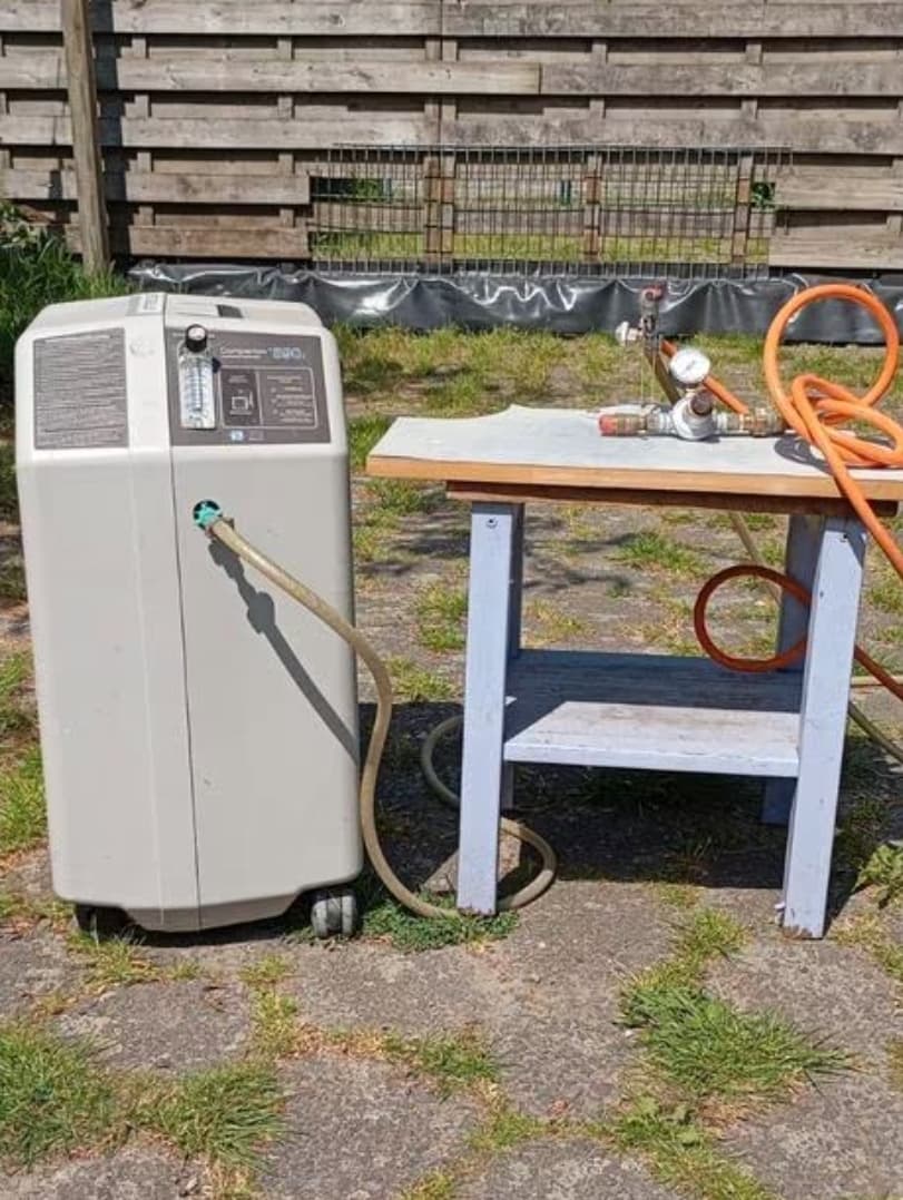

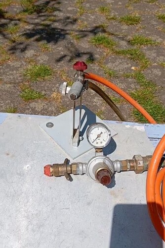

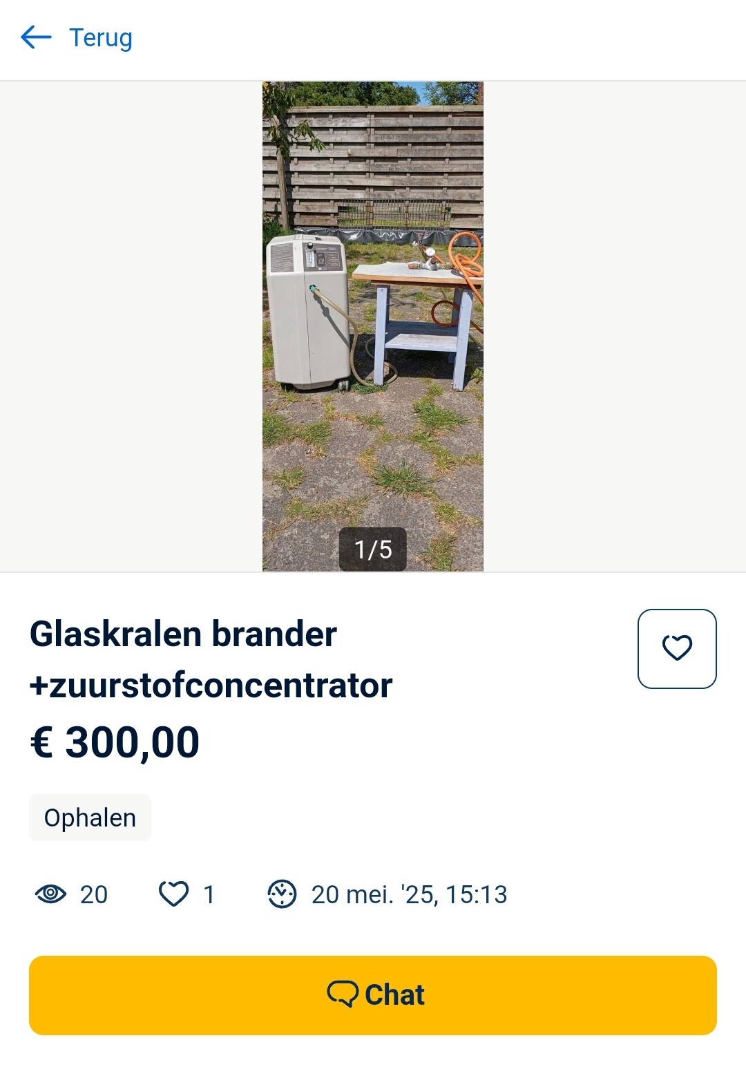

Omg I found an oxygen concentrator complete with hoses and a gas connection (and stationary torch for glass blowing) within cargo bike distance!
Can anyone tell me if I can buy this and just replace the stationary torch with a handheld torch?
The price is crazy low though but maybe there’s just not much of a market for oxygen concentrators that aren’t fit for medical use and the rest of this stuff.
If it seems good to anyone with more knowledge about this I’ll send the guy an offer asap.
300 Euros seems super steep to me but other than that, all seems good.

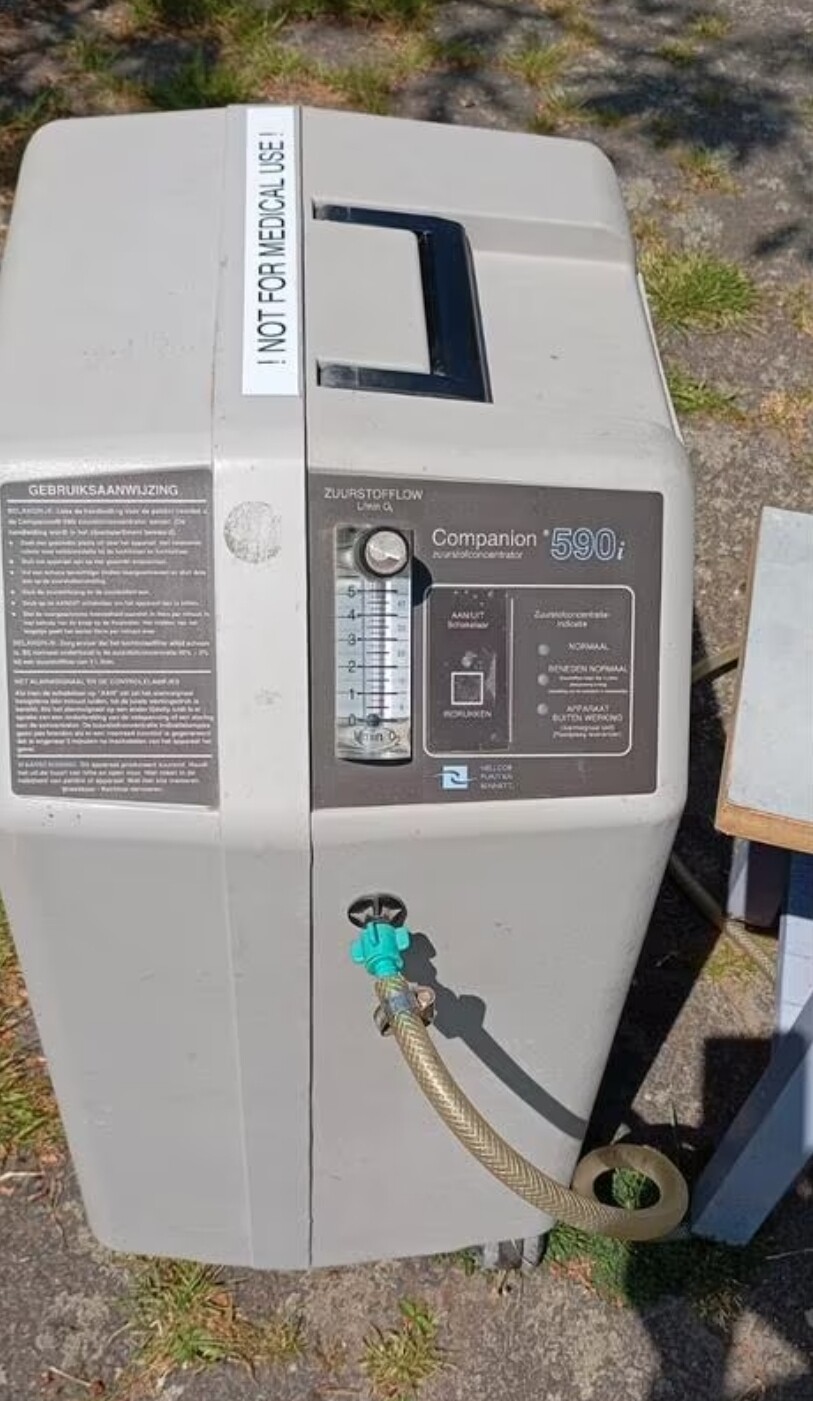

This particular model seems to go up to 5lpm judging by the scale on the front, that is plenty, I never go over 3lpm on mine and lately I stay just over 2.
The connection is also standard, you will either have to use an adapter for your hose like this person is doing here or if you are lucky it will just screw in once you remove that green adapter, mine came with the adapter like in the picture but once removed the connection was the same as my hoses.
You most likely won’t need any tools like those, just the oxy concentrator.
If you try it, make sure oxygen comes out, there should be leds and audible notification of any issues.
Mine takes 30-45 seconds once started to go to an “all green” status but only if the oxy flow is open, if there is no flow it will start beeping, remember, this was designed for human use, if there is no flow it’s a problem so, not all “alarms” are bad for us, some simply means that the flow is not open.
On mine I just disconnected the wire to the buzzer, problem solved!
But yeah I leave the O2 knob on the torch open at least a little all the time, to avoid that period of time after you turn it on when it’s not making high-purity O2 at first. Shutting the valve briefly probably doesn’t harm it but who knows, they’re not meant to be shut off like that ever, so maybe safer to just leave the valve always open.
Not claiming to be an expert about this, everything I know I learned from Doug Fattic.
Well unfortunately this is the first time I’ve ever seen an oxygen concentrator for less than €350 here in Belgium so €300 and an included propane regulator is probably the best I’ll find here. And it being super close by is a bonus.
Yes I looked up the model and it does go up to 5 lpm which is what I’ve seen people recommend.
Okay nice hopefully this will be the same then.
I’ll send the guy an offer but ask to test it first.

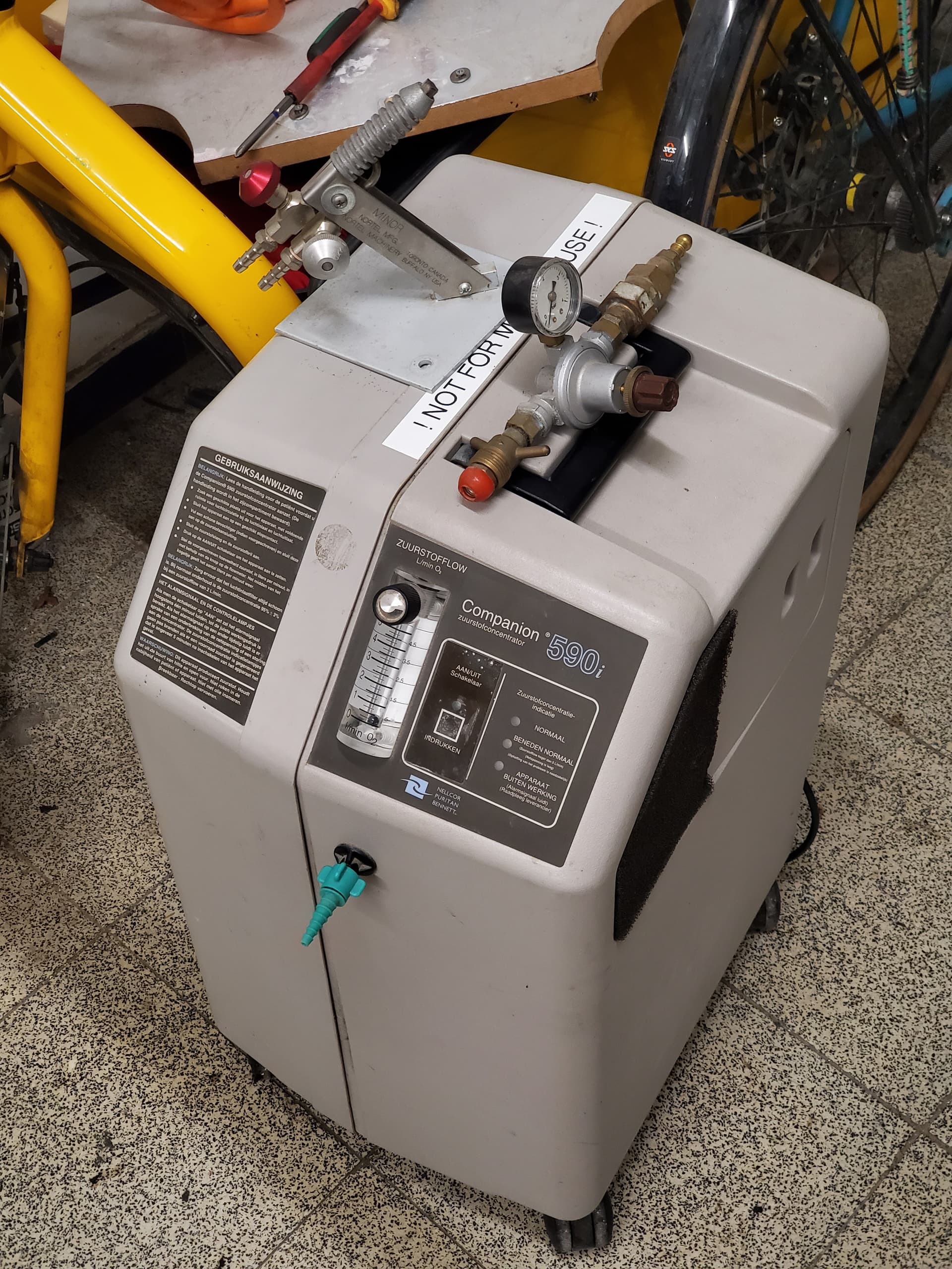

Okay so I just picked it up, for €300 I got a companion 590i oxygen concentrator, a propane regulator and a Nortel minor benchtop glass working torch. (And hoses but the guy said this setup had been sitting for 10 years at least so I’ll be replacing those)
Should I flip the benchtop torch or can it be useful for framebuilding work?
The companion 590 needs to have a couple of brittle hoses replaced but other than that she purrs beautifully.

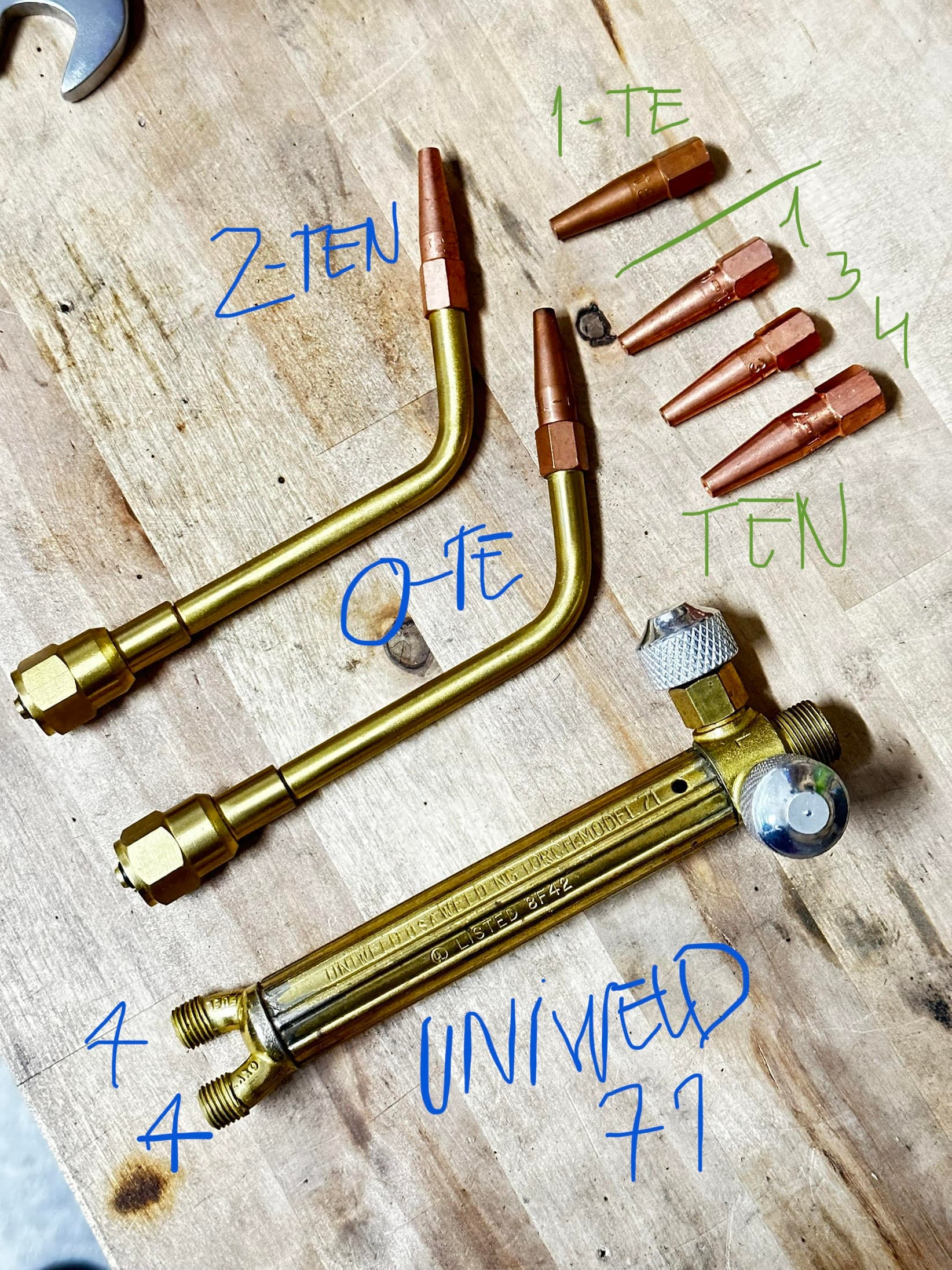

What Torch did Doug recommend? When I took a class with him more than 10 years ago, he recommended the Uniweld 71 handle with a couple of different tips. This is what I got back then. I used it when I started with acetylene, but then I switched to propane + oxy concentrator.

That’s the exact torch that Doug recommends in the velocipede forums for brazing with propane and oxygen. Just out if interest, where did you take that class with Doug?

This is the Forum post I’m referencing. Doug compiled a list of everything that one needs to braze with oxy/propane. He specifically mentions the Victor TEN tips for propane and the Uniweld 71 torch. So you should be ready to go!
And since the Victor mixer should be of the equal pressure type, you don’t even need higher pressure out of the conecntrator.

I was about to tell you to get some Paige Tools tips but it seems they are gone.
