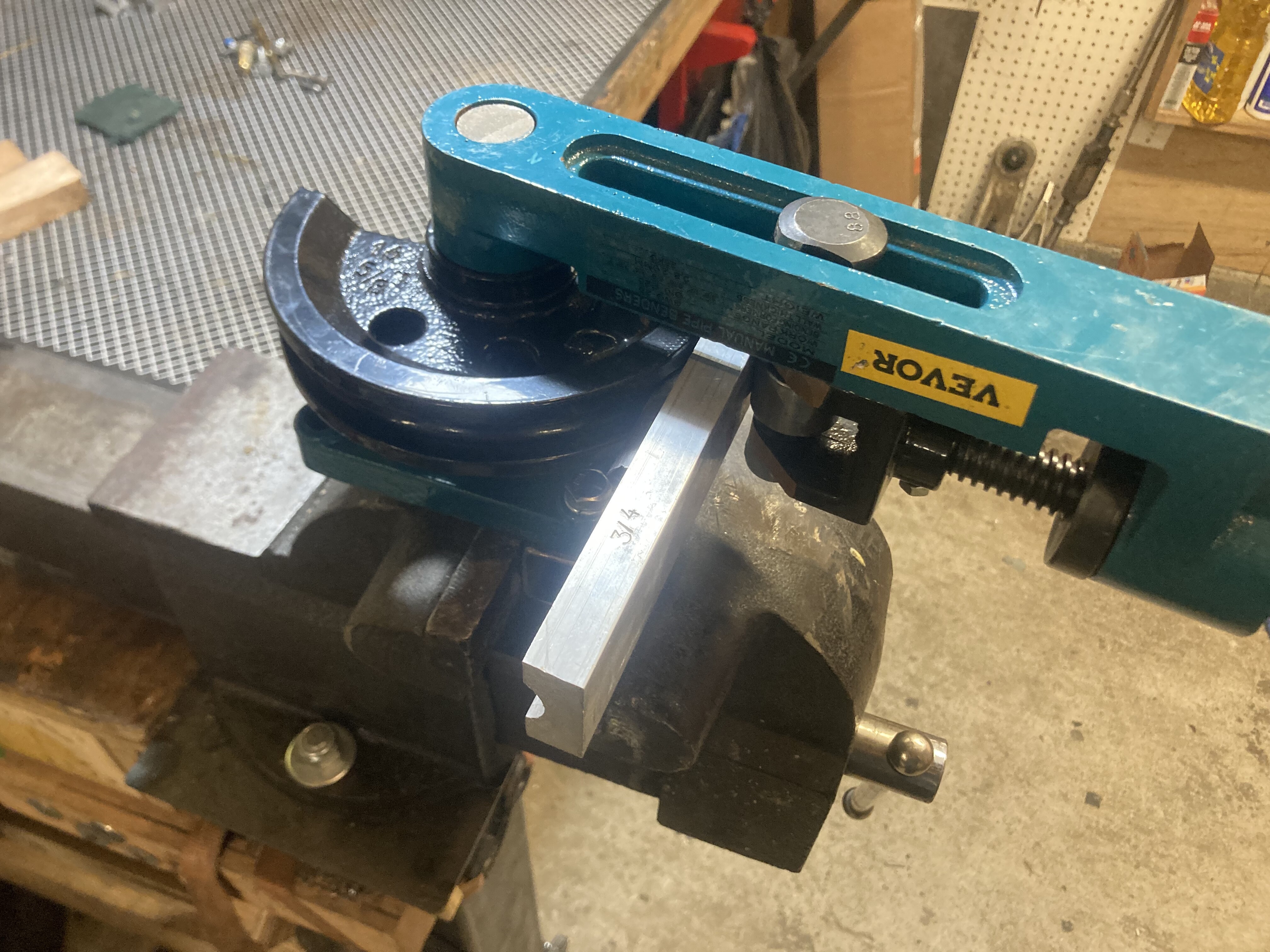

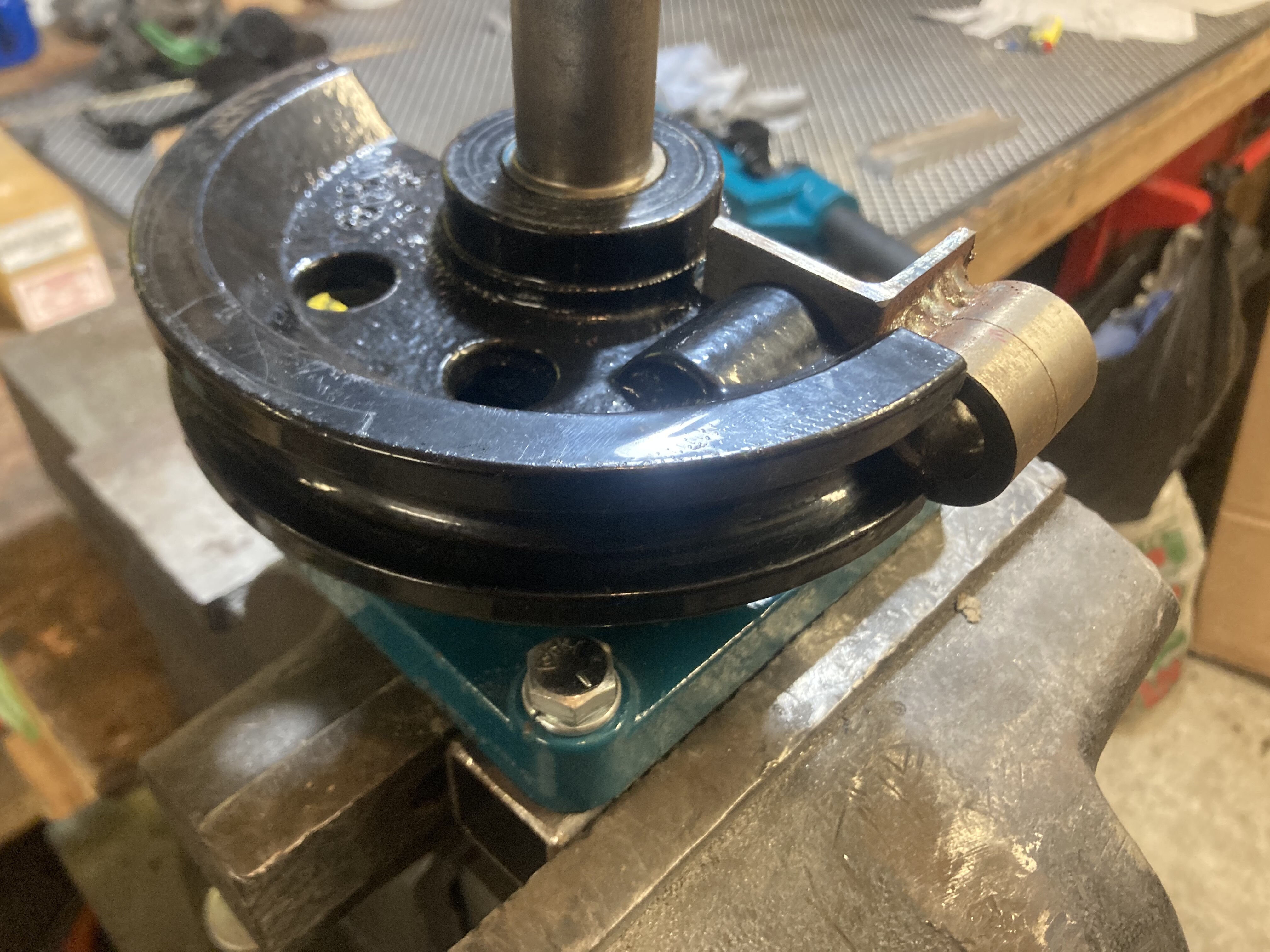

Some hot rod tips for the Chinese bender:

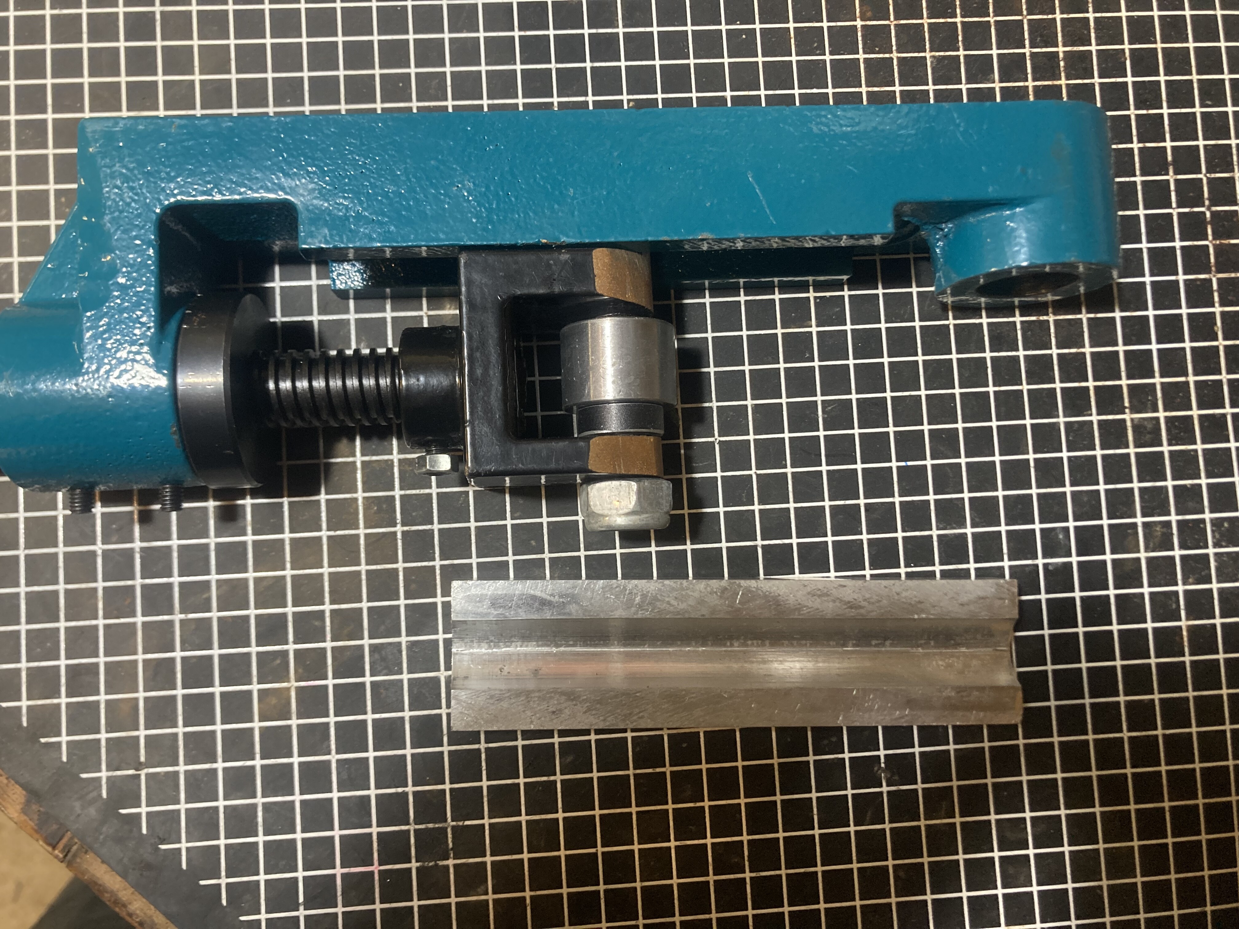

I replaced the stamped tube retainer with a larger sleeve to spread the pressure on the tube to prevent dents
The other thing I did was replace the wheel shaped die with an aluminum follower die. This improved bend quality significantly. I have been bending 7/8, 3/4 and 5/8 without ripples
