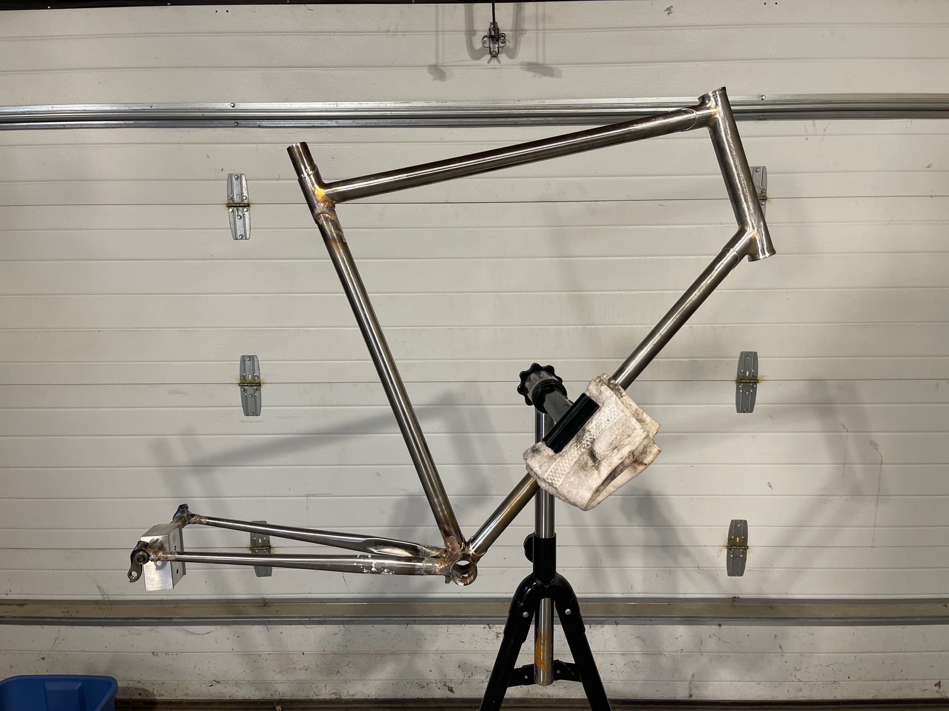

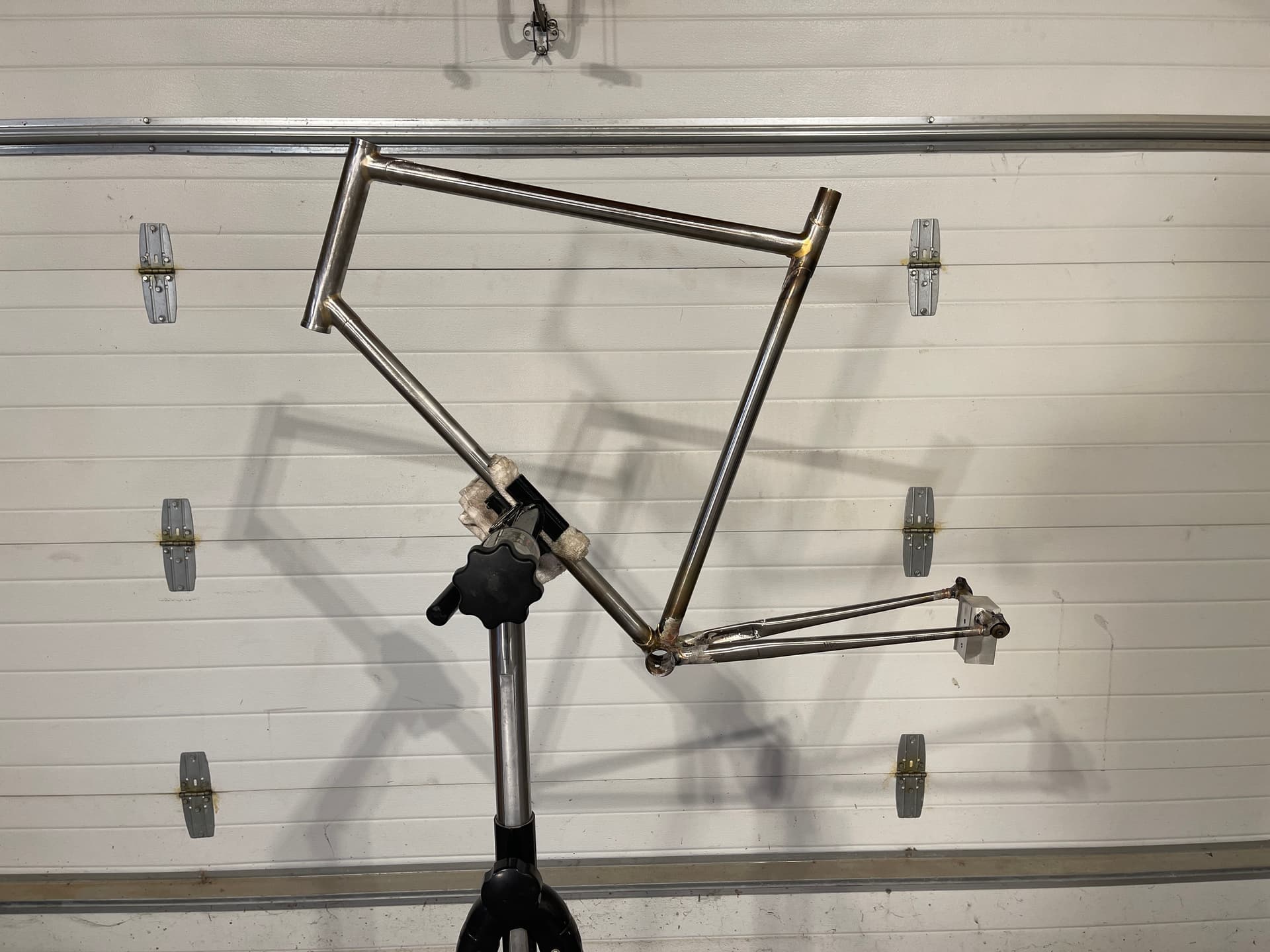

After noticing Paul Brodie did it in his YouTube video series building whole frames, I decided to file the main triangle fillets before moving onto the rear triangle. Its nice breaking large tasks down into smaller parts. It’s also nice feeling seeing a completed stage of progress. With fillets finished, it looks more like a bike.
The fellow from whom I purchased the frame jig included the manuals from his class with Doug Fattic, c. 2009. In the manual, it provides some instruction around brazing rear dropouts to chainstays without a jig. I was not feeling so confident. I like jigs. @StarMichael kindly sold me his Alex Meade jig and shipped it to me in Canada. Came with blocks so it works for seat stays, too!
It worked well and I brazed the dropouts into the chain stays and the chainstays into the lugged bottom bracket last night.
I’ve gotten better with the 56% silver, but I still tend to add too much, wanting to make sure the joint is good and full and solid. But that means I then have to remove the excess from around the lug edge later. My filing around the lugs and bilaminate points isn’t as clean as I would like with the tiny straight files I have, so I’ve ordered a couple of riffler files to see if I can better clean them up before paint.

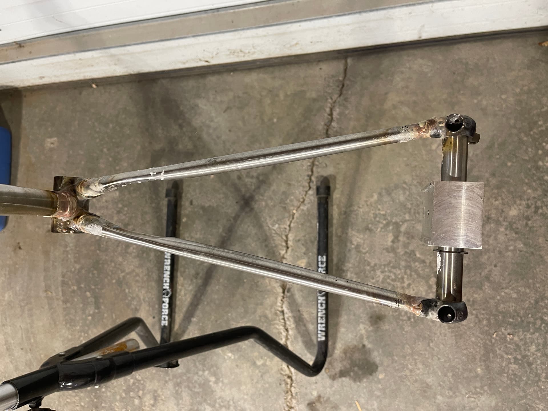

I considered a few different options for alignment. Sometimes it is hard when starting out to know where to best invest in tools and equipment. After reading some threads, I opted for a budget welding table. It’s assembled and seems adequate for what I need it for.
I can tell the frame’s main triangle isn’t straight and neither is the rear triangle, but it also doesn’t seem terrible. I put a wheel in the rear and it spun without rubbing. That’s a win, I think. The spacing between stays and tire is unequal side to side, but its in the 60/40 ballpark at least and not 80/20.
An ART337, along with some other fittings, tools, and supplies are coming from Peter at Ceeway next week. I’m keen on some kind of fastback-esque seat stays and this fitting should work with the SL seat stays and provide enough width between them to clear the 43c tires I intend to run. Nice.
After supplies arrive, I should have what I need to jump into the alignment work.
There is still a good amount to do, but I am optimistic I will be able to have it finished enough (certainly not painted) and in some kind of rideable condition before the snow flies. Here’s hoping, anyway :slight_smile:

Alignment can be a controversial subject but I don’t think you need a table. If you look down the bike from the front, shut one eye, line up the HT with the ST, and move your head from side to side so you can just see the ST peeping in and out, you can see tiny errors just with the eye. I’ve found this more accurate than messing around with lasers. And I’m pretty sure it’s all people used to do back in the day (if you’re lucky). There’s a video somewhere about some lads in Yorkshire holding frames up to the window to look down them I suspect like this. This is the most important aspect of alignment to get right.
To get the BB square I tack that to the ST first and just lie it on its side in the same place on my reasonably but not perfectly flat table. If the gap from the table to the top of the ST is the same both ways up then it’s perfect. But I’m tigging everything. The process is a bit different if using lugs because you can actually bend the lug a bit. Once the TIG weld is fully in there, you’re not changing that angle, so it had better be right.
I believe this is also at the root of some of the controversy around alignment. If you use a table you’re using the edge of the BB shell as your reference. Since you can’t correct that on a TIG frame (all you will do is bend the ST if you try to) you’re better just to get that as square as you can right from the start and then do any further checking/correction in the vertical plane. In other words, you align the HT with the ST. You don’t align both with the edge of the BB shell.
As for the rear triangle it’s all about whether a wheel will go in there and be equidistant from both pairs of stays. Tiny errors are magnified by the wheel. I always put the seatstays on last because this makes any final corrections that may be necessary very easy. When mitring chainstays I check that each chainstay will fit exactly the same in both sides (turn it the other way up). That guarantees they are exactly the same length which is the key thing to get right.
String around the HT and back to the stays, and then measure the distance to the string on both sides from the ST is how to make sure ST and HT are both on the centreline.

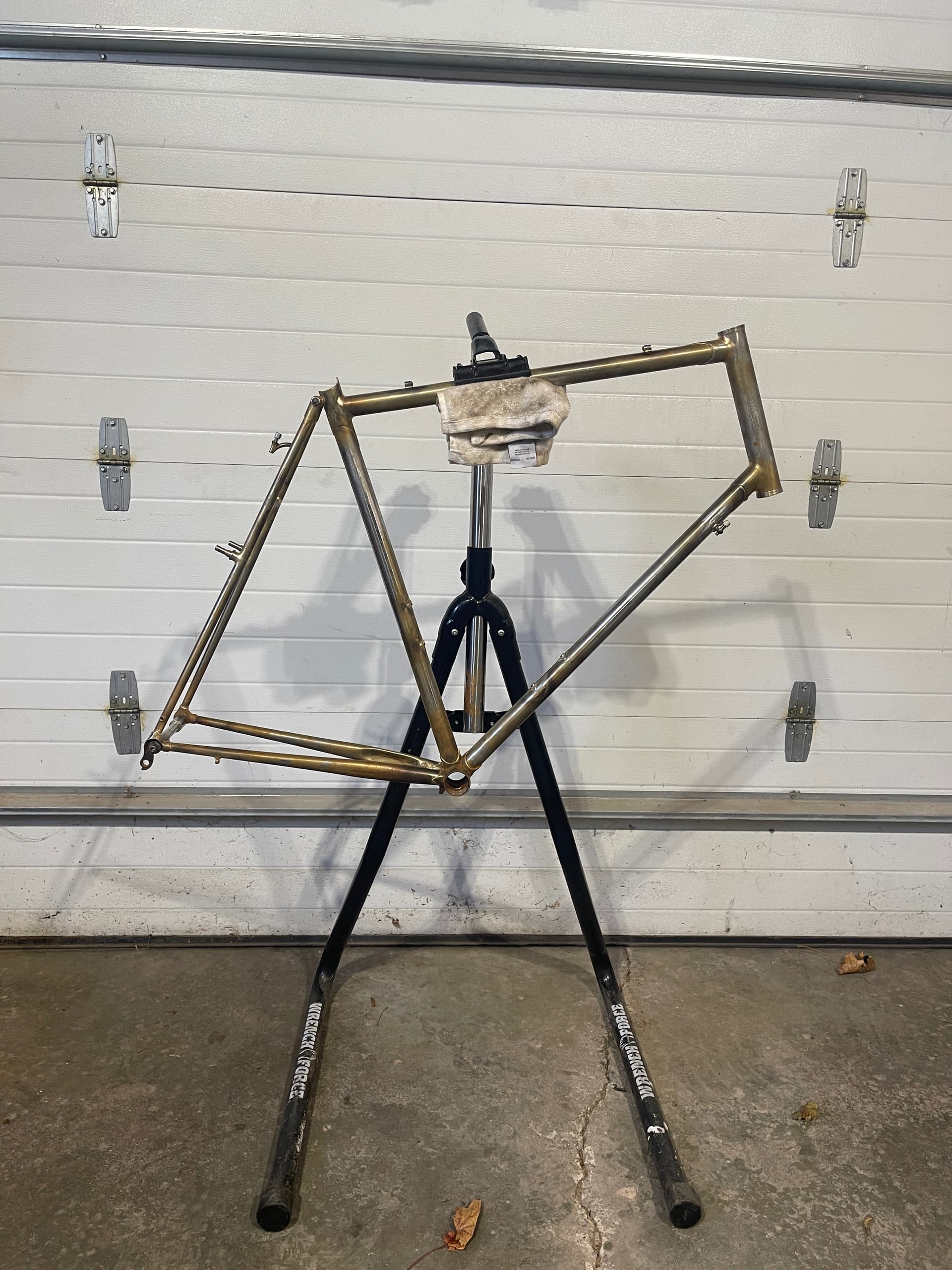

I Frame progress update:
I finished it in the wee hours of this morning.
It’s nowhere perfect. It’s not bad the way that is motivating to try again to do things better the next time.

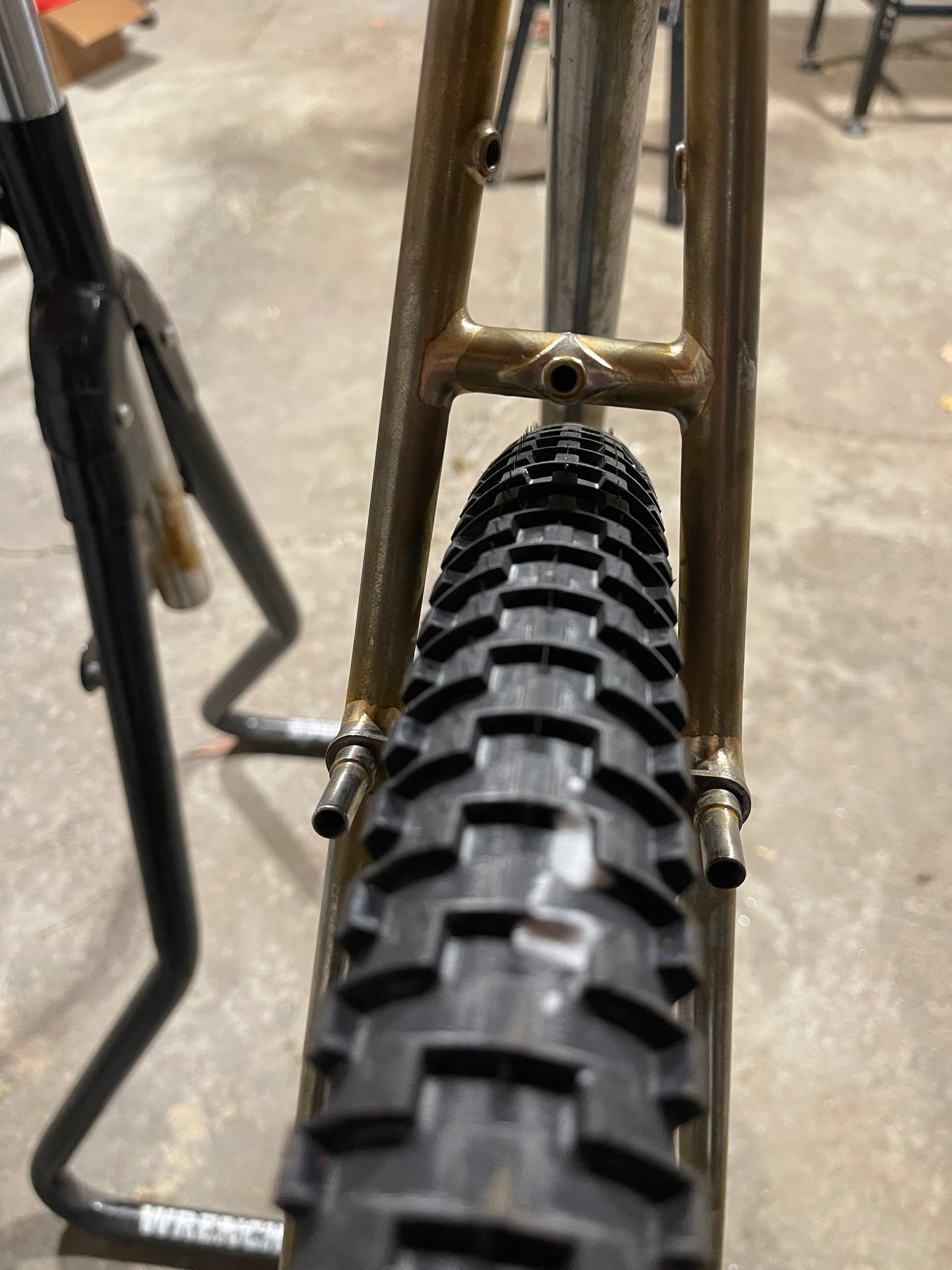

The alignment process was both more and less interesting and complicated than I thought. The front triangle turned out to be in the same plane in a really nice way, however, relative to the bottom bracket it was off by a bit. Maybe a centimetre over the approximately 60 cm seat tube. It wasn’t so hard to put it to less than a millimetre out over that same length using the Harbour freight – grade welding table I bought for just this purpose.
I severely manipulated the classic SL chain stays, so they didn’t deform consistently. I also thought that they were in perfect alignment when I installed them, but the rotation in the lugged bb turned out to be off a little bit.
I aligned the rear wheel in the chain stays fairly well I think, but the seat stays are a little off, I think, because of the asymmetrical deformation of the chain stays and my not knowing how to and not bothering to compensate.
I had to put the seat stays on twice. The first time I forgot to tack both stays in their dropouts before completing the silvering. The state assembly pulled very heavily to one side.
The second time, the seat stays rotated a little bit somehow, so they’re not as aligned as I would like.

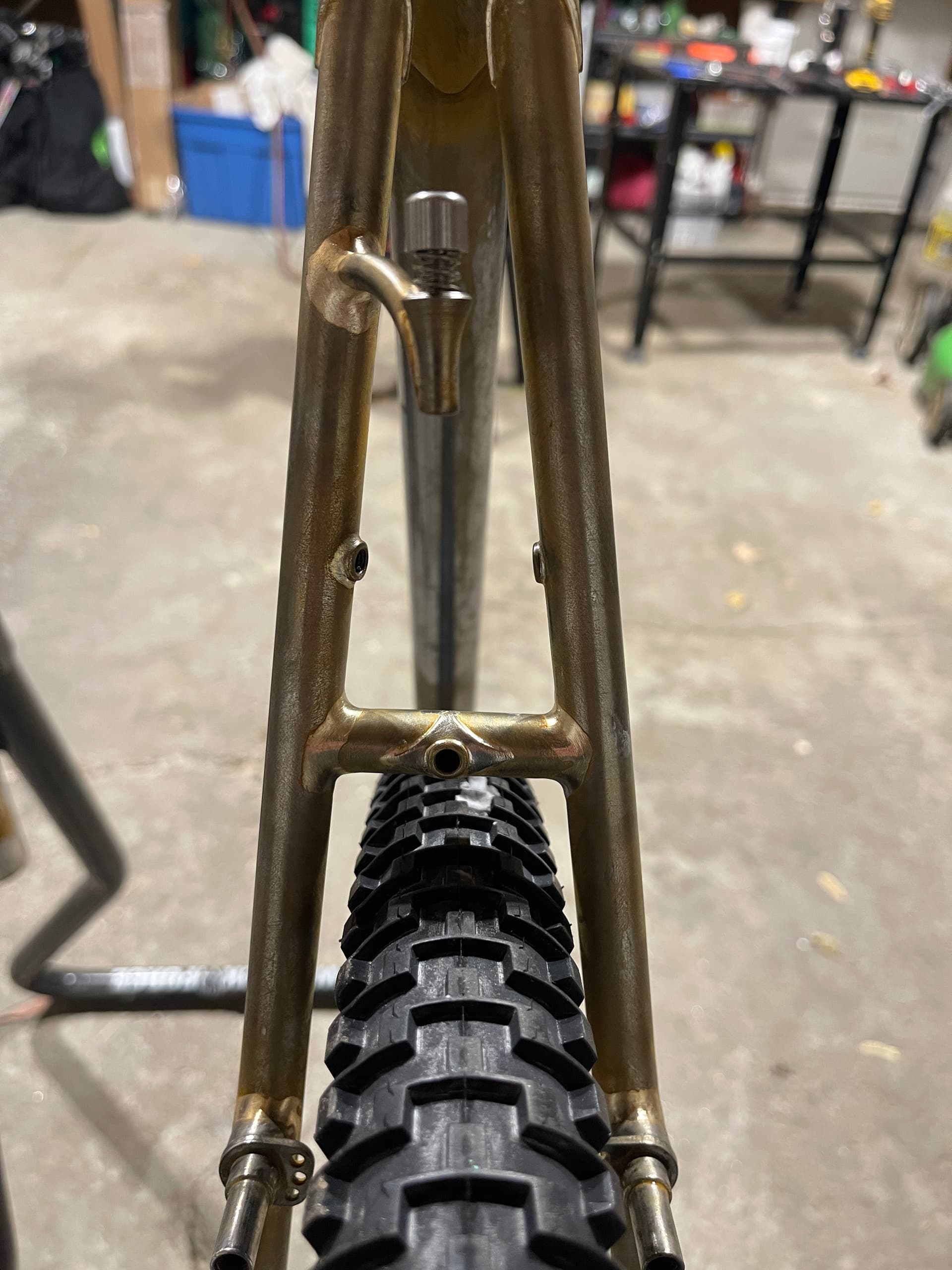

The seat stay bridge is, in all likelihood, a little crooked.

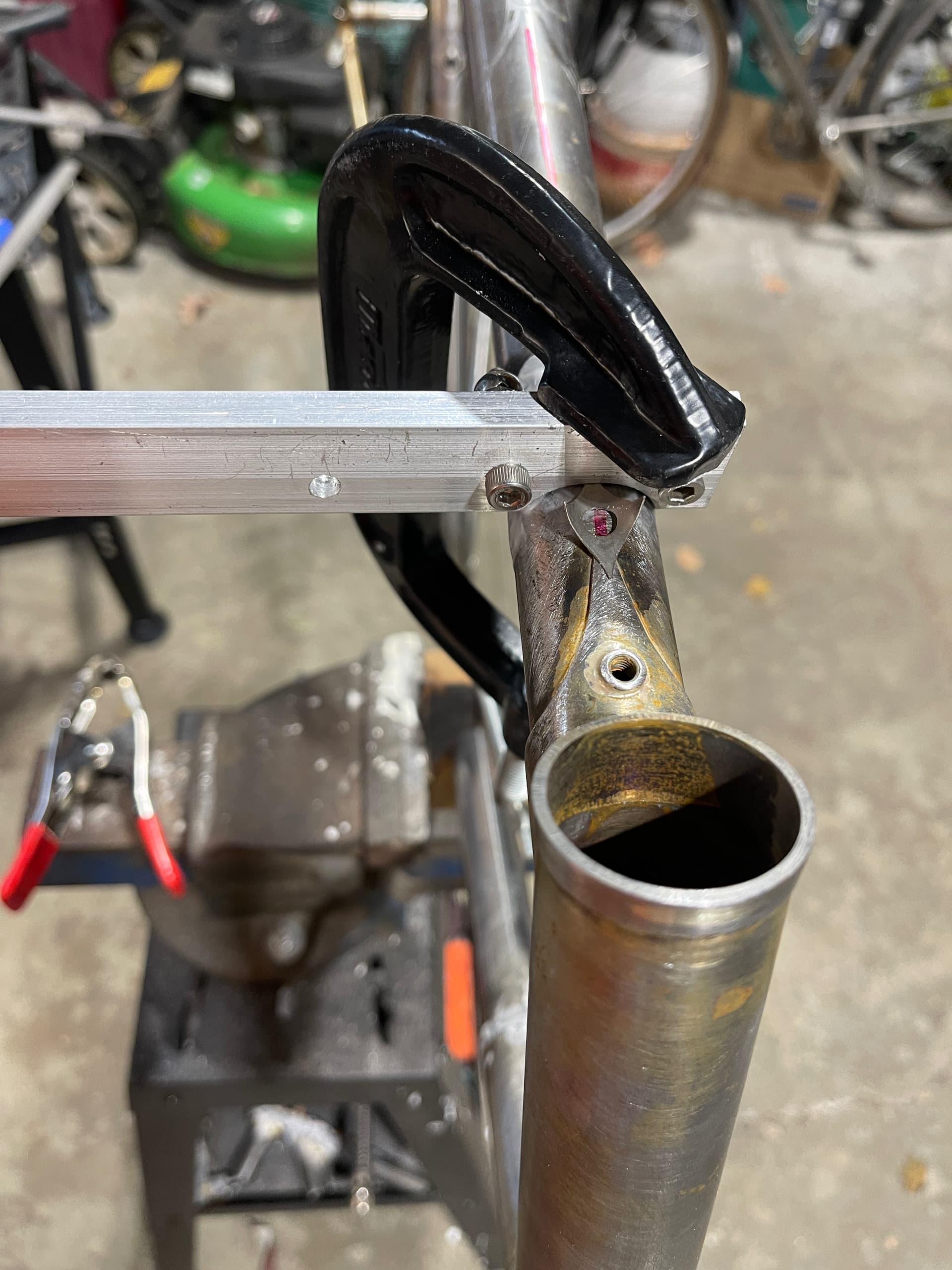

I made a little jig out of a miscellaneous piece of aluminum to hold the down tube shifter bosses. I screwed up, though, and removed too much material, requiring a bottle boss reinforcement to shim the assembly in place.

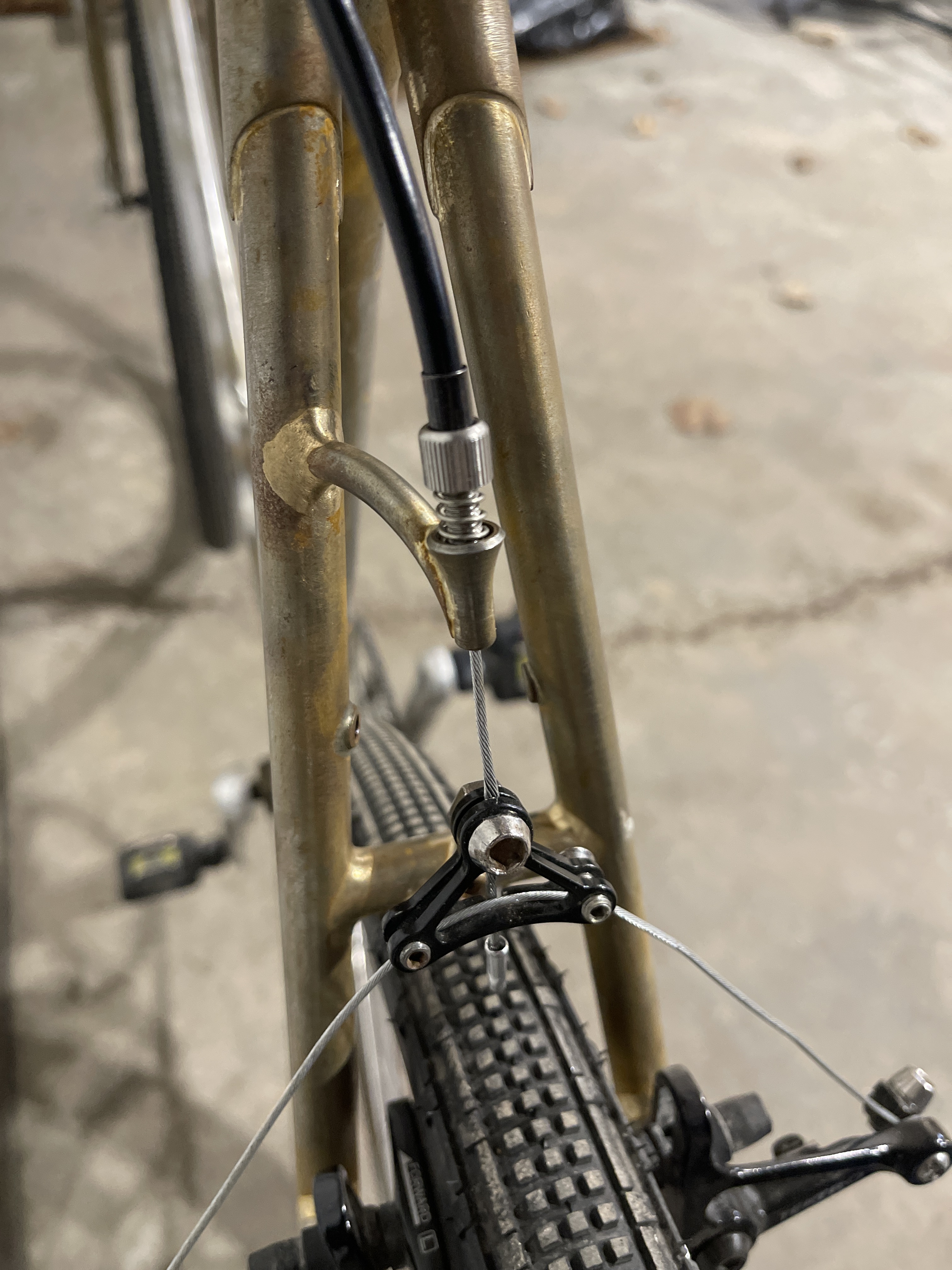

The candle lever bosses were installed, using a jig, made out of the same kind of aluminum bar plate. The one cantilever boss rotated a little bit during braising, so they are not perfectly symmetrical.

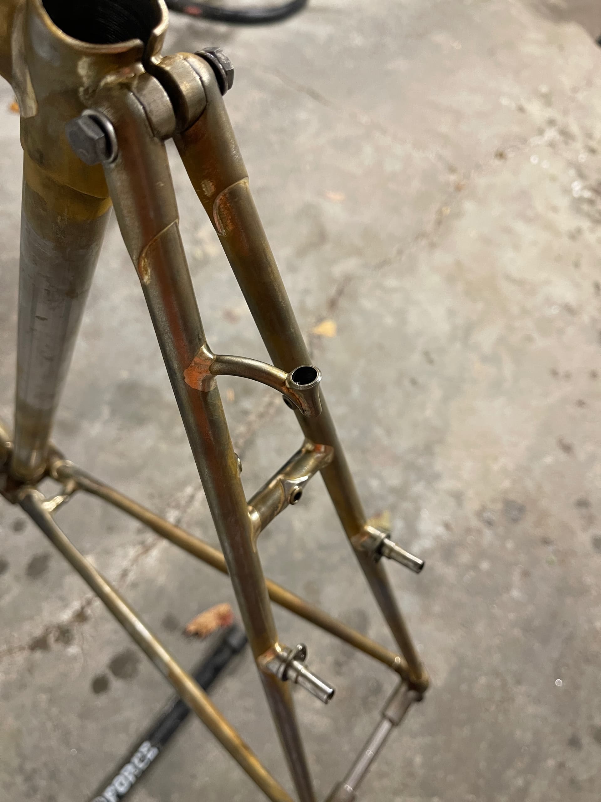

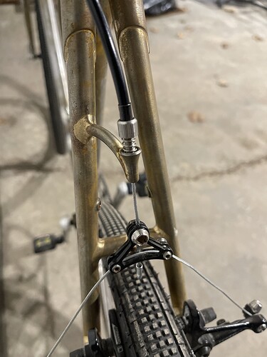

Another challenge was using the very beautiful paragon machine works cable stops. I tried installing two of them on the top tube probably six or seven times, but they got hot so quickly that the flux blackened and the silver wouldn’t adhere. I kept scraping off the burnt flux and trying again with less heat, smaller flame, more flux, etc. but didn’t quite get it. I’ll try again with them on the next frame, hopefully after having built up my skills.

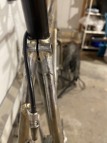

The bottle boss showing in the by laminate next to the down tube shifter pods is intended for dynamo cable routing for a rear light. I drilled out the vent holes in the non-drive side dropout, so that I could run a cable up to the seat stay bridge if I wanted to.
Metal Guru kindly sent me an adjuster screw bugle with my last order, so I have incorporated it to the built-in hanger for the rear canti brakes.

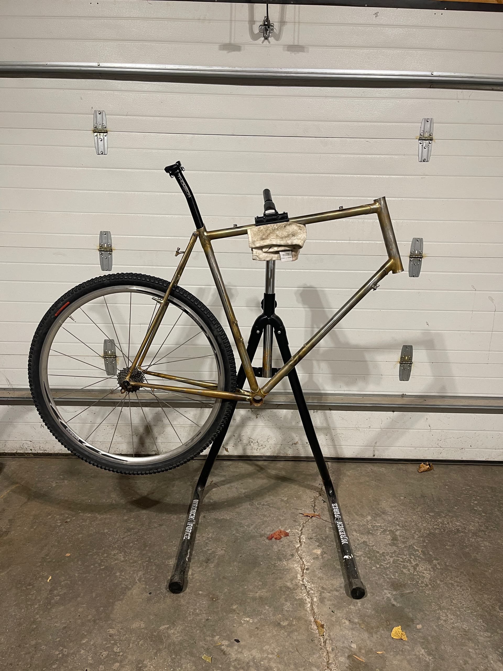

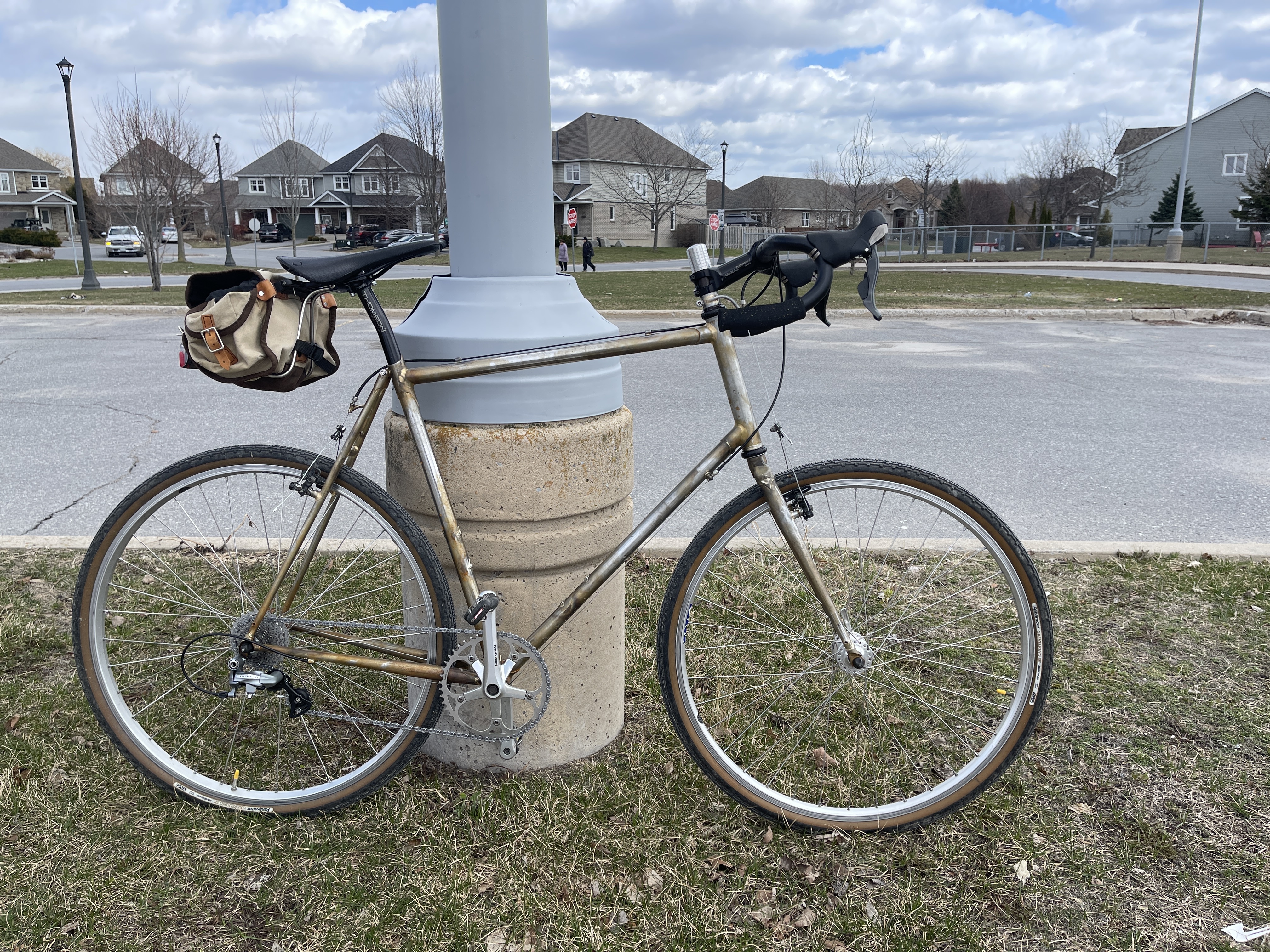

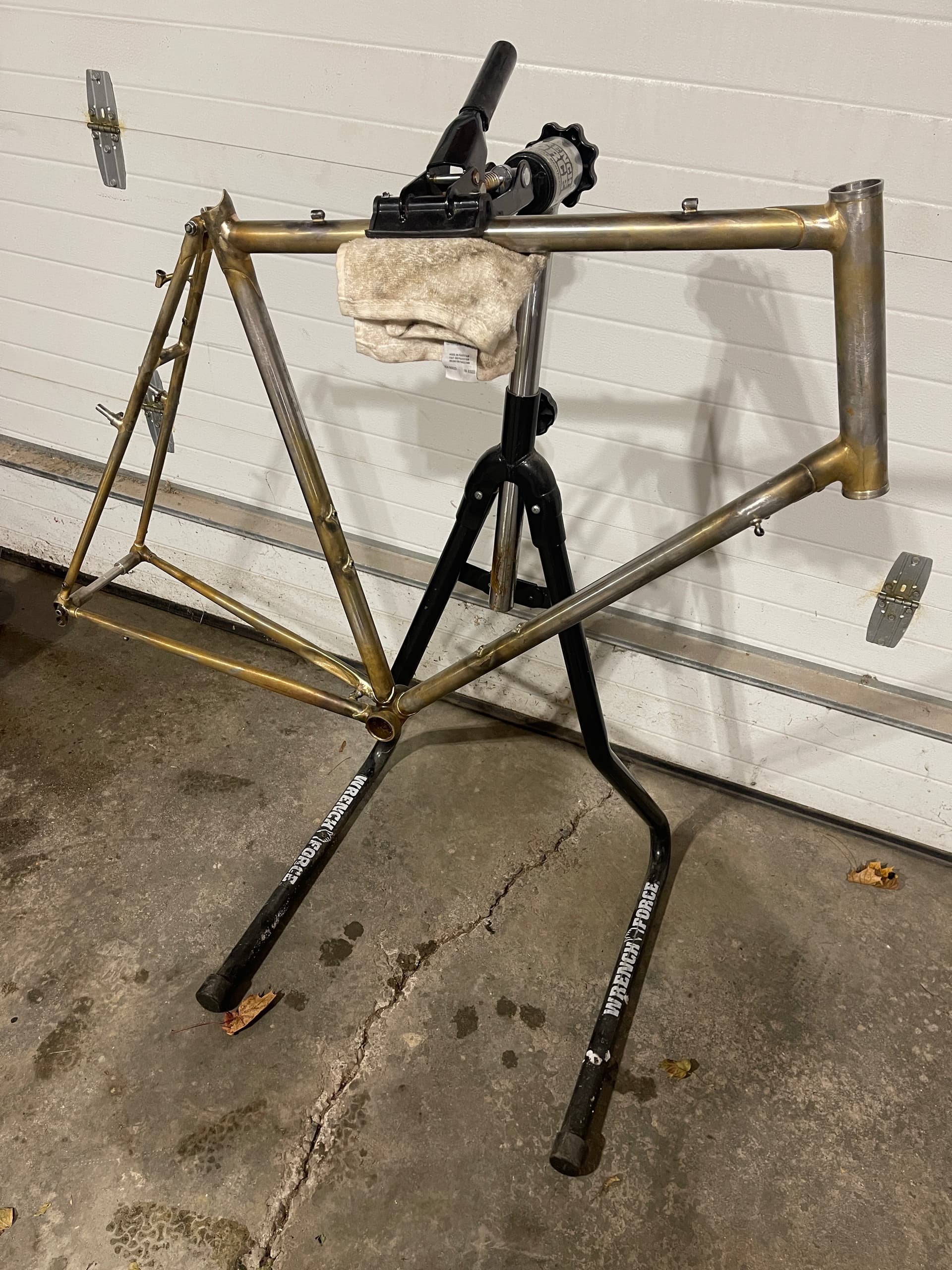

Mocked up at very close to intended ht and st angle (both 72 degrees), with a seat post at typical saddle height, and rear wheel and Bruce Gordon Rock n Road tire, 70x43c.

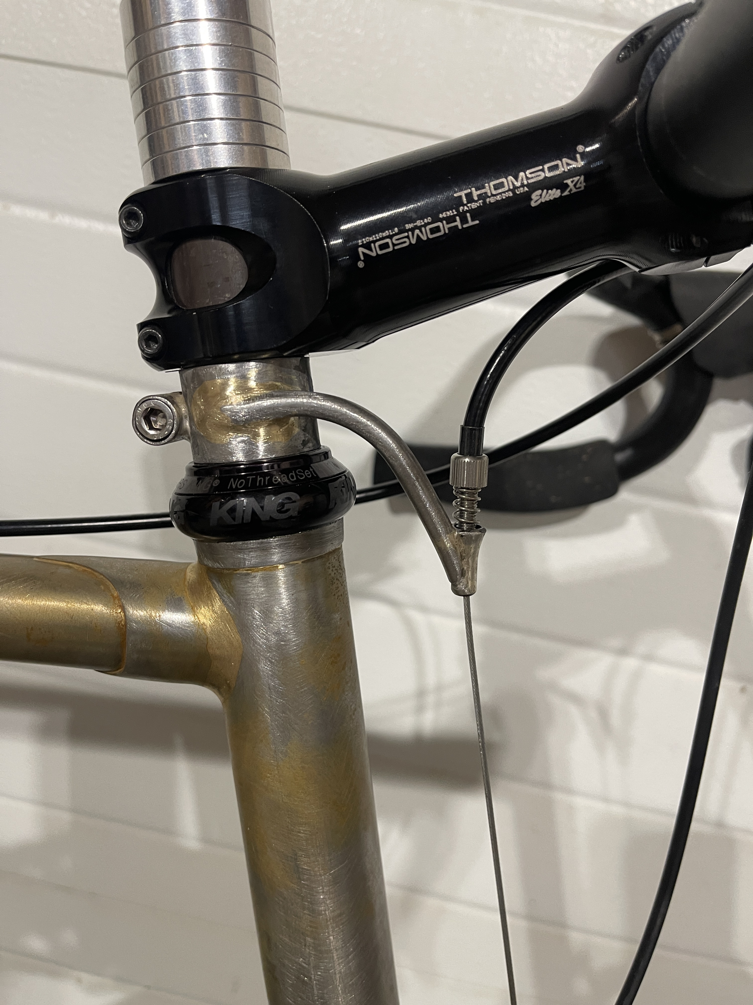

Over winter, I ordered a crown race cutting tool and then used the Easter long weekend to finish the fork and make a cable hanger.
A picture from the first mock-up/shakedown ride.
Totally sick and glad to see it out- how was the first ride? Any creaks and gremlins or ready to rip?

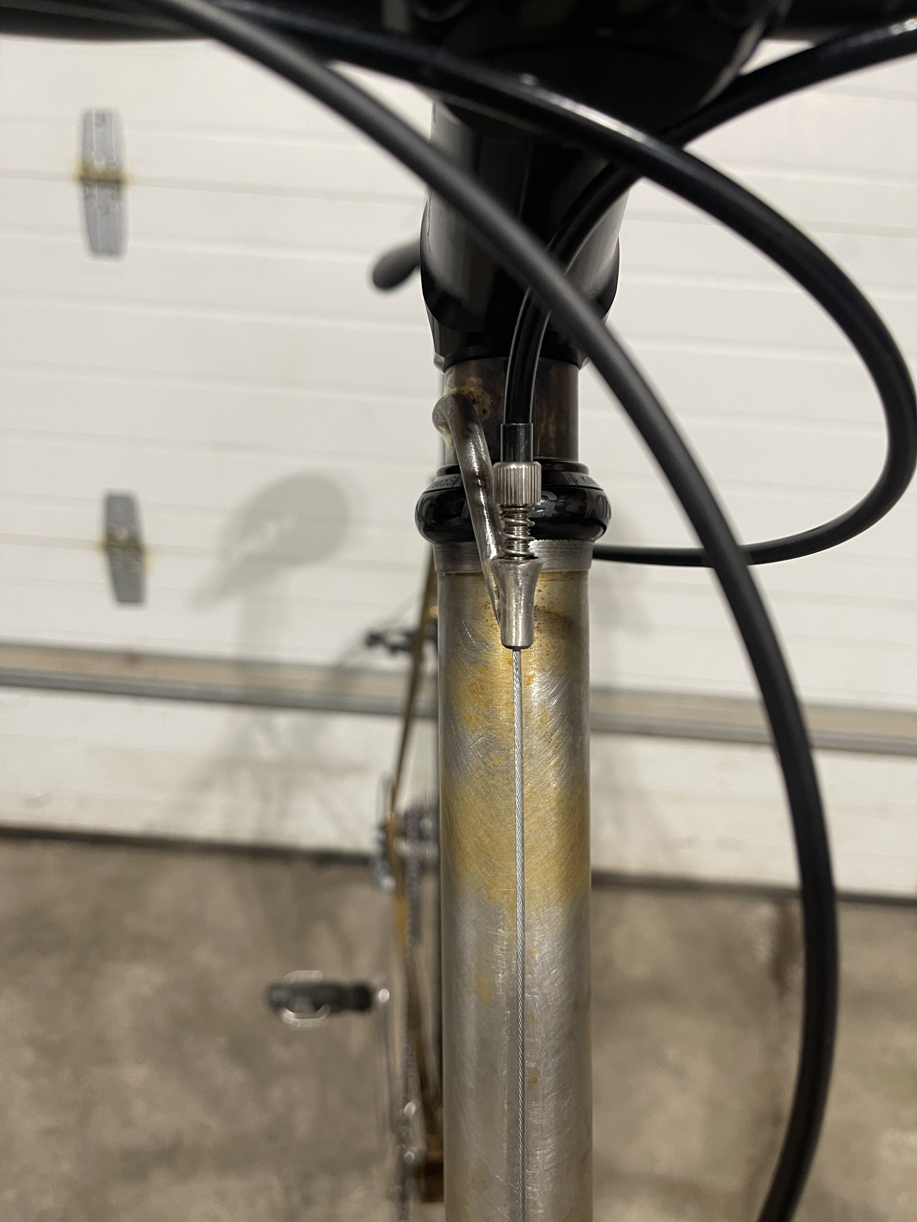

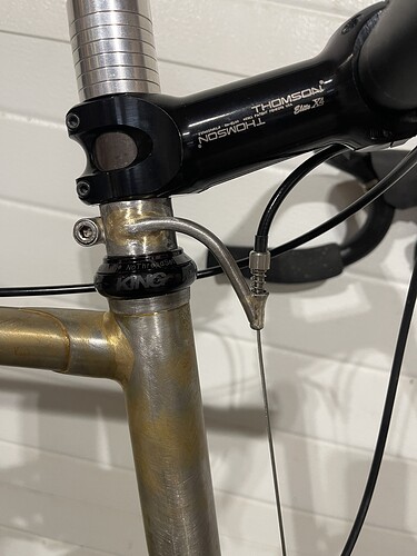

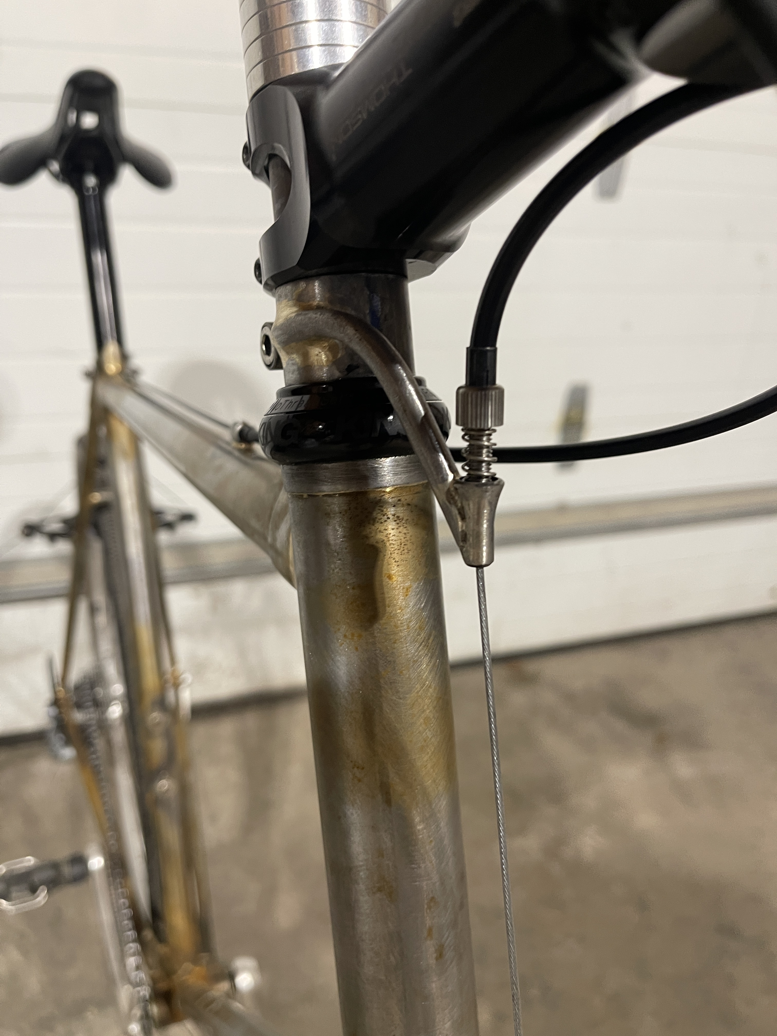

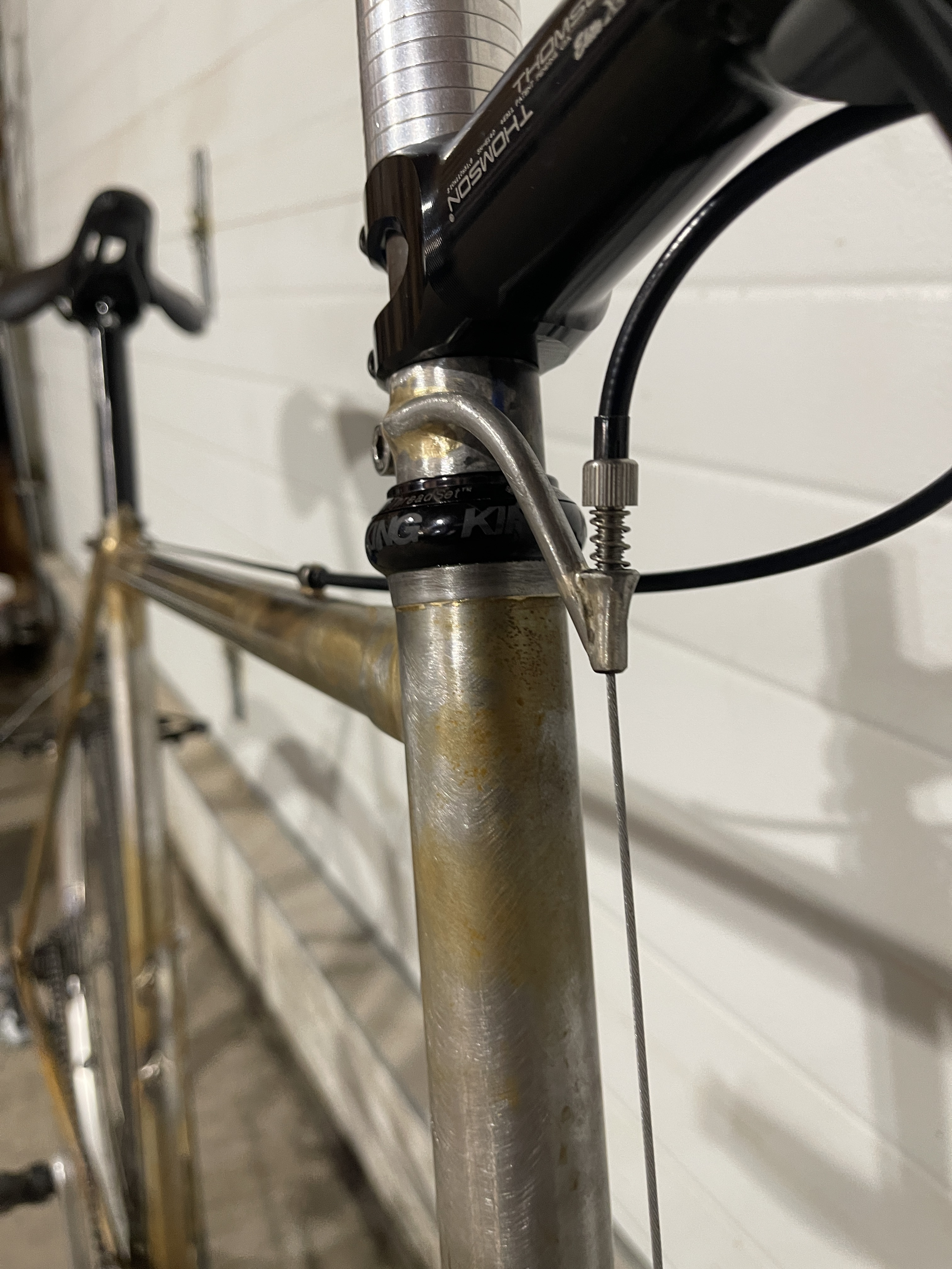

Some close-ups of the front hanger. It’s not perfect, but not terrible. There are some things I would do differently next time, but it didn’t turn out too bad. I tried to make it match the rear hanger. Pic of rear hanger below.
Thanks! Not so much creaks.
I tried riding the fork with no hands on the handlebars. It pulls just a little to the right. I’ll have to take a look at that.
Besides aligning and adjusting the fork, most of what’s next is removing excess material from my excessive silver application and some light sanding before paint.
The first ride was nice. It was just around 15-20 km around the neighbourhood.
It is super comfortable. I kept sitting on it and thinking, “Wow! It’s like this bike was made for me.” Oh, right. It was!

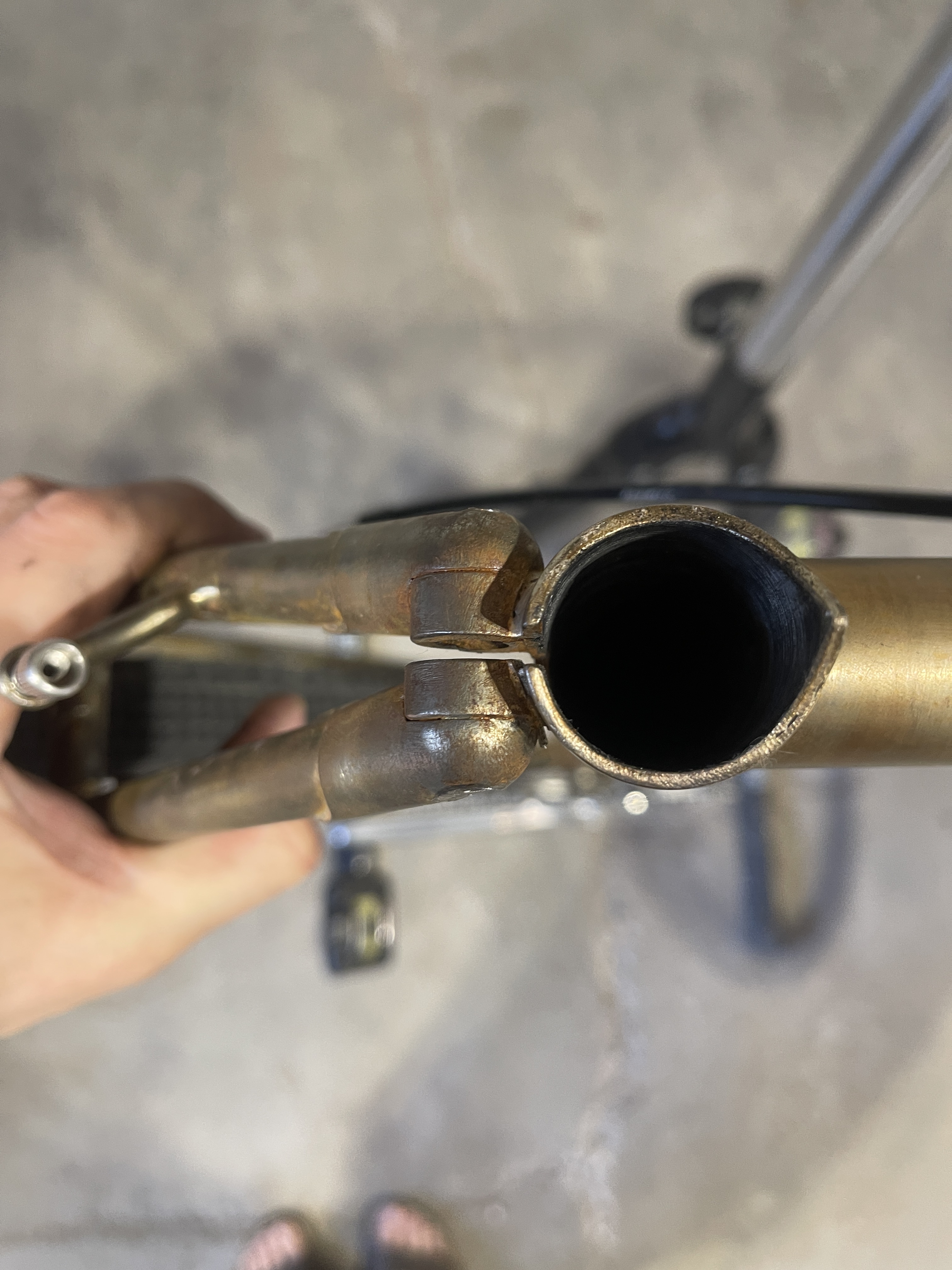

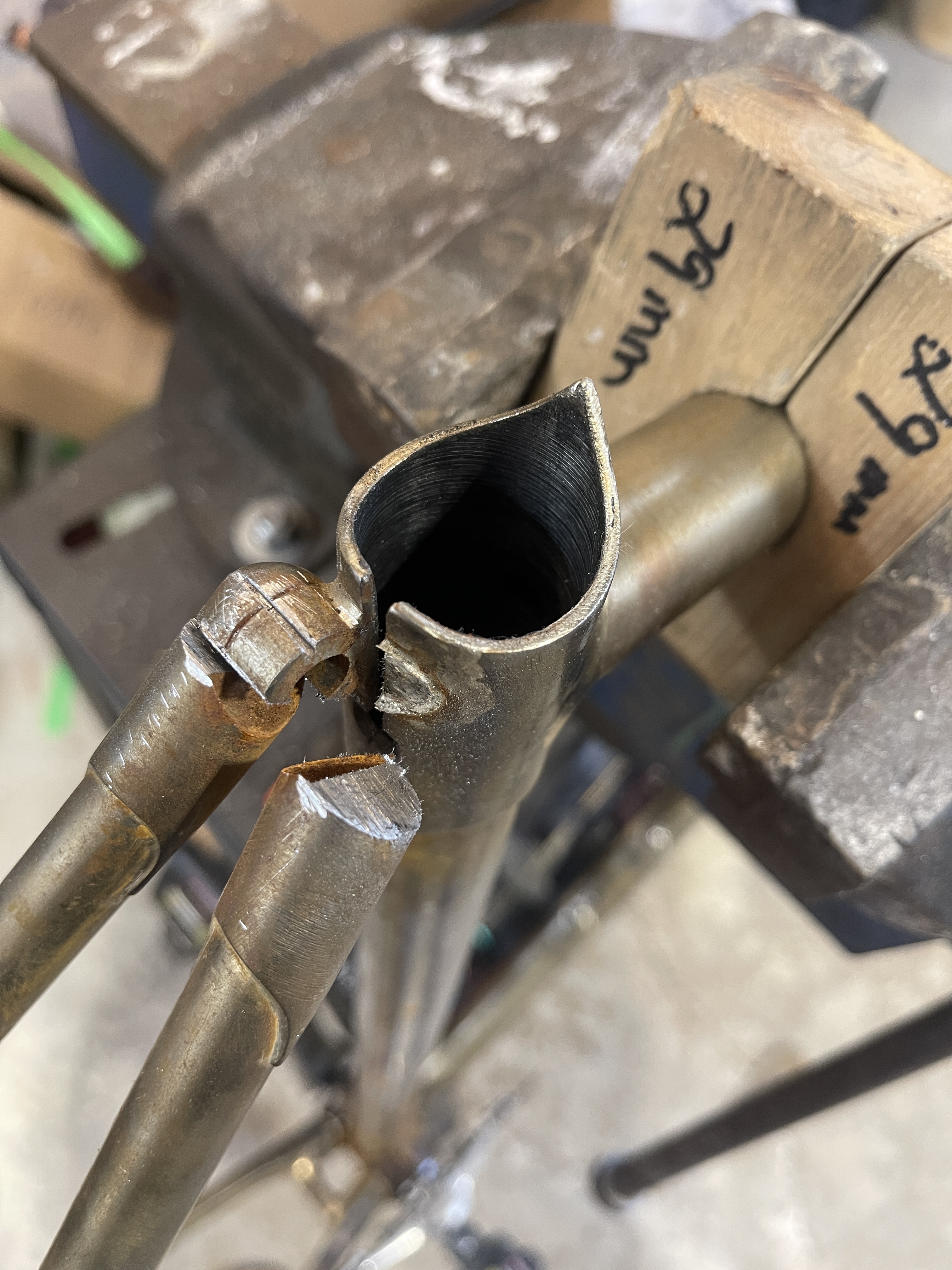

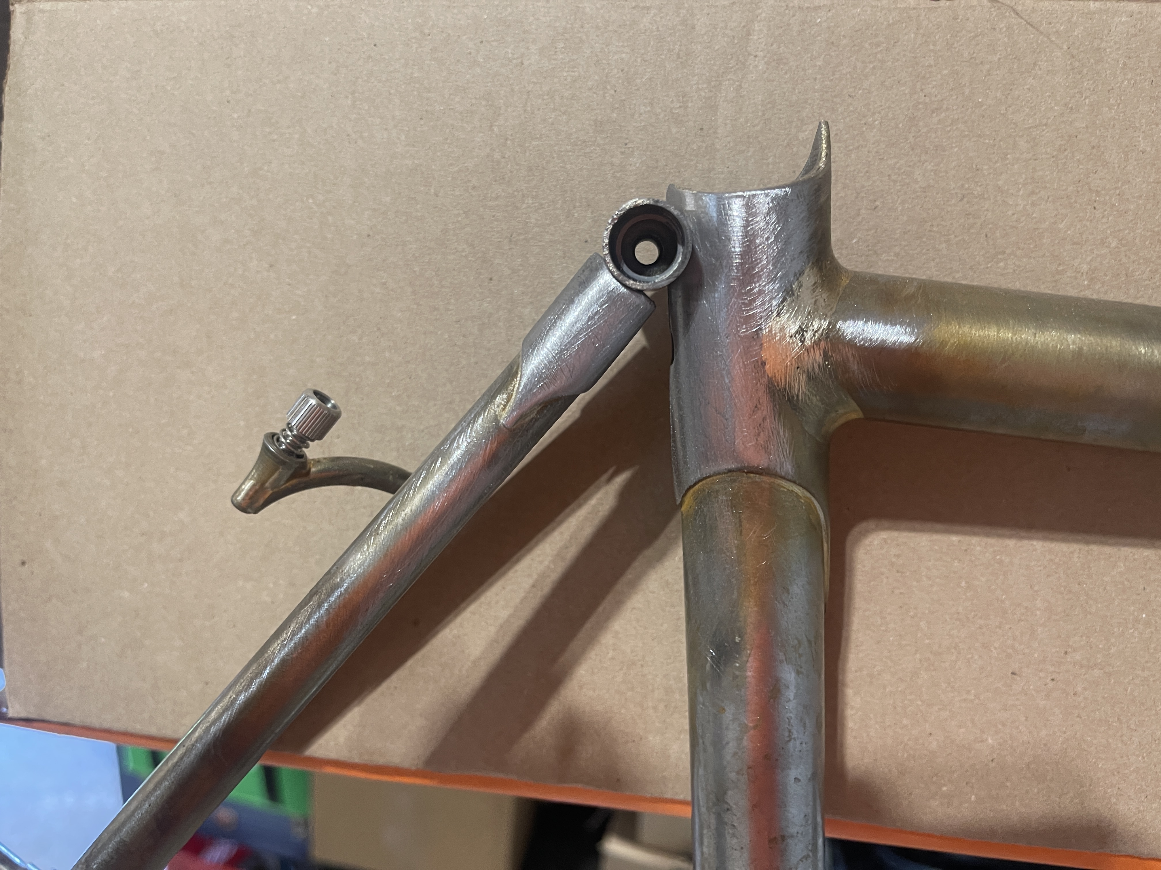

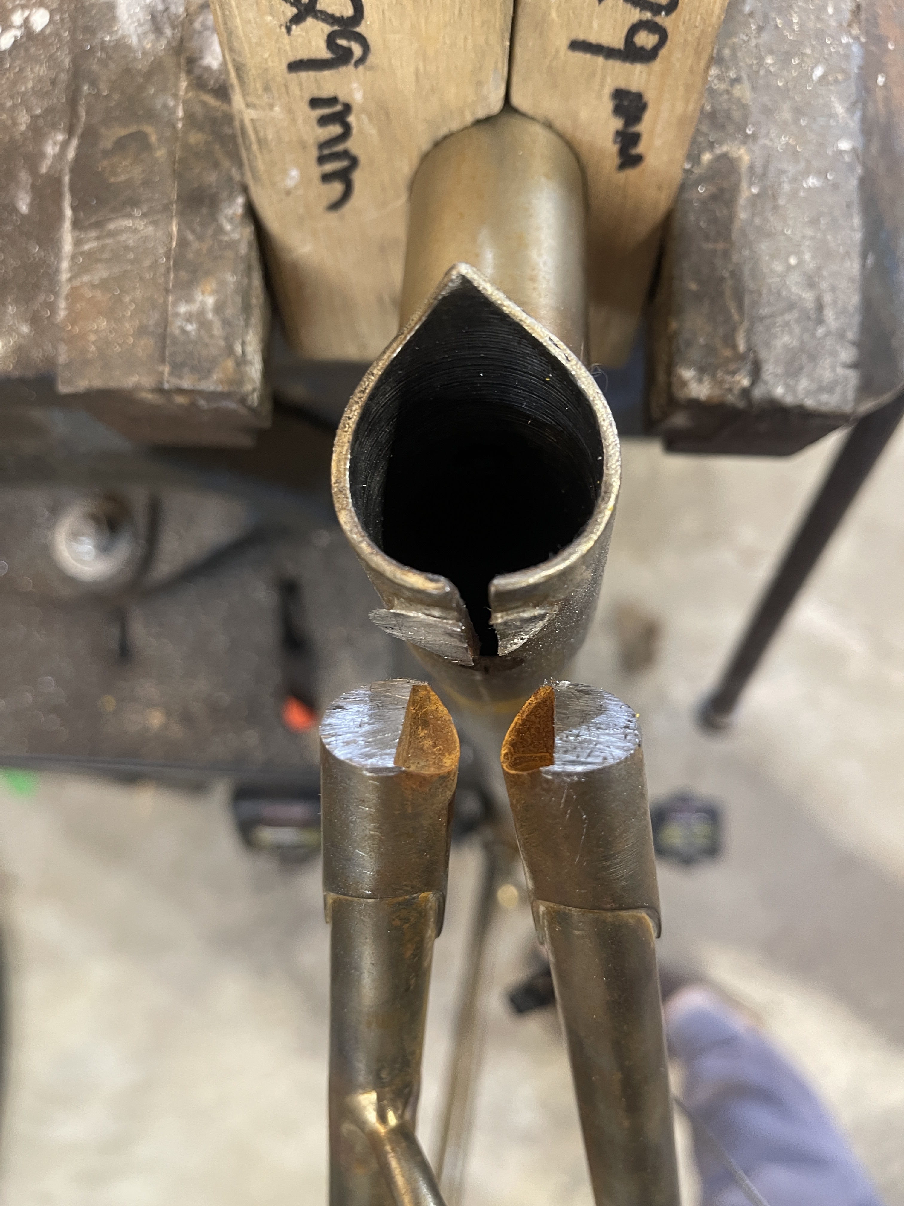

I’ve continued riding this frame, putting it through some paces before paint. On Monday, I was riding and the silver holding the seat stay tip to the seat tube bilaminate gave out. The seat post clamp bolt has bent or broken a few times and after this I decided it best to resolve the issue before considering the frame done and ready for paint.
There is a lot of metal there for the bolt to move to clamp in place, so I’m not surprised there are problems.

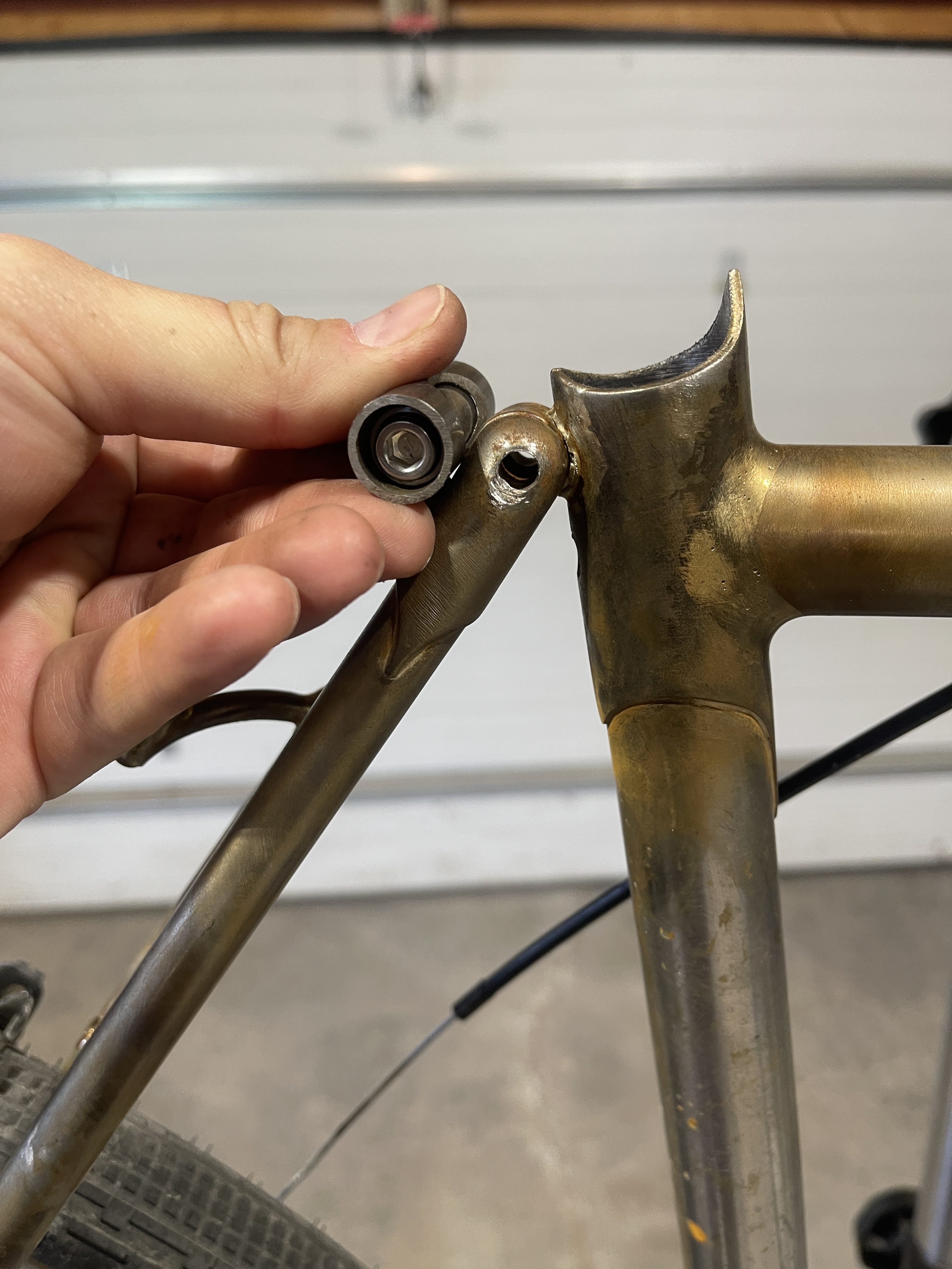

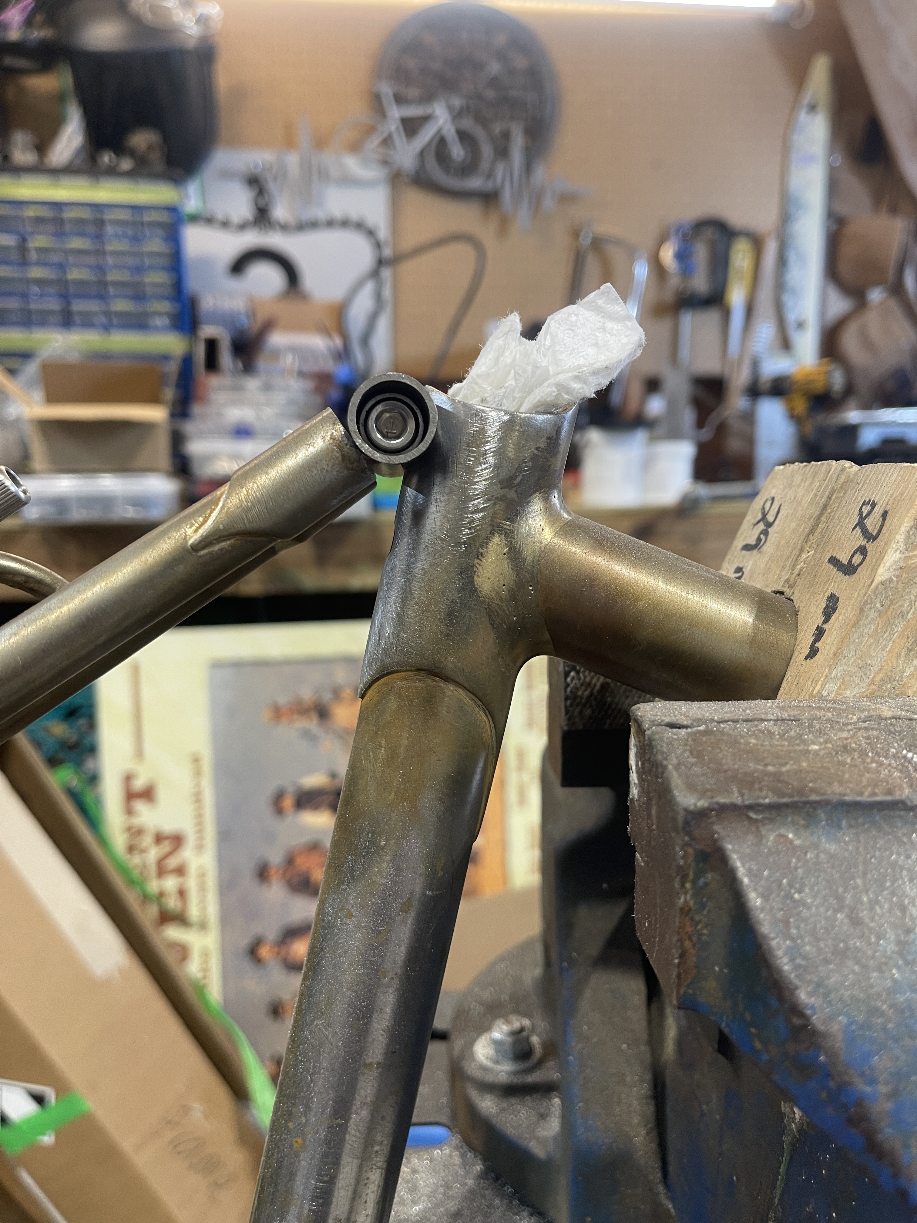

Thinking through a couple of ideas, I decided I wanted to keep to the initial design and its fastback stays.
I used a hack saw to remove the top section of the seat stays toppers and files and 60 grit to remove the remaining metal and silver from the old seat clamp.

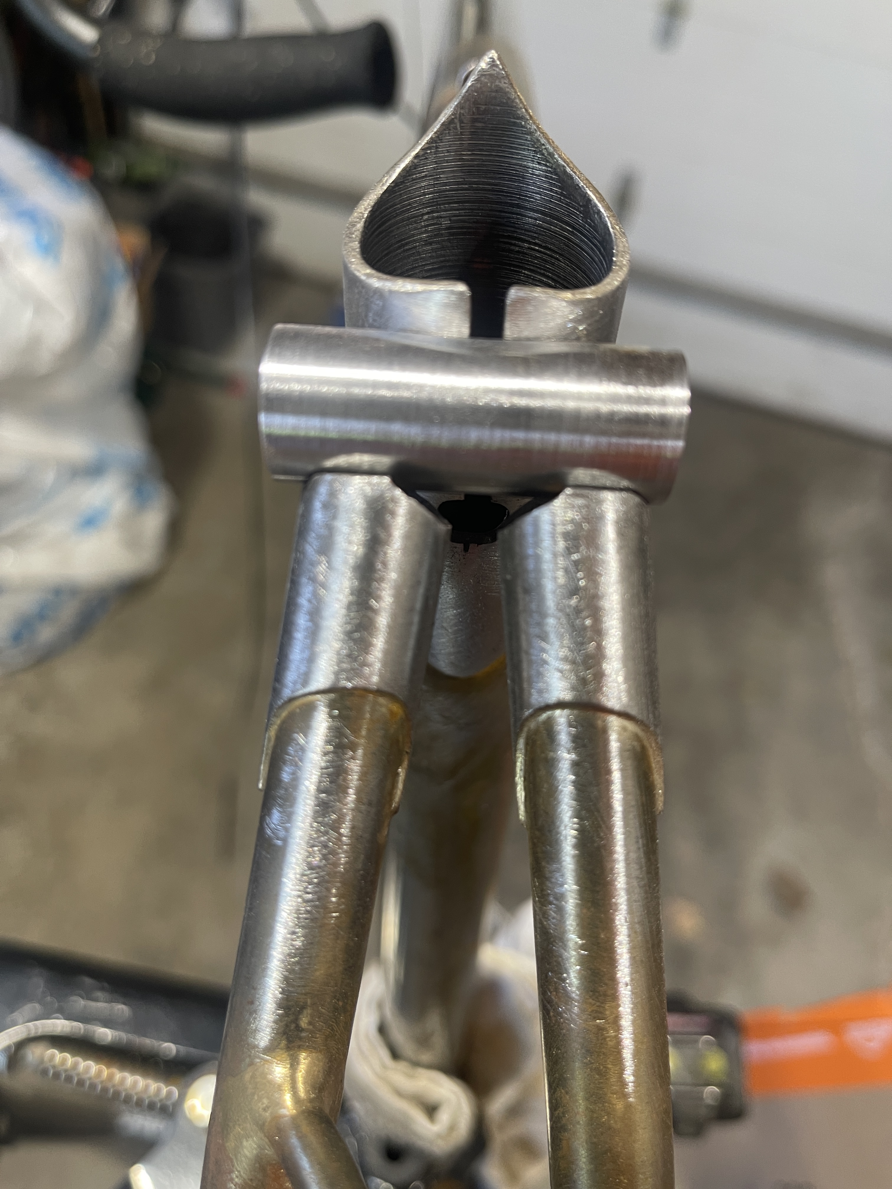

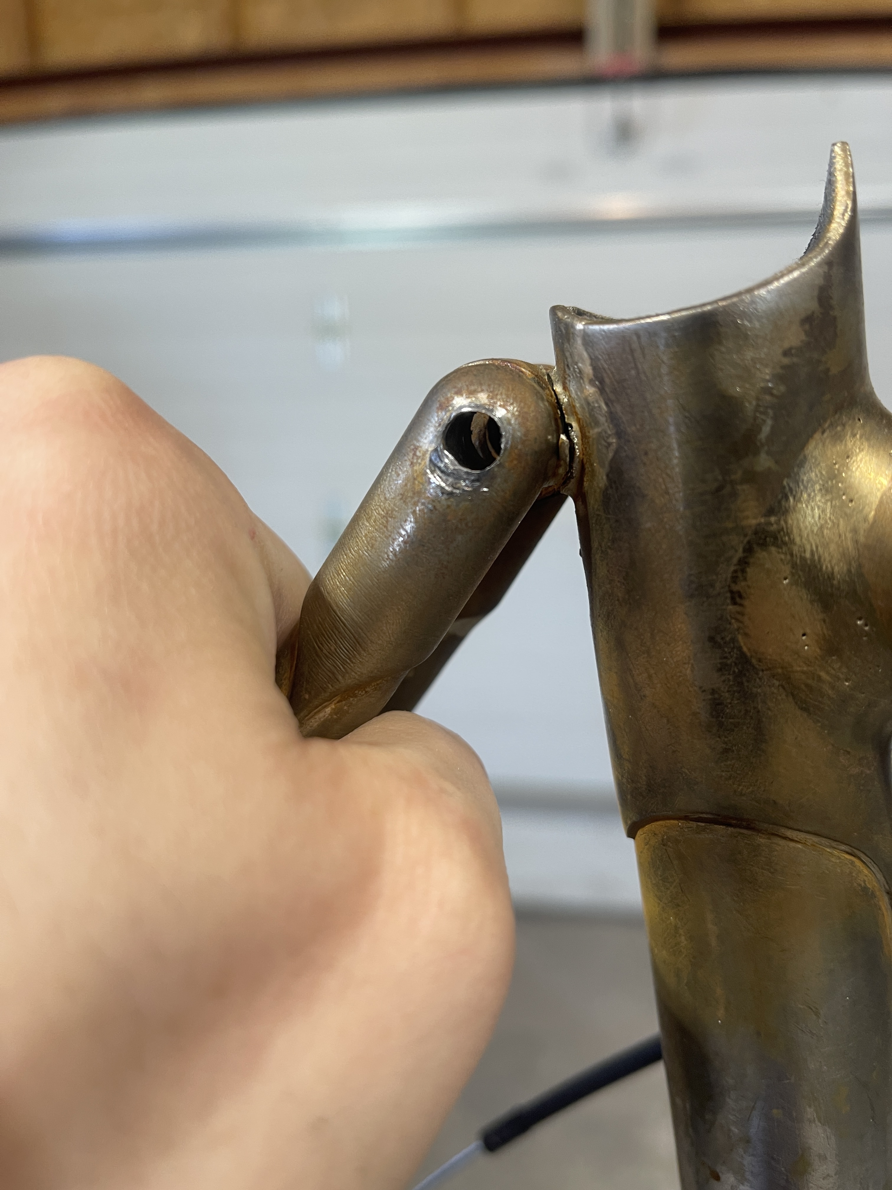

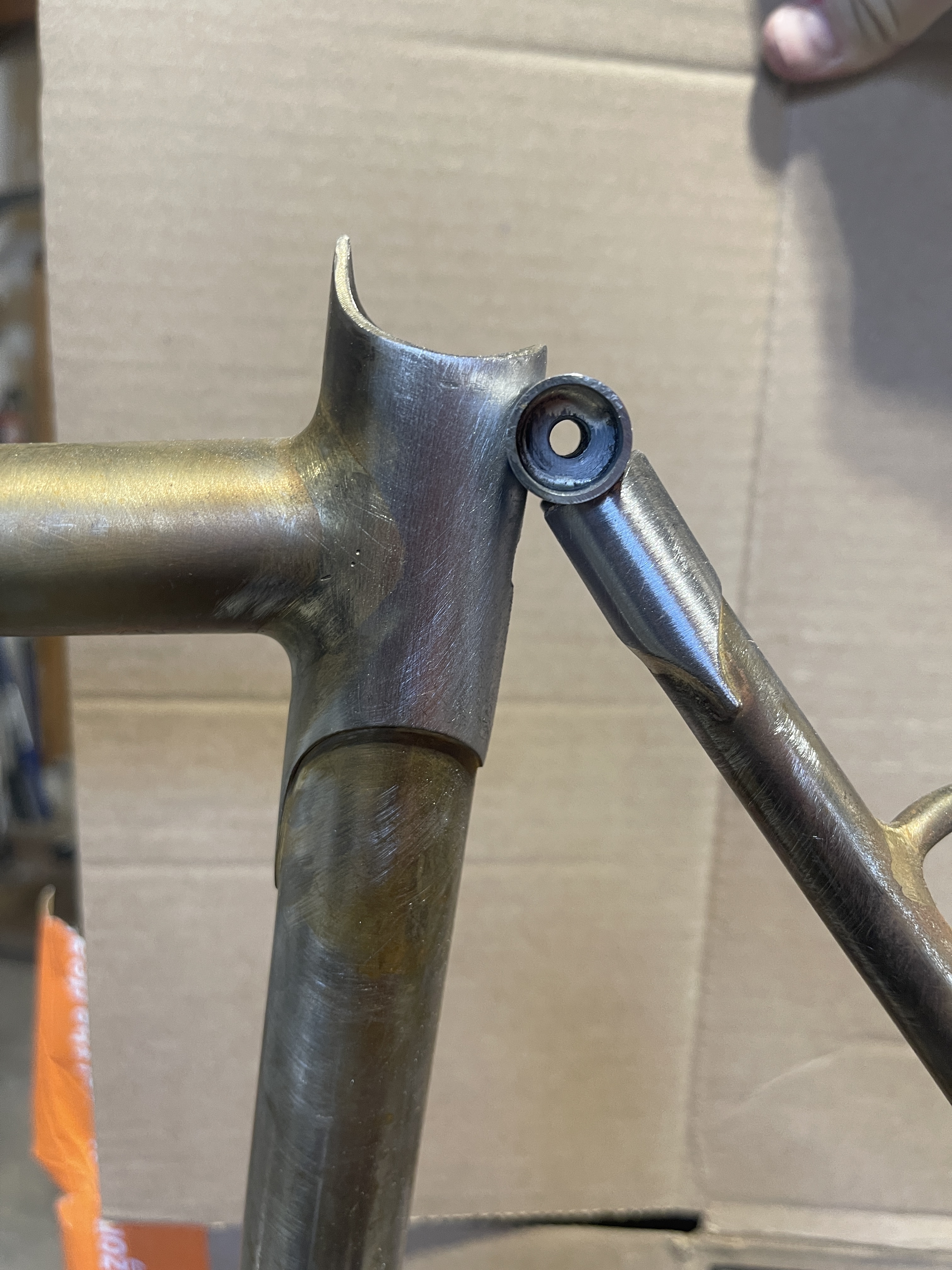

My plan now is to silver the standard clamp braze-on into this small tube stub that has been filed to match the braze-on’s contour, then fillet the assembly with brass to the bilaminate seat tube topper.
Since the last picture of the mockup, I have filed a curvature into the seat stays toppers for a better fit with the small tube housing the seat clamp piece. (The seat stay tops don’t touch the clamp piece squarely, as shown in the mock up picture.)
After brazing, I will file to match.

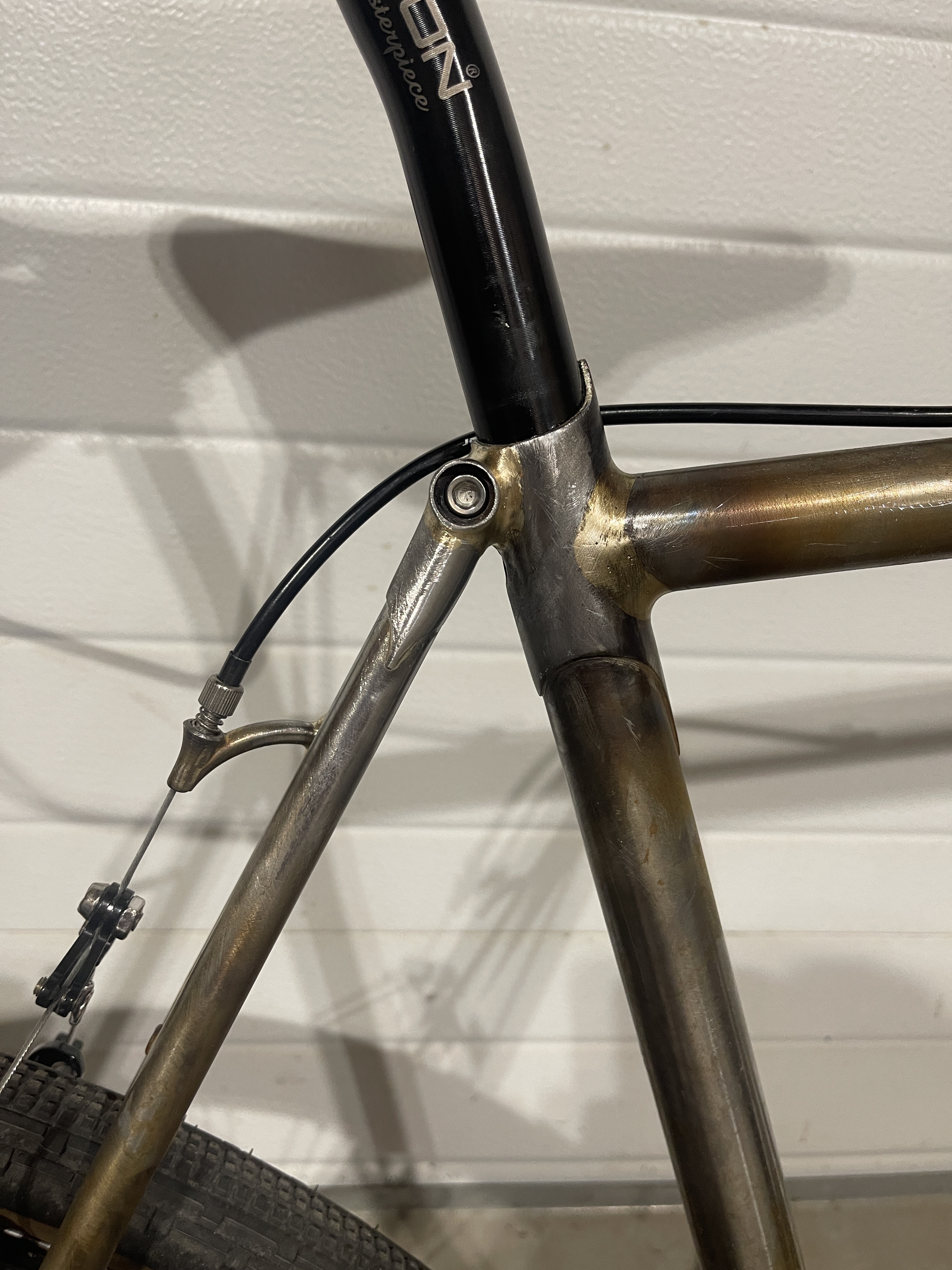

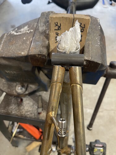

More pictures for a better idea of what I’m describing.
Today was the day. I gave it a go and now it exists. I could have done a good number of things better, but it doesn’t look terrible and should function. I haven’t taken it out on a test ride yet, but it definitely seems much more robust.
