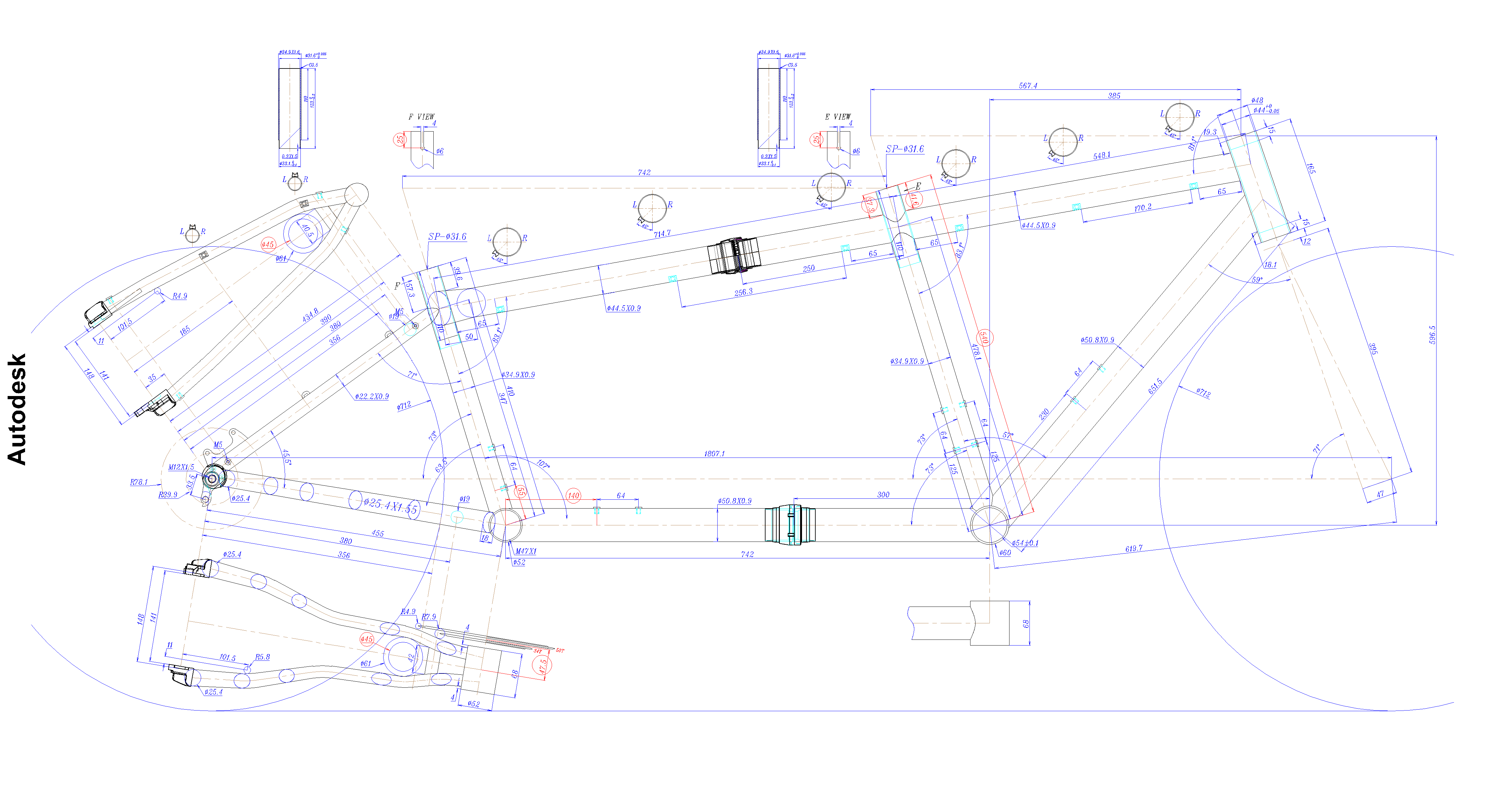

I am looking for some help with a tandem frame that I’m getting built. I’m wanting to know what BB shell width and chainline I should specify. I first tried going past my local bike shop to ask them for some help but they said that’s out of their knowledge base. I then started searching this forum and got even more confused.
My ideal setup is to have SRAM red 2x with 50/34 chainrings and a 12 speed 10-36t cassette. The wheels would be Rolf Prima and they come in either 142mm or 148mm boost. The crankset is Appleman 2xr and comes in various spindle widths. I plan on a standard English threaded BB. I would have 2 sets of wheels, one setup for road with 28 or 30mm tires and a second set for gravel with ideally 50mm tires (45mm would also be ok).
In reading some threads here, it seems like I would want 148mm boost for the rear hub since I plan to use wide gravel tires so I can get proper clearance? The rear BB and the front Eccentric BB come in either 68mm or 73mm, does this choice change things with the chainline? And, how do I decide on what chainline to tell the builder? I’m not looking to have a narrow q-factor.
(My first start with BikeCad, modeled mostly from my current Cannondale tandem)
Ff using the appleman cranks then just go with the 73 shell and use a chainline that allows the stays the frame builder chooses to achieve the tyre size and chain ring clearance. For the most part I would let the frame builder figure it out. That is what you are paying them for.
