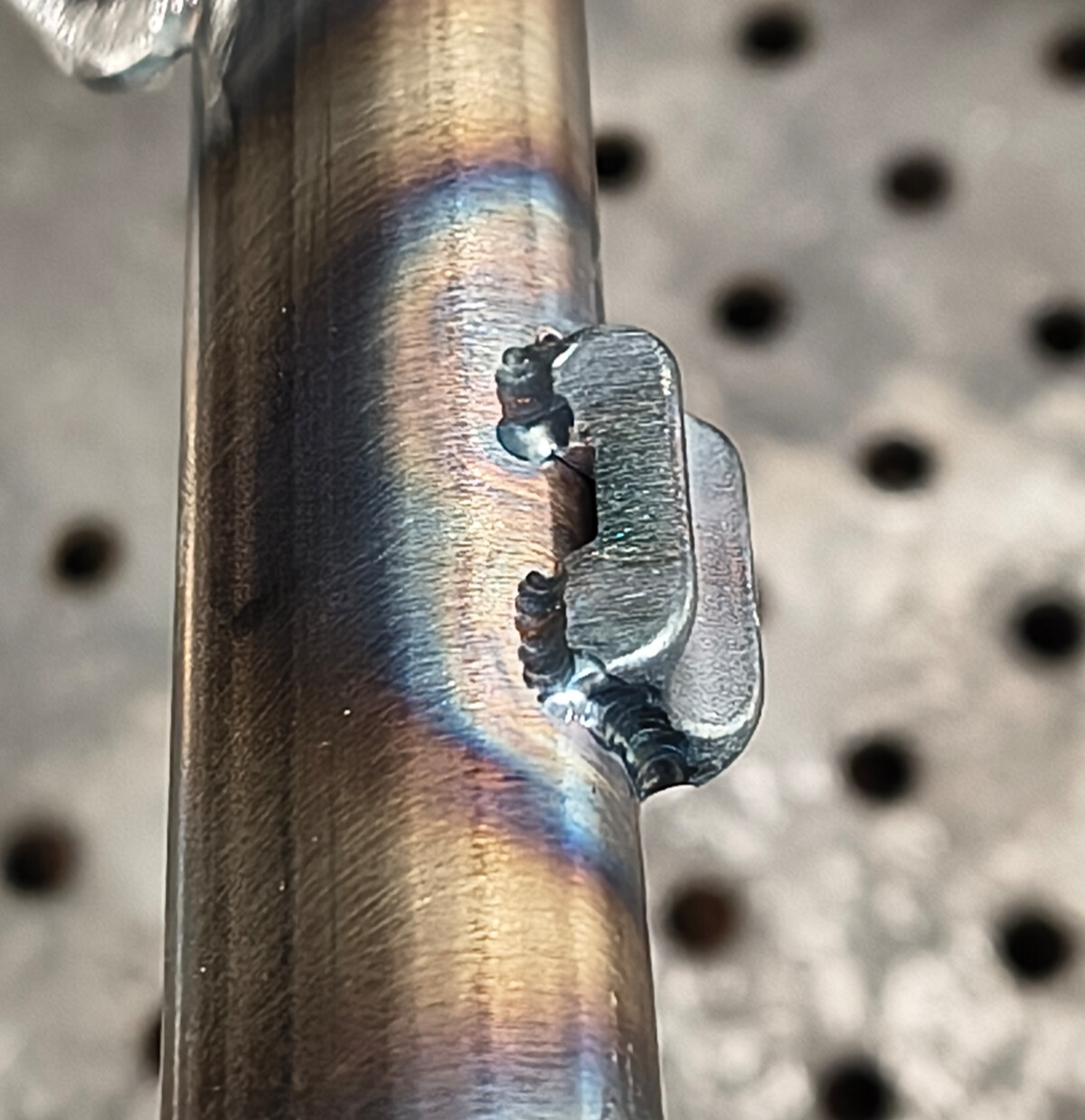

Here’s my example of fusion-welded cable guide on a chainstay:
Looks like you’ve done a nice job with that cable guide. If you’re fusion welding you want to wash some metal down from the thick part you’re attaching onto the thin tube.

Looking at the cable guide, you can see that the guide itself is undercut, but the tubing is not. So in that sense I don’t think there is much more to do, at least in this design. Well, maybe the ends could have gone without the weld, as they create a perpendicular stress riser to the tube…
I got a few of these fusion-weld cable guides, but I’m not sure if I will use them.

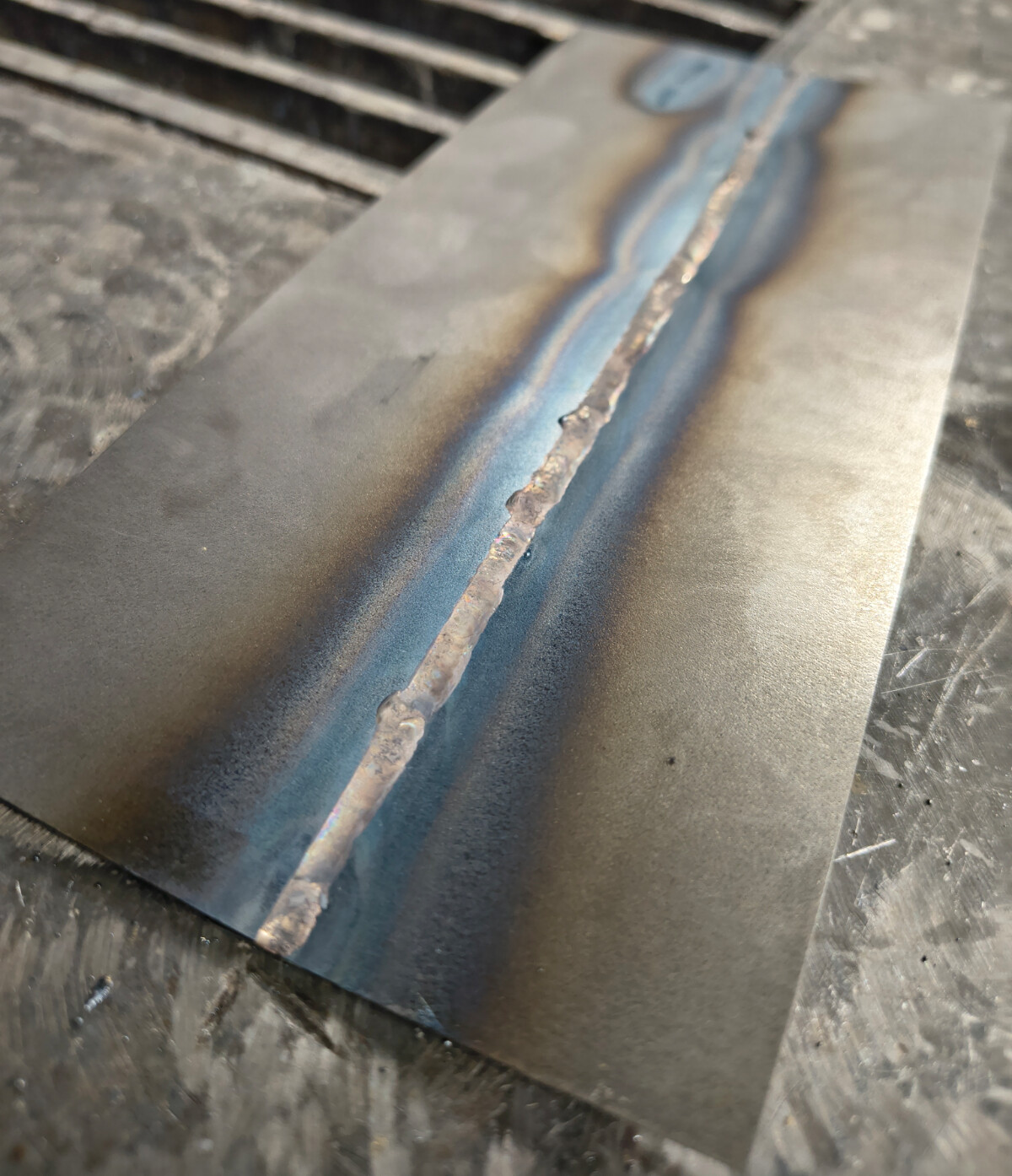

I also did a TIG brazing practice on some 1.0 mm coupons. While I think it is great for lap joints, it definitely did not flow between the pieces, as it would with flux and a torch.
I think you would have to create an external fillet with TIG brazing to rely on.
I used 1.2mm CuSi3 MIG-wire for this. I think it was pretty easy, as this was my first go.
Yes you always create an external fillet with it– a larger one than you would with TIG welding. So your bottle bosses will look a bit lumpy (like they would on an aluminium frame).
