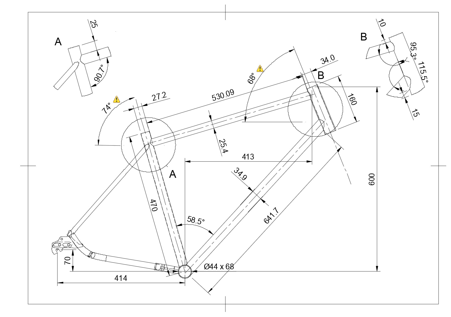

What a fun topic, Eva - and so to the point of some of the bikes I am trying to build! Very late to the discussion, but that’s not holding others back. Here goes.
In summary, I am a mountain biker and do not like how a traditional road bike handles, so I designed myself a gravel bike that I like to ride. It’s not unlike a Chamois Hagar or PVD’s Bird of Prey, but I took it in my own direction. Drop bars, yes. I maximize front center and use a 35mm stem and wide bars to counter any flop tendencies at low speed. The flip side is a bike that is so confident at speed or in the rough stuff. Room for a 160mm dropper or more is a must. I have tried to maximize tire clearance within the world of road components/dimensions, but I can’t justify using a yoke. Rather than suffer a 45 mm chainline I prefer to use a ~49 mm and more comfortably fit a chain stay, chainring, and tire into that space. For this chainline I am experimenting with a boost rear end, as I like to use the Eagle drivetrain in a mullet configuration. Better? To be determined
