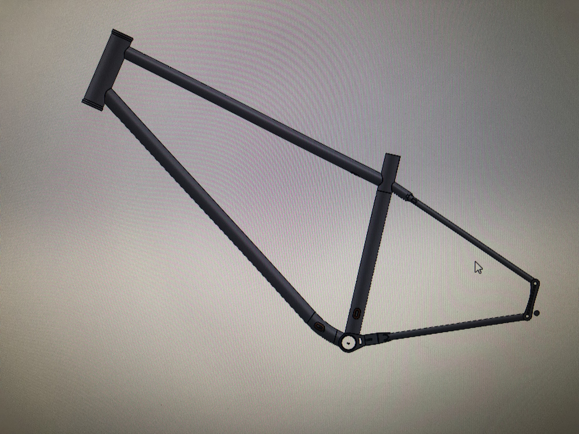

Hey everyone! Going to be making a run of frames for my dad, brother and I for bikepacking and trail riding. 140mm fork, 65 deg head angle, big 180mm headtube. Initially looking at using a 35mm .035mm 4130 DT that I’ll put a bend into. My thought was to give it a bit more flex loaded and over long ride days… Am I in the danger zone here? I figure the large HT should spread loads and the HT angle isnt nuts, and I know the riders and they wont be hucking any jumps (or just very small ones). Feedback appreciated! Thanks!
Looks like a fun frame.
Instinctively my first reaction is that a 35mm DT is pushing it for what looks like a pretty big frame triangle.
A skinny down tube may make the handling pretty noodly.
Especially if riding loaded with a combination of a long-ish fork and what looks like a rather long frame too. I don’t think that kind of flex contributes much to ride comfort.
I’d personally prefer to go with a skinny top tube and seat stays. You could even ovalise the TT which is widely regarded as providing more vertical compliance. Large volume, low pressure tyres will likely contibute more to comfort than any tube selection tuning anyway.
I’d encourage you to build one frame to test, then decide whether to go ahead with the other ones. That’s the most logical way to proceed when embarking on a project with more than a few unknowns.
If you want to play with tube diameters for comfort, I’d look at tweaking TT diameter before DT. For my designs, I like to go with a big diameter downtube and relatively smaller diameter TT. An oval toptube will also theoretically be able to give more comfort without sacrificing too much stiffness (pedalling).
What’s the bend in the downtube achieving?
Thank you both for the input! I moved up to a 41.3mm DT, no bend. Initially just really liked the bend on the DT for aesthetics and a smidge more room for a framebag.
