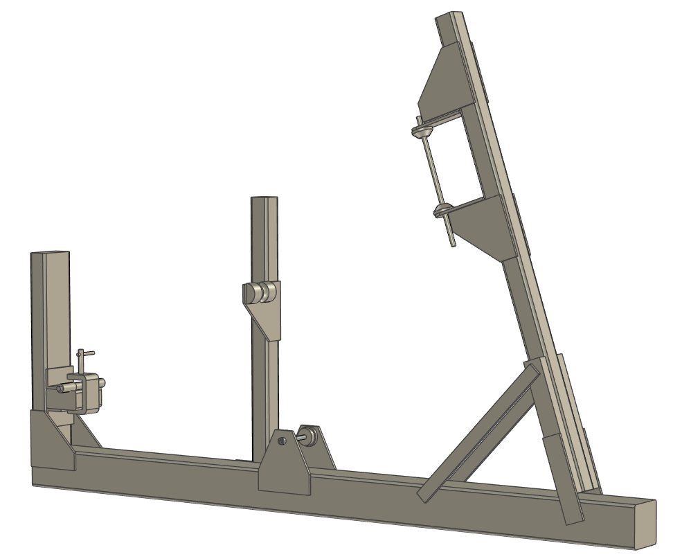

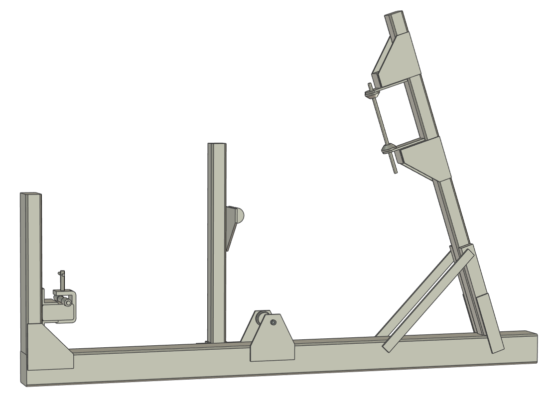

Last night finally had a eureka moment to how I will hold the head tube without having many expensive custom machined or lasercut pieces in my budget jig.
I know it wasn’t recommended to build a jig for my first frame but you know it’s a hobby and I felt like building it. It’s also based on a few tried and tested designs.
Quickly drew a simple representation of the jig, you’ll have to imagine the extrusions have all the usual slots etc.
Looked up the prices for the last bits I need and all in, this jig will cost me about €400 including what I’ve already spent on the base extrusions and including the cones for the head tube and puks for the BB and all the necessary hardware. (Oh except the little C clamp I still need to hold the dummy axle in the slot in the extrusion)
€226 in extrusions and associated hardware incl shipping
€48 in aluminium flat bar as struts and spacers for the head tube holder incl shipping
€100ish for the machined cones and puks incl shipping but not import cost
Even with the €60 dummy axle from Trichereau and the couple of M8 threaded rods and the C clamp it’s still below €500!
I’ll try to hold the seat tube with a PETG 3D printed piece, I can print that myself so doesn’t cost me anything and I hope if I keep it far enough from the lugs it shouldn’t melt or warp.
I’ve used mounting plates wherever possible because I feel like they really keep tolerances pretty tight by tightly clamping everything.
Most important part for me is that with this design I can draw my frame in the jig in CAD and easily use the numbers from my cad to set up the jig.
Oh and there should be plenty pf clearance everywhere to get in with the torch and fully braze any joint I want in the jig. Just gotta watch out I don’t melt the nearest aluminium :rofl:
Of course you should build your own jig :slight_smile:
I attach BB to ST, then CS to BB first, just using blocks clamped to the table. Then all my jig has to do is hold the HT relative to the ST. For simplicity, the ST is always vertical, and you just set the HT to whatever the difference in angle is (using the usual Chinese digital level box).
You don’t really need any machined or laser cut pieces except some cones or similar to hold onto the tubes. Just make sure everything is perfectly aligned (string to check the dropouts are equally spaced from the centre line, and the “eyecrometer” to check the HT and ST are parallel are good enough) before you start tacking.
I’ve tried using laser levels to check the HT/ST are parallel. You get it so both are perfectly vertical. But then you look at them by eye (down the frame from the front) and you can see a slight error. You correct that, check again with the laser, and it will still look perfect. Conclusion: the eye is more accurate.
What is the reason for doing part of it on the table? Isn’t it harder to get access with the torch all the way around?
Not that I have any other option than a single jig that holds everything in a compact footprint with my crowded 16 m² garage haha.
I’m looking forward to seeing whether it all really works like I hope it will. If it works as well as I hope it does I’ll share all the details so anyone can make a copy, I think I’ve managed to make a very accessible and affordable version of this design.

I have thought of converting my fixture to something like you have drawn there. It seems to be a better way to get everything lined up in the vertical plane with different sized shells. Using a self-centering vise to hold the BB shell is a great approach. Aligning and fixing the center of the vise to the center line allows you to simply open it up and stick in whatever width shell you’re using and know that’s clamped in line to the center of the frame. As it clamps, it centers the shell on the center plane of the frame. I don’t know the repeatability of the cheaper self-center vises but it seems like a good way to handle that part.
A self-centering vise sounds like a perfect future improvement!
Right now it’s just two fixed plates, in between those I’ll put little machined puks with a fixed spacing through which a threaded rod runs to clamp it all together and it’s limited to whatever will fit in between them which is realistically a 73mm shell.

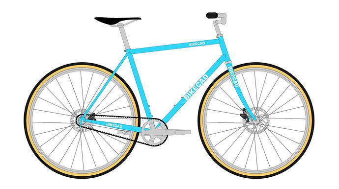

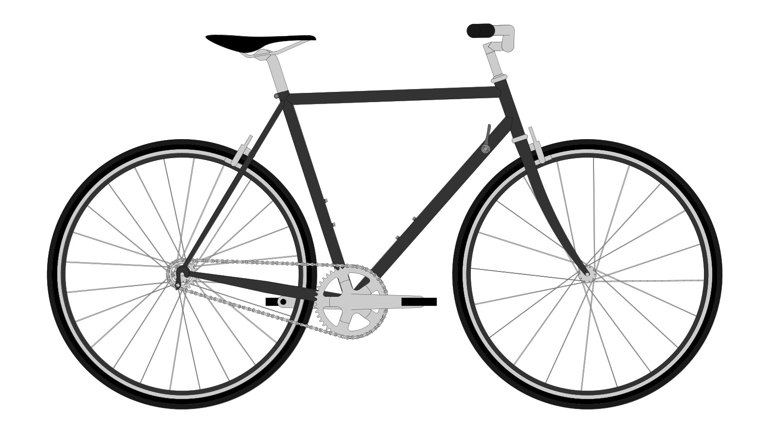

Quick updated bikecad visualisation for planned frame #1 and if the rear is stiff enough for a belt drive, planned frame #2.
Might put gears on #1, not sure, doesn’t matter I’ll just use semi horizontal dropouts anyway to have both options.
