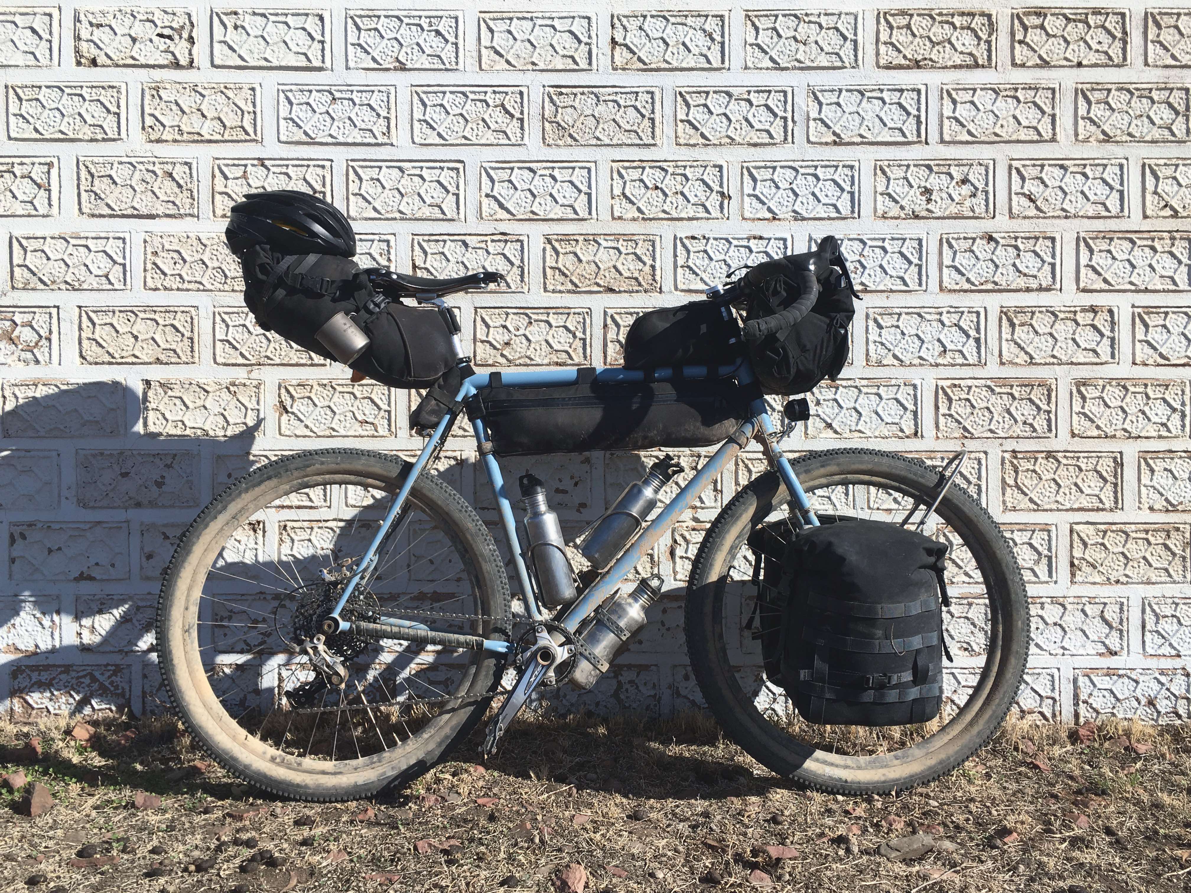

I’ve had the same experience regarding over weighted fork (pics below). Even with low trail you need to adjust to the handling. It’s a less than optimal setup in my experience. A balanced/centralized load is the way to go!
Get get a framebag and move the water bottles elsewhere if needed. I prefer a wedgie shape framie with a seat tube bottle if space allows. I find it’s the easier bottle to reach and less chance of leg rub when you inevitably over-stuff the bag haha. Fork bags for light things like sleeping mats, bags and puffer are good too.
If you can get away going rack-less then that’s the way to go, however I’ve had good luck lately running a lightweight rear rack and small (8L) panniers on bikes that have a dropper post. Below is a light(ish) touring setup I used recently. 1 month/2000 km trip in Tasmania/luruwita, AU. Yes it’s a hardtail but I was mostly riding gravel roads (stopping to unload and ride park/trail every week or so). First time I’ve had a setup that I would 100% run again.
