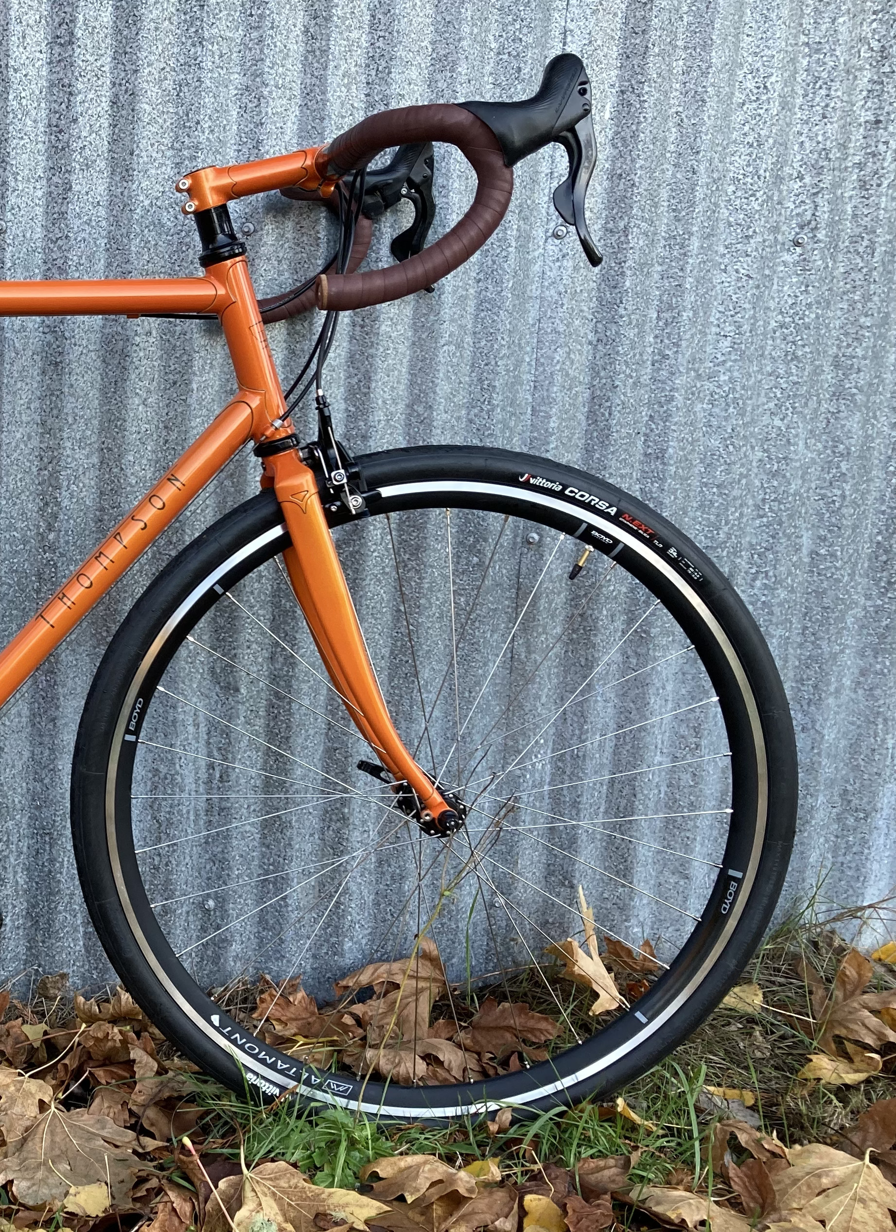

Hey folks, has anyone turned up any new fork options? I’m planning a “road plus” or all-road build - goal is to fit a 34C tire. Planning to stick to QR wheels. I’ve drunk the kool-aid and ordered a set of Grand Cru mid-reach calipers. Still not seeing a lot of options for new forks. The Whiskey No7 RD+ QR still looks like the most obvious option. Seven cycles seems to have made a “PureRoad Medium Reach” but aside from being very pricey I’m not sure if it’s currently available. Any other suggestions - either new or Ebay? I’m open to metal forks, but a old-school skinny raked steel fork wouldn’t suit aesthetically.
The Whisky and Seven are the only carbon options and I believe both are discontinued.
You could get a custom length Wound Up Fork made but it’s not far off aesthetically from a classic 28/20 steel fork blade.
If you’re open to a steel fork I would suggest getting the Columbus Max Fork Blades. They are 36mm deep and look much more modern.

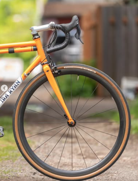

Beautiful!
I’m currently building myself a road bike with 48mm 650b wheels, disc brakes and friction shifters, but this makes me think I may have gone too “gravel” ![]()
Thanks for the hints, guys. The Whisky No7 is still my top candidate, I think, but I’m coming back around to the idea of a steel for for future builds. I do like the Columbus Max blades.The Wound Up forks look pretty awesome actually… Anyone have experience riding them?
Gorgeous! How do you like the rim brake / 34C setup… does it align with your expectations?
That is a very nice look, actually.
