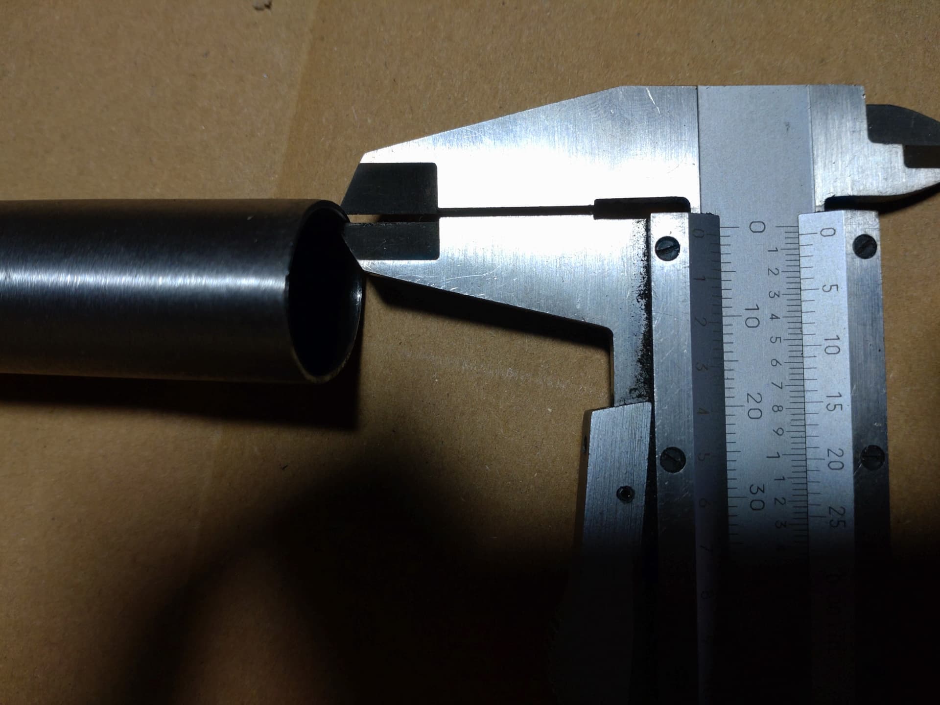

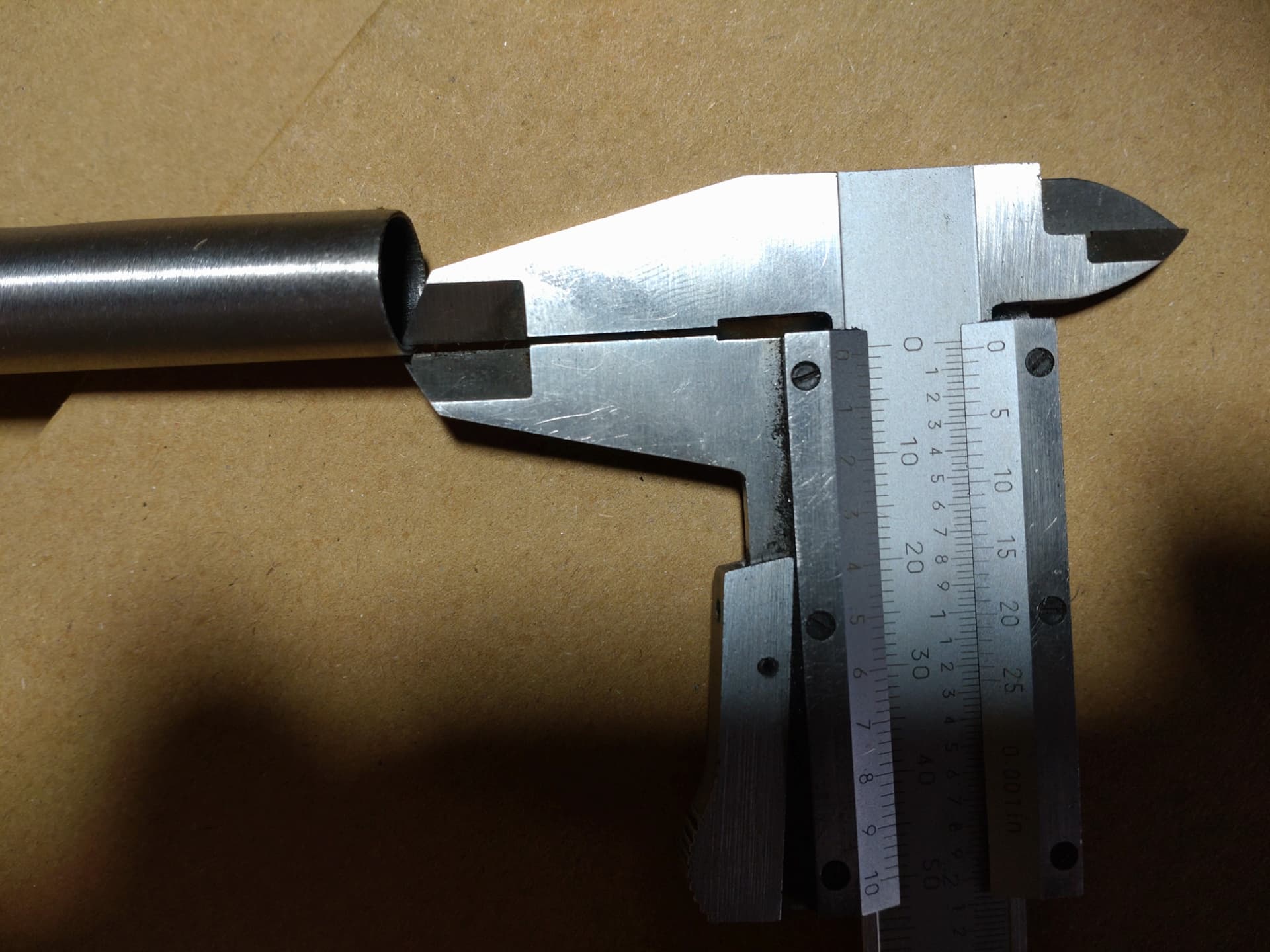

Well I have some EX5707s here. They do look a bit thinner at the bottom end, and seem to measure about 0.7mm, but there’s a bit of burring, and the usual black stuff on the inside.
Actually I have noticed before that Columbus stays (I think they were Cromor) seemed much thicker at the tapered end than Reynolds ones.
Bottom:
Top:

All the tapered tubes start out as round tubes. AS they ‘squash’ it down the taper the material has to go somewhere. As the taper diameter drops the wall thickness goes up.
