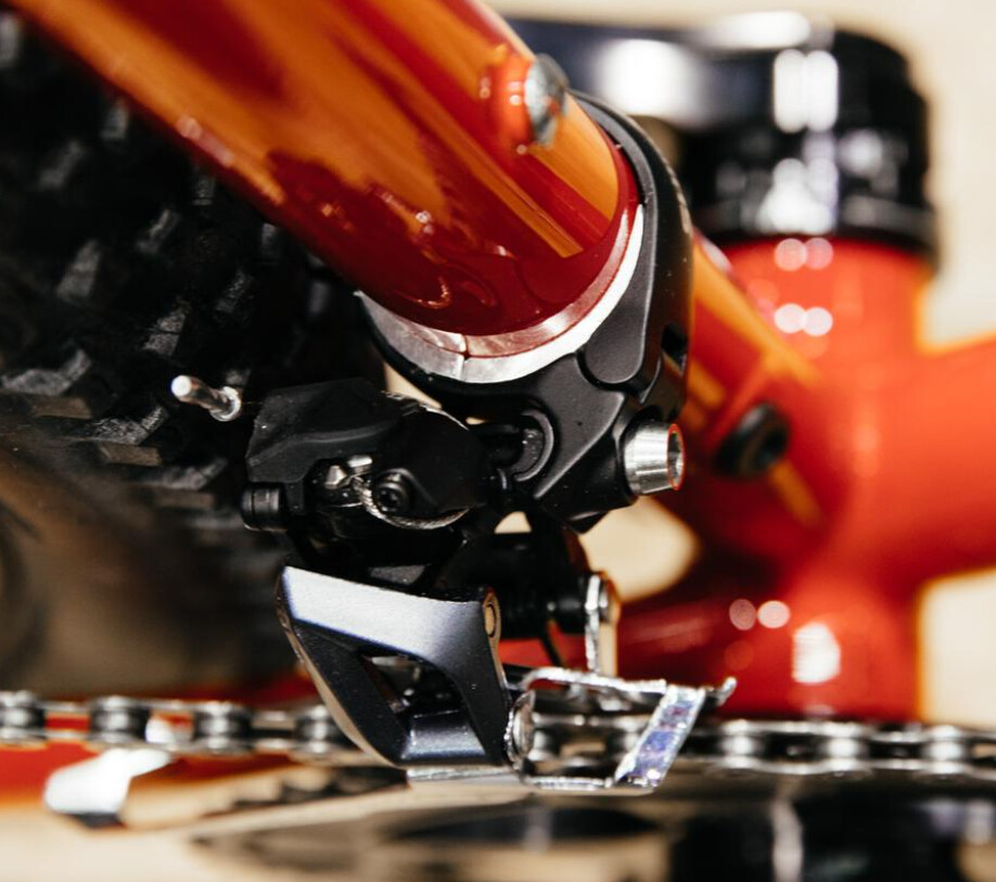

What I was confused about for a very long time, is how the GRX front derailleur is working. For all intents and purposes, it’s a road derailleur, albeit sitting 2.5mm outwards.
The answer seems to be the Cutthroat’s “road boost” FD mount, which moves the FD further out to the boost chainline.
If my assumption is correct, then this little piece of metal is genius. It could, if the frame had the space for it, allow someone to run a full-on road groupset, on a boost spaced MTB.

Another great solution is this Jtek Eccentric Front Mech Shim. You simply use a 34.9mm clamp on a 28.6mm seattube. They don’t state the offset it allows but I’m sure it’ll get you there.
Todd from Black Cat made his own on the 2019 NAHBS bike below!
