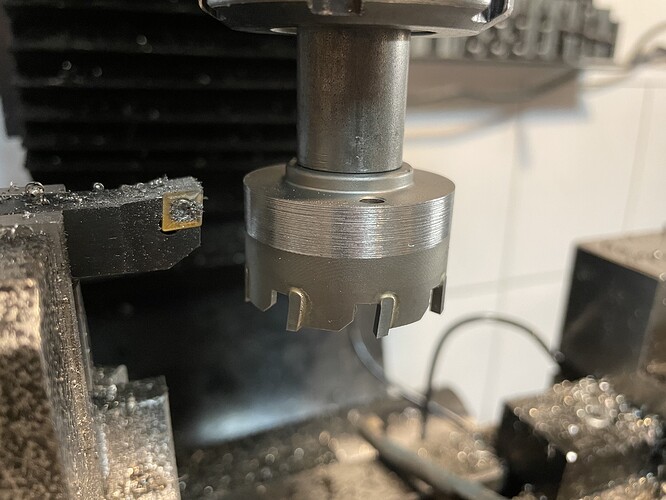

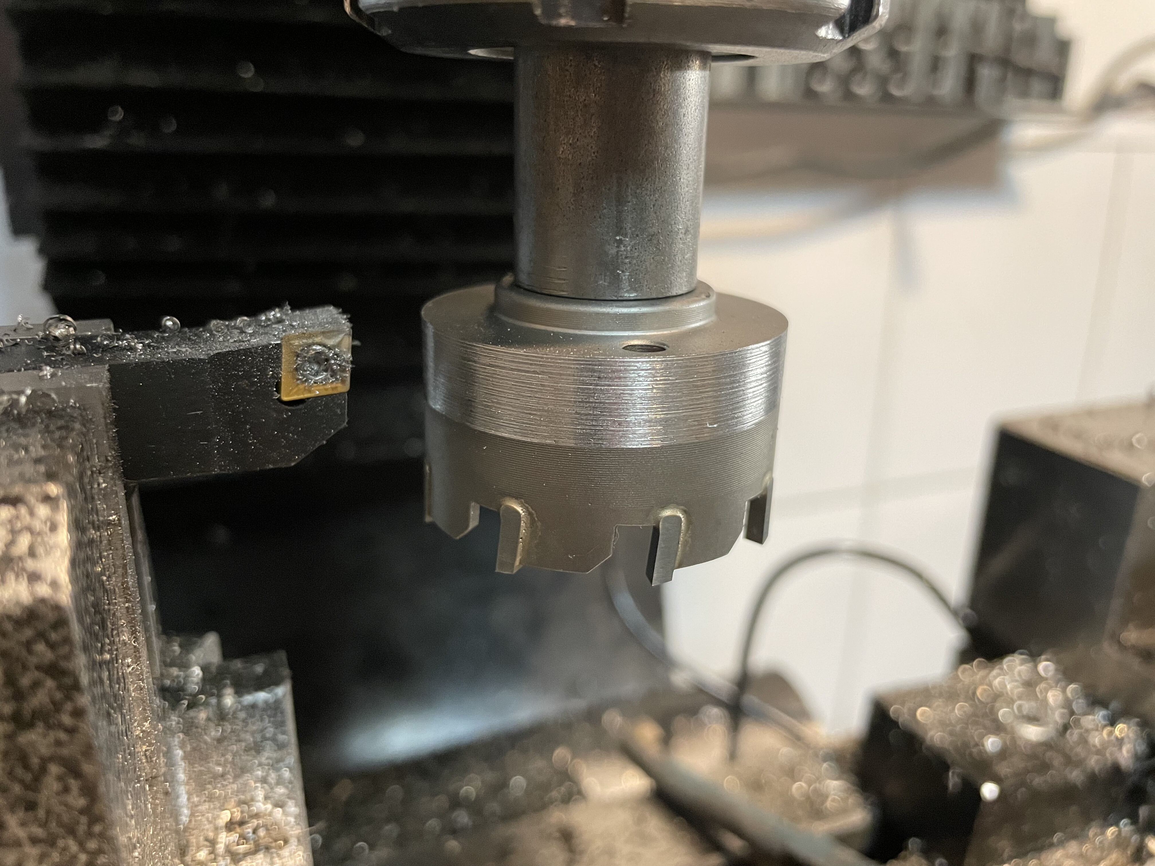

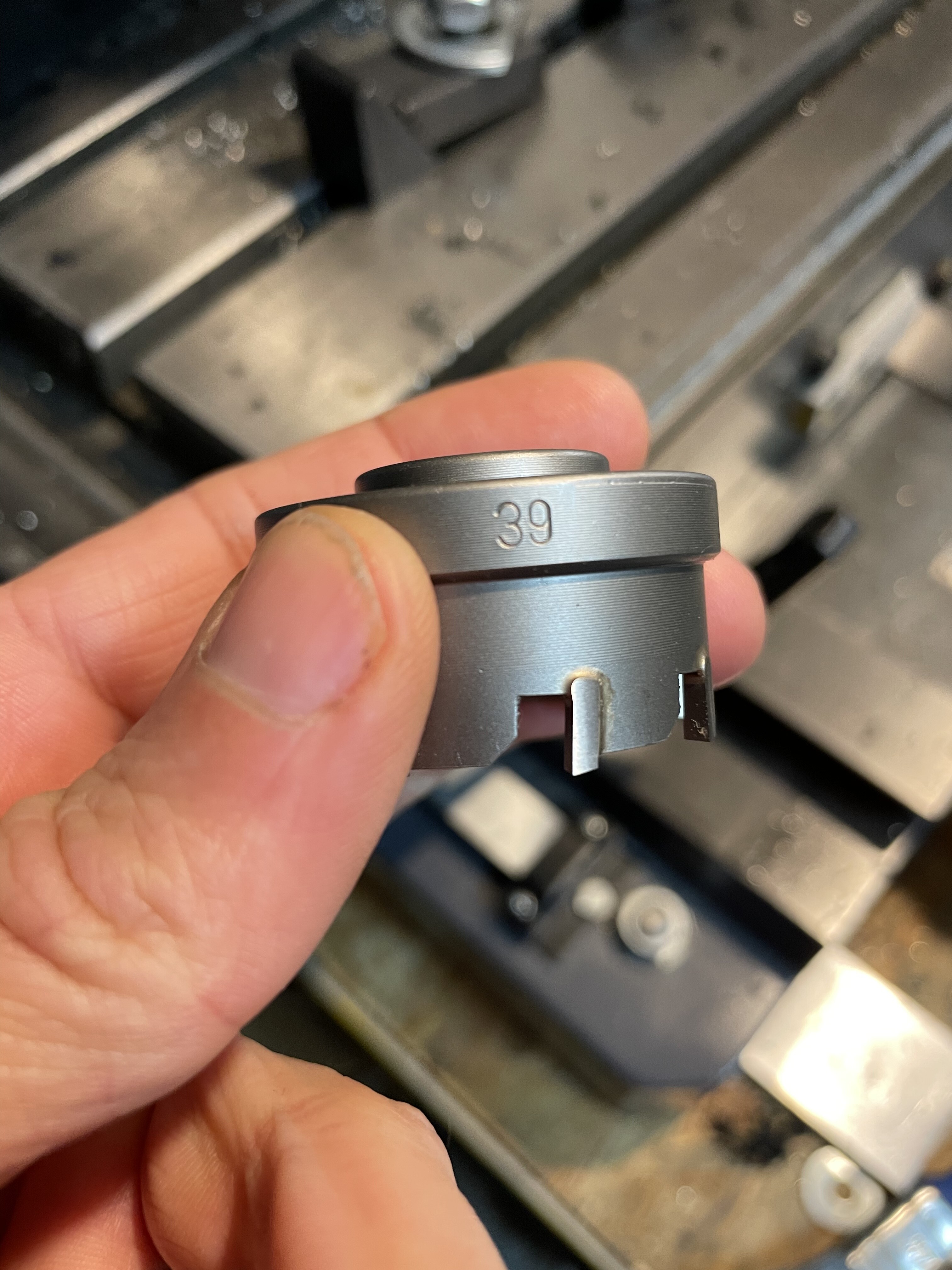

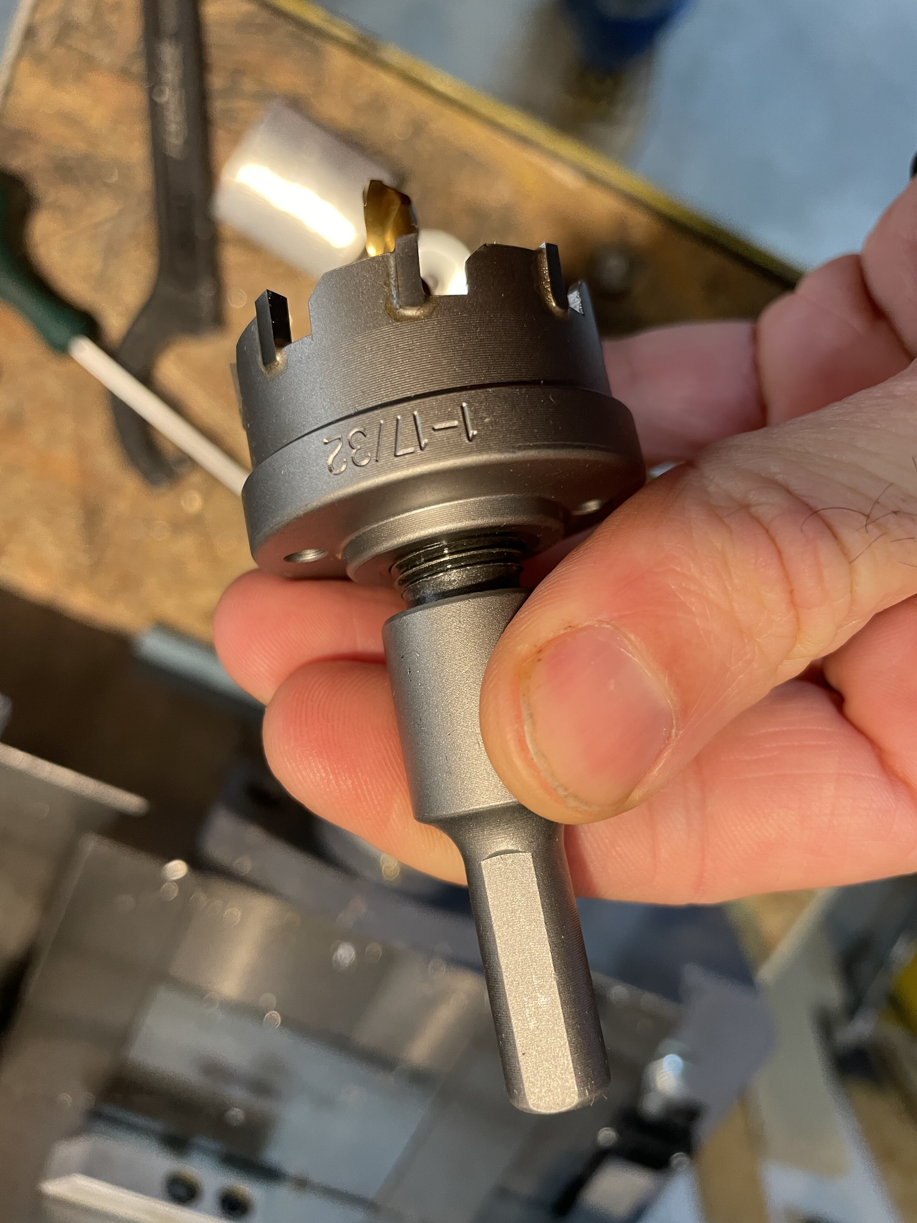

Actually I Just came across this problem. I also have eu made bsa BBs. And there is a solution: starret makes this one in 39mm. You just need to get rid of the rim.

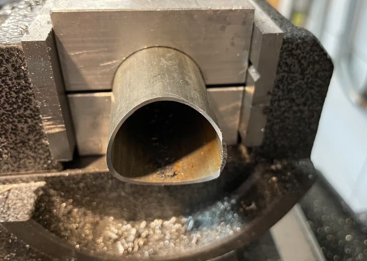

Thats what I would think if I did not test it. It actually cuts pretty good (and much better than I’d expect). I’ve tried higher rpms ~600 to 930. This tube in the pic is 0,8mm (just scrap beeing test cut so it’s not even centered).
I guess the thing is - a wholesaw of this tpi would probably rip the tube apart. But: this is not a wholesaw. The difference is that a wholesaw is never round, so it needs to be high tpi not to catch material. This one has teeth that are brazed and than sharpened so each of them follows the same circle thus greatly reducing risk of cathing. They are like lathe knives.
Only problem is that this things’ thread is just a bit different and it does not fit paragon arbours.

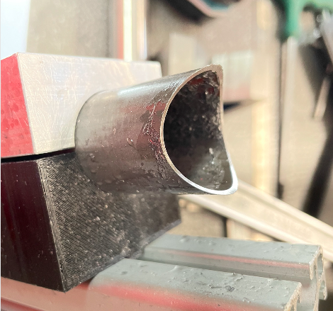

Edit: one more thing. For those who are concerned about heat and might want to research this further: when using regular wholesaws oil is burning. Here - no smoke at all, so my guess is there is less heat. Just cut this one:

Would be an other solution to skim off 1mm of the bb. To 38mm?

I am glad it works, it looks like a really nice solution. Was this the one you got?
https://www.starrett.com/metrology/product-detail/SM39
Is that without coolant?
More less this one. Now I’ve figured out that there is one version for deeper cutting (I got the shallow one of course and had to cut in 2 go’s…).

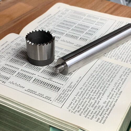

I use these hole saws: https://www.ultratools.fr/Fine-pitch.php Fine pitch (10 tpi) in imperial sizes. Downside: they are shipped from the factory in India, so much additional costs. But make very nice and fitting cuts. Bimetall-Lochsägen HSSE-Co 8 mit Feinverzahnung 126057 | Lochsägen makes fine pitch holesaws, too.
