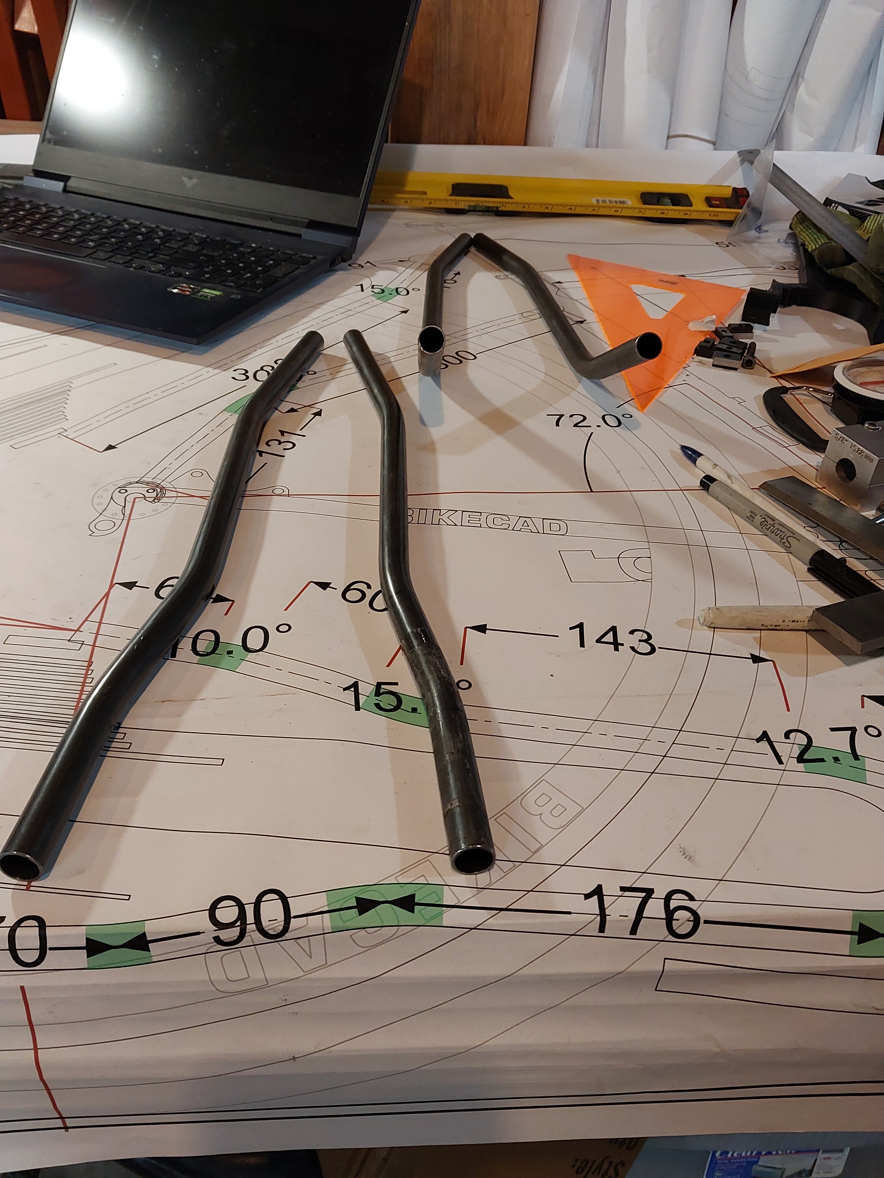

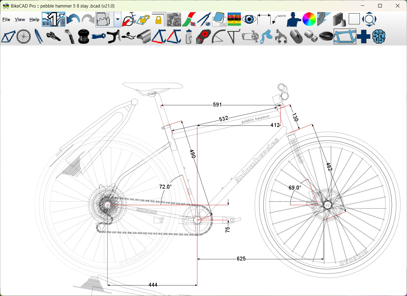

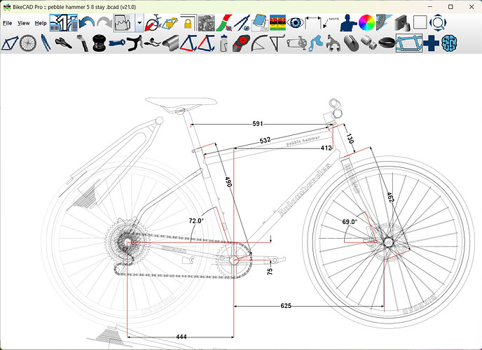

So I am making a gravel hack bike..( old rocky mtn hammer race front triangle) the back end of this bike had a accident back in the day so I just cut it off.. I have some 5/8 straight gage that I usually use for seat stays that is 0.035 thick and I have some that is 0.049 that have gone on a bmx race bike for chain stays.

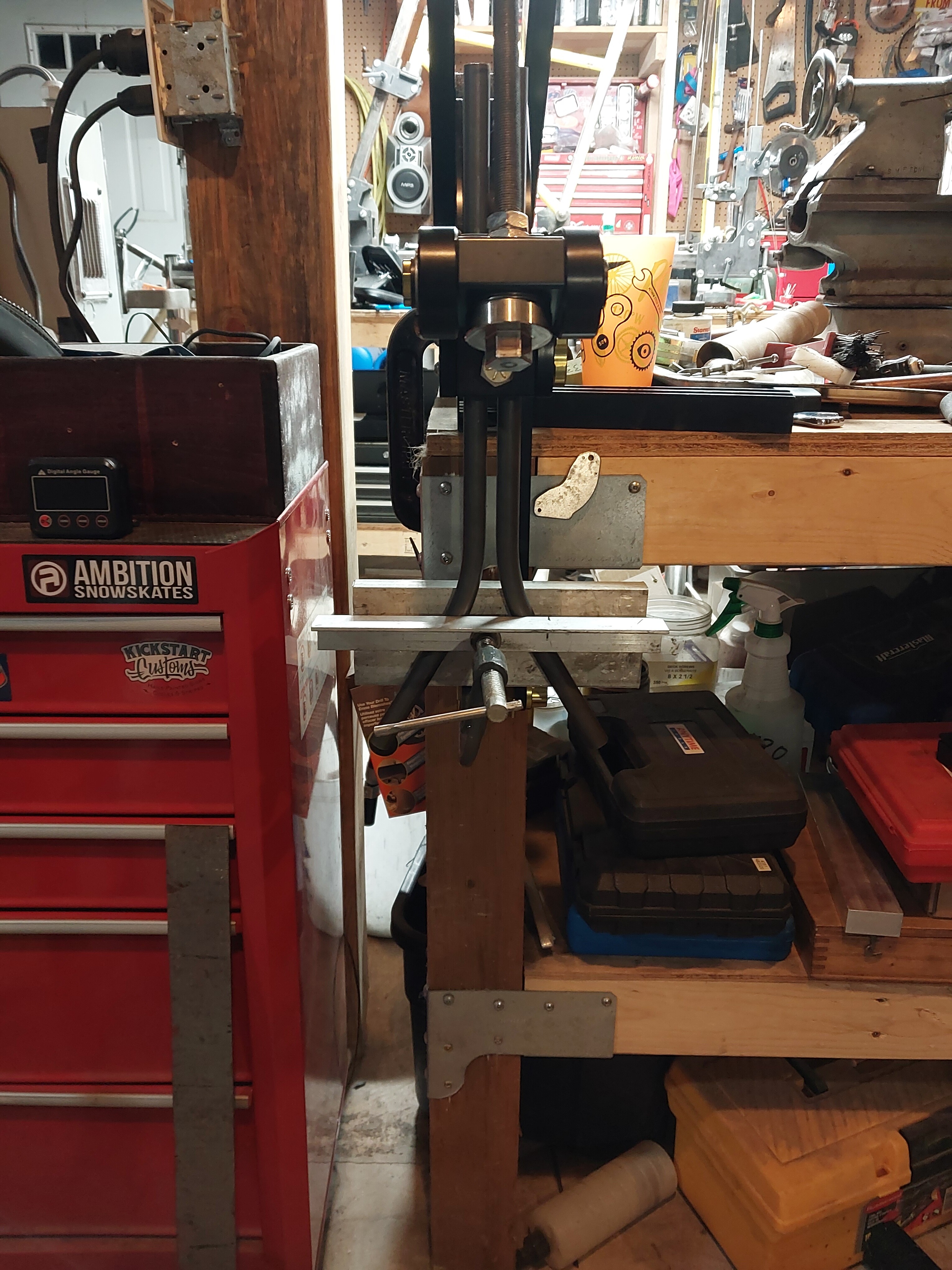

do you think the 5/8 x 0.049 would be sufficient enough for chain stays on a 1990 mtn bike…cough I mean a gravel bike. haha are they are kind of the same ?? I also have the dies on my cobra toob bender for this tube, so it makes it easy to do what the heck I want and not be stuck with stock tube bends any thoughts

not my first rodeo modding a frame but my first gravel bike back end.. just don’t want it to be to much a noodle.. the 0.049/ 1.24 mm thick tubes are stiff!! but at 444 mm length stays and regular qr rear wheel just wondering if it will wonder.. I am also 6’2” 170lbs and raced/ jumped most bikes.
the frame will be tig welded or brazed if it feels best to do..

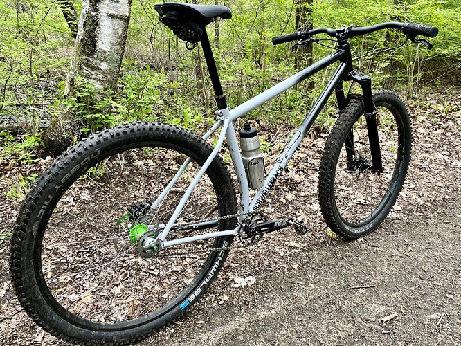

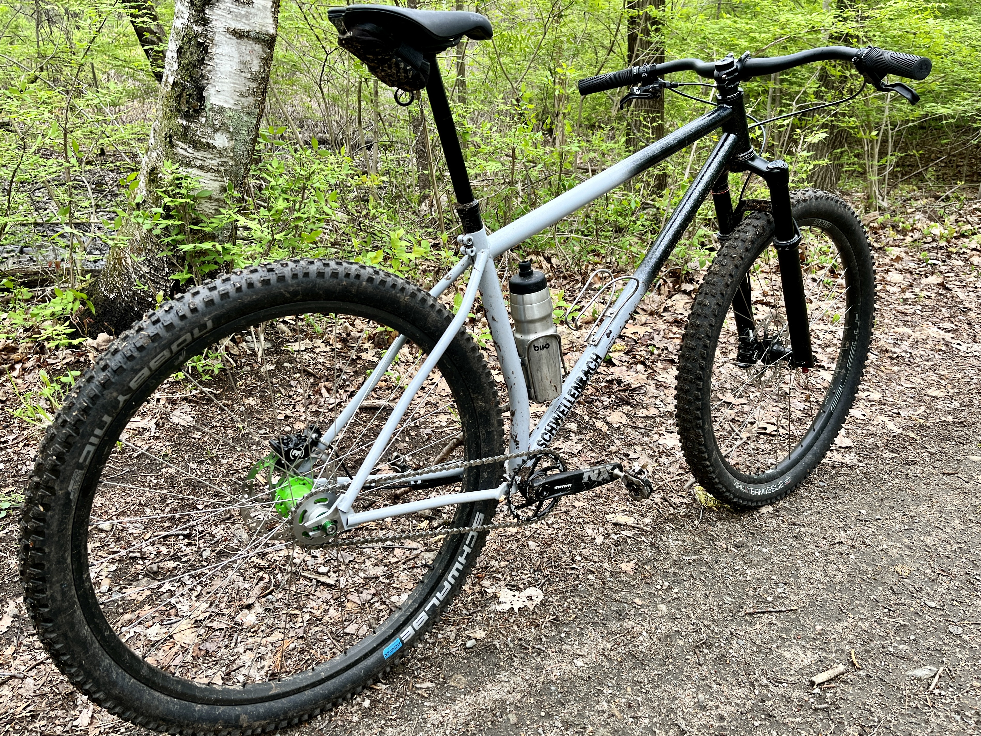

I’ve built two single speed mountain bikes with 5/8” x .035” 4130 stays. I’ve ridden both very hard over two+ seasons without any issues.
The second bike I made was a long-low-slack hardtail on which I used the fairly lightweight Zona tubes. The chainstays are 0.8mm wall and 22.2mm diameter (which is .032 and 7/8in). Regular CrMo, cold-drawn seamless. Its owner has been happily smashing it down big rock gardens in the North West of England with no issues.
so ya I think I will slap in some 5/8 x 0.049 stays in there and see what happens It might be nice for dent resistance.
