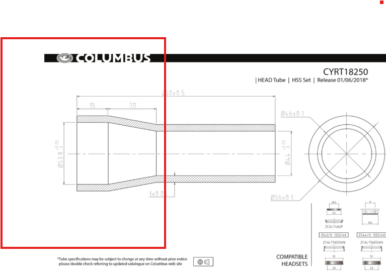

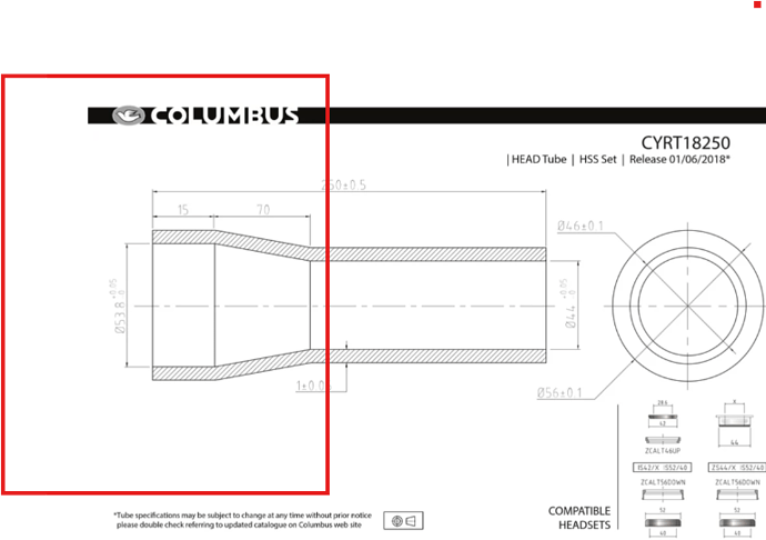

But I think for my next frame would like CUT and braze 2x 56mm down section together :smile:

Here you can find one.
