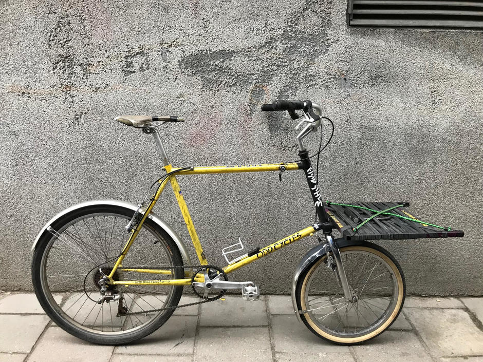

Ahh fair enough then. Sounds like an annoying system. I wonder if the platform could fold vertically out of the way you’d have more luck. Would be an easy enough modification to do on the Omnium or DIY a frame. Something like this.
Another option is a more compact bike like the Omnium Mini. Similar to the Clydesdale but the load is fixed to the frame which makes it a hell of a lot more stable. A DIY example I found.
Frame mounted front rack is definitely interesting, will keep it in mind for a bike frame build! So far I am collecting all the bits and pieces for the tig setup. Still deciding which protective clothing to get, where to store the argon and organizing some scrap metal to start practicing.
