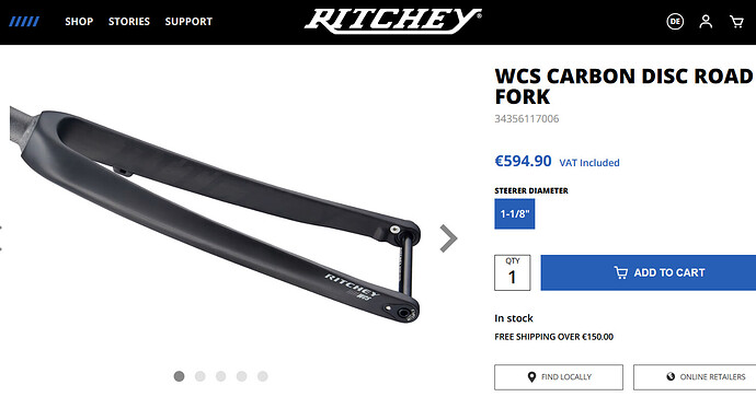

So fortune or not. I manged to buy a slightly used Ritchey Carbon fork for 150€ which marks the start of the project and also defines a lot on how the frame has to look like.

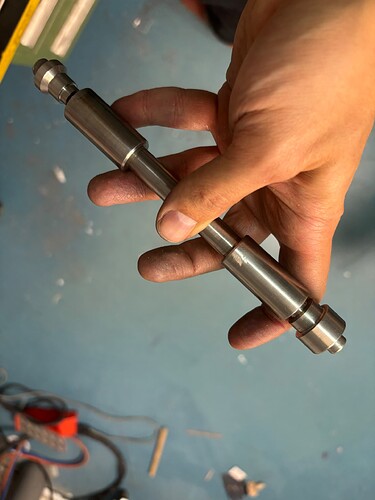

First step: as always build some jigs or make some adapters. This time I need some dummy axle adapters to make the syntace dropouts fit my LCFF jig.

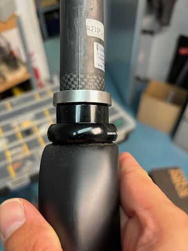

Actually the plan is to go with some reinforcement rings on the headtube to make it a smoother transition to the headset. Looks like below. Distance between fork and headset could be a bit less but otherwise I think the transition looks quite good. Headset choice is a bit limited with the integrated crown race as I have to go for a headset with 45° bearing.
I also thought about the tapered headtube IS42/EC42. However, I don’t like the looks too much (would prefer IS42 straight then) and I would still need a reamer. And for the IS standard I guess its a must as you also have to do the 45° chamfer.

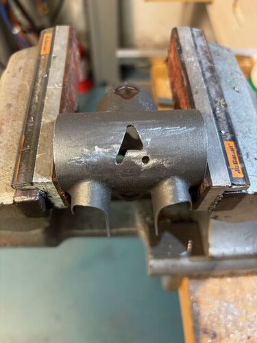

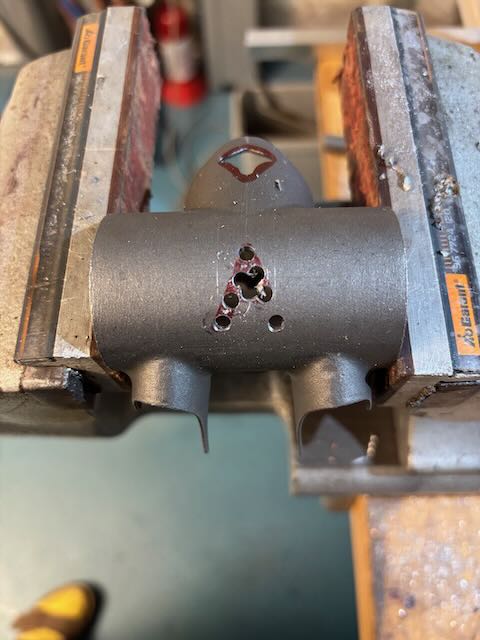

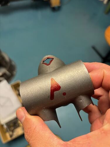

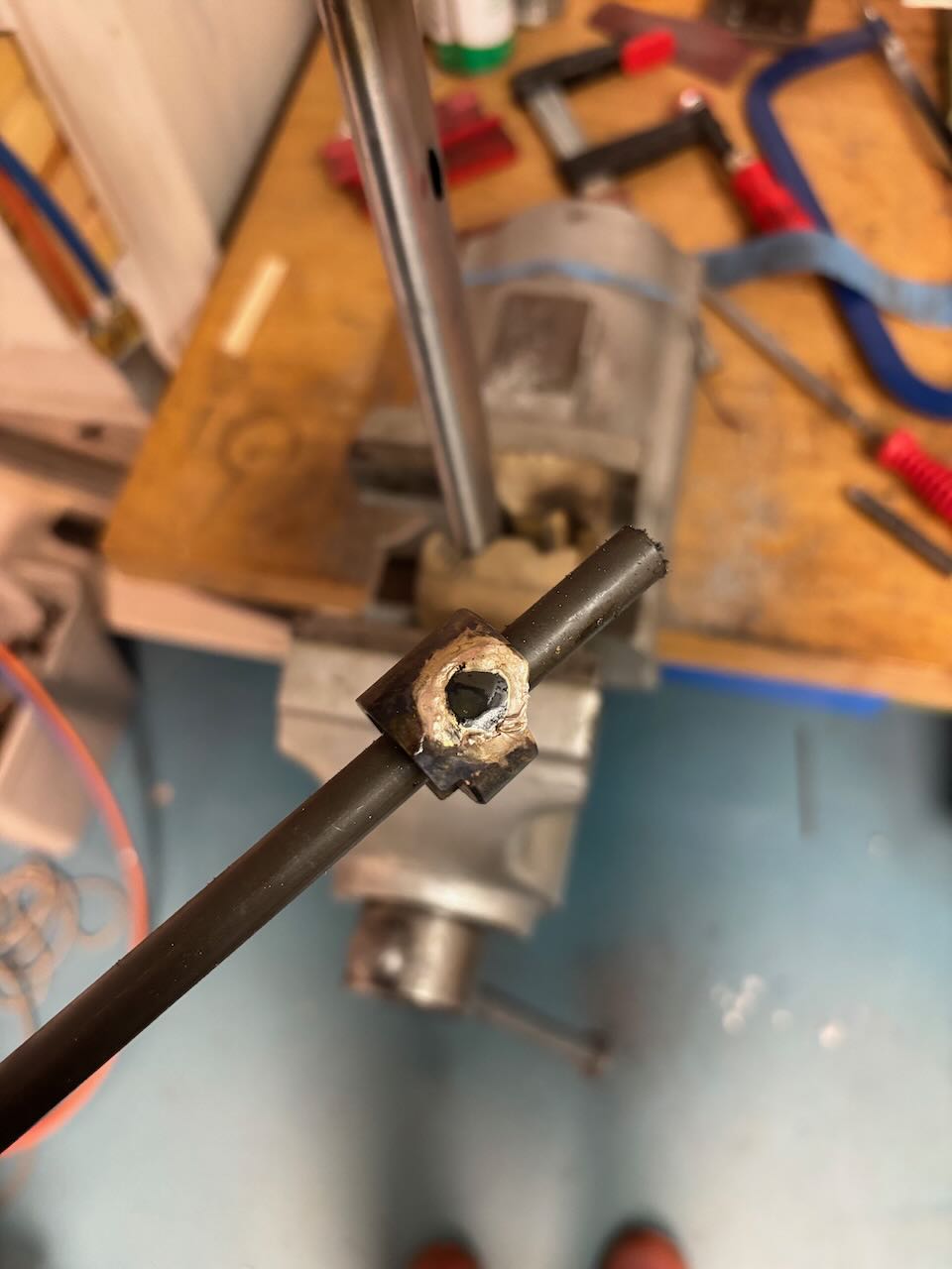

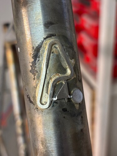

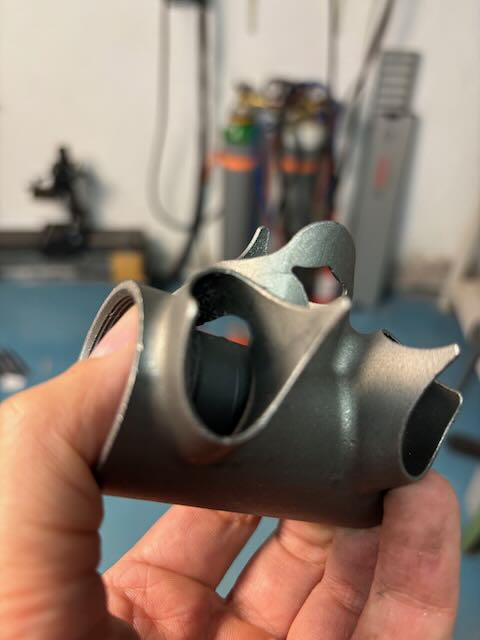

Ok - little progress. I decided to go for the 36mm headtube, a 35mm downtube and a lugged bottom bracket where I hope to get the brake hose routed through from the DT into the chainstay through a little notch in the lug. Also the lug needed some windows and a logo so I did some drilling and filing.

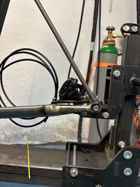

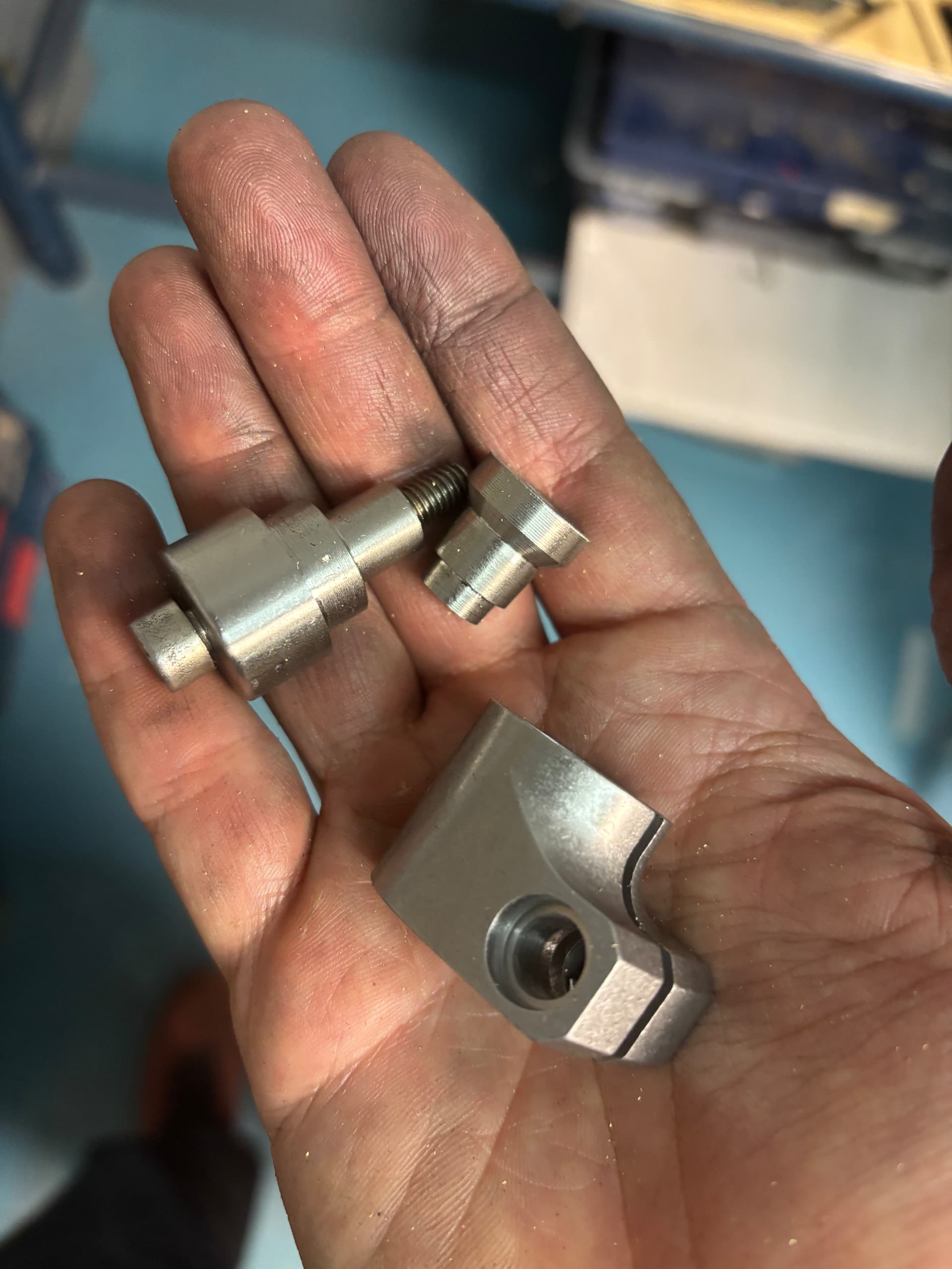

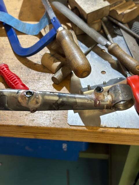

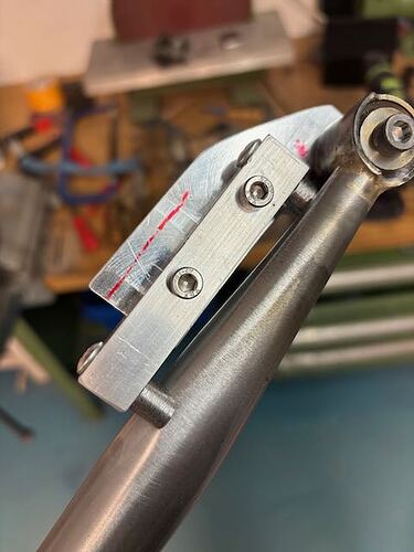

Handmade some tiny bosses for the flatmount attachement out of stainless and silver brazed them on. Everything quite tight with 140mm rotors - had to dimple the chainstay a bit and the seatstay should just fit above the caliper.

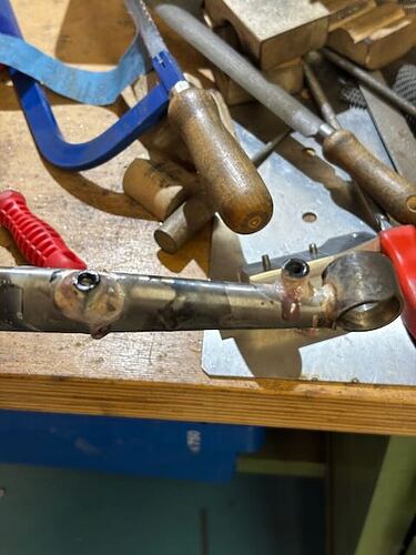

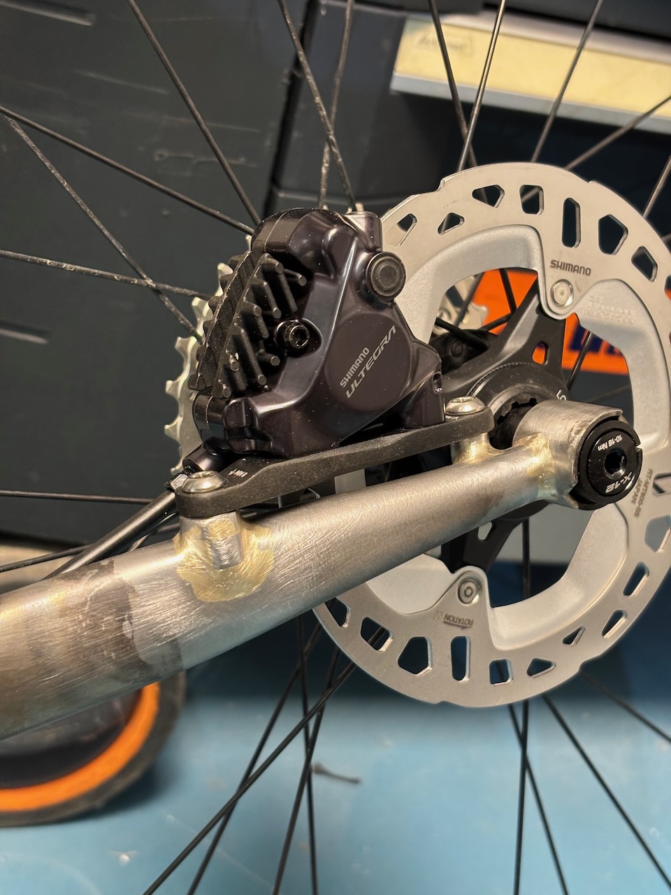

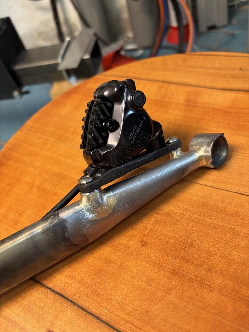

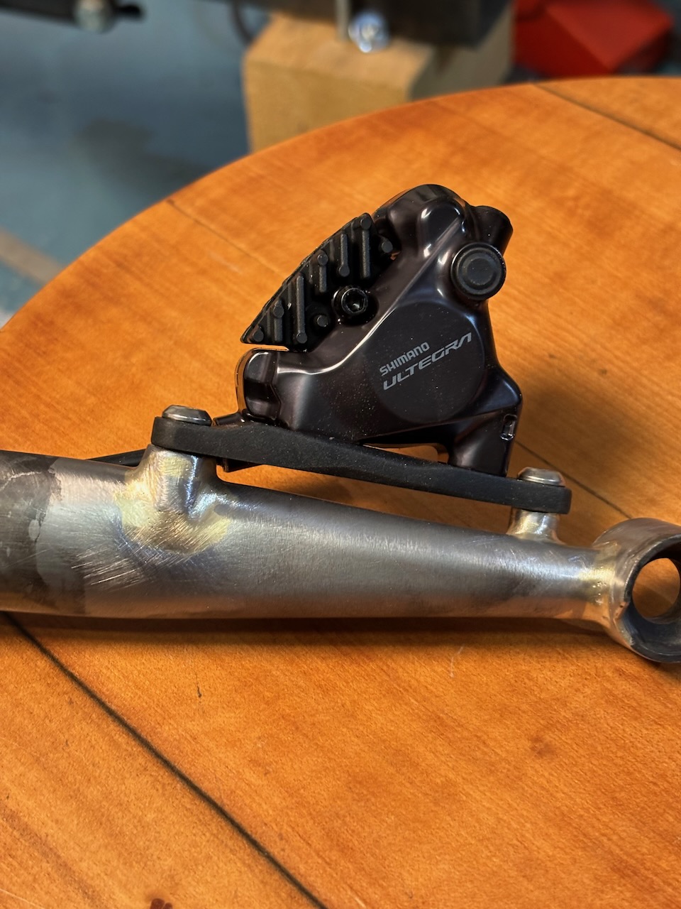

Celebration was too early….Created something for the fail gallery. When I designed the jig for the flatmount bosses out of the flatmount front spec I overlooked that the disc is located nearer to the dropout in the front compared to the rear. So I essentially created a nice fork leg…. For the chainstay the bosses are located about 8mm too far to the outside.

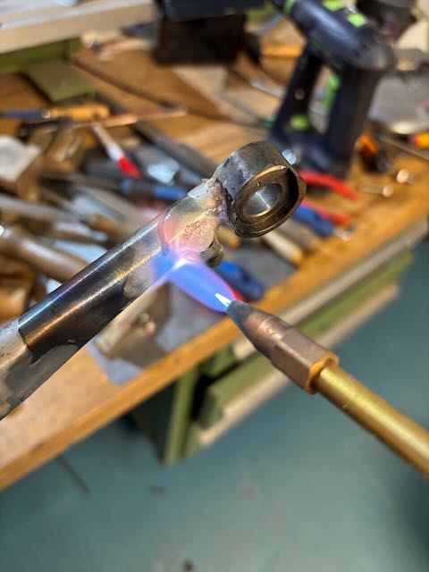

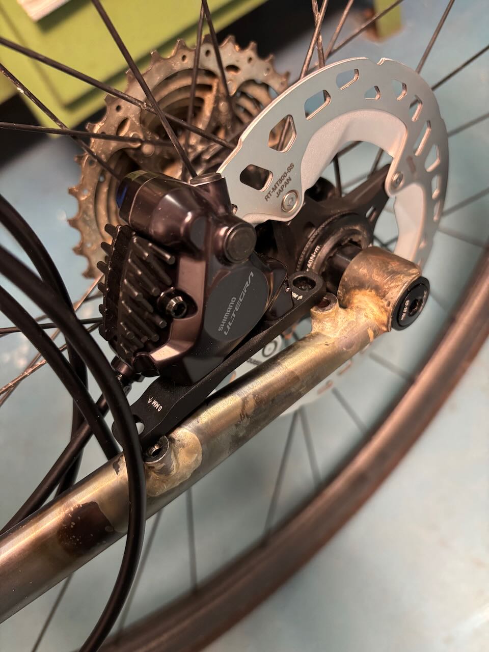

So after a lot of thinking I de-brazed the dropout (34% silver - so not a super big deal and not much heat for the tube) and it looks that it might work if I only reattach the chainstay fully to the inside of the dropout…. wish me luck…
I know it’s too late now but I’d have been tempted to bump up a rotor size, and machine an adapter that got you enough room to bring the calliper back inline. To keep the alignment correct, you’ll have to move the stay over the same amount at the dropout end and BB end. Or is that what you plan to do?
I thought about an adapter but was worried about the twist as the brake center would be quite a bit away from the chain stay center. Also disliked the thought of another adapter….
Actually I plan to move only inwards on the dropout and have to keep the BB the same (Lug!!) - it will cost some tire clearance - I can live with that. And the brake bosses will not be perfectly center lined -but the standard-adapter allow for something like 4mm left and right at each bolt. So I guess it won’t matter much… But so far all assumptions from ligning the stuff by hand and in the jig…

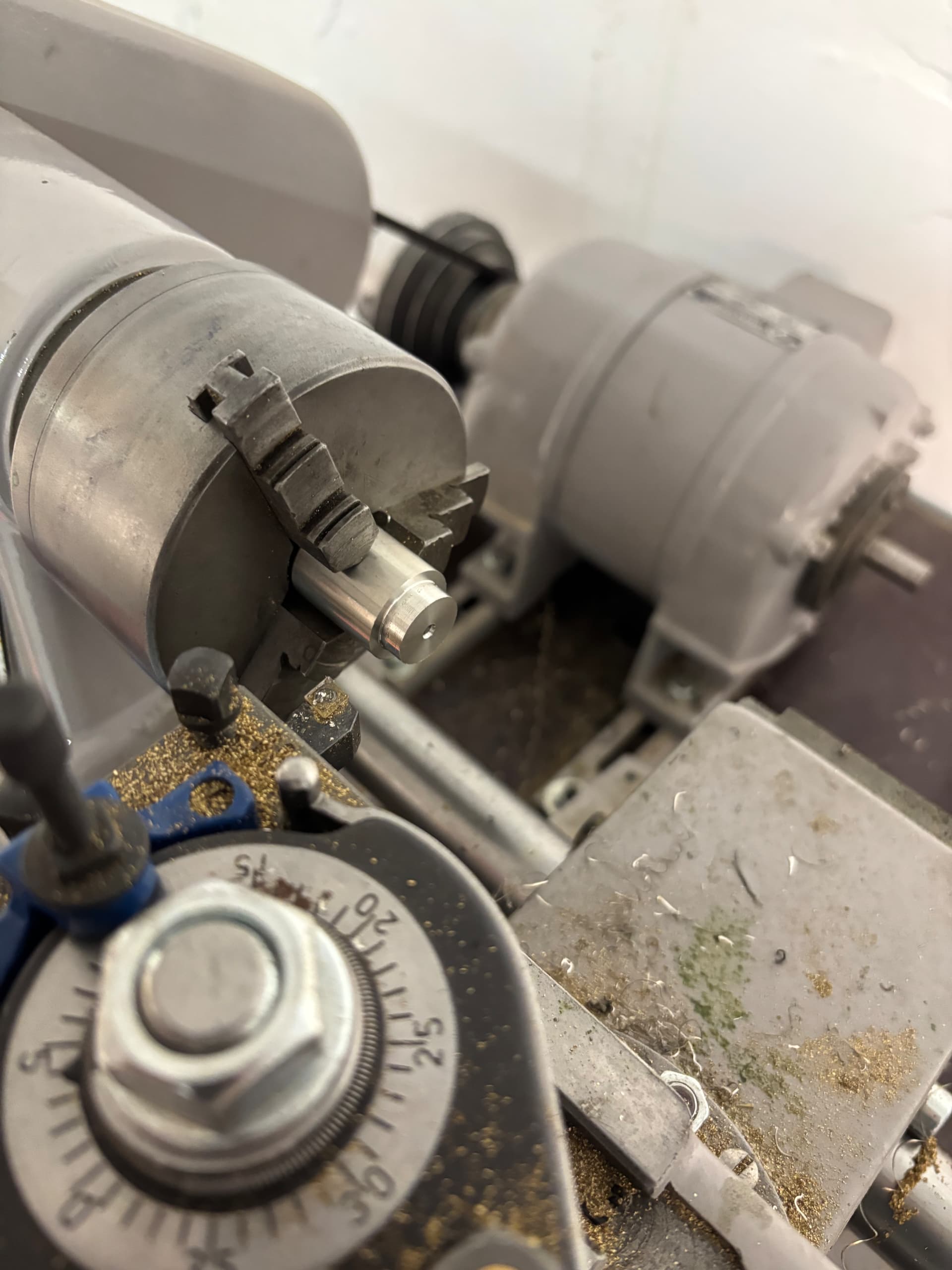

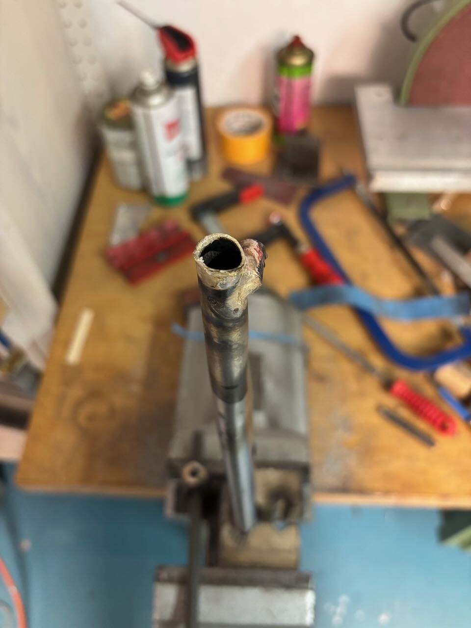

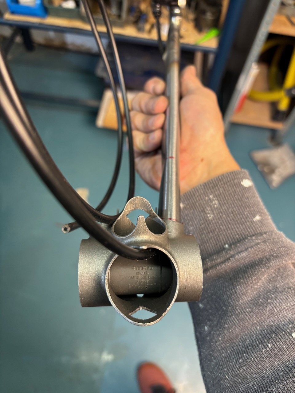

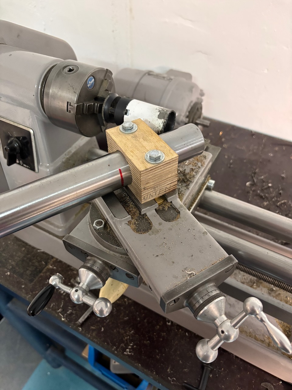

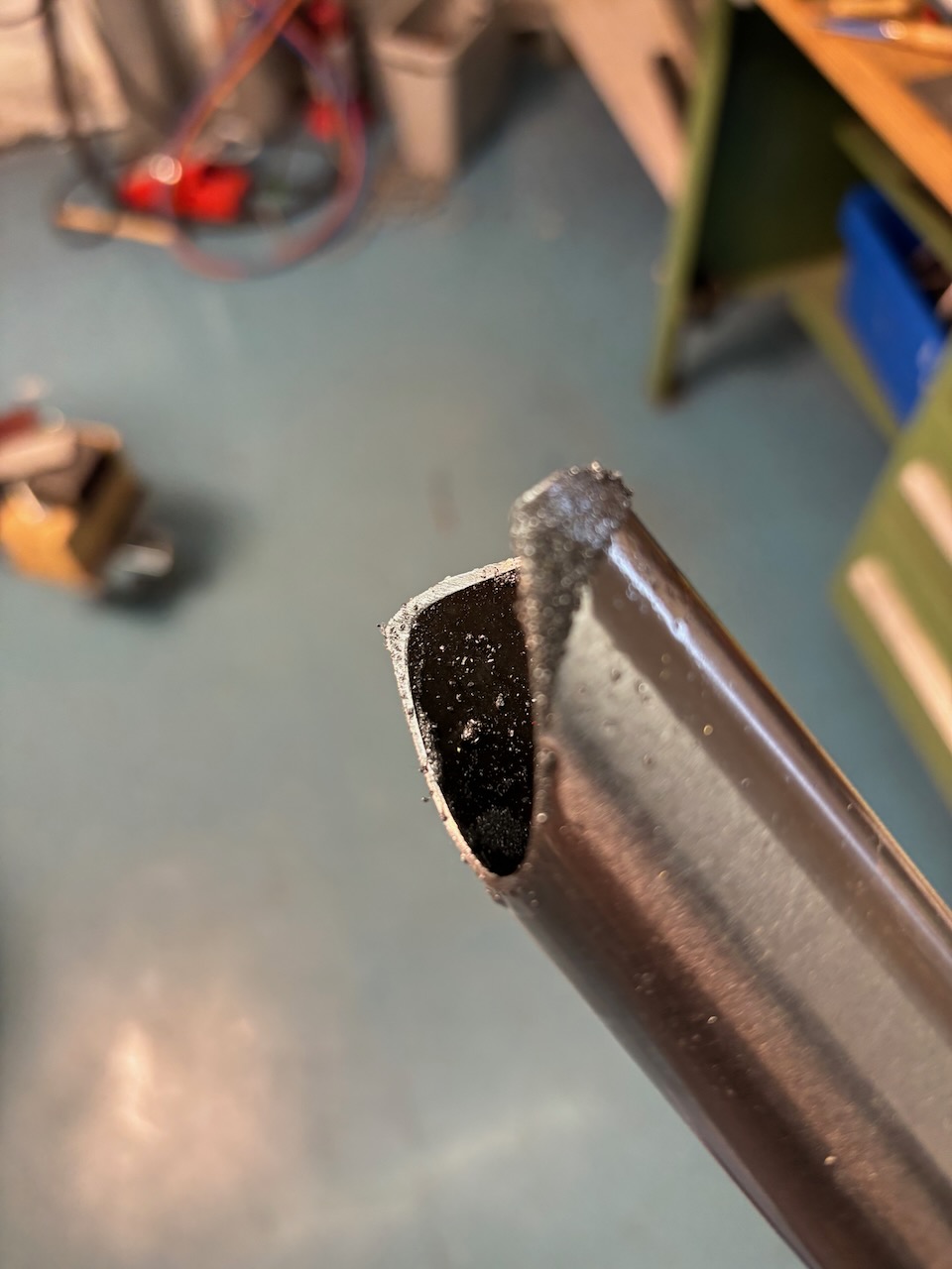

Oh I lost it somewhere. Was able to fix the flatmount in a nice way. Then fiddled around a lot to route the brake hose through the BB lug. And a pic of my way to small lathe cutting tubes - but it kind of works. Even though the belt stalls if a turn the knobs too fast….

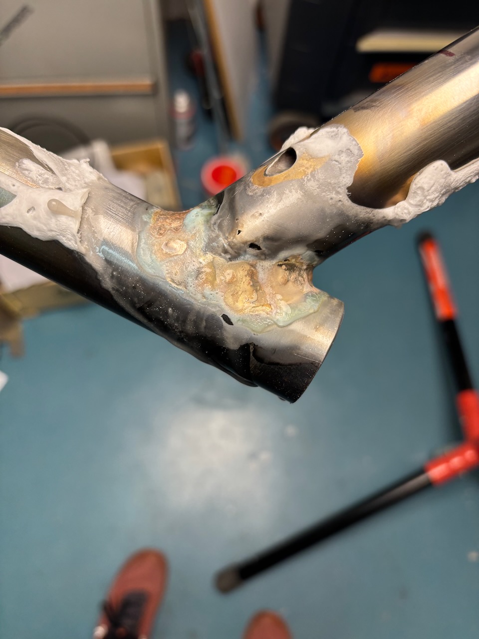

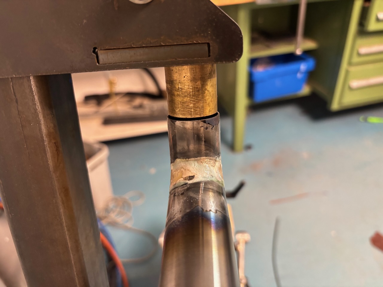

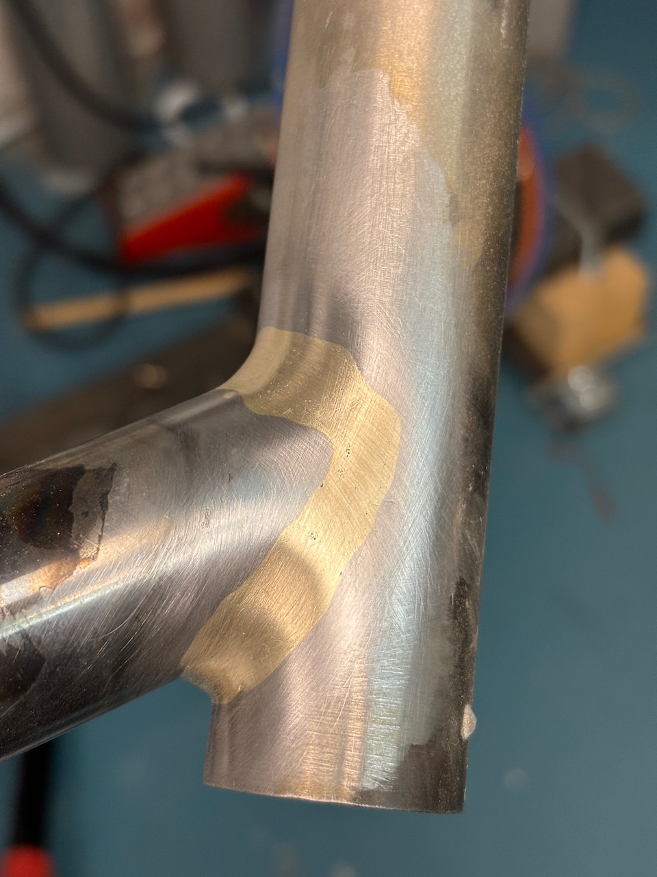

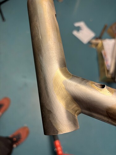

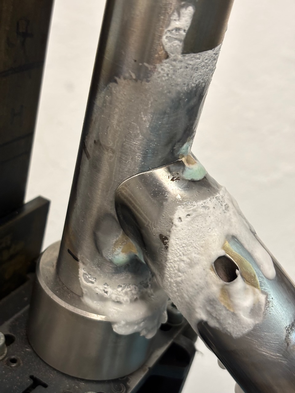

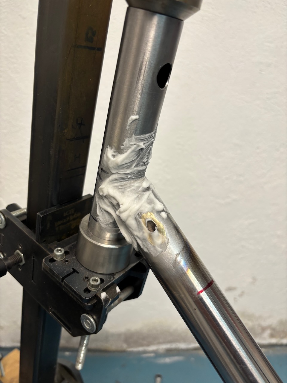

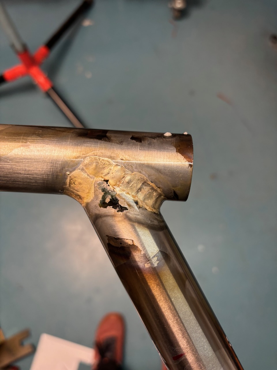

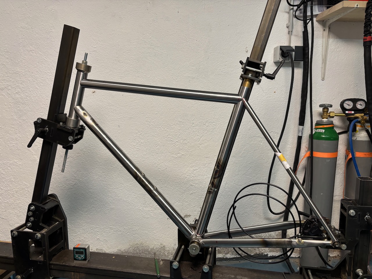

And pics of my DT/HT (always the first connection in my workflow) brazing sequence with 34%silver (wish I would have more stock…)

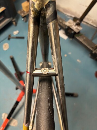

And the last set of pics of the fabriaction. I was a bit in a hurry back then and didnt take too much photos. After the DT-HT connection I usually braze the BB in one go with the Seat Tube, Chainstays and the DT assembly. After that I add the Toptupe and hope everything is straight. If not the SeatStays attachement gives the chance to do some minor adjustments to the rear wheel alignment. Usually I try to go without setting the frame. So if its straight in the jig and the rear wheel sits alligned to the top tupe towards the headtube I usually let it be and call it “straight”. It takes some experience to call a frame straight I learned - the more measurements you do the worse it gets usually…. :smiley:
For the seat stays I chose some Columbus XCR this time to give it a bit of a classic touch combined with the EC34 steerer tube. Contrary to that the Geo has quite a bit of sloping and the chain stays are the short taper ones.
And at this point I was also quite sure my internal brake hose routing through the BB shell to the CS will work - and so the Di2 cabling.

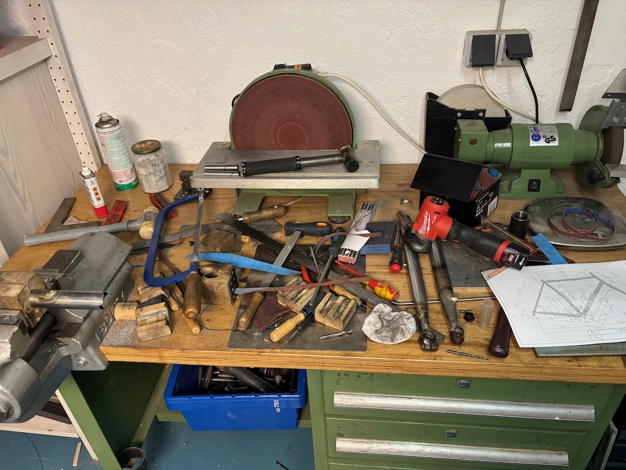

Cat approved it! And the final chaos on my workbench…Can anyone relate?
