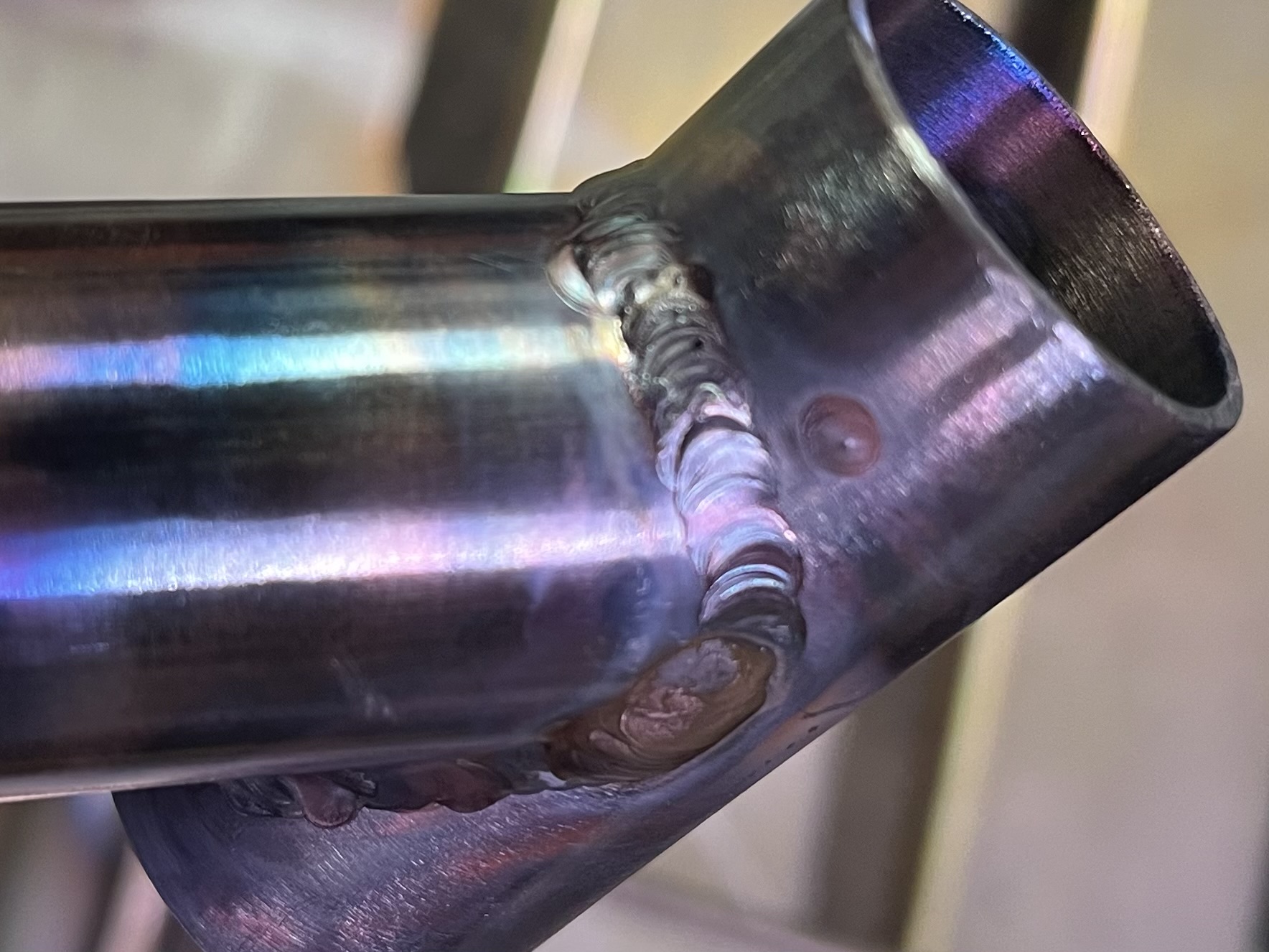

After prep and cleanup, only time for one joint today, but seems descent even though I was hurrying due to a life-imposed deadline. Some balled up spots but better than before.
*30 degree joint.
Been a few days with life taking me places, but I was able to get a practice session today. Ran some beads on the flat just to refresh, then did another 45 deg join.
Keep it up and you will se results.
I would recommend get proficient at 90 degree before moving on to angled miters. Angles increase difficulty drastically.
I also clamped my T in a drill press vise for tacking and used it to position the work. These small joints are tricky on a flat table.
Some great advice I did not know I needed was “remember to breathe”. This does wonders to relax you.

Another day at the practice. Tried a more blunt tungsten grind. Also ordered a tig grind attachment for a dremmel for consistent angles and to try and remove one more variable. (3mirrors brand $38 off Amazon, FWIW)
Two joints today, 1-1/8” x 0.035”, 85max amps, rule of 33’s.

Incremental progress. I need to remind myself to stop when I get out of position. Might help to get stronger cheater lenses, too.

Welded one joint up. Felt relaxed & in control. Still some inconsistent spots. Will keep chuggin’ along.
Between work and a mild illness, it’s been a week, but I was able to prep and weld two joints today. Feeling pretty good about them, know they’re not perfect, but scrolling back I can see improvement. Working I definitely feel the improvement.

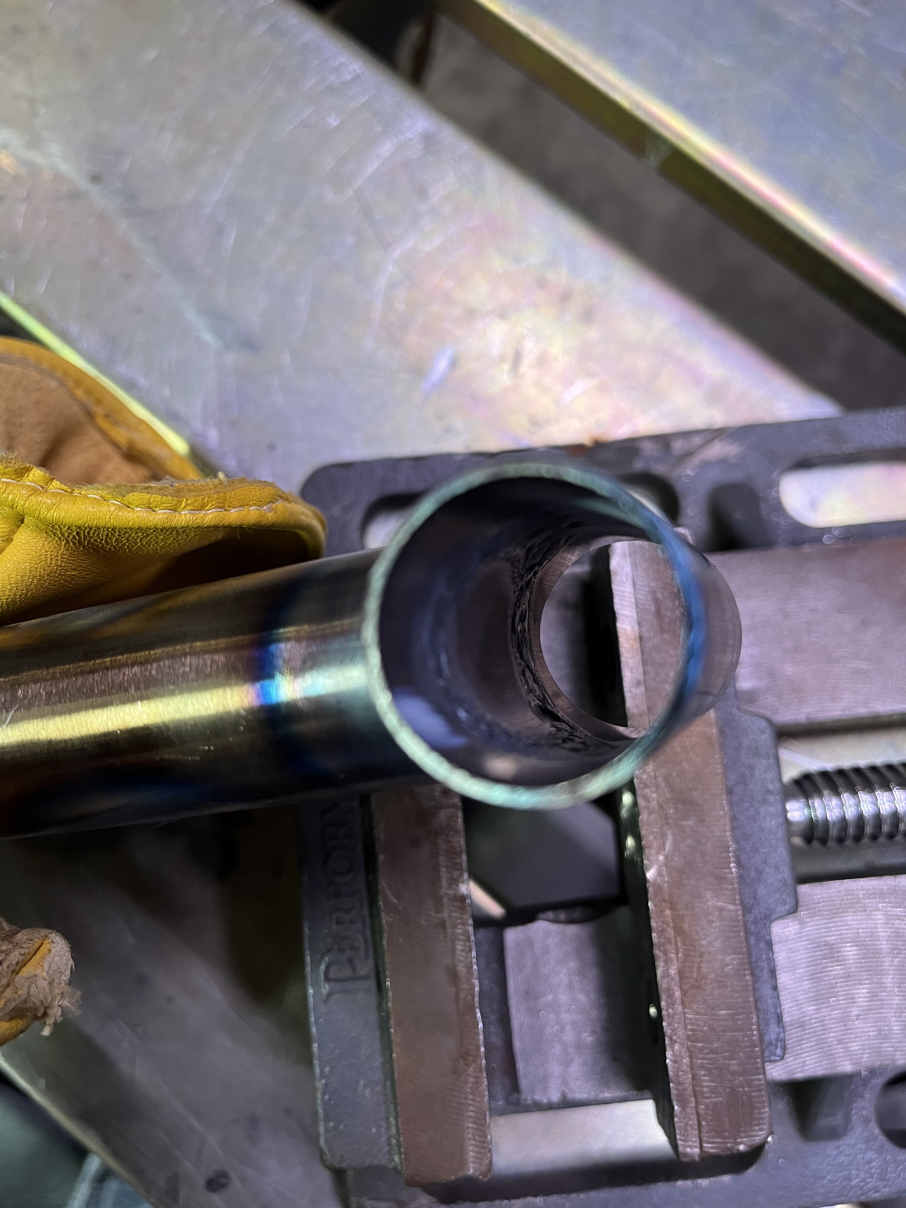

The inside, if it tells anything:
