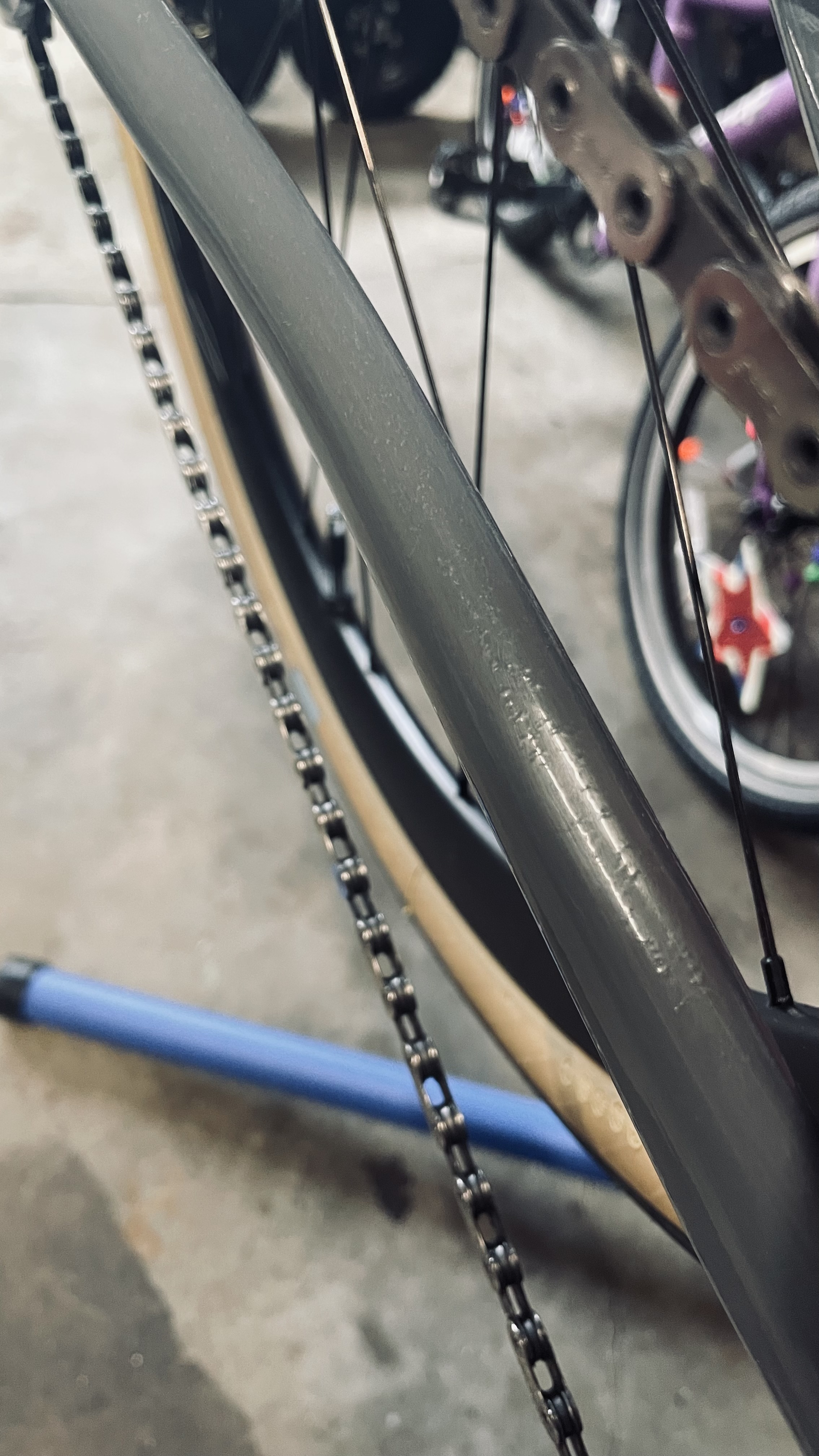

Another question for those with more experience:

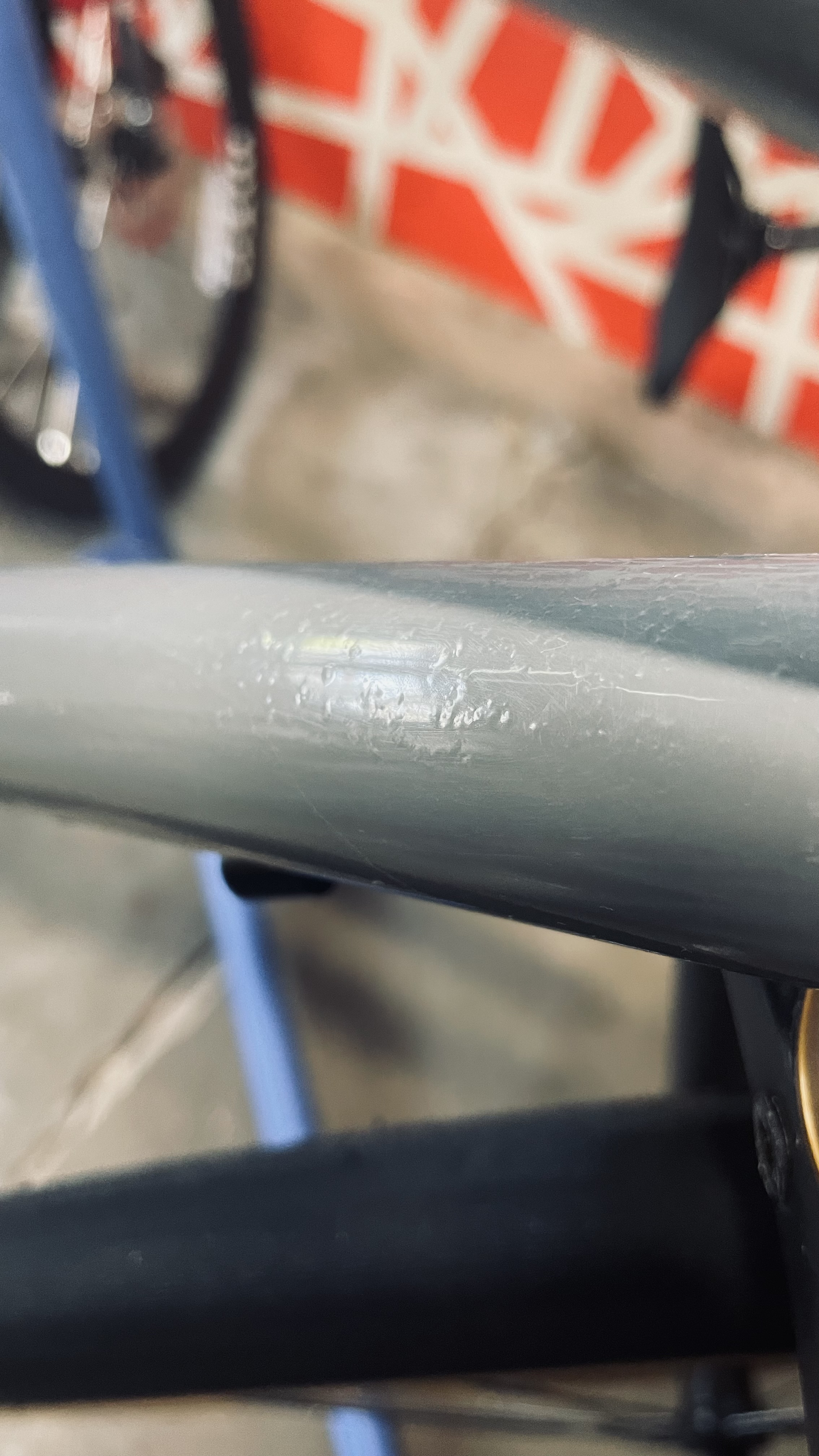

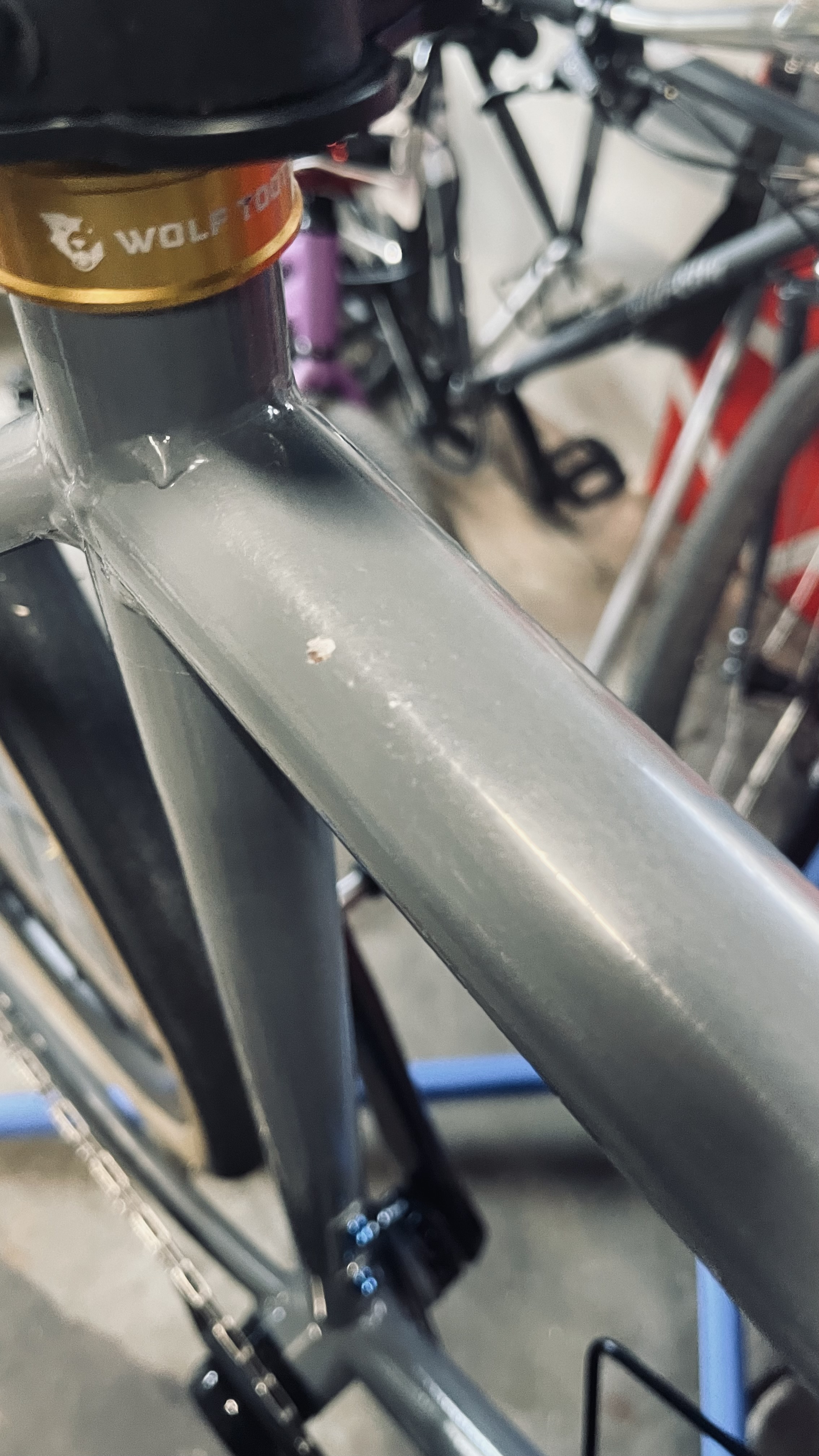

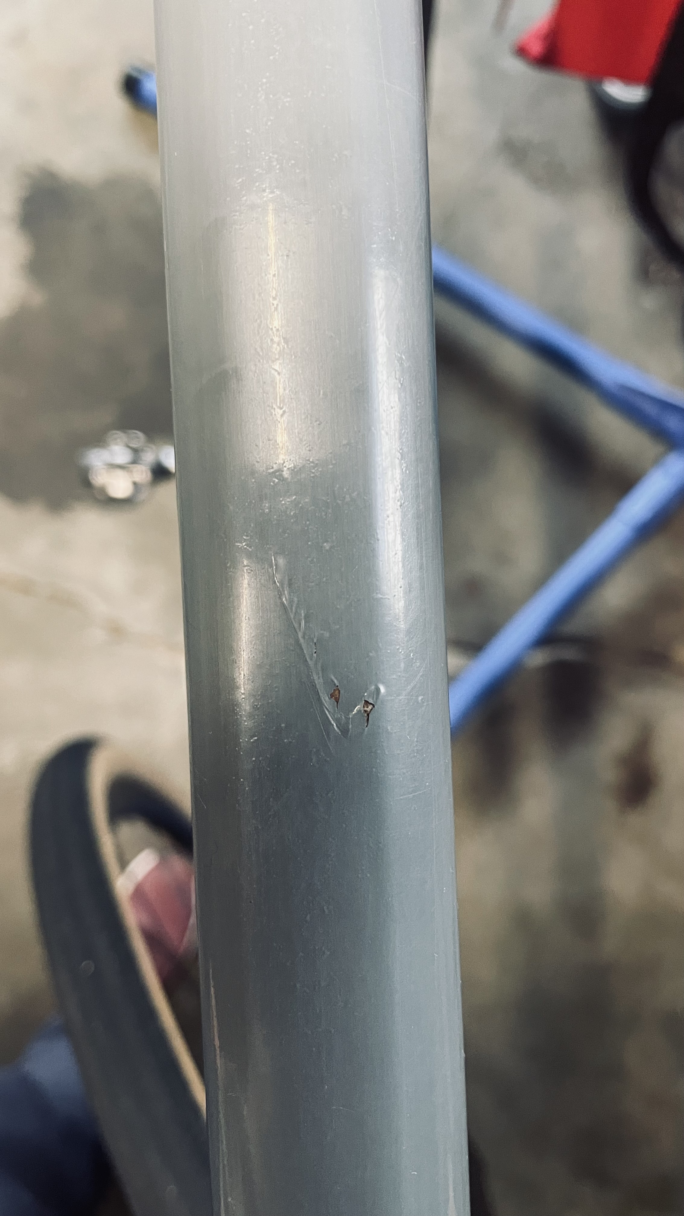

I had this frame powder coated about 10 months ago. He’s done a fair amount of bikes before, and was even separately recommended by my LBS. There are little bumps showing up all over, and overall it seems pretty fragile. A bar strike caused the top tub to almost peel. I did take the cheap route and use powder he had extra from past jobs.
Is this bad powder? Bad craftsmanship? Bad prep? Is it rusting under and making bumps?
Looks like poor application.
Lots of issues can come up with powder, could be the air used was not dry enough and causes moisture buildup under the coating, surface wasn’t sandblasted blasted or cleaned properly which affects adhesion, or powder wasn’t baked at the proper temp or time.
Agreed, looks like incorrect surface prep to me - looks way too shiny in those pics to have been sandblasted. But hard to tell from photos.
Thank you both, I’ll have a chat with the powder coater.
