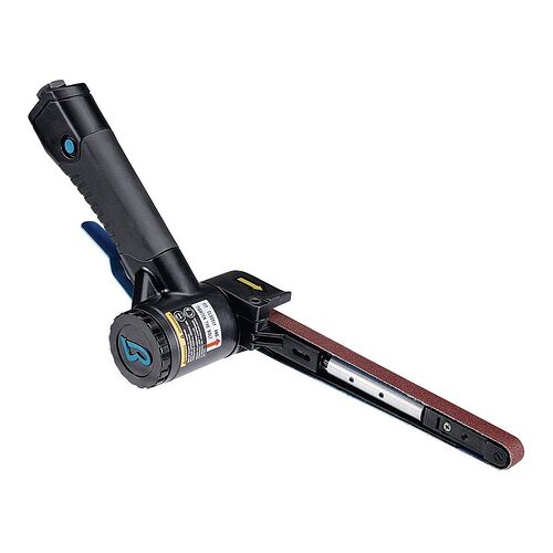

Have just picked up a original style Dynabrade dynafile.
Belts the length it uses (610mm) in thin widths are impossible to get in NZ, but have a company that will make me 30mm widths that I can then cut down to whatever I want with a jig like this
Just wondering if anyone on here is cutting waves into their belts and if so, are you hand cutting or have you come up with a jig to do so? I’ve read that it helps feather the edges so it doesn’t cut in so hard.
I’m excited to have a play with this and also that it can take down to 3mm belts on this model.
Do you think it would be possible to trim down the 3m non woven/scotch Brite pads to be thinner? I know they have a backing that would slice but wondering how the actual material would take it?
