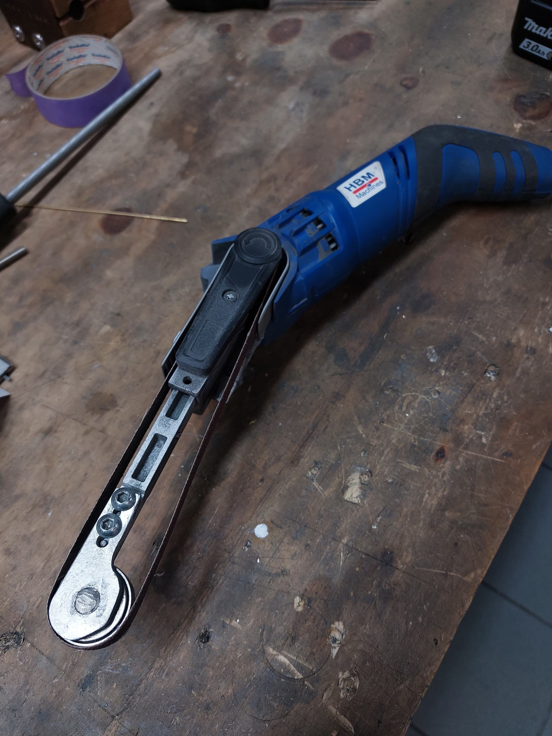

I adapted the cheapest sander I could find with a big offset bearing to add some room to flex. Works very well eventhough I am no longer using it to file the fillets with it.
This is what I need.
Can you explain what you did? Then maybe I can copy it. I also like the idea that its cheap! :smiley:
I basically just cut off the front and made a new end from some scrap aluminium and I cut away the bits that hit the belt. Probably my shittiest yet most effective tool.
Here is a photo of the original thing:
