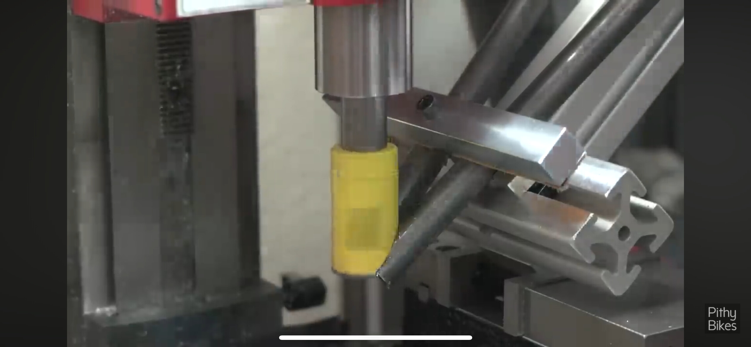

One of the big considerations for me is using a 4” mill vise so I can attempt to miter the left and right seatstays / chainstays / unicrown fork blades at the same time. I think a 4” mill vise appropriately jigged up is big enough. However, I’m not sure if I can get by with a mini-mill to do that. Perhaps, the Little Machine Shop 6500 series will do that? Or whatever equivalent Grizzly, Sieg, etc. Chinese mini-mill. Basically, I’m just asking if anyone has any experience with these $2k mini-mills to know how big I need to go in order to do mitering of the seatstays at the same time. I know. I know. For that money I can buy a bigger better used mill. I just don’t have the space.

@AJAX I’ve been using the mini mill for ~6 months now and I really like it. It works great for tube mitering and has enabled tooling projects and workflows that I wouldn’t have been able to implement otherwise. It’s been super fun to use and a great learning experience, if you’re on the fence and don’t have space for a larger machine I have zero reservations about recommending one.
The drawbacks like lack of stiffness, lack of power, lack of clearance, etc. that people describe are all real, but in my experience these issues are exaggerated and the tradeoffs are well worth it considering the alternatives (no mill at all, the expense/hassle of a larger machine). Just about the only framebuilding tasks you won’t be able to do on a mini mill are simultaneous mitering of the dropout side of seat stays and chain stays and the steerer tube miter on fork blades. For at least the SS/CS miters you should be able to get around this by mitering one tube at a time and determining the angles using careful layout on a sheet of paper. If you want to see one potential workflow check out the Pithy Bikes YouTube channel. He has a few videos showing his process and it seems to work well enough. He uses the ~$1000 Sieg mill so you really don’t need a big or expensive machine to be effective.
I think the steerer tube miter on fork blades is the only miter that there isn’t a workaround for using a mini mill, even considering some of the “larger” versions. I plan on experimenting with 3D printed templates and an oscillating spindle sander for these miters. Hand files would work too.

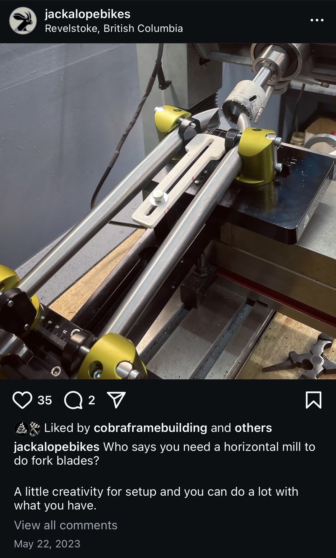

Yesterday I forgot that I’d seen Jackalope Bikes use a mini mill with a rotating head to miter fork blades. Something like this would be required to use a mill for that miter, I think the legs get in the way otherwise. I’m also not sure I’ve seen a machine like this for sale in the U.S. but I haven’t looked too closely.
I don’t have much experience with lathes so I can’t speak to the potential of that workflow. Seems like they’d solve most of the clearance issues as long as you have a good way to attach the mitering fixture.

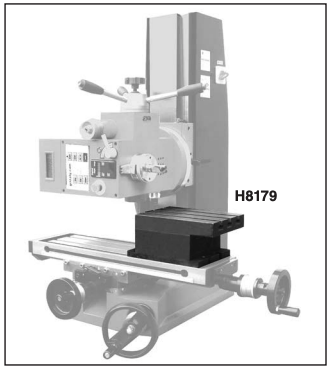

Looks like I was wrong about benchtop mills with tilting heads, both Grizzly and Precision Matthews have a couple models that let you tilt the headstock up to 90 degrees. Here’s a picture from the G0704 manual showing a similar machine set up as a horizontal mill - unfortunately it looks like they don’t sell that horizontal table accessory anymore, but a tilting table would probably let you do the same.
A 1" hole saw mounted in an R8 collet protrudes ~3" from the spindle on my mill, spindle to table distances vary quite a bit from machine to machine but I bet some of them have enough vertical clearance to do dropout miters like others have suggested.
I think those mills use a few bolts to tram the head. I had a mill like that and tramming it accurately took a while and was a pain with lots of light taps from a deadblow hammer then tightening the locking bolts without knocking it back out of tram.
