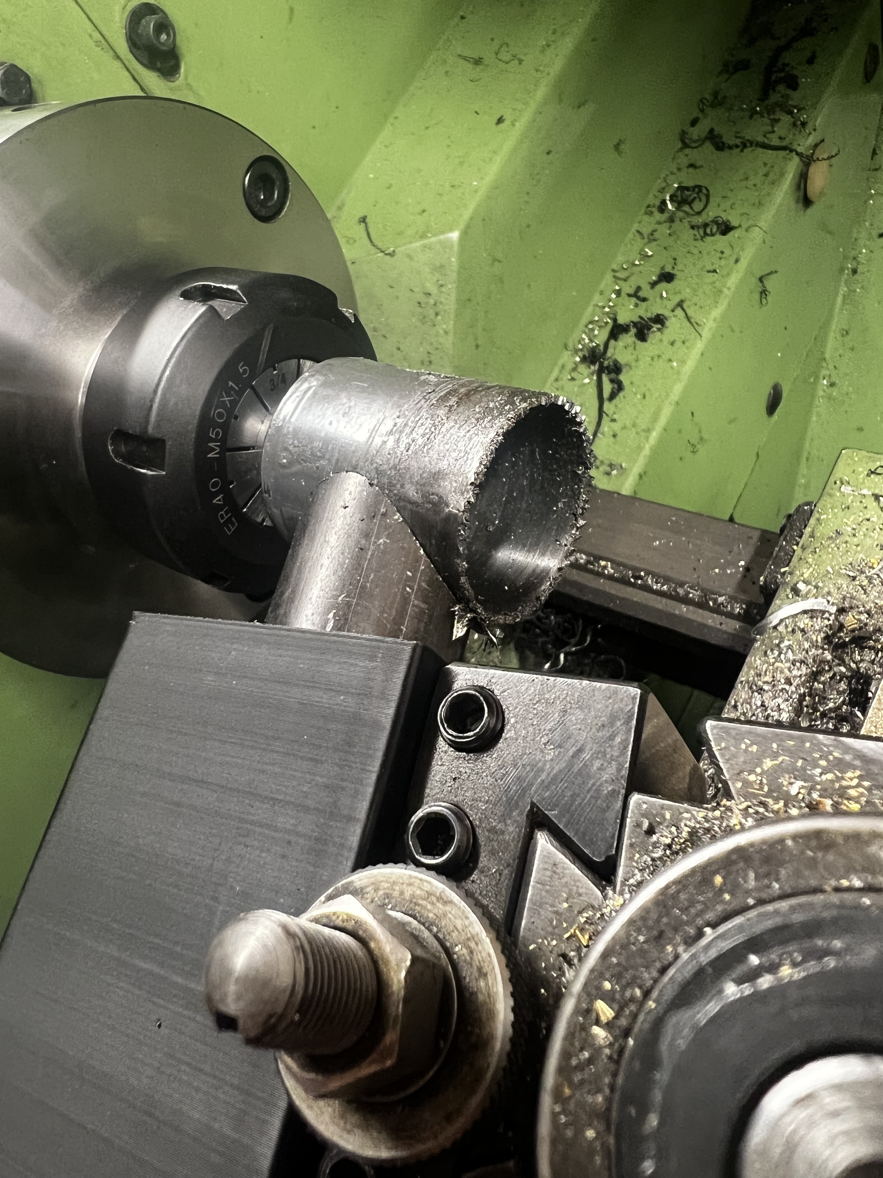

Do you have a lathe? I’ve been experimenting with mitering on the lathe using a 3D printed “tool holder” that holds the tube and a hole saw in a collet in the headstock. It is working well in my tests so far.
I’ve attached a picture of the tubing holder. I thought I had one of it in action, but I can’t find it right now.
I found a Weiss VM25L on craigslist, for making small parts the DRO and quill readout are really nice to have. It weighs around 250lbs. As @photon mentioned the Z axis clearance is limited and I have to move my setup to miter a set of chainstays. If I was only mitering tubes I would definitely look for a horizontal mill like others suggested.
Would you mind sharing a photo? Did I understand correctly that the tube is held in the tool holder, and the hole saw is in the chuck? Or is the setup (almost) the other way around?

This is how my 3D printed tube holder works.
I originally planned to make something that replaced the tool post and clamped tubing blocks. But I tried this first as an easy option and it works surprisingly well.
The key thing was making sure that the block rests against the tool holder and isn’t counting just on the printed key for stiffness.

My lathe is an Emco Compact 10, which is a nice size for small framebuilding shop. It breaks down into 200lb or lighter components if you remove the tailstock and has a roughly 1 meter by 30cm footprint. The through stock hole on mine is unusual, it fits 36mm tubing for most of the headstock, but steps down to 25mm just at the left bearing. What this means is that I can fit forks into the 3-jaw chuck and put the crown race right by the chuck jaws, but I can’t fit something like a long downtube through the chuck to face it for a coupler.
Looks great. I have an Emco V10, and have been thinking about cutting miters on the lathe. Do you use the power feed when cutting the miters? I see you have done the 2" riser block to get rid of the compound slide. I have some pieces cut for my riser block modification I just need to drill some holes in them for mounting.
I don’t using the power feed. Even when I did miters on the mill (most of my experience) I always fed by hand because I like to feel the pressure and adjust feed rate based on that. I feel like hole saws are too inconsistent to use any textbook feeds and speeds, and I’m too cheap to use annular cutters.
I had to get rid of the compound slide to fix the AXA toolpost, the compound slide was just a mm or two too tall. I think these lathes work better with Multifix type posts. The solid toolpost is way stronger though! I can put the compound back on with the stock 4-way toolpost in about 5 minutes if I need to do some threading or tapers.
