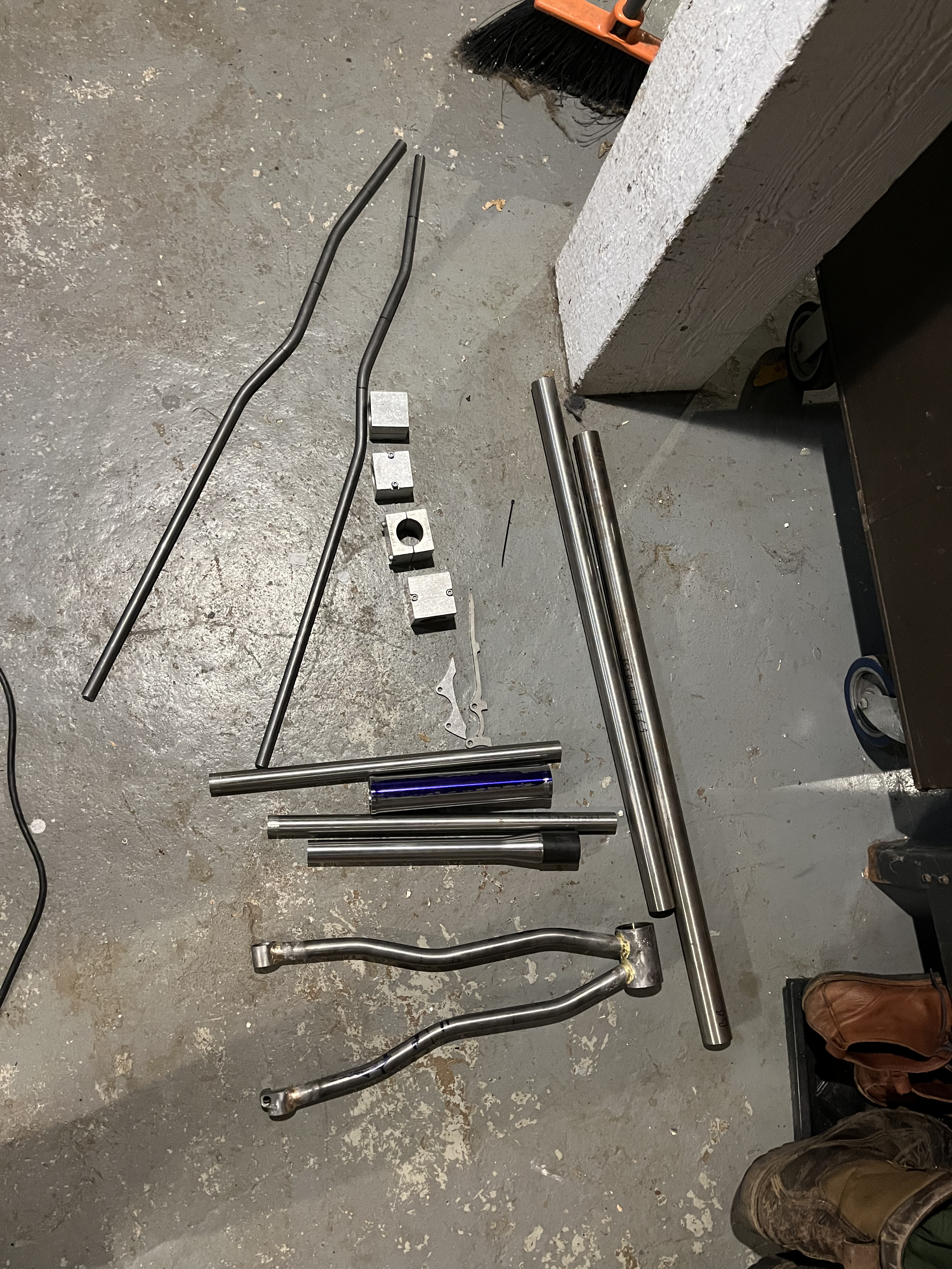

Tubes: DT and TT are thick 853. .049", 7/8" chainstays. I don’t want to build this bike again! I’d much rather be making 29" BMX bike…

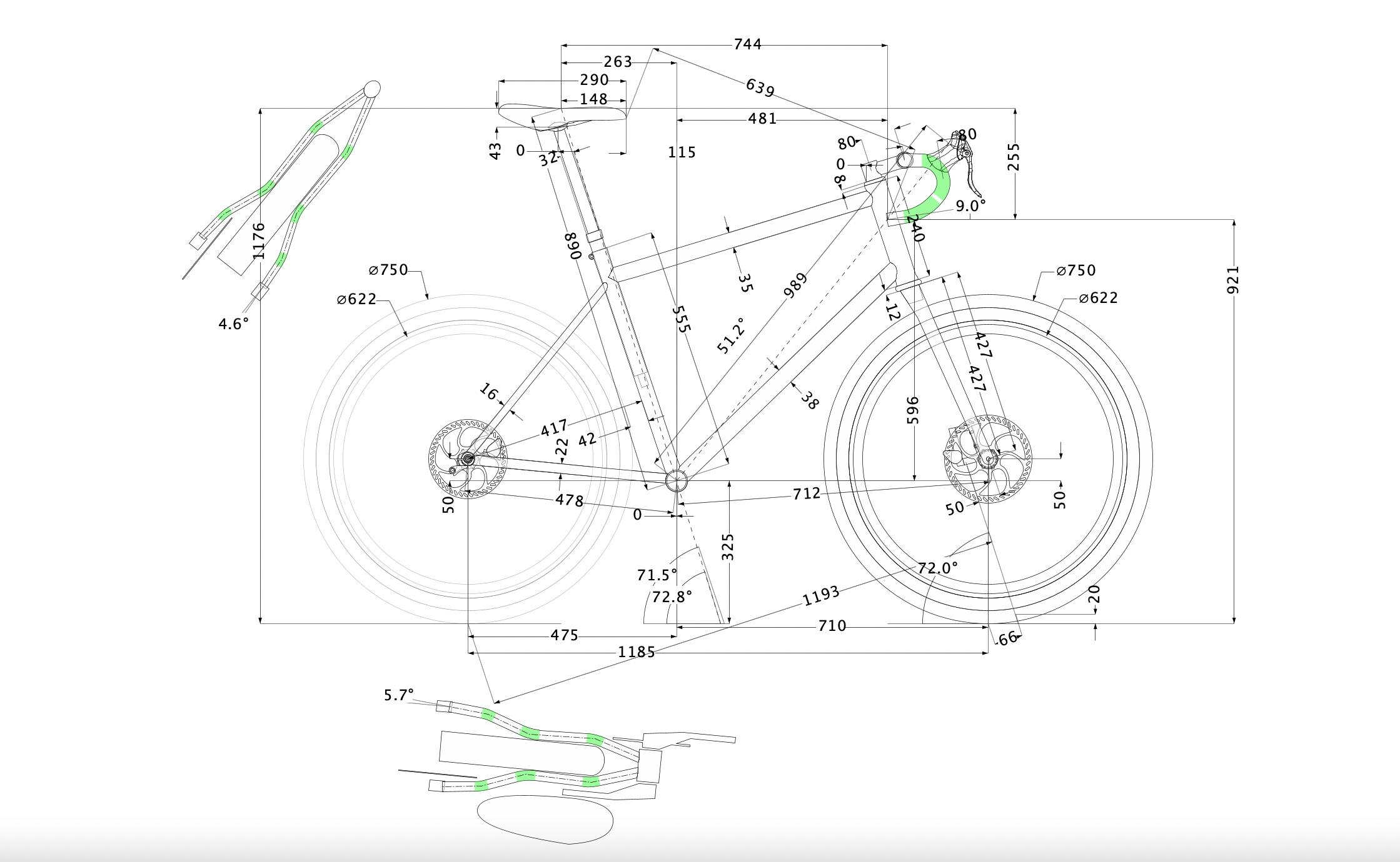

Cool project. What’s the drop between top of saddle and top of bars? Looks like a fair bit. Probably best to leave a couple of inches of spacers above the headset while you dial in your fit, especially since your mtb bars are higher than the saddle. Looking forward to progress pics.
Thank you.
I have been 6’9” a lot longer than I’ve been building bicycles, and I’ve gotten used positions more aggressive. I think a lot of tall cyclists do! I should be honest, I’m building this to race. I’m also using all available 12” of the tapered steerer. Any adjustments will require a custom stem or longer fork legs!
I designed the mtb around 30 percent sag, so the bars are effectively a bit lower in practice. It’s still not ideal. It’d be better shorter, with a shallower seat angle. It was designed for 190 cranks and was my second go at it. For a high cadence, fast bike, im using 175s.

I am curious, what is the exact TT and DT you are using? Its such a big bike, I cannot Immagine!

The downtube is: REYNOLDS BX2168XL DOWN TUBE 853 38.1x1.15/.85/1.15x850
The top tube is also a downtube: REYNOLDS BX3030XL DOWN TUBE 853 DZB 34.9X1.10/.9/.6/.9X760
They are the same tubes I have used for the last 3 frames I have built. I have been very happy with them
Have you considered building with a sus corrected fork? At your height they can make gravel bikes look much more proportional. @adamsklar made one of the best looking tall human gravel bike I’ve seen back in 2018. Check it below!

It is a good looking bike and definitely looks better than most xxl bikes! I quite am used to staring at big, ungainly looking bikes though, and they appeal to me. Also, think about the frame bag…
I have seriously considered a carbon, sus-corrected fork and made a few bikecad drawings. It would solve a lot of problems and I would love not having to build a fork! What has stopped is the cost for what I seem to get as a retail price-payer and my experience with carbon forks. I suppose I could buy a steel salsa fork, but I would rather build something without suspension correction and have a long headtube.
I am heavy. Even if I do manage to get fit this year, I will still weigh like 260 pounds or so. I had a suspension corrected carbon fork on a single speed mountain bike maybe six years ago, and there was something vague and insubstantial about it. It had too much flex and judder under braking and I could watch the wheel track lazily underneath me in disconcerting ways. Back then, I kept both wheels on the ground because I could imagine snapping my fork like a toothpick. Like everything else on this earth, it did not feel like it was designed with me in mind.

The discourse on this forum has caused me to rethink my the geometry as well as the design of this current project. I’ve raised the A/C a bit to get the bars up and I am reconsidering the fork construction.
