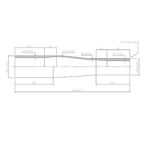

Curious about this seat tube, is this compatible for use on a lugged frame?

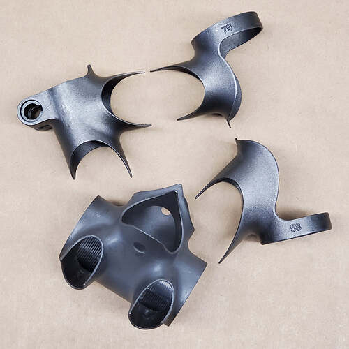

Yes, absolutely. In fact, Metal Guru even sells a lug set intended for use with this tube and a tapered top tube. Gravel Geometry Lug Set, Sloping or Horizontal Top Tube Option – Metal-Guru.com

Yes this tube can be used with lugs, another lug set that would work can be found here.
Also, for lug less construction the top of the tube can be sleeved with a piece of chrome-moly tubing to prevent distortion.

This being a single butted tube, the thin section (0.6mm) would be on the 1-1/8” diameter end.

For lug less construction there will be too much distortion with an upper wall of 0.6mm.
You would need to reinforce that area with a sleeve or just use a bulge butted seat tube instead.
