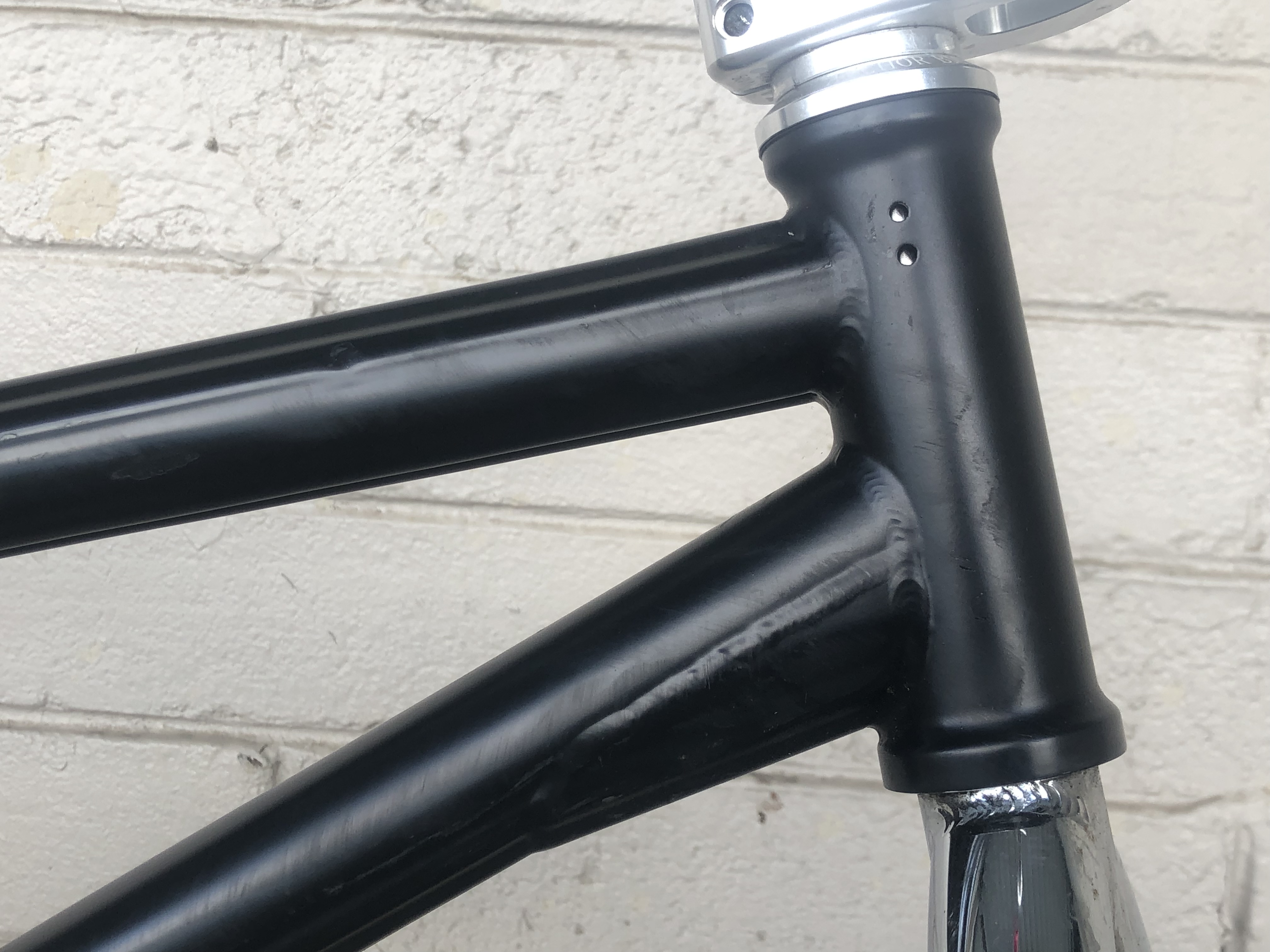

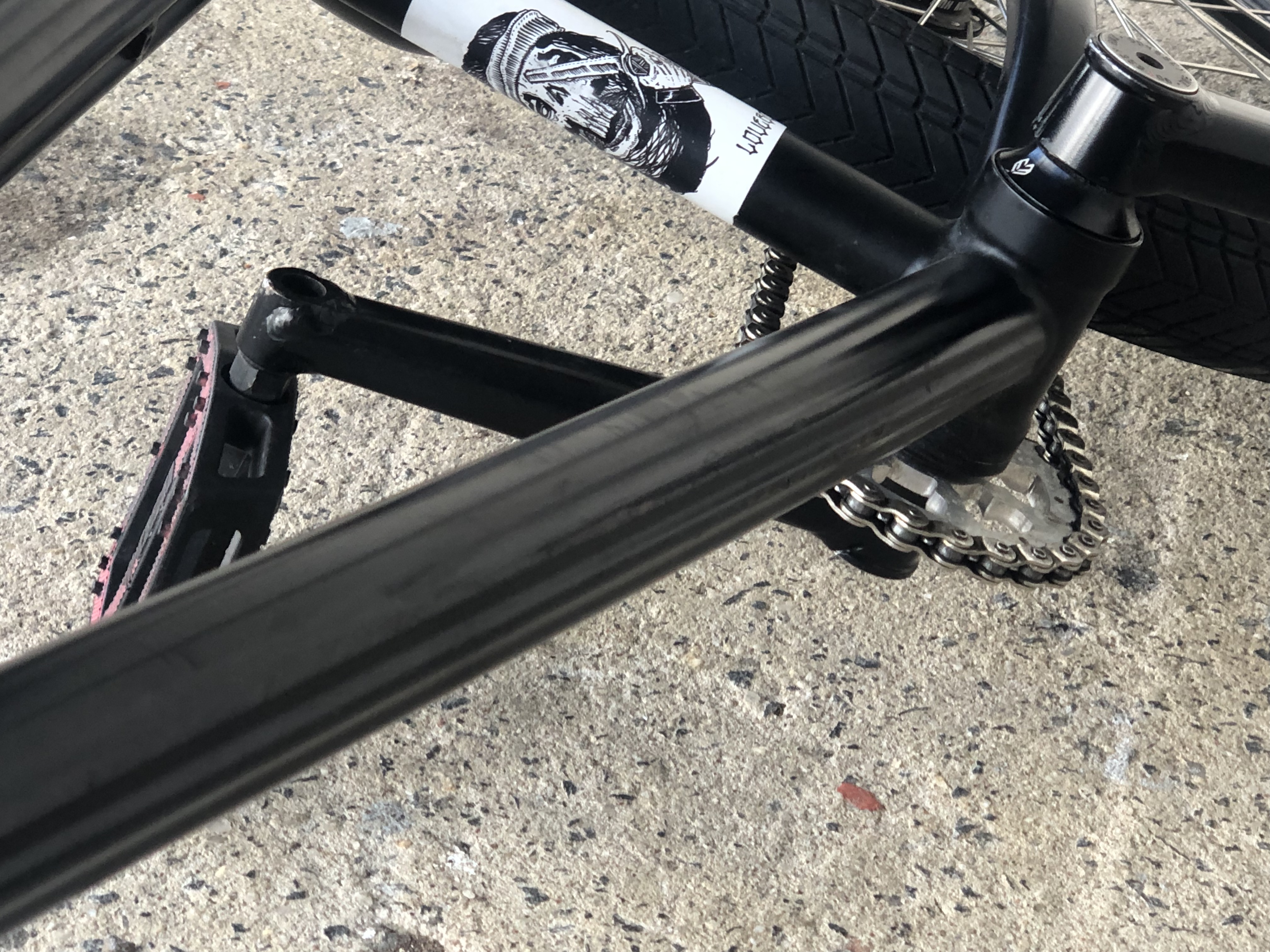

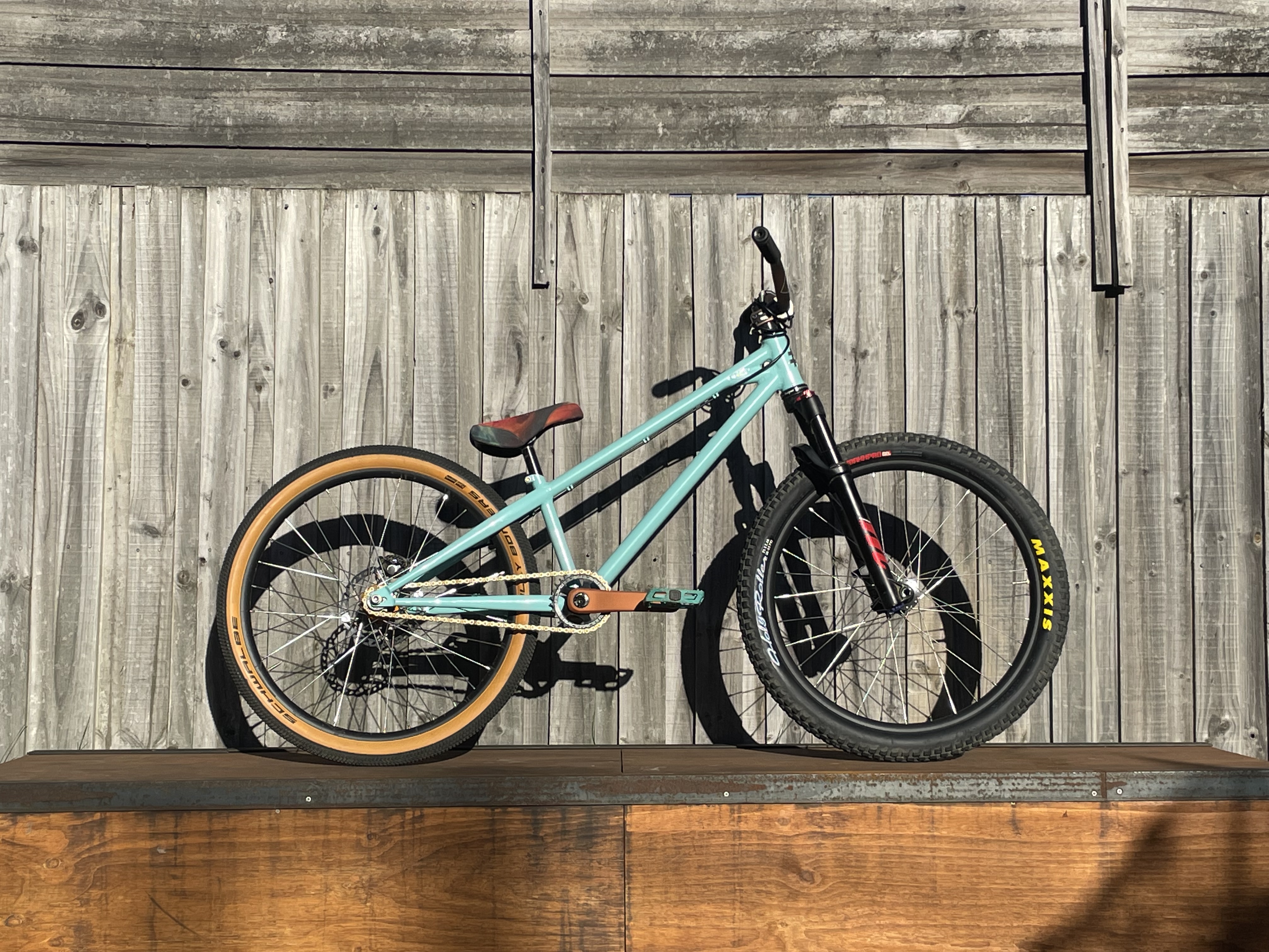

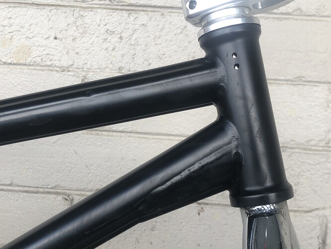

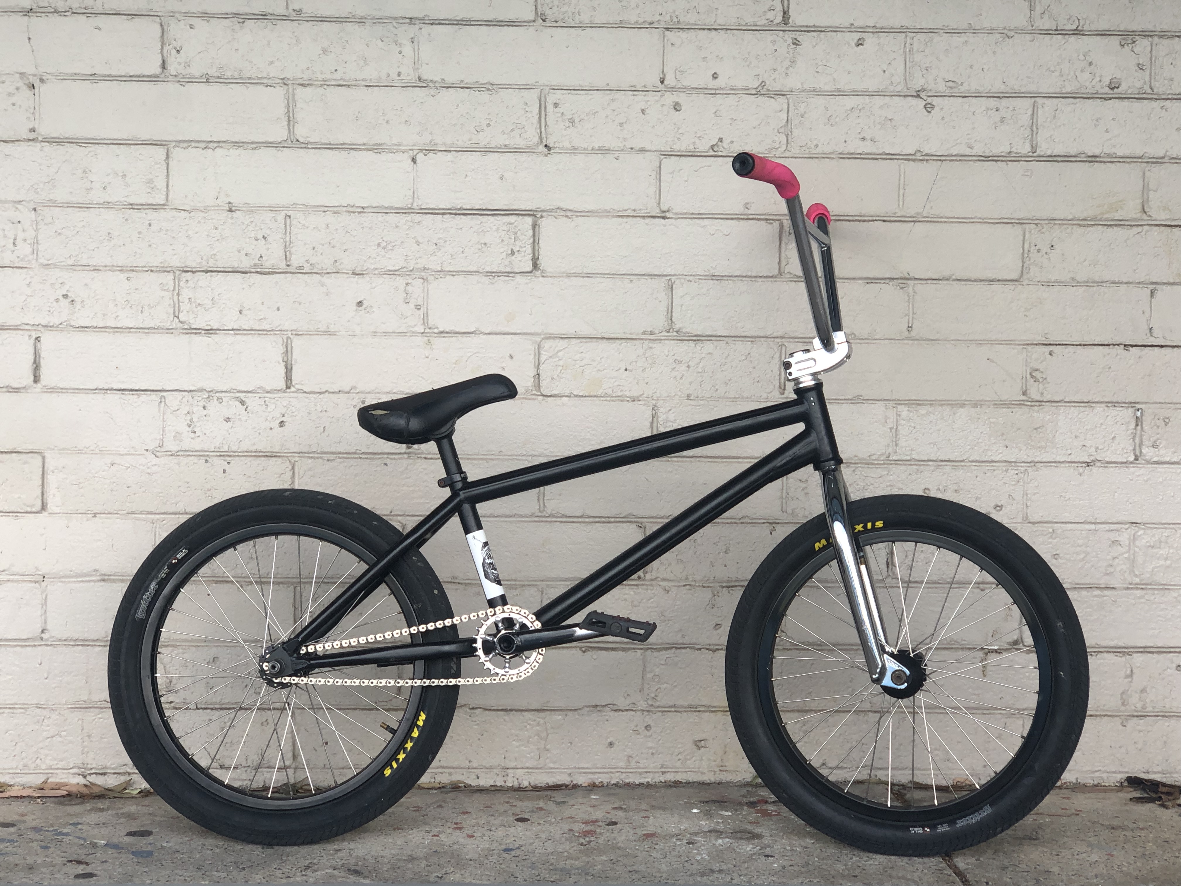

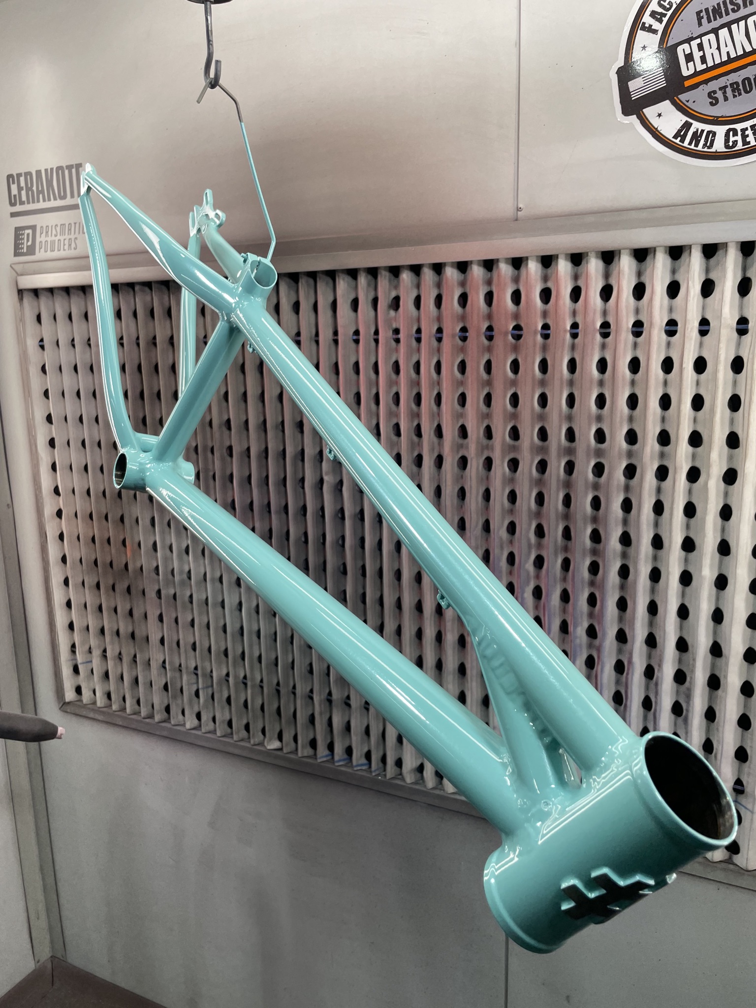

So I mentioned in another thread that I quite like some of the features (marketing gimmicks) in some Sunday frames.

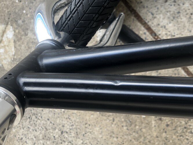

Currently riding the Sunday Soundwave V3 21"TT. TT and DT are formed in an axial corrugation way, and I rather like the HT gusset. My last WTP frame started cracking along TT gusset welds.
The frame has taken some serious slams straight to coping and keeps on trucking.
Ignore the pink grips… the usual are black ODI longnecks, these are all I had after the the old ones tore.

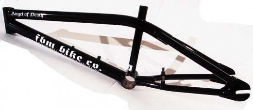

The FBM angel of death was a beautiful example of a double wishbone, top tube pierced by seat tube. My first small batch frame, had to enlarge the dropouts for my 14mm axel-48 hole triple wall rims! Overbuilt was the business, 10mm thick sprocket with a fat chain, sprocket chunks and feeble grinds! This thread almost gets me excited enough to pump up my tires, put my front wheel on, and go cruze a skatepark.

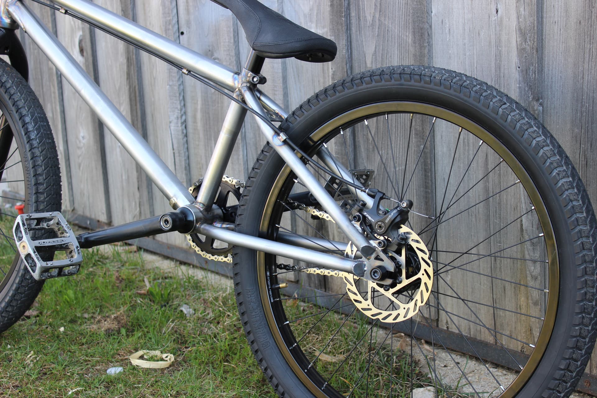

Hi guys, first post here, maybe I should introduce myself on the right topic too.
I’m trying to get people into “made locally bmx frames” here in France, custom for most ,but not an easy task so far :sweat_smile:

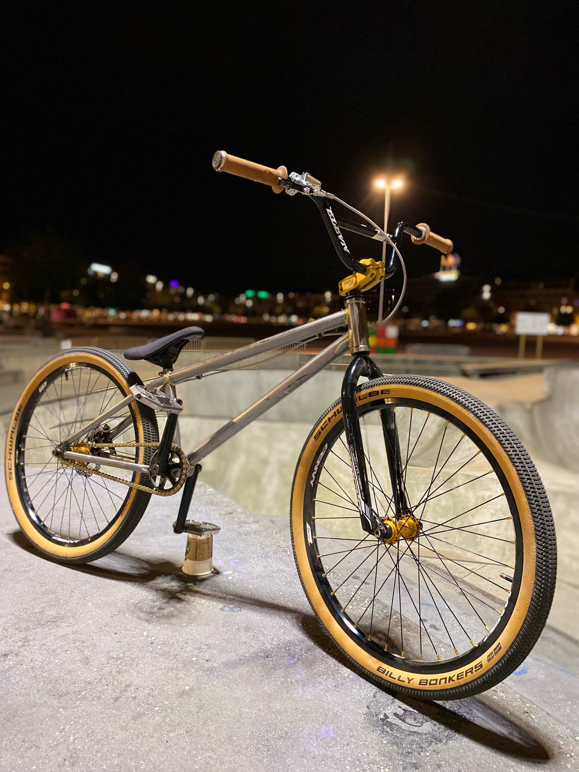

I have build a dozen of bmx frames so far, all different one from another so I won’t post them all but I’ll happily answer questions and give details if you’re bmx curious.
For starter here is a 22" disc brake bmx, I call it the lazy bike…you’ll go through any jumps much easier than on a 20

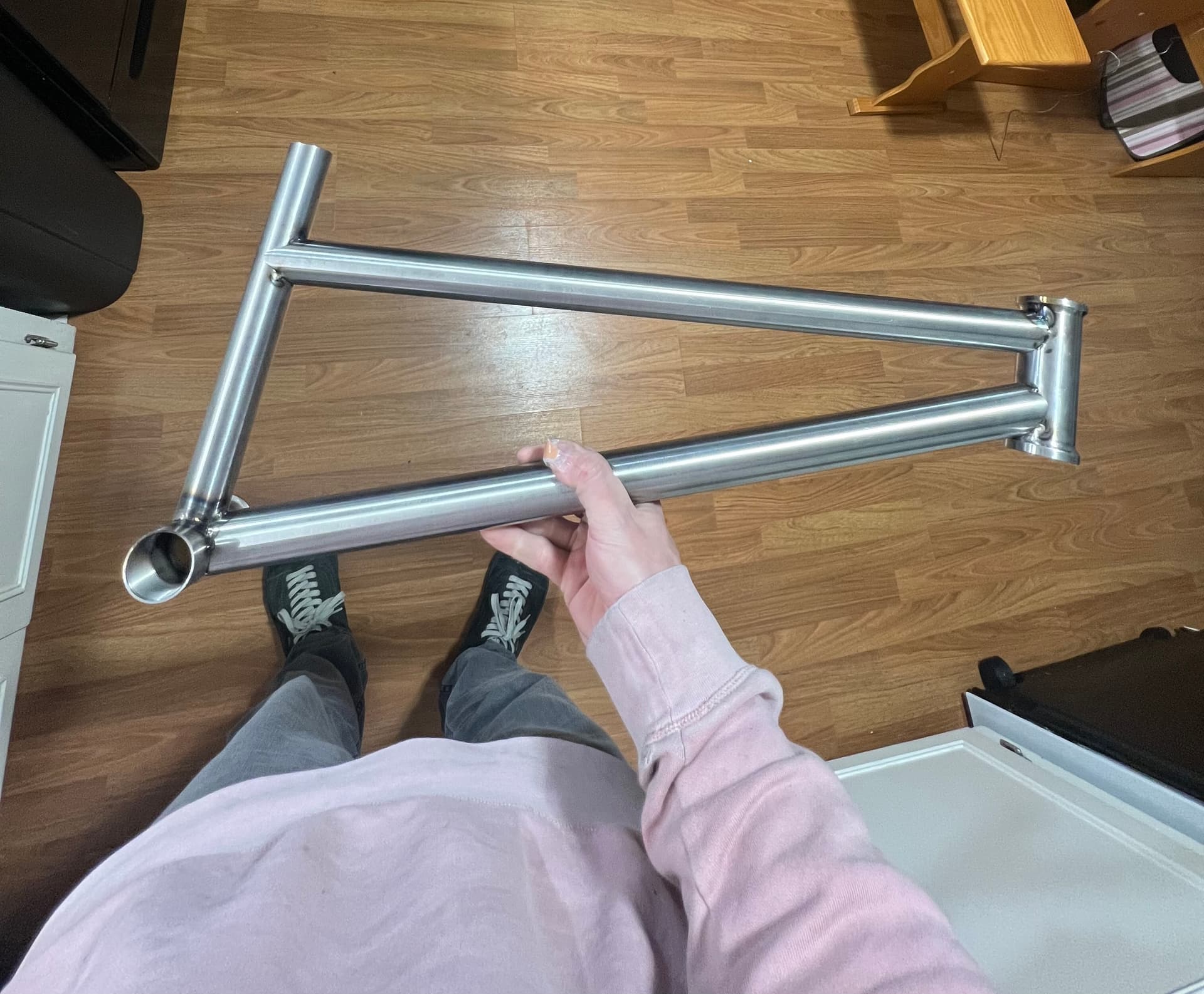

While BMX didnt get me into cycling, it did get me into frame building. Have spent the last few years racing and this year little freestyle in my down time. Working my way through my first frame build, pulled a lot of geometry from my ZeroNine OS20 race bike (the one in the first picture) which I have absolutely loved. I’m toying with a lower BB on this one, similar to a Daylight frame, and a slightly longer wheelbase. Really excited to race my own rig around on the national circuit.
Im lucky enough to be based in Nebraska, 30 mins away from the NoWear compound. Not only an amazing place to ride, with an excellent community, but a lot of knowledge and expertise in the BMX world.

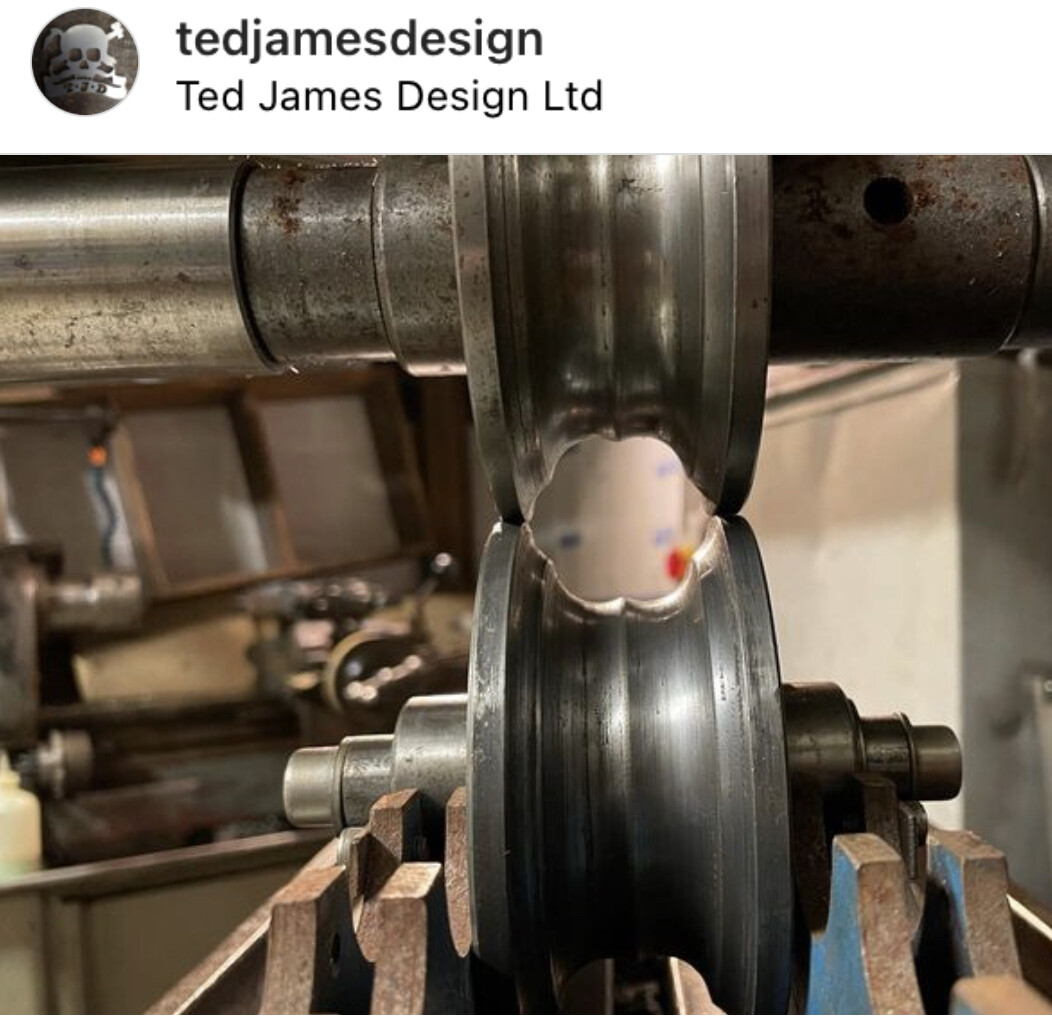

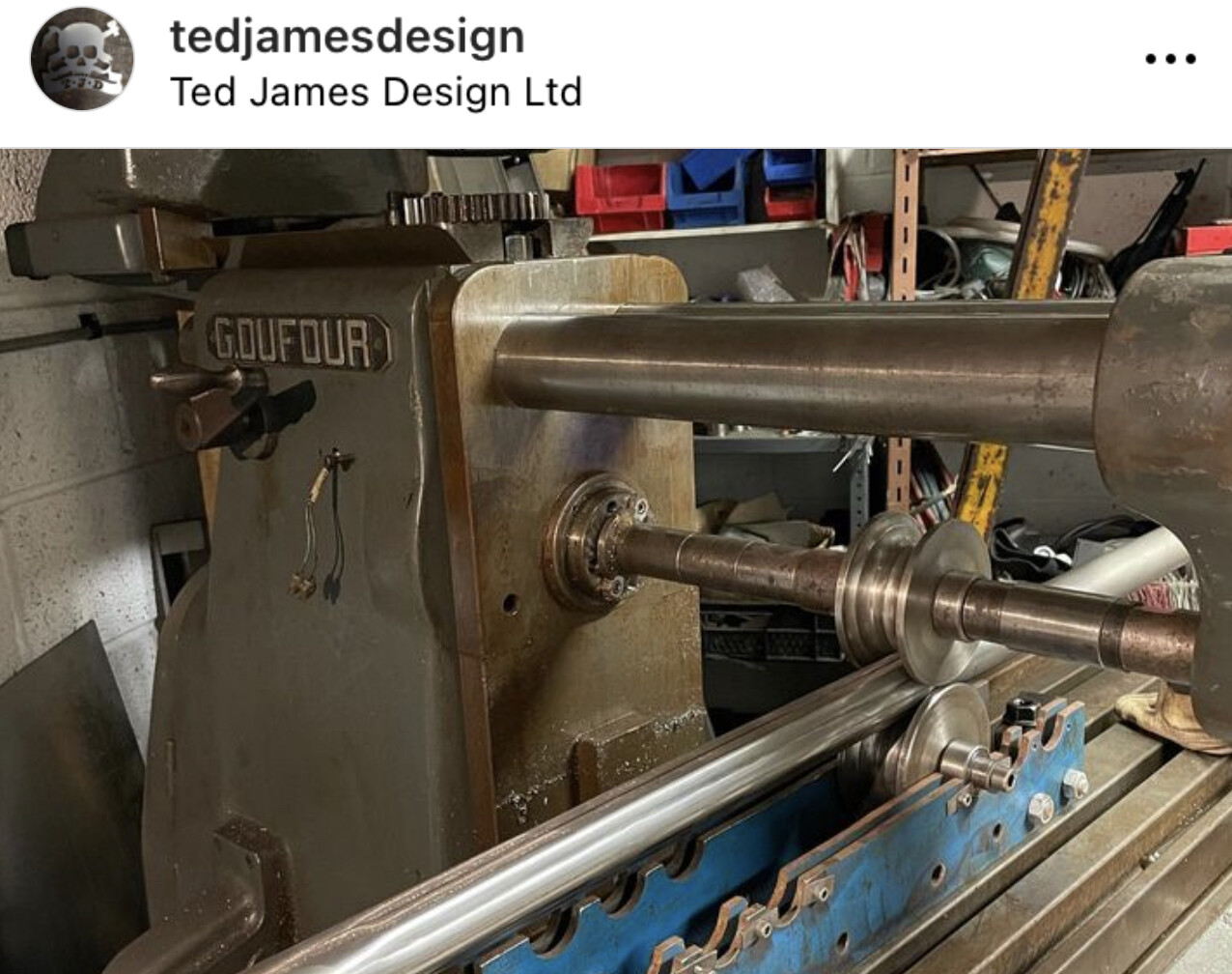

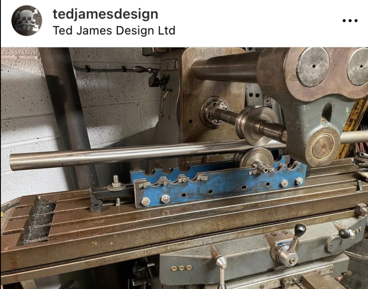

Those Sunday formed tubes are cool. Have you seen how Ted James did his? I like his use of a horizontal mill for the tube forming.
https://www.instagram.com/p/CVzew6QMLKO/?igshid=MDJmNzVkMjY=
Wow, thats a really cool workflow! Thanks for sharing that.
The BMX world has so many great fabricators. It’s funny how little crossover there is between the punk rock BMX builders and the fancy frame-building world. We are doing the exact same thing, just different size tubes!
OMG that the forming on the horizontal mill is such a rad idea!!
Ted James is so underated, love what he does and his DIY spirit!

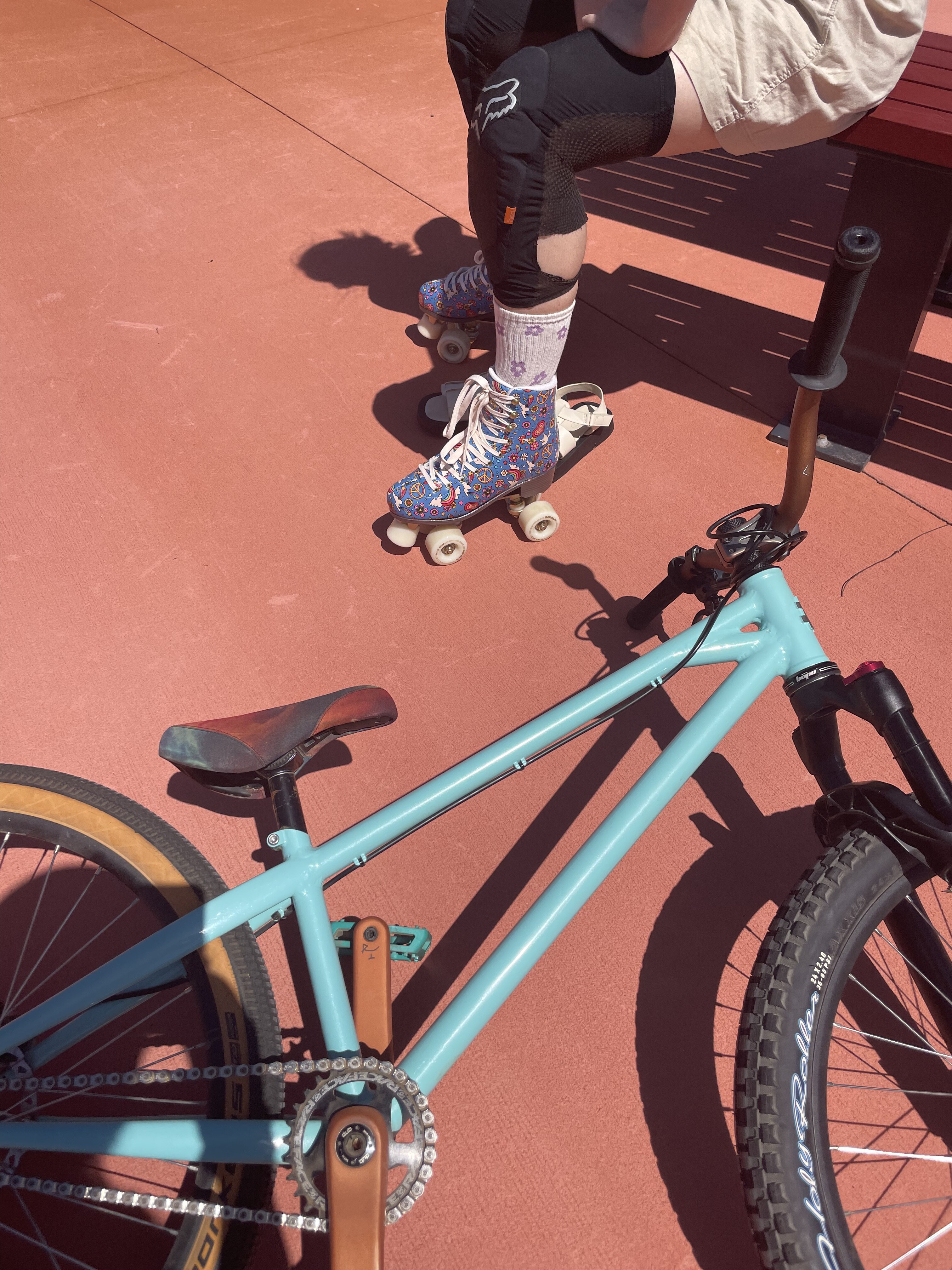

That is a lovely cruiser. Here is the 24” dirt jumper I did for the lady.

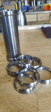

Hello fellow bmx enthusiasts!

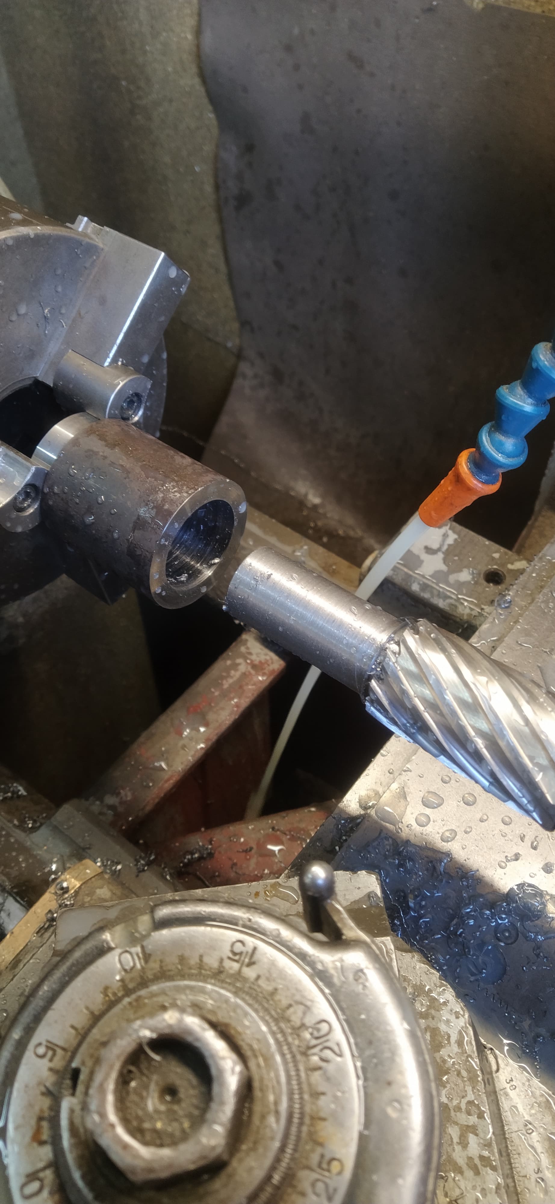

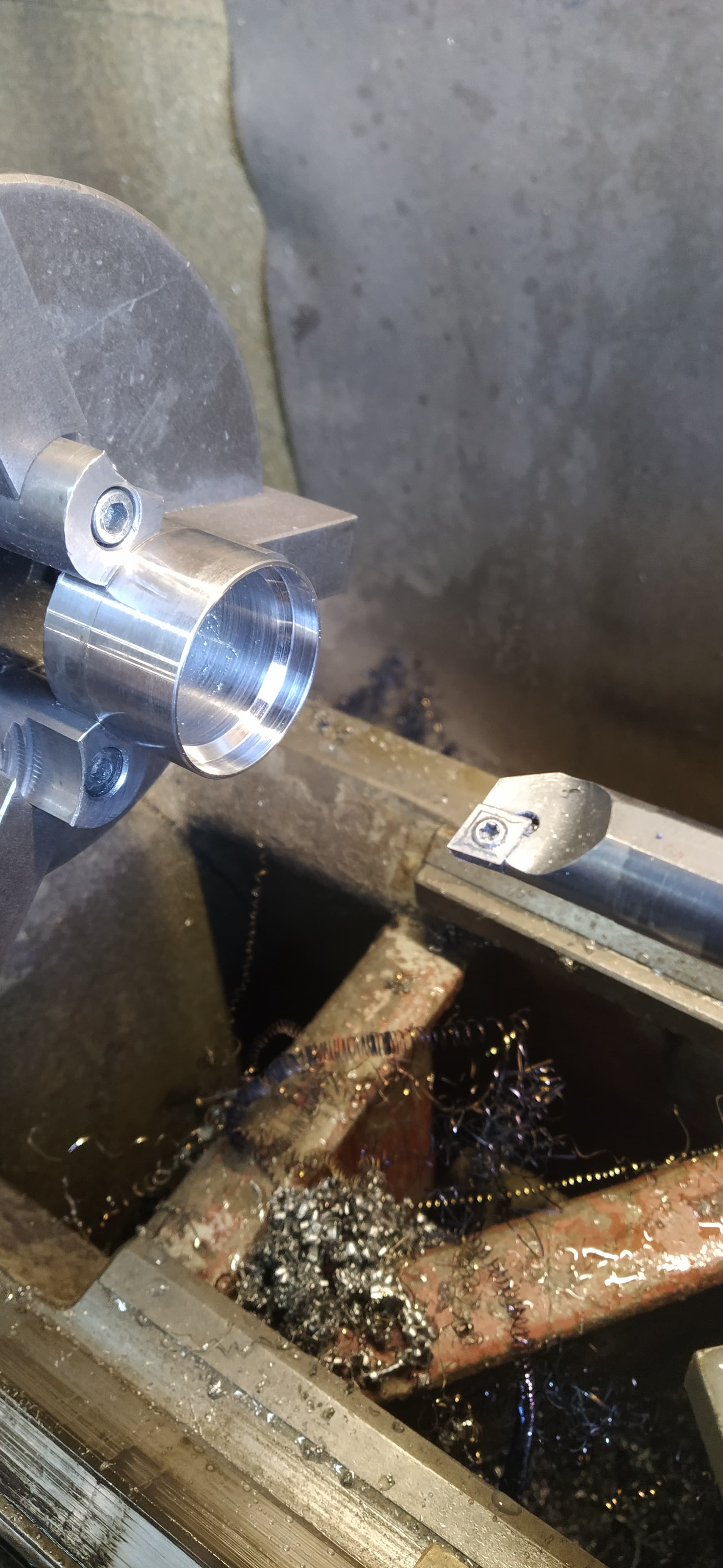

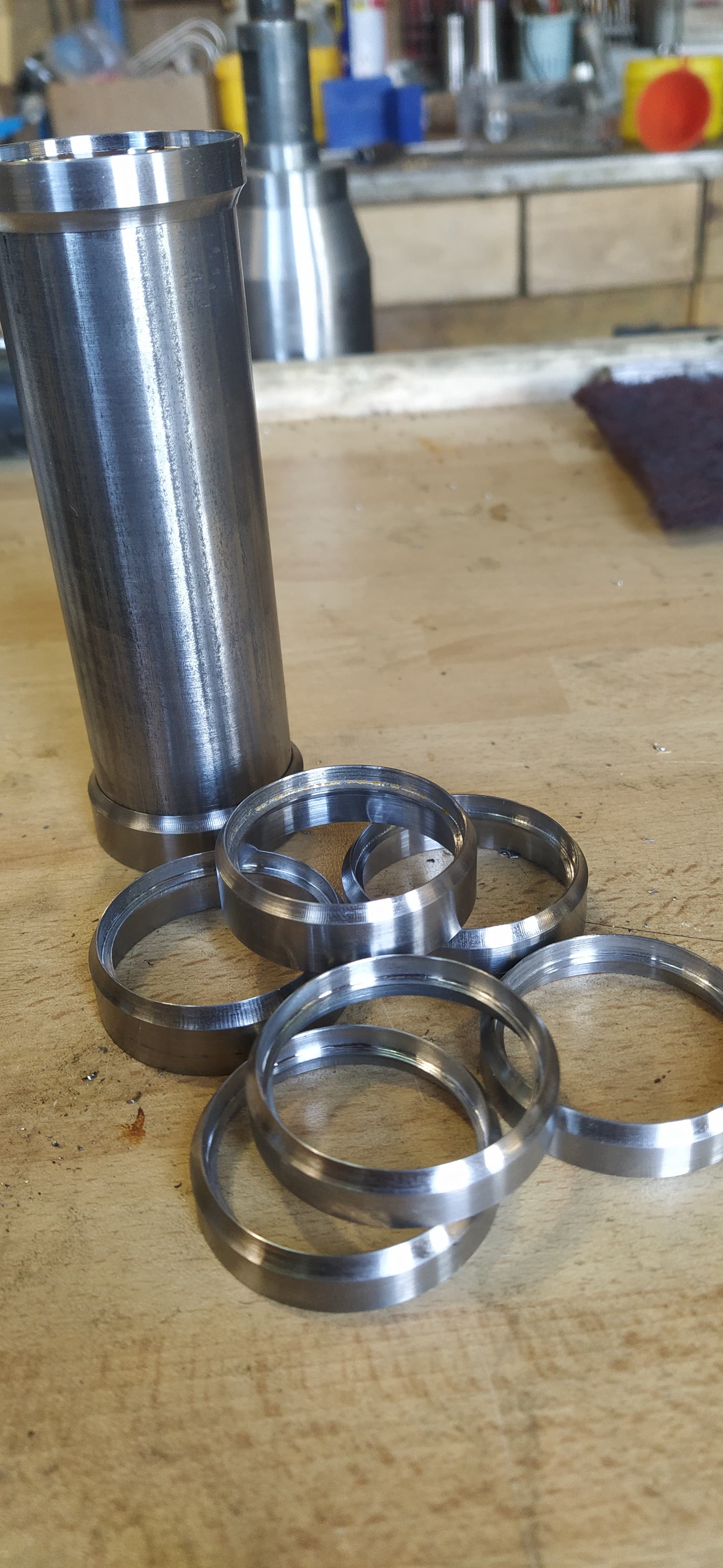

I spent two hours on the lathe this morning to make some integrated headtube rings. There my solution when I can’t get an off the shelf headtube long enough, there not really time worthy if you can find a CNC made headtube the right lenght.
Here are some process shots, I make them out of 25Crmo4 round stock
Coring out the round stock then cleaning boring pass
45° bearing sit on one face then boring the other face to tube OD ,either 38 or 40mm
Quick filet and ta-daaaa ,IS42 integrated headtube the exact lenght you want ,just need to braze /weld the cups.
Hope you like it and if you want to give this a shot and are not sure how to start, feel free to Ask
Flav
Those look great! How do you plan to attach them?
