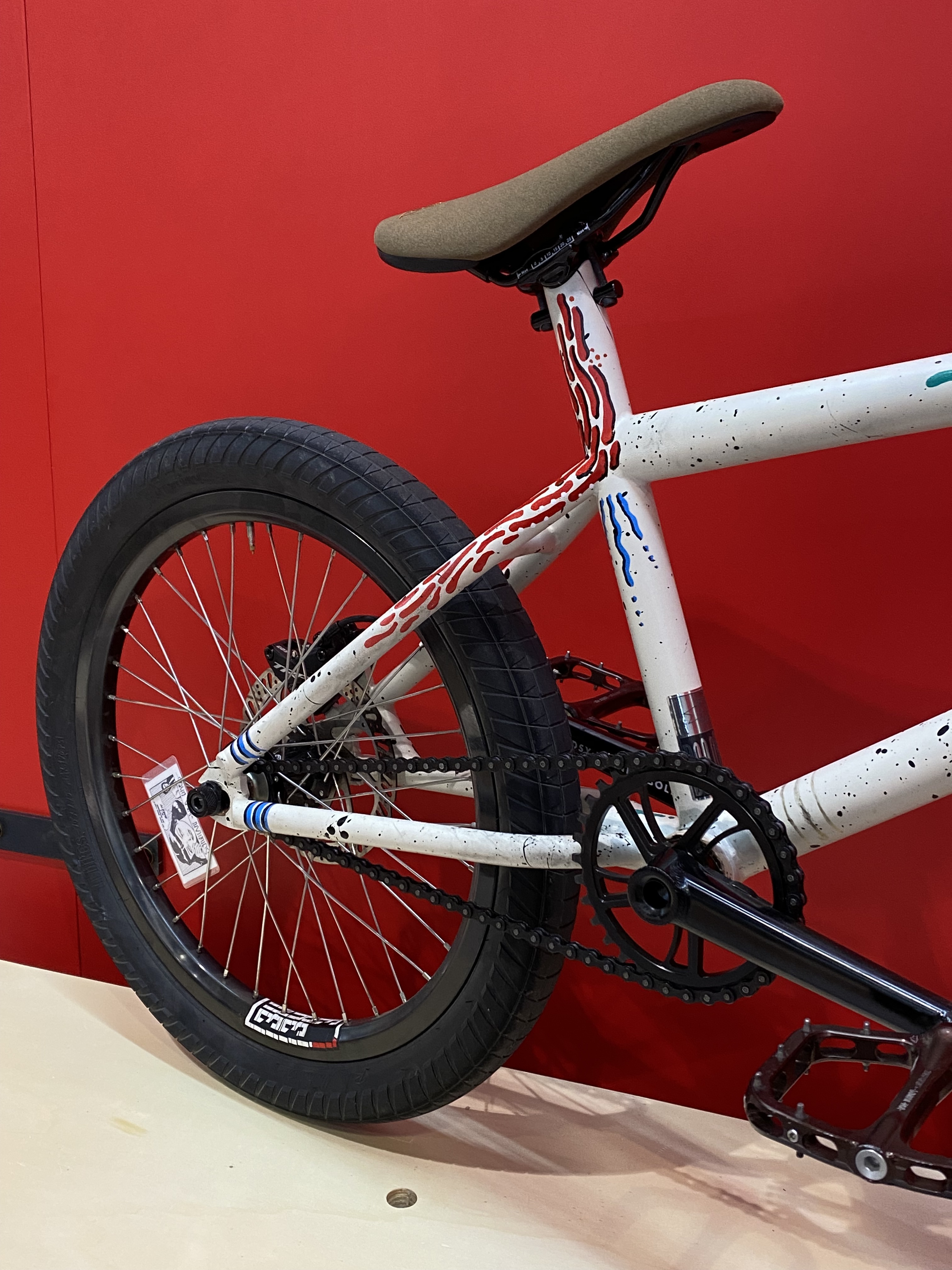

This bike from BMX50/BMX Chop Shop has some cool stuf going on. IS headtube, custom dropouts, disc brakes, carbon, etc…
Not sure how the chain tensioning works:
Finally, a good use of flatmount. looks like a 120mm rotor?

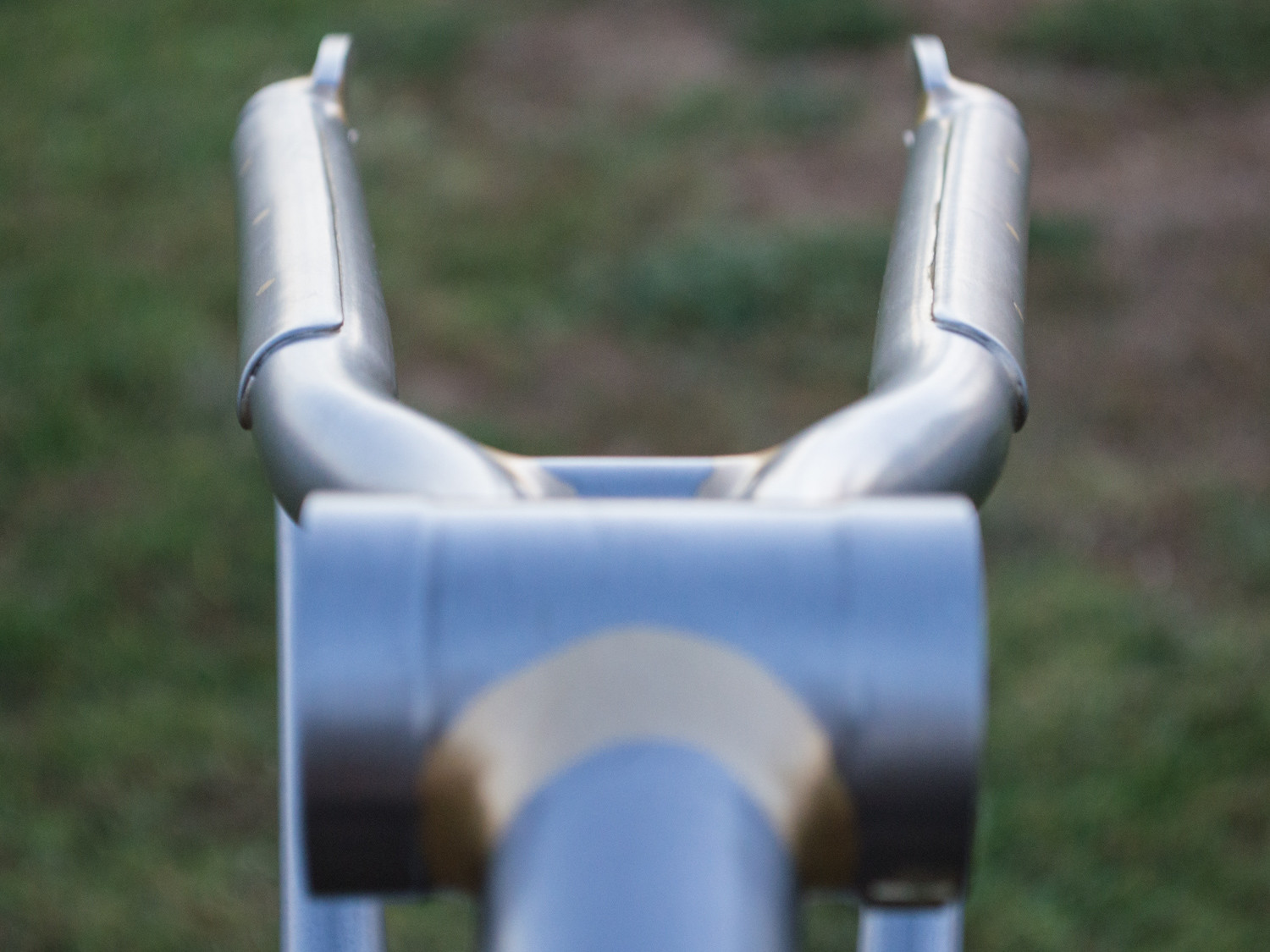

The first frame I built was a, to put it mildly, a bit of a disaster. Lugged frame, lots of improvisation during the build, and the geo ended up less than ideal.
So, why not go ahead and build a fillet brazed BMX for attempt number 2?
I convinced S&M to sell me two “frame kits” with unmitered tubes and pre-bent stays and proceeded with building a frame for myself. In 2017 I chipped away at the cutting and mitering during weekends and late evenings in the garage.
Here are some snaps from the process along with the final result.
Love the stay caps!If i remember correctly,your bmx builds were a big inspiration to me back then, were you the one that made the brazed chainstays plate/guard?
Cheers!
I think you may remember correctly. The second BMX frame I built got a pair of stainless chainstay guards.
More photos here.

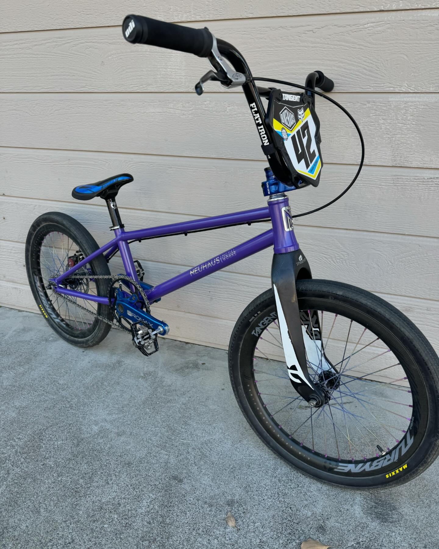

A couple of race bikes that came out of the Neuhaus shop recently.
