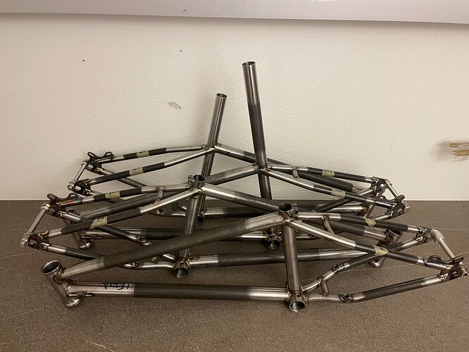

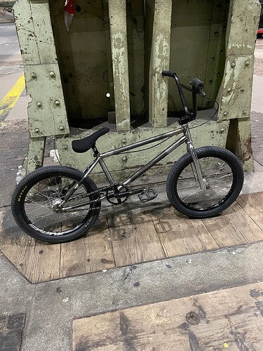

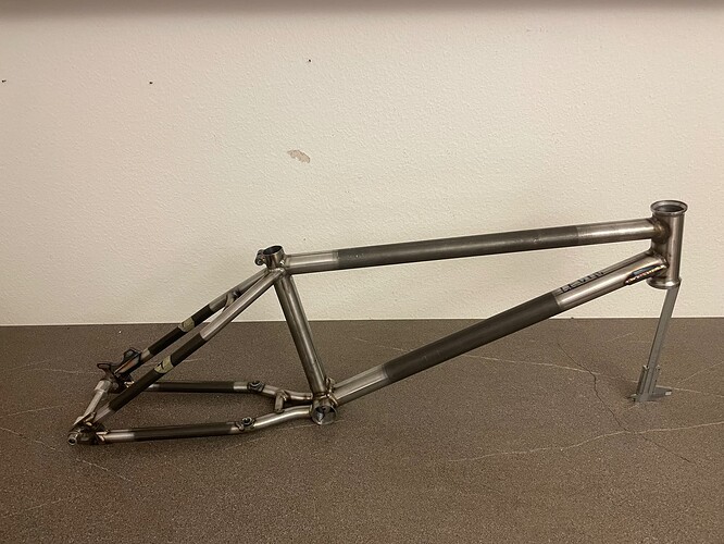

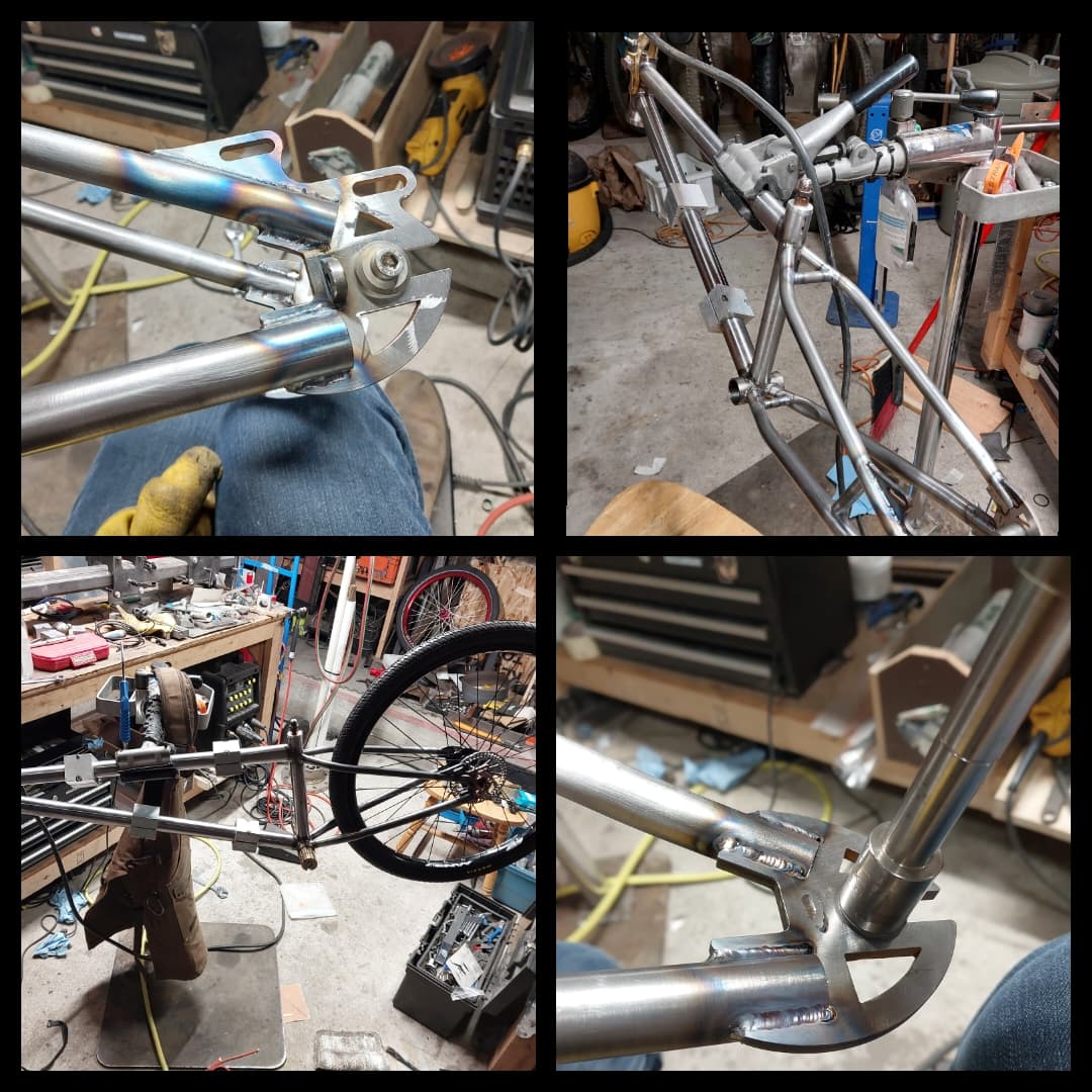

My first batch of Bike Frames:
Really stoked on how the bike turned out, 21,666“ top tube, 14“ chain stays, 11.47“ BB height, 10“ stand over, 74* head tube angle, 71* seat tube Angle, 120mm headtube (no spacer needed). Perfect for trails and transition.
It was a really weird but cool expirience to give my „baybys“ away…

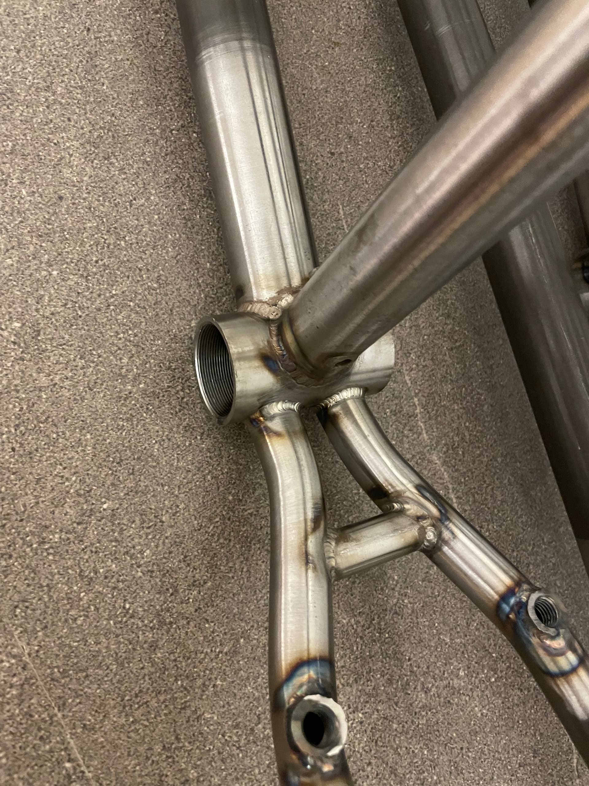

Hell yeah! Love the dropouts. What’s the end result on the long seat tubes? Pivotal or??
The seat posts are longer to get a little creative
That’s awesome!
Really cool frames!

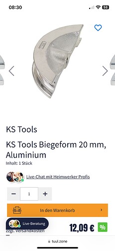

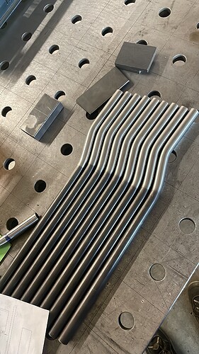

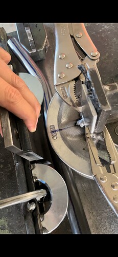

If I may ask: What tube dimension did you use for these chain stays and how did you get them bent with those two radii so close to one another?
Asking because I’m looking for a solution to build something similar :wink:
They have 20x1.5mm wall thickness, thats why they bend so well. My bending set up is pretty ghetto:
I use this pretty cheap die and a wheel for a gate with a 20mm radius for my Set up.
The bends are center to center 70mm apart, if that helps for planning.

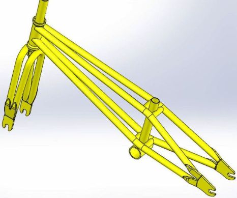

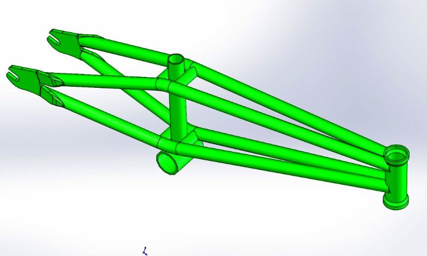

This is from my @bicycleposters IG account, but I thought some here might be interested:

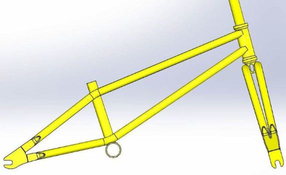

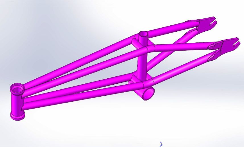

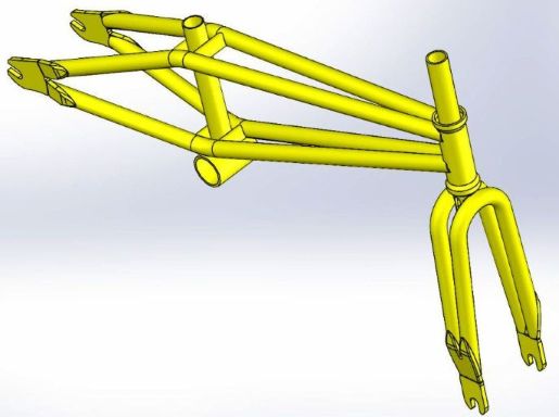

For nearly 35 years, I’ve had an idea in my head for a flatland BMX frame design, but I never actually put it down on paper. A few weeks ago, I came across a post from @standardbykecompany featuring a twin top tube frame, and not long after that, I watched some clips of @alejomarques doing his thing. Between the two, something clicked and finally pushed me to sit down and sketch out the concept.
It’s still rough and needs a lot of refining, but I’m genuinely excited about how it’s shaping up. The design has been living in my head for decades, so seeing it take form feels pretty satisfying.
I’m tentatively calling it “Three-Deuces” (or maybe “tri-duce” or “tre-due”…???), but the name fits the idea for now.
This was just a design exercise for me, but I’d love to see someone in the BMX world take a concept like this and bring it to life.
Nice concept!
The name should obviously be the “triple double”
@1:17
Ha, love it!
