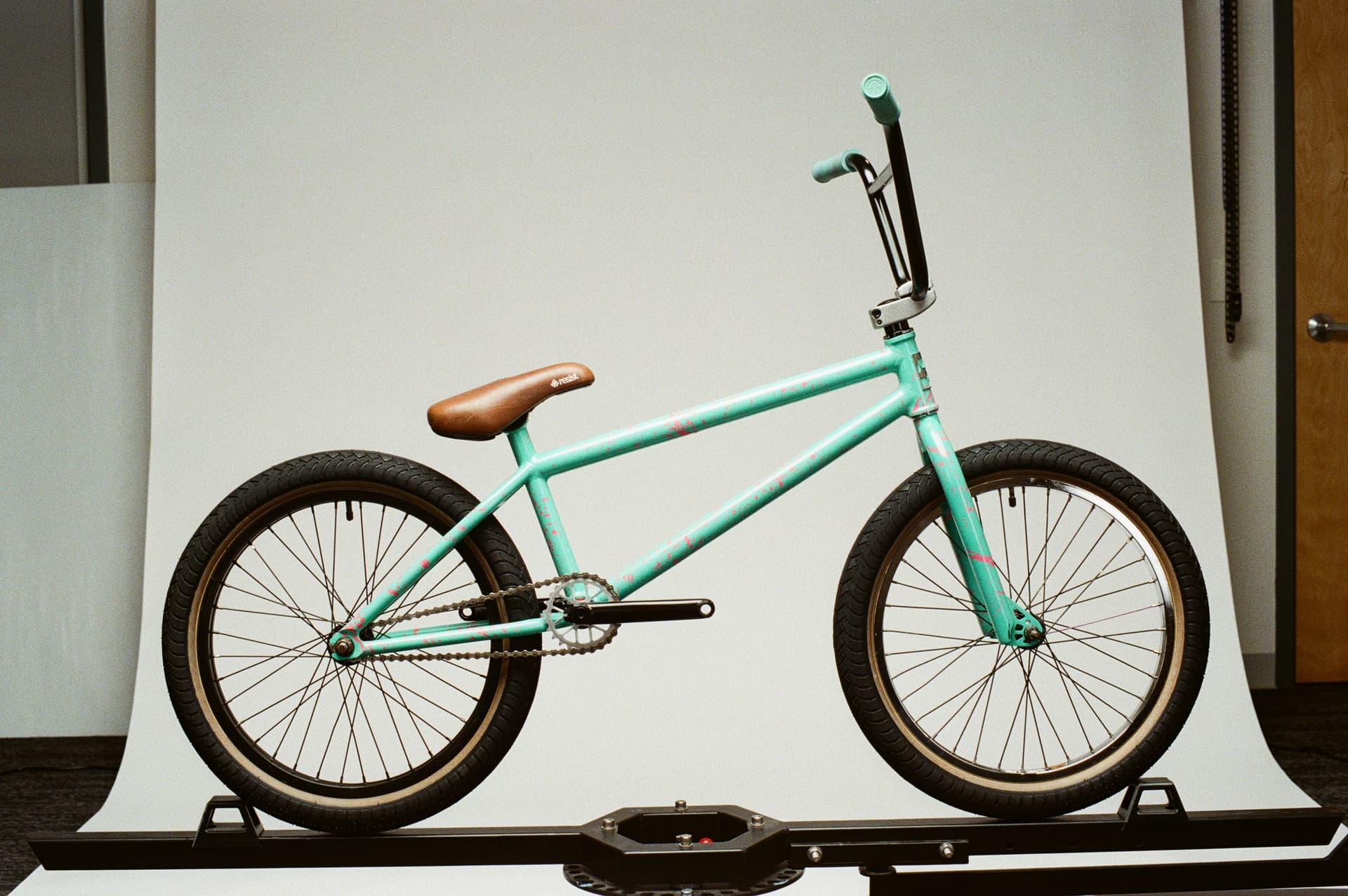

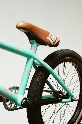

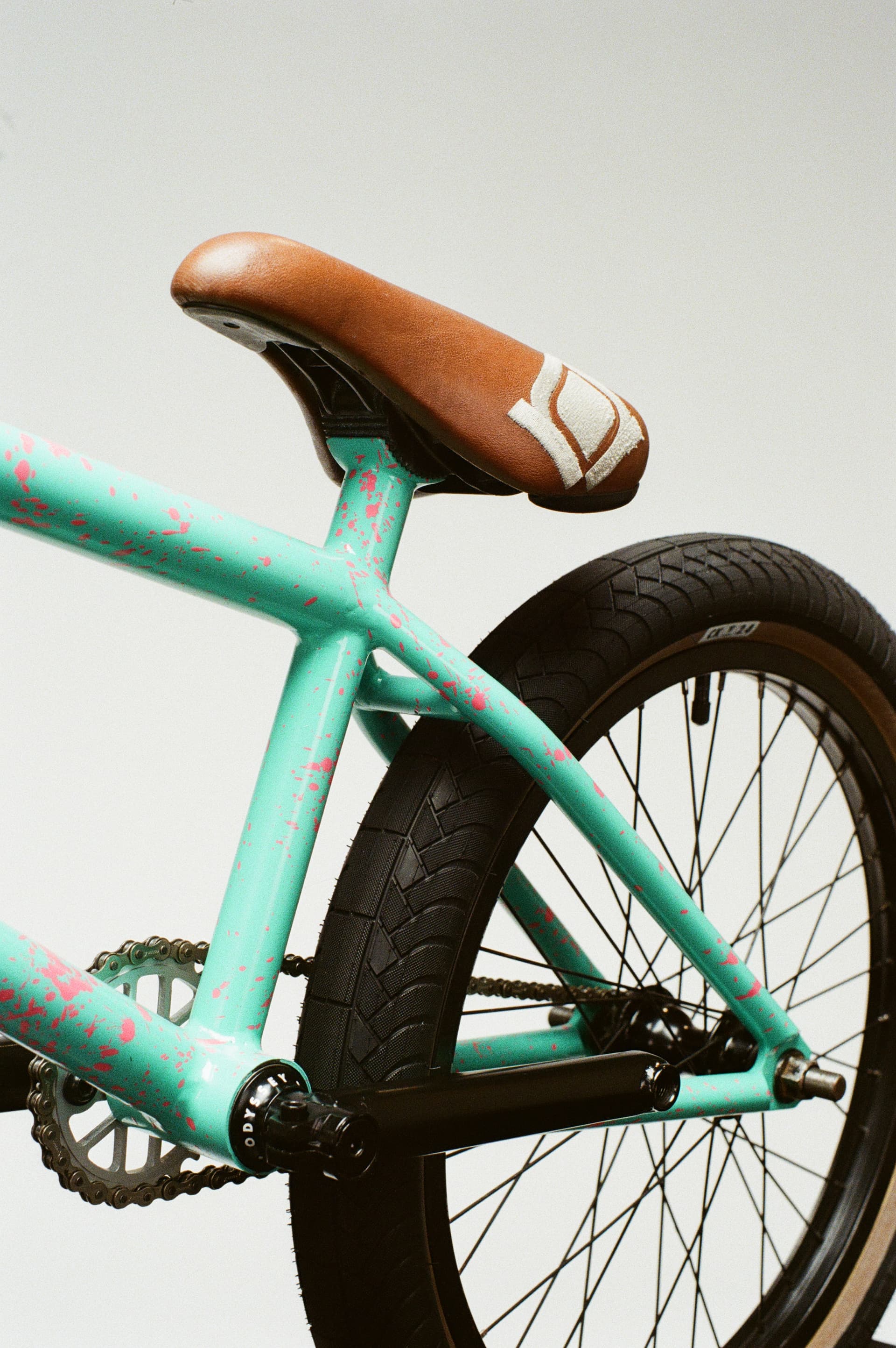

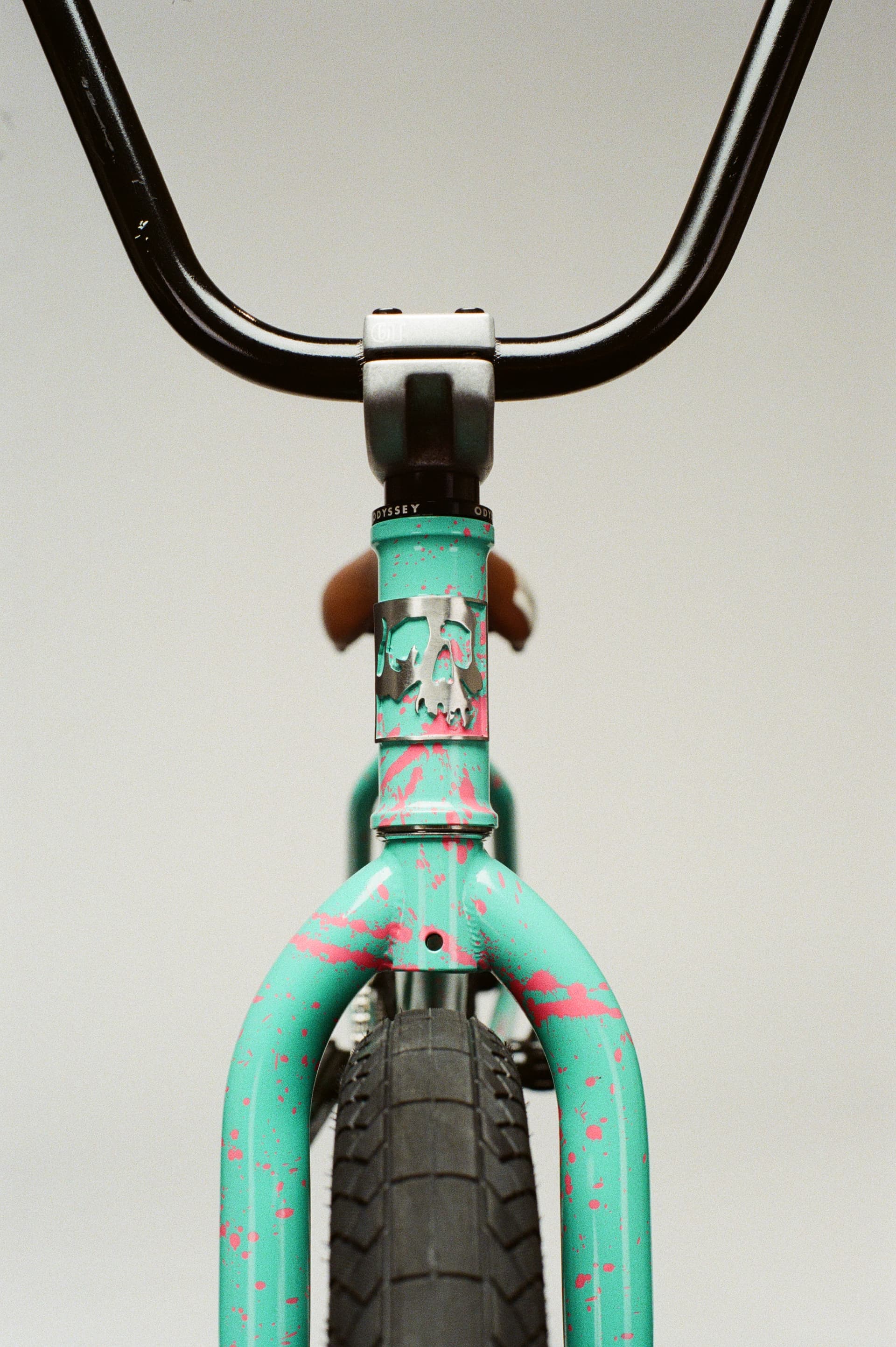

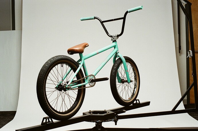

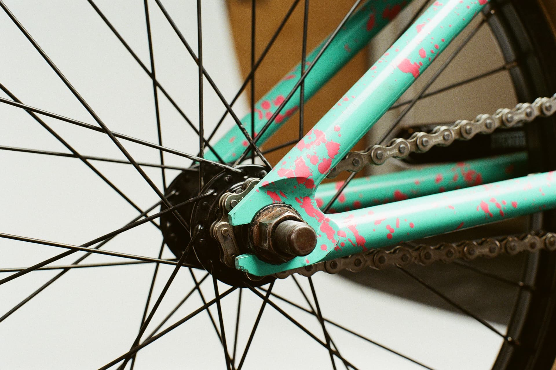

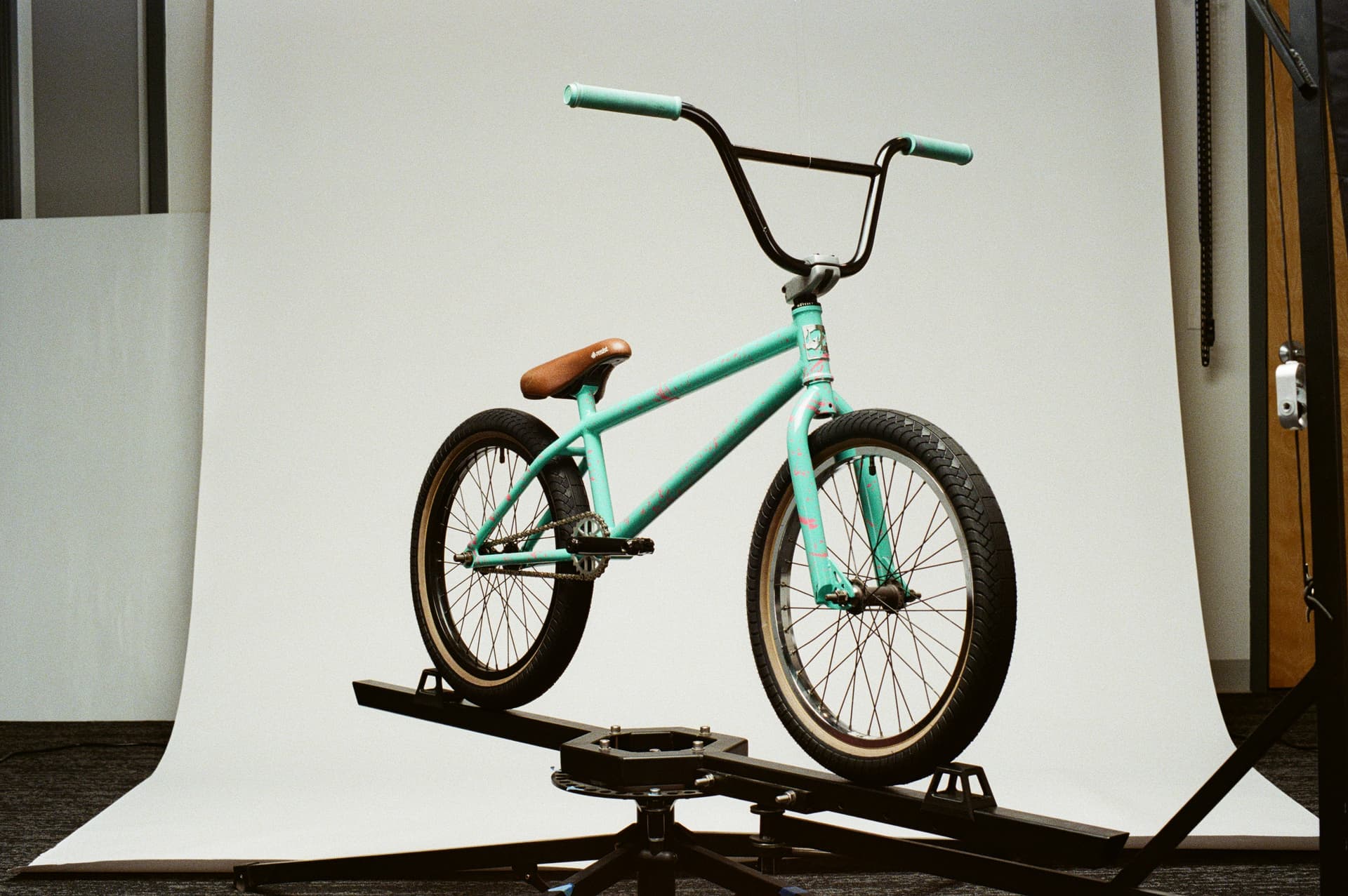

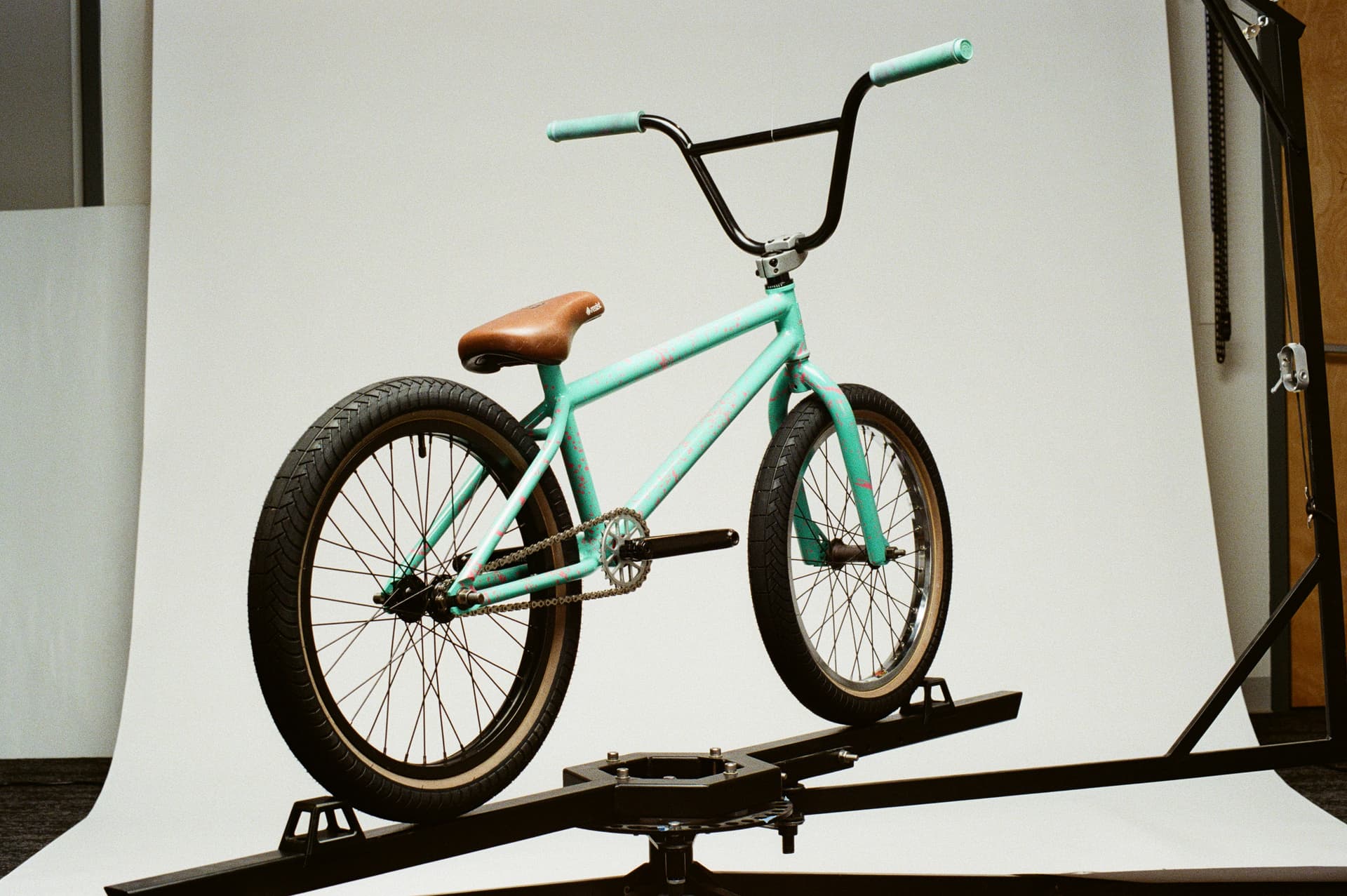

I hope nobody minds, but my two hobbies lined up for this one. I shot some photos of the BMX frame I built on my Olympus OM-1 on Fuji Superia400 in the studio at work. Because I shoot film, I don’t believe much in photoshop. (I suck at photoshop)
And a few detail shots of my favorite parts.
sick shots! i also shoot film haha.
shooting bikes is rough, you killed it
Thankfully I had my coworker who is our photographer help me set up the flashes and test out the correct settings on his digital camera. Once that was done, it was easy. I only had one photo not turn out. It was a fun challenge.
i don’t think most people will realize how sick those came out, film’s hard. getting things right on digital first is totally the move
