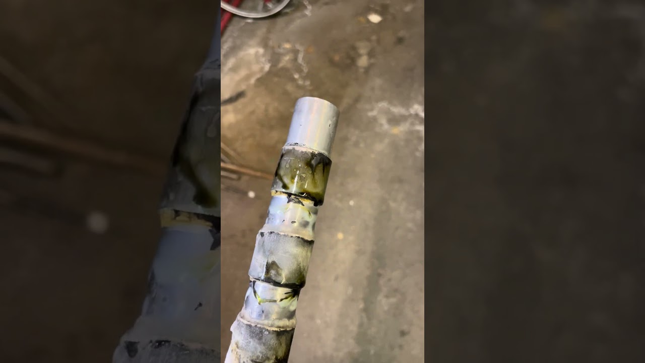

Hey Guys…
Took all of your advice and gave it a try again.
Lots of flux, internal and external heating etc.
The flux really helped… @project12 thanks :slight_smile:
It gave me a bigger window before frying stuff… Even then, the flux got fried in the 1st attempt :slight_smile:
But the 2nd and 3rd attempt weren’t so bad… Less burnt flux and good coverage. Probably I over heated the inside part as there is no line of sight. But it’s better than no heat at all.
The silver hasn’t come out from the other end yet… But there is good coverage (I cut it open to check.)
Will keep trying…
@Duanedr didn’t try with bronze yet… But will give it a shot after I figure this out. Bronze solder sounds pretty interesting :slight_smile: .Thanks for the gap profile info.
@Johnmarmalade Thanks for the encouragement. Trying the flicking game. Will learn someday :slight_smile:
Shot a video and a few pics… But can’t upload the video from my phone for some reason… Will try from the system soon.
Feedback from your video:
-pre-heating everything way too much, so when you get in there with the torch the entire workpiece is already hot and you only have a couple seconds (literally) of working time before it overheats/burns.
-too much time with torch on the workpiece, generally in brazing and especially with silver, you should be backing the torch away every 2-3 seconds for about 1-2 seconds. Brazing temperature is a small window from liquid to boiling/burning, and your goal is to keep the temp essentially just above liquid but well below burning, but with a torch that is much hotter than your working temps - so you have to remove the heat input frequently to not overheat.
-workpiece is too hot and flux is burning before you are even getting on the edge with your silver. Silver is also very sensitive to contamination, and it won’t flow/stick to where any burn is, so if the inside of that joint is burned, it won’t flow through at all regardless of how much you do with the torch. That’s why it’s all stuck in a lump on your edge there.
-hard to tell exactly from the video but based on what’s happening with the flux, your torch is still too hot or is oxidizing flame. Try a smaller overall cone and make sure you are not oxidizing - slightly carburizing/reducing flame (tiny bit of a shadow around the cone) is preferred for silver. If your torch is oxidizing at all, everything is going to burn crispy black before you can get any filler in.
  • moving around too much. If your goal is to get filler to flow from the top to bottom of the piece, you have to slowly give the filler a pathway with heat. Even if the distance is only say 1” total, you can’t jump from top to bottom of that distance with the torch and flow it through - there’s probably a cold spot in the middle somewhere. Break it down into 4 smaller sections no more than 1/4” at a time. Pull filler from top edge to just a 1/4” bellow edge, back off for a sec. Then go from the bottom of that section down again 1/4”, back off to cool. Repeat again until you make it to the bottom of your piece/joint/lug.
  • for your practice pieces drill some holes about halfway through the piece from the top. This can give you a visual if the silver is flowing at all. If you are adding from the top edge and silver is wetting out the drill hole, you’re at least getting it to that depth on the workpiece.
Also some folks have referenced the working temps and the heat chart which is great to keep track of, but a good visual rule of thumb for silver is that if you’re getting any colour on the metal (seeing any red at all) it’s too hot. You should be below red base temp on the workpiece at all times.
Thanks for these… Understanding the pattern helps to learn the dance!
This makes things clear!
Thanks Danielle for your inputs. (As also all the folks above.) These should work as markers on an uncharted road (cairns). Was getting a bit frustrated at the lack of results. Will try again by working on rectifying these issues.

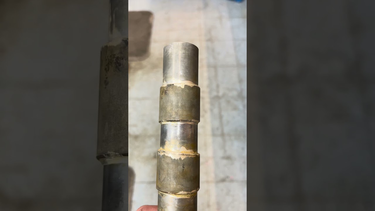

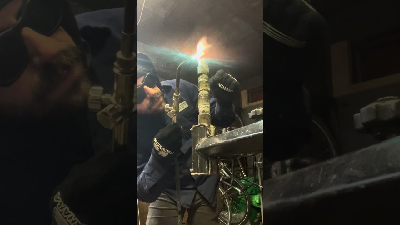

Highjacking this thread instead of creating another brazing advice thread, I’m seeking advice on how to improve my silver brazing.
I’d say I’m relatively comfortable with fillet brazing with bronze, but I have little experience with silver. Currently I’m practicing with 1” long sleeves of 1-1/8x0.058” tubes over a 25.4x1mm tube. I’m using Gasflux 56% silver with “U” type flux. I’m running both Oxy and Ace at around 6psi, dunno what tip number it is but it’s around 1mm. Prior to brazing everything is sanded with 100grit in the direction I want the silver to flow, and cleaned with isopropyl alcohol.
After a number of these practice sleeves I think I’m getting some results, but there are a couple of things I’m struggling with. Notably, when I first start adding silver, I seem to have a hard time to make it flow all the way down. Instead of staying there and overheating everything, I just keep going and as I go it seems to get easier to make it flow. Then when I went all the way around the tube, back to the start I can easily see the silver now flowing at the bottom. So i do manage to have full penetration all around but can’t seem to do it from the get go. I’m not sure if preheating is the issue? Down below there is a video of the last sleeve I’ve done, which seems to be the best one I’ve done so far. Then videos of that same sleeve right off the torch and without flux after soaking.
The first couple of sleeves I absolutely couldn’t get the silver to flow through. Then I started concentrating the flame a bit more on the base tube instead of the sleeve and things started to improve and could manage to bring the silver all the way at the bottom, but not quite everywhere.
In general I feel like I tend to overheat, especially seeing the color of the metal when rewatching the video and the flux looks a little burnt to me. Anyways any advice about my technique in general would be greatly appreciated, thank you!
Your practice piece is difficult because you have a sleeve without much mass on a thinner, but relatively massive tube. It looks like it is easy to overheat the sleeve without bringing the tube beneath it up to brazing temp.
I think what is happening is the silver begins to flow better because you’re bringing the inner tube up to temp at this point.
What is your goal with silver brazing? If you want to build a lugged bike, Have you considered buying some less expensive lugs to practice with? When I started learning to make a lugged frame, I really appreciated being able to braze a practice joint and split the joint down the middle to inspect penetration. I think you will find lugs to be easier because there is more of the tubes exposed to preheat before you heat the lug itself. Disregard if that’s not your goal though.
If your goal is to silver braze seat tube sleeves, I think you will find it easier to practice if the sleeve is closer to the end of the tube so you can get some heat inside of the tube and also bring it up to temp faster without heating your previous practice pieces and excess tube beyond the sleeve.
Thanks for your advice!
For the time being my goal is mostly to be comfortable enough with silver for its various applications, like eyelets, dropouts, fork crowns, etc. I would like to build a lugged frame eventually but I generally favor fillet-brazed or Tig welding.
I did think that these practice sleeves are probably a little hard since they don’t have cutouts like most lugs would. I just thought it would be a good way to get acquainted with silver and have a better idea of how it works.
