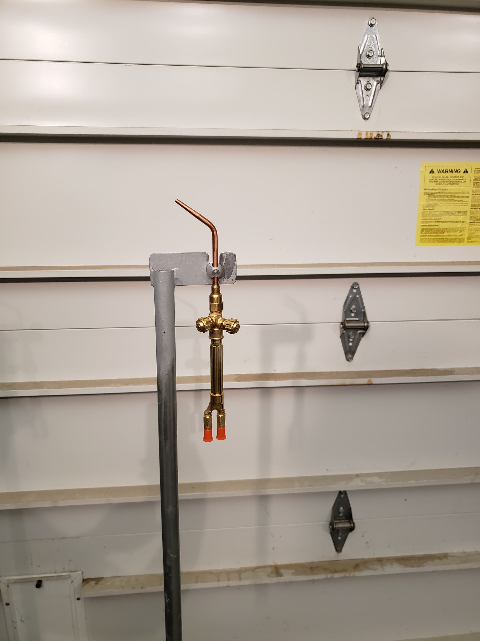

For what it’s worth… I think most people are using the Victor J28 or the Smith AW1A or clones of them. If you use a torch hanger it doesn’t have to be pretty but please make sure it’s secure. This is my J28 and hanger.
