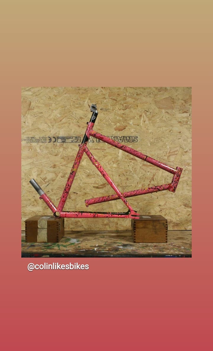

It’s a hinged clamp that encompasses two brazed in lathed bits. The lathed bits flare out from the nominal downtube diameter so that in the axial direction you have a mechanical joint stretching the hinged clamp rather than relying on just friction grip. It only relies on friction-grip in torsion.
good photos here:
If you want to make a lesser ghetto version then you can absolutely make that work too. I did it just with some seatclamps an angle grinder and an old seatpost (link below). So only relying on friction grip. This was for a polo-bike so a bike that i travelled with a lot. I forgot to do the downtube bolts up properly once and when ridden the bike felt like it was going to collapse underneath me. I imagine the legit ritchey version is a bit more forgiving in that regard.
