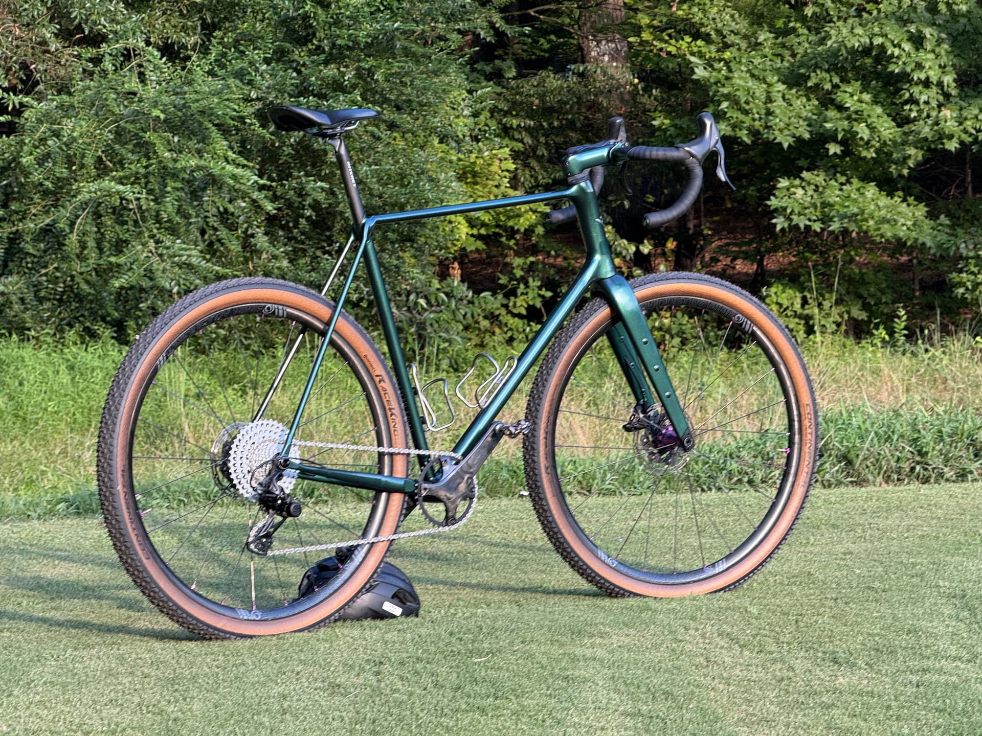

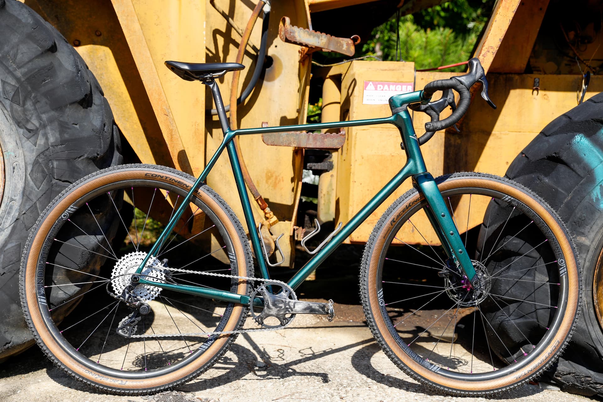

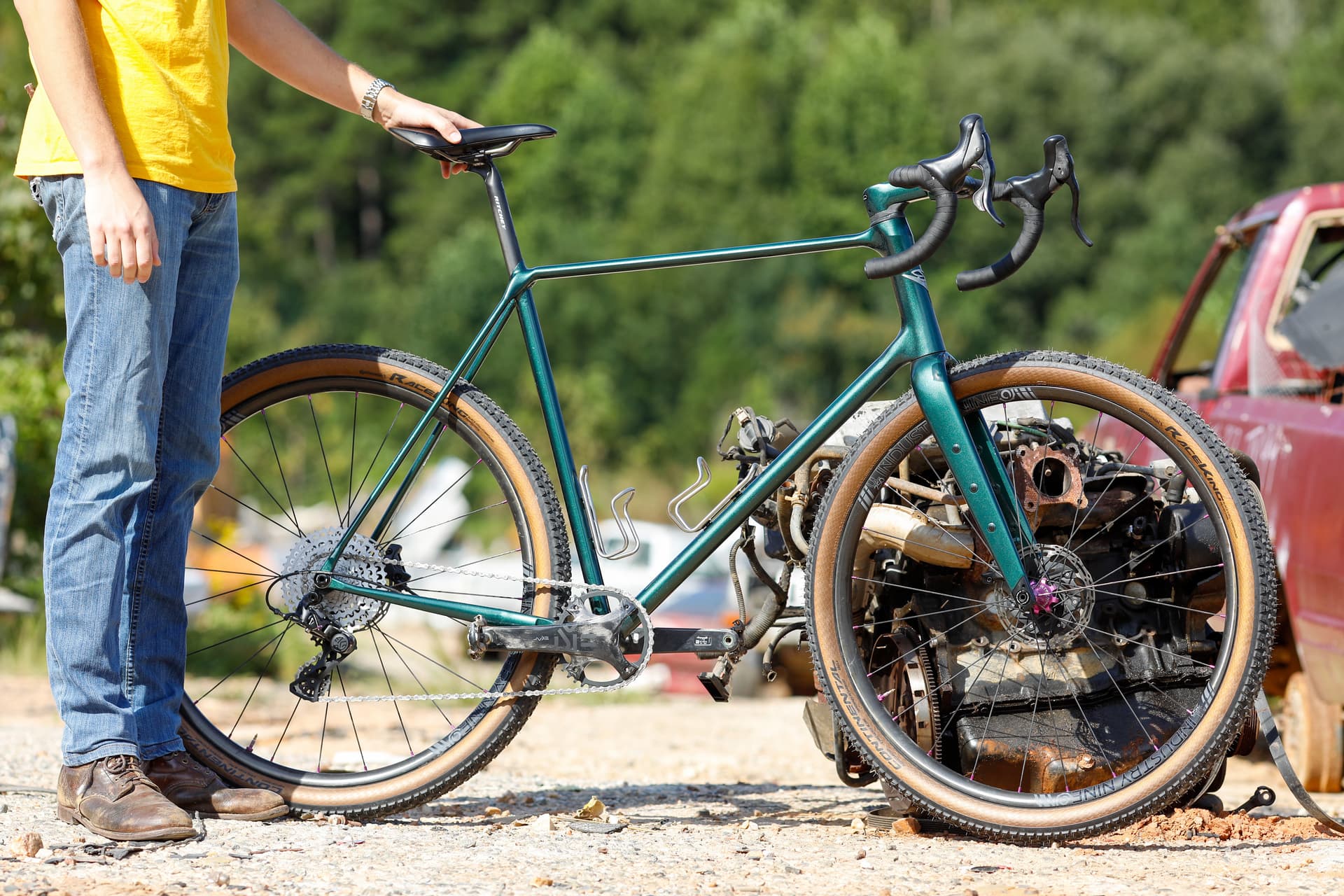

Hi all- long time lurker who’s slowly been working through my first full bike build. Wanted to attack a modern gravel race bike that could clear some big rubber (2.25”) and also play with a few modern components i’ve never touched (internally routed cables, Ekar groupset, etc). Finished product:

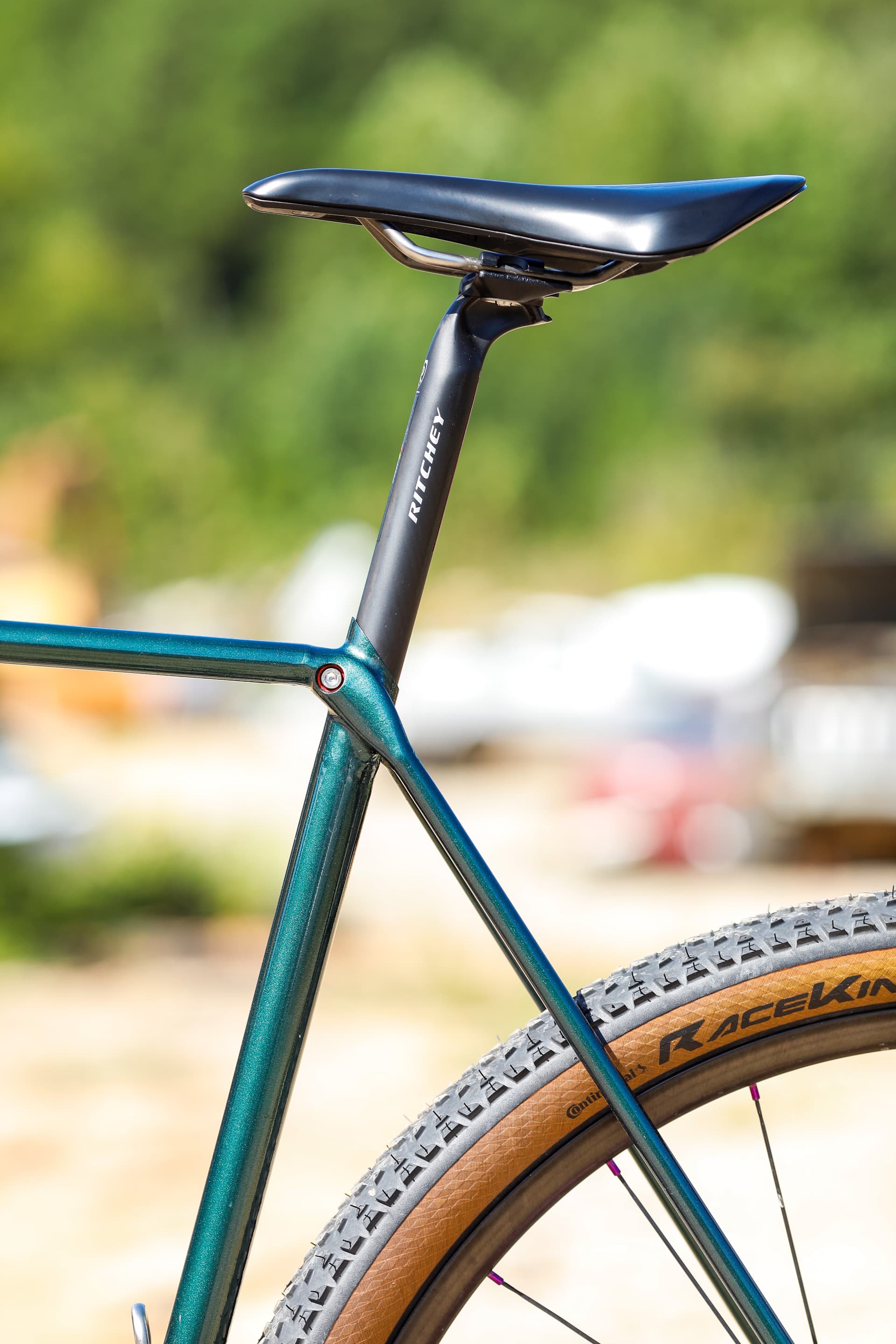

The seatpost wedge system was a design I borrowed from an early '00s Trek stem (which i asked about here!). Another benefit of 3D printing are the blind features required to pull it off which would never work otherwise! Seems to work great, but time will tell how it holds up. I’m pretty happy with how beefy it seems relative to some of the carbon frame solutions i’ve played with.

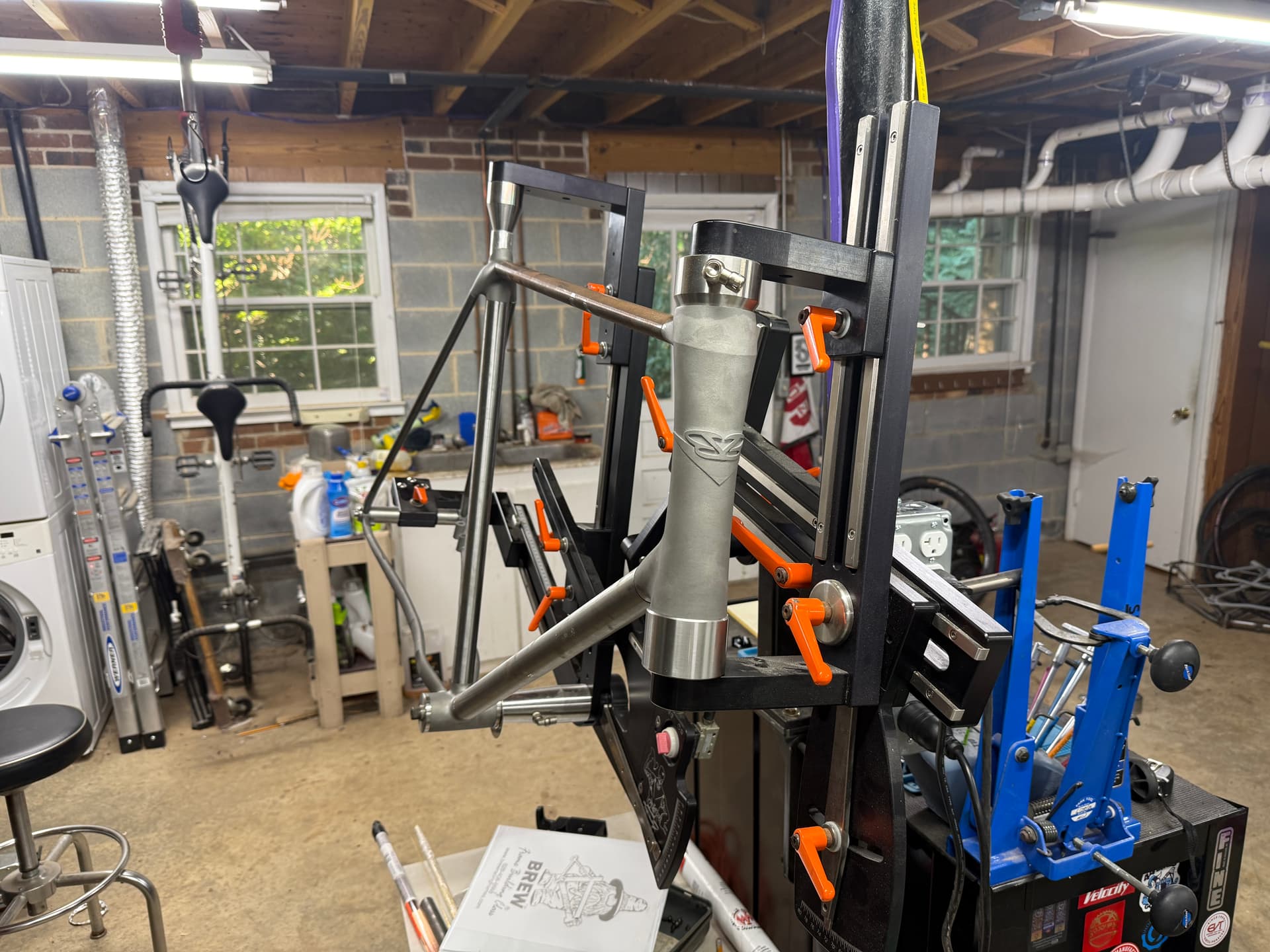

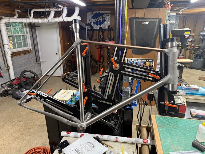

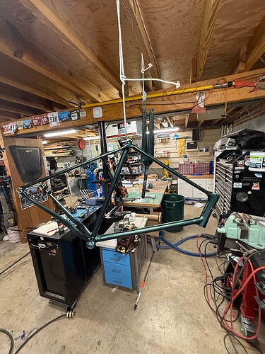

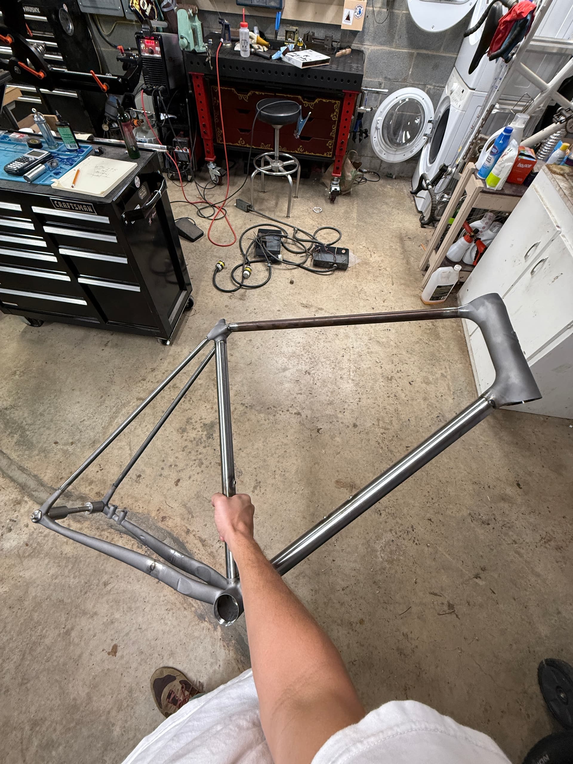

Cutting the tubing was extremely straightforward due to the lack of miters, as was initial fitup and tacking; i was concerned the heat treat would significantly warp the parts, but the only parts with any noticeable deformation was the chainstay halves, which i was able to tweak into place easily. Not the best welder in the world, but I was fairly happy with how it turned out. For a first frame, I tried to give myself a bit of grace that I know it won’t be perfect, but i’ll learn a ton.
Couple of learnings for the group from fitup:
The ovalized toptube has an outer profile that almost perfectly approximates an ellipse, but the inside of the tube has a vastly different profile that shows how it was formed. Since i have “sockets” that the tubes fit into, I had to grind these out on the toptube to get it in place. Easy to fix for next time, but for anyone doing something similar on formed bike tubing, buy the tubes first and verify the inner dimensions.
Check your clearances! Still have to investigate this, but the only real “issue” i hit with fitup was that the clearance to my native 160 FM bosses on the chainstay was about 0.5mm to the rotor! some quick work with a grinder solved this and it’s basically invisible, but that’s the only part of the frame design i didn’t triple check (as i didn’t have a rotor modeled). Oldest lesson in the book for sure, TRUST BUT VERIFY.
After welding, I used a band file to grind everything flush. Had plenty of access around all my joints, which certainly isn’t hurt by the fact that the frame is so huge :). definitely need to be careful at this step as it’s easy to forget how thin the tube walls are outside the welds, and how quickly you can make a big mistake! I have a super undersized compressor for this kind of tool, so was running way under the proper pressure for most of it. I left to get a drink of water which let the compressor pump up to full beans, and i proceeded (without thinking) to go at it with the same vigor as before, and filed a hole in a tube, which i then had to go back and patch. Mostly though, it was a great experience and I think this type of bike frame construction really helps those of us who suck at welding have simpler paths to trace while skills improve.
After welding the bike up, I did a rough check of alignment, where i found it’s mostly fine, but definitely induced some skew at the BB area. I realized I had fit up the BB shell in my jig at a slight angle by using the wrong spacer! At this point, knowing it’s my first frame, I decided to just charge ahead and accept that it might be a bit wonky.
All the frame machining was pretty straightforward. The 17-4 material machines really nicely, and i observed zero porosity in the freshly machined bearing seats/BB area/rear axle. This gave me a lot more confidence in the supplier/material.

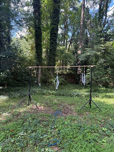

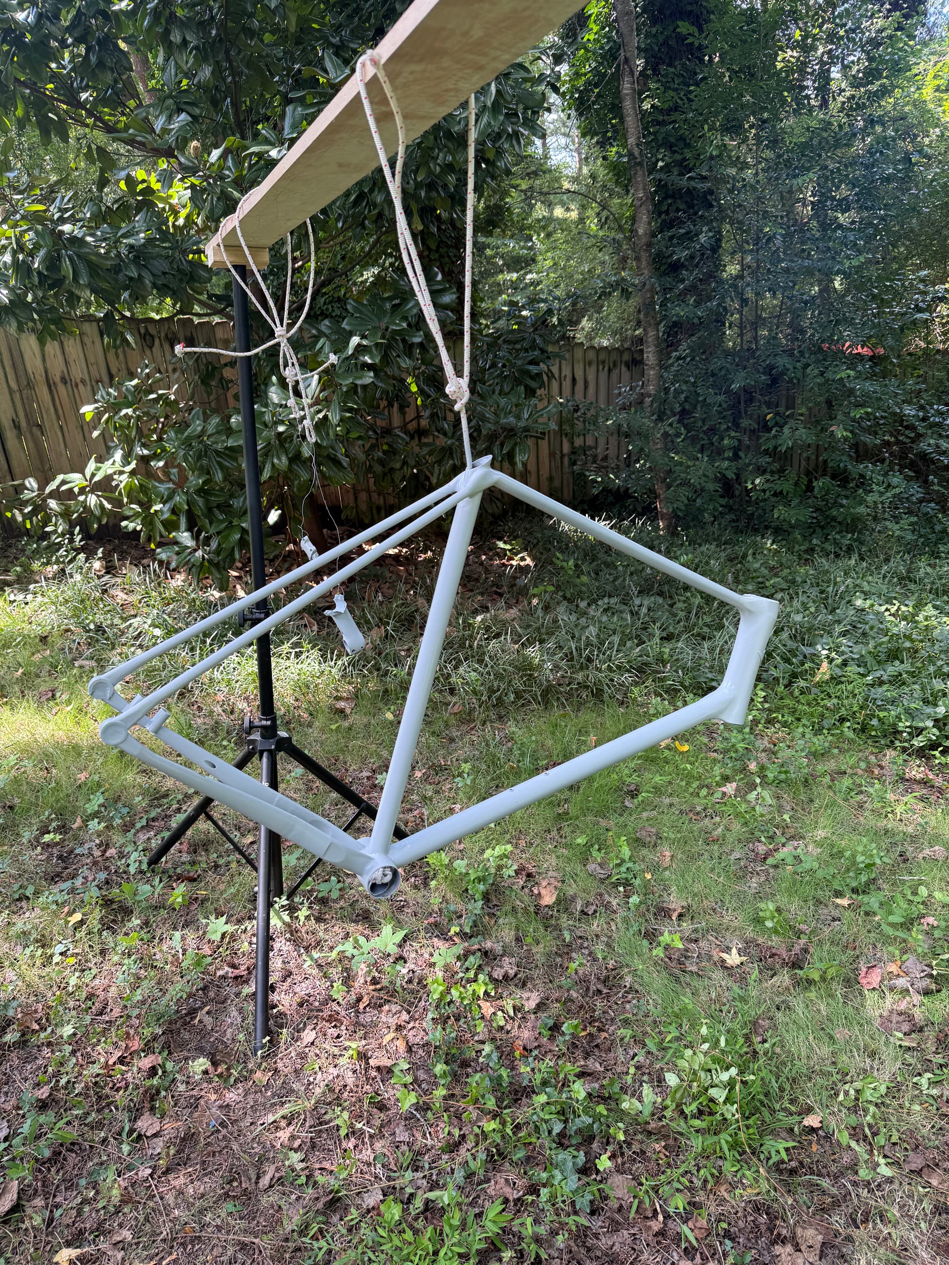

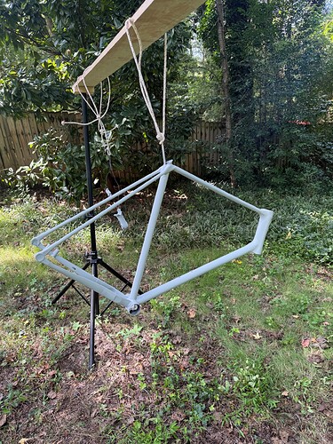

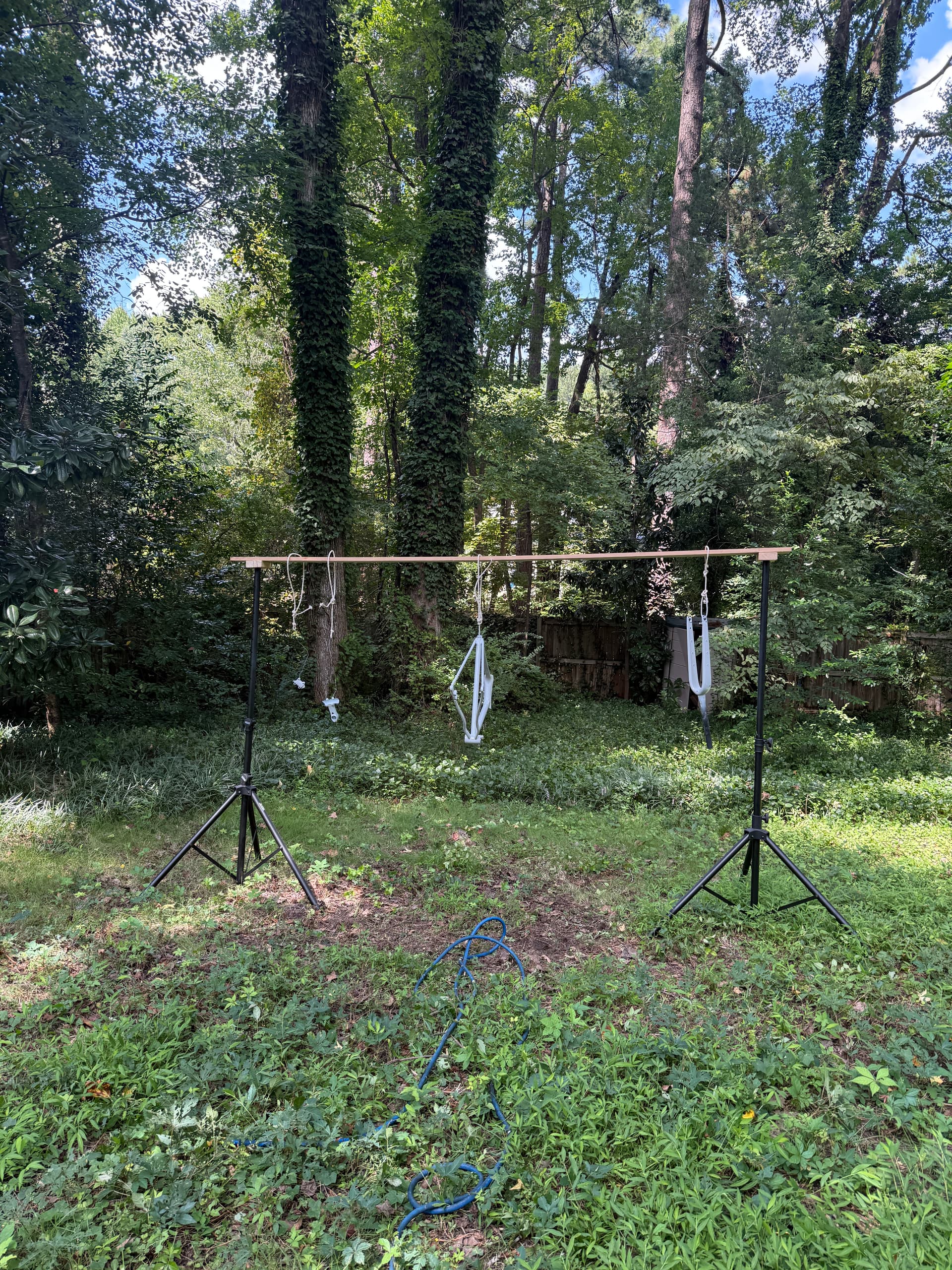

Painting is a bear in and of itself. This is my first bike but i’ve been a tinkerer all my life, so have done my fair share of urethane painting. That said, my current workshop setup is very un-conducive to spraying, so just made the best of what I have. I’m using Urechem paint products, which you can easily by cheaply online and shipped to your door without the hassle of the local paint shops which seem to hate shadetree guys like myself coming by and bugging them. I set up what I like to refer to as the most expensive windchime in history in the backyard with all the parts for the build and went to town. No real issues with the setup other than you just have to accept that it’s never going to be perfect working outside like this, and by the time i was putting clear on, the sun had mostly set, which is worst case for getting a good sheen. C’est la vie.

Painting overall went great- I didn’t do a good enough job removing the ink transfers on the fork (a Rodeo Labs Spork), so in the right light you can still see the outline in reflections. I think if I wanted to I could pretend it was a deliberate choice since it looks kinda cool, but it’ll stay the forum’s secret that it was totally on accident :slight_smile: . The bead blast finish from the 3D prints mostly disappears after primer/sealer, and paint went on really nicely overall. I struggled a LOT more than expected getting a good finish on the carbon fork. I’m not totally sure why it was laying down so differently but I couldn’t get nearly the sheen I was able to achieve on the metal parts. More experimentation here needed for sure. I assumed the fork would be the easiest part to paint since it was so uniformly perfectly smooth, and is mostly big flat sections!

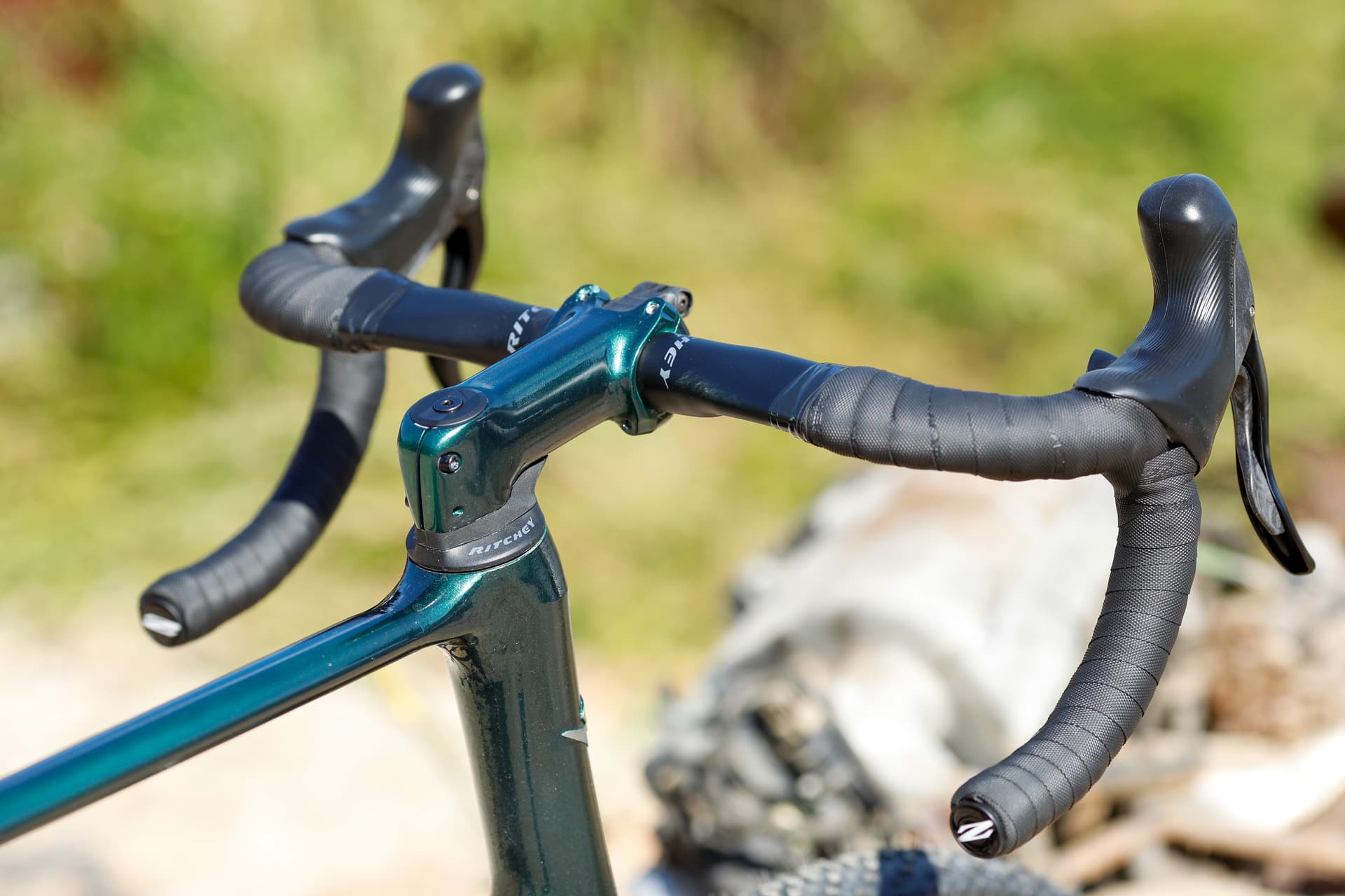

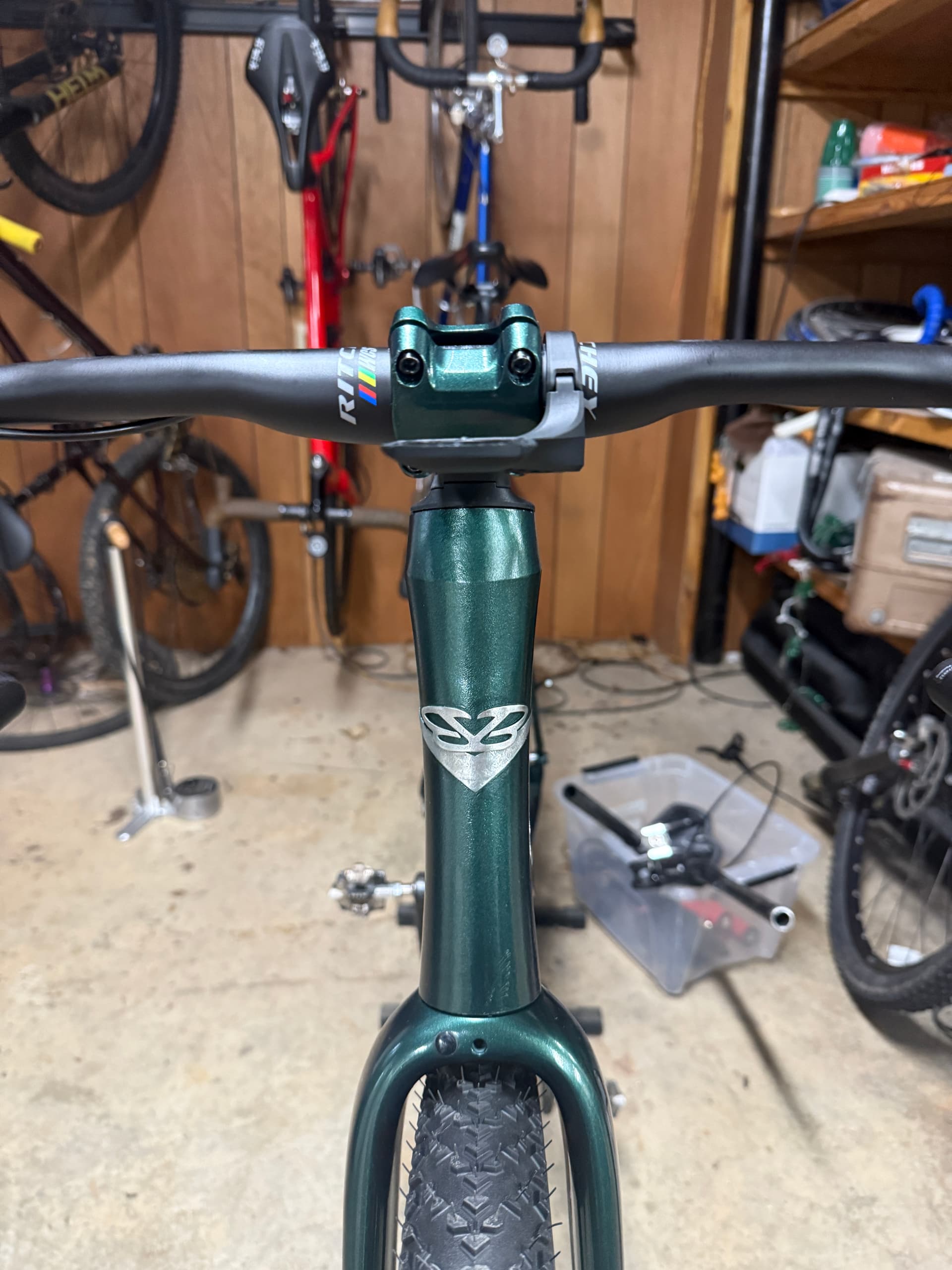

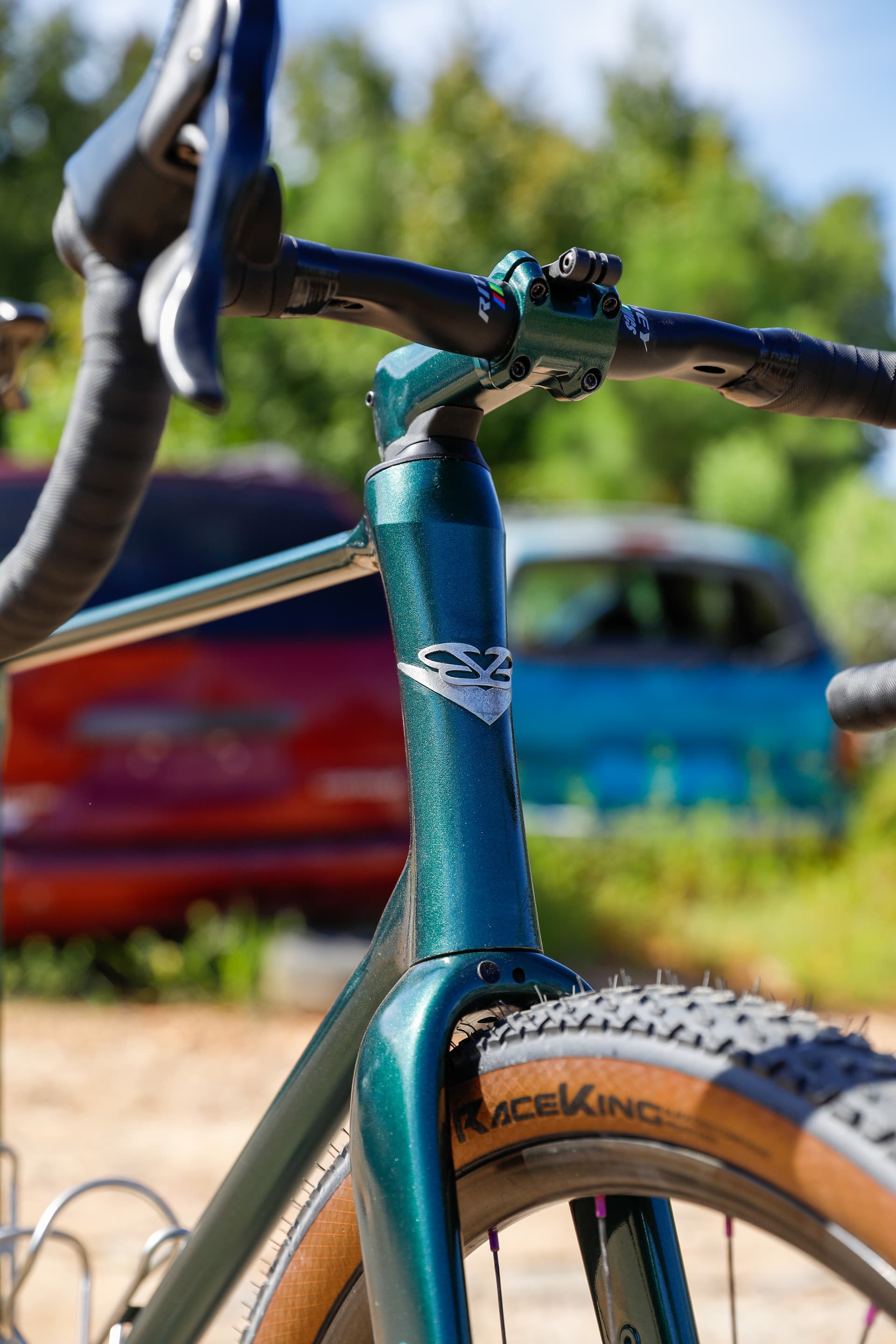

Since the “head badge” is printed directly into the headtube, all it took was removing the paint mask and buffing it out to get it shiny. I really love the two-layer affect on it, and how you can see just a bit of porosity in it which helps reinforce it’s a PART of the bike. Otherwise, I did a pretty bad job in some areas masking off paint which meant a bit of effort after the fact cleaning it up- i’ll definitely be 3D printing paint plugs for all these areas next time to make it much faster and easier.

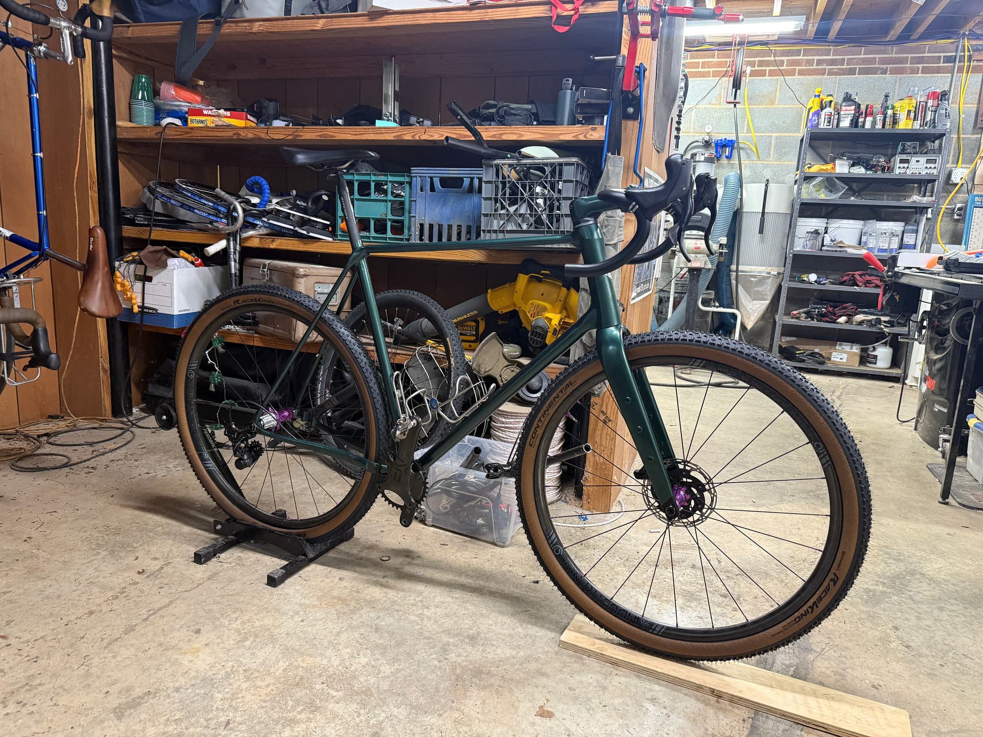

Assembly was it’s own challenge. This is my first bike trying out fully internal cabling, and my experience was pretty similar to the stories i’ve heard- namely, it’s not HARD per se, but boy is it frustrating to spend an hour trying to fish a cable through a single tiny hole. I wanted to experience it myself, and now I can say I have. It’s really not that big a pain for me personally as I’m not a pro mechanic doing this kind of thing for 8 hours a day, but I totally sympathize with how people see it, as it’s “work” that doesn’t feel productive or even rewarding of the same skills we use in other aspects of bike maintenance. Some tips and tricks I found along the way that might save someone:
Campy installs little fittings at the ends of their brake hoses that seat a shift cable into them which you can use to pull the hose through the frame. This was super helpful in some places and not worth it in others, but a great idea that all manufacturers should do. My secret weapon for this build was adhesive lined heatshrink, which I used to join housing to cables, or hose-to-hose end to end. Gives plenty of bite to be able to yank on cables, there’s no rigid section that makes going around bends hard, and the the super thin walls didn’t create additional resistance. Just snip the end off once it’s pulled through and you’re done.
I swear I had to assemble/disassemble the stem and headset area of the bike 7 different times through the build as I was working through it, definitely some beginner stuff that with a process in place wouldn’t be an issue. My biggest screw up which will live in infamy in my brain- after working for hours to get all the housings routed and terminated, i was finally ready to bleed the brakes, when I realized I’d routed the wrong hoses to each caliper! I refused to be defeated, so decided to swap the banjo fittings at the brake levers, which involved some truly sketchy tugging and pulling of that fitting through the handlebar holes. Lots of cursing and wasted time to avoid having to start all over. Will DEFINITELY be labelling the hoses from now on to make sure this never happens.
Last screw up- this is my first time with Ekar shifting, and when I cut the shift housing to get a nice generous bend, I didn’t realize the derailleur was in a “locked out” state which makes it easier to get the rear wheel out. Consequently, when it’s “unlocked” for actual use, the housing is too short. It works good enough for me to get some miles on it before trying to pull a new housing through, so going to chalk it up to inexperience and fix it later.
Generally the assembly was only marred by self-inflicted wounds caused by inexperience. In future builds I’m confident I could eliminate most or all of these hangups and have a pretty straightforward assembly.

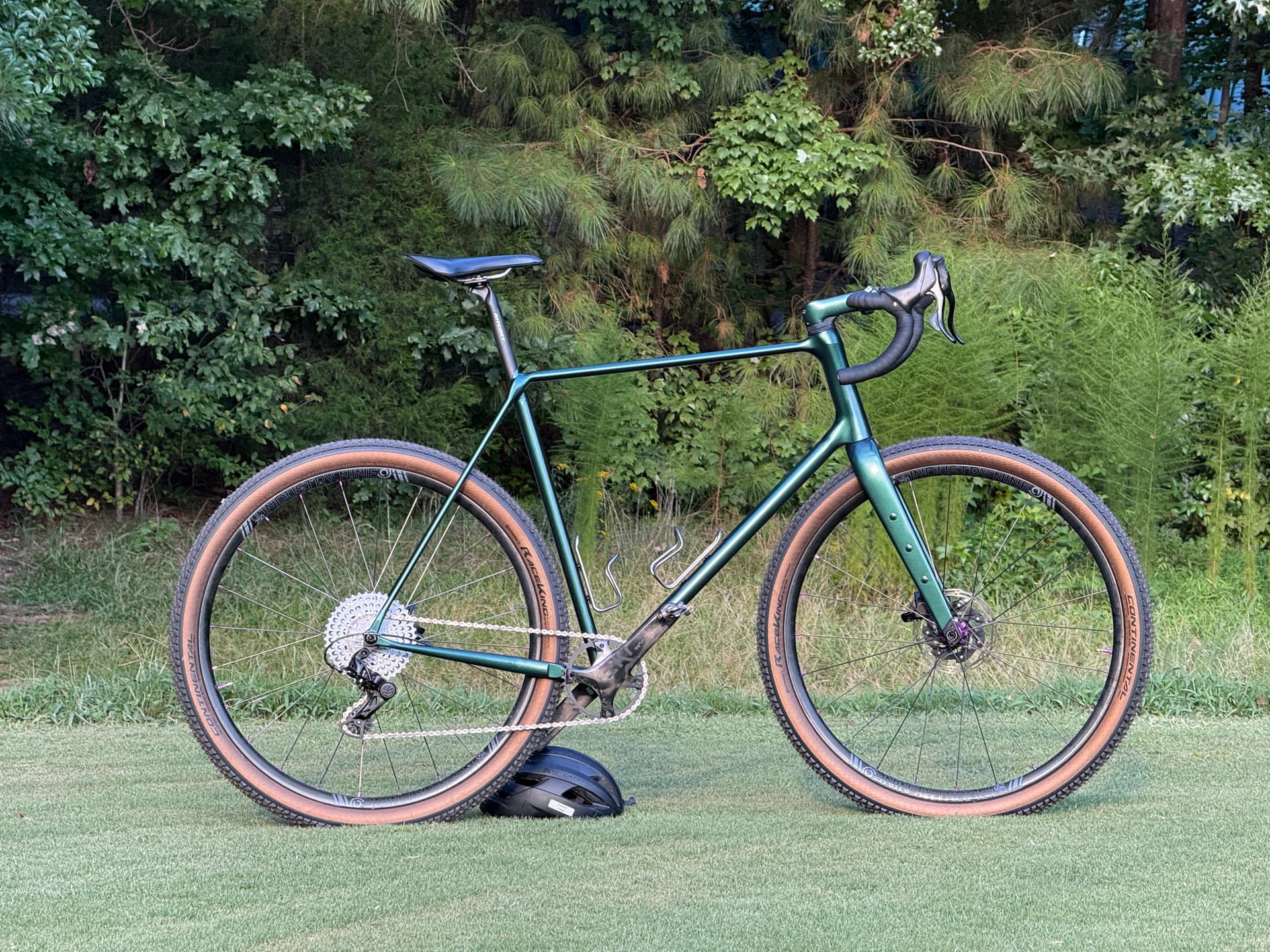

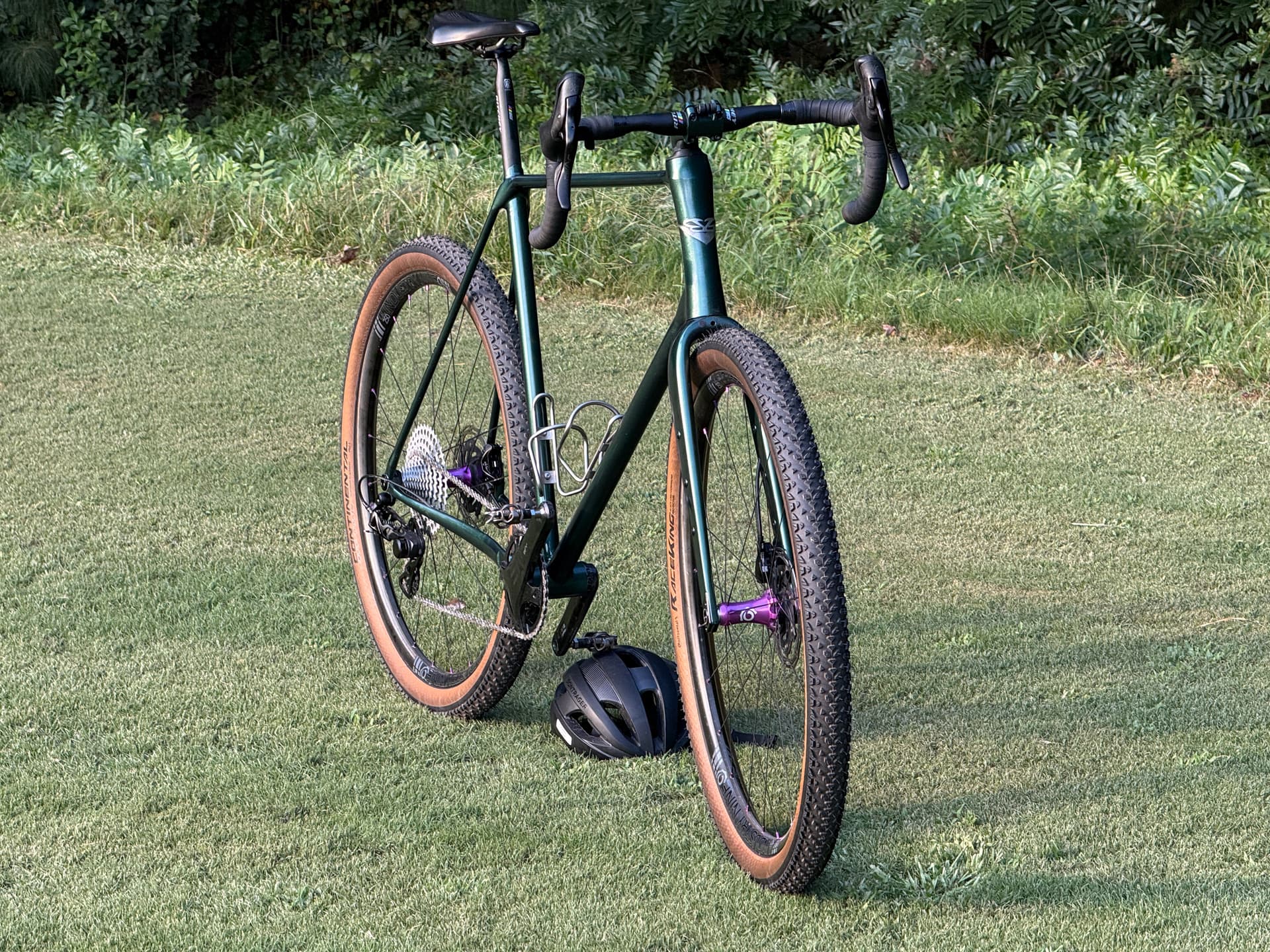

The first test ride was, to say the least, euphoric. I inched around my neighborhood, certain for the first 5 minutes the whole bike would rapidly disassemble underneath me. It was only after getting a few cautious laps in that I felt confident enough that it wouldn’t immediately explode where I could bed the brakes in and do some proper feel testing. An experience I’m sure all of you here have had before, but I’ve built a lot of really cool stuff in my life across a lot of different hobbies, and that first ride stands out above all else on pure satisfaction factor.

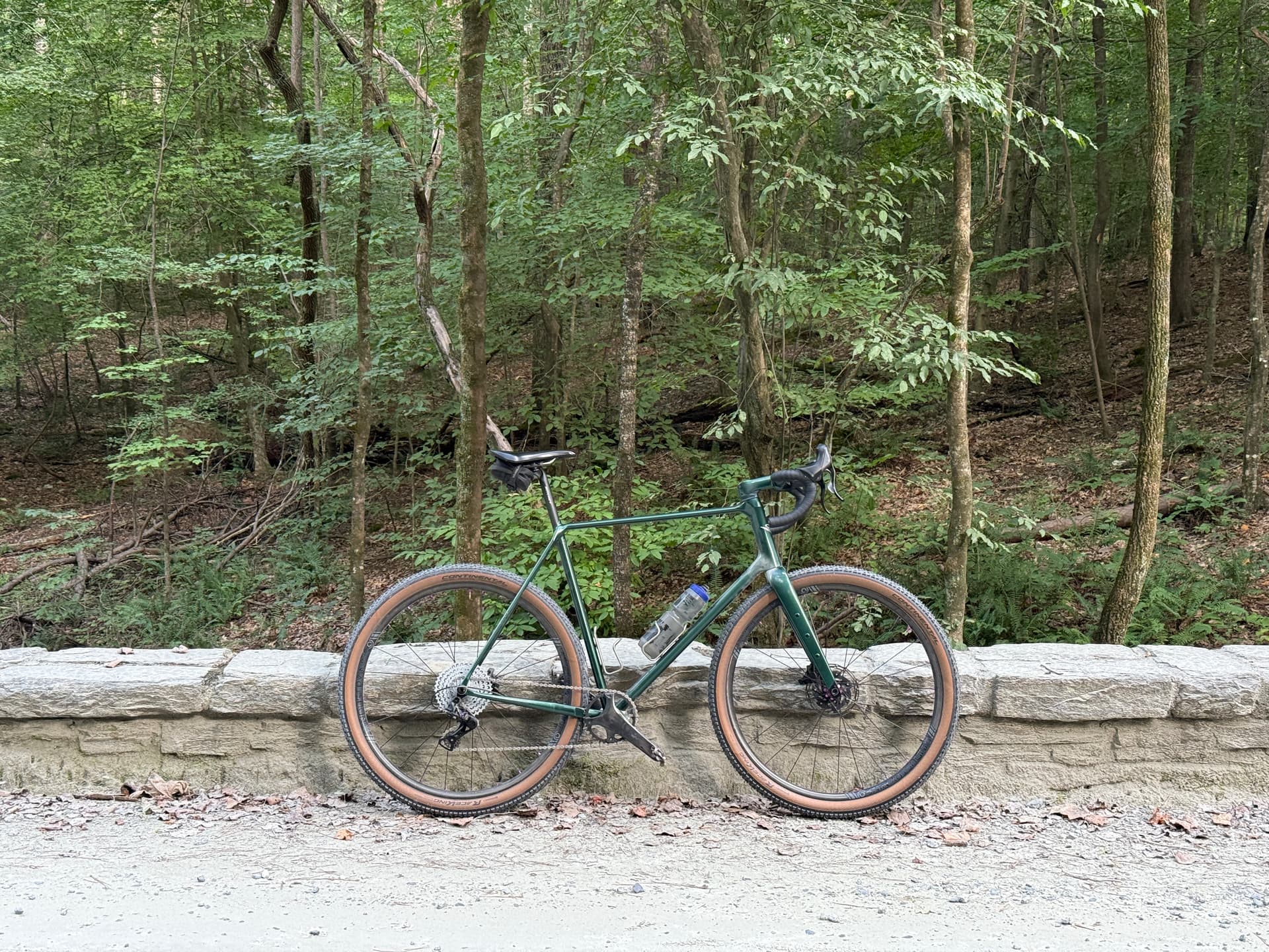

The next day I got to bring it into our local state park here to do some proper gravel riding. Still taking it a bit easy but really starting to feel the bike out, it rides awesome. The big tires feel great underneath me, the long wheelbase is super stable, and the fit is perfect. Biggest thing I’m not sure about yet is where I landed on front end geometry- i’m not sure I’m 100% happy with the way the bike is steering in the front but it’s so different than my last bike, I want to get more miles in to really suss this out.
Overall, I’m beyond stoked with how this turned out, and can’t wait to build the next one. Hope this serves as a help to anyone else jumping into this, or maybe it’s just an entertaining look into how I stumbled my way into something pretty sick!

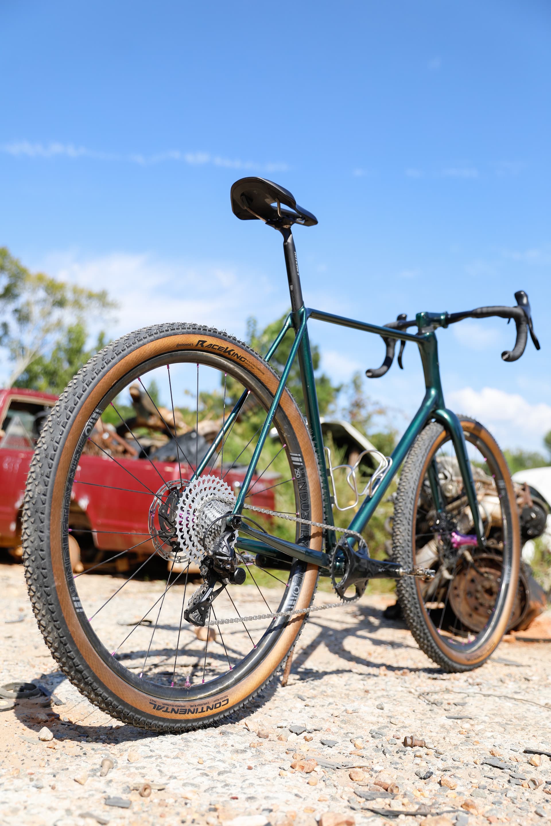

I figured some folks here would enjoy some bike porn, so here are some shots I took over the long weekend with a friend who was willing to humor me on my choice of venue :slight_smile: .
Which wall thickness did you use on your head tube?
Varies throughout the part, but there’s a nominal thickness of 1.6mm through most of it, with it increasing up to 3mm in high stress areas and around bearing seats. Fully radiused internally wherever possible to eliminate stress concentrations.
