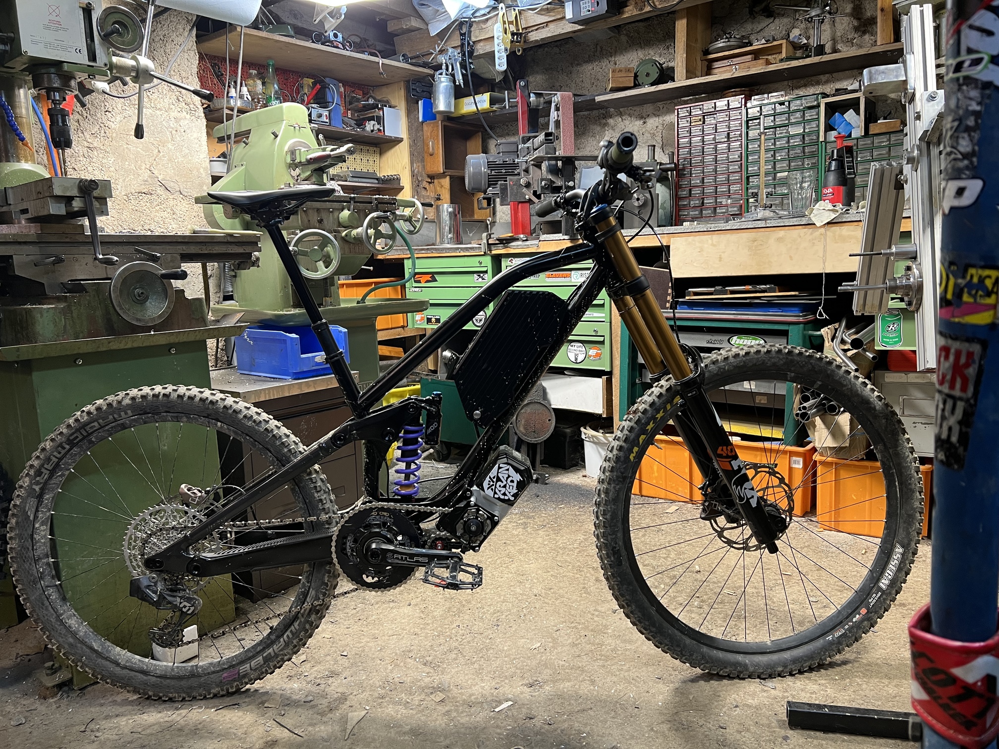

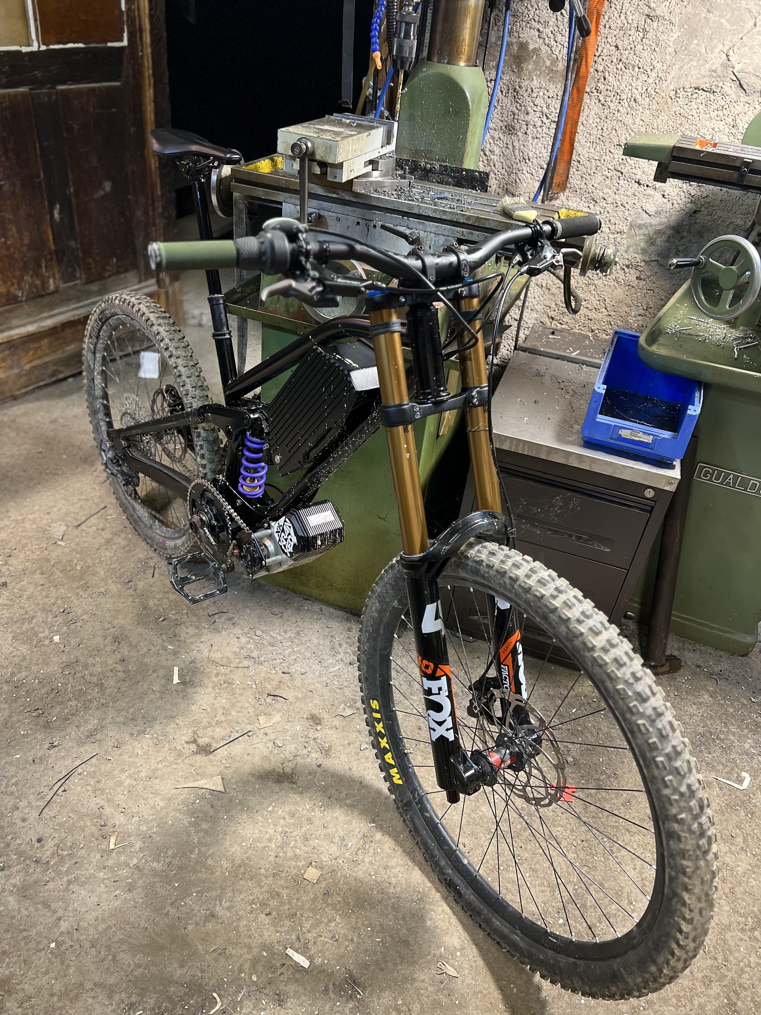

And a few pics of my DH-E. I was curious what it could be if the norms weren’t respected. It’s interesting and fun but would never replace a DH or enduro bike for me.
I tried to tie in the main pivot and shockmount into the motor mount for strength. I used Squint Eye FEA principles for this design.
It does glow in the dark. Scared me to death one night in the garage after I killed the lights.
It’s a Prismatic powder: Glowing Yellow with a Super Chrome base coat
I absolutely love this. What a shredder of a bike!!!
@liberationfab It is a great bike and puts up with so much abuse!

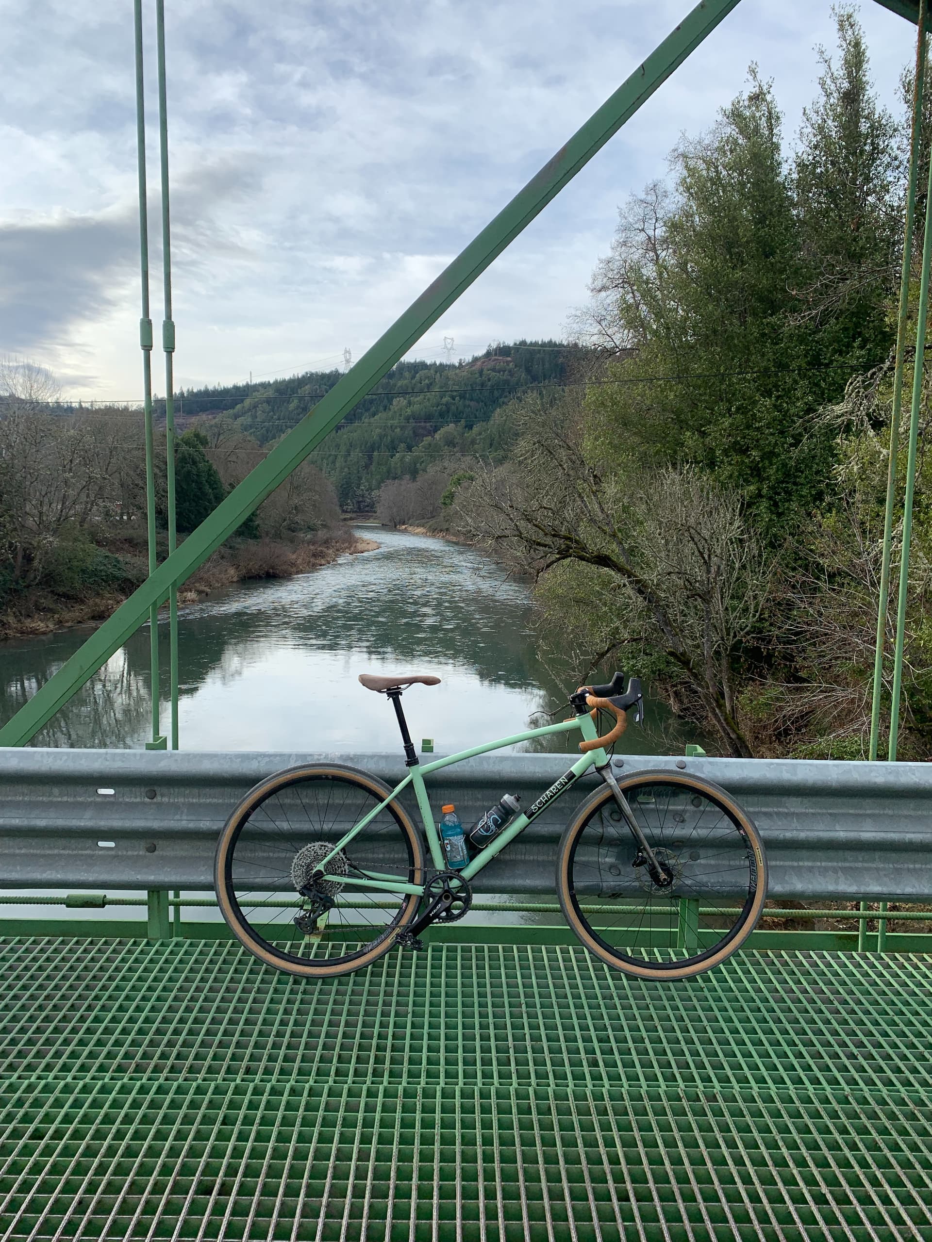

Here is a pic (okay, three pics) of my personal gravel bike. It’s an early iteration of a semi-stock model I call the Cinder. It’s a very mtb-informed geo and spec, but with road levers/brakes and a SRAM/Ratio mullet drivetrain. Never liked traditional road bikes on the pavement, let alone the dirt, but this bike really works for me (primarily a mountain biker). I built this about two years ago and have been riding it much more in the past year since discovering the wealth of amazing gravel we have nearby in southern Oregon and northern California.

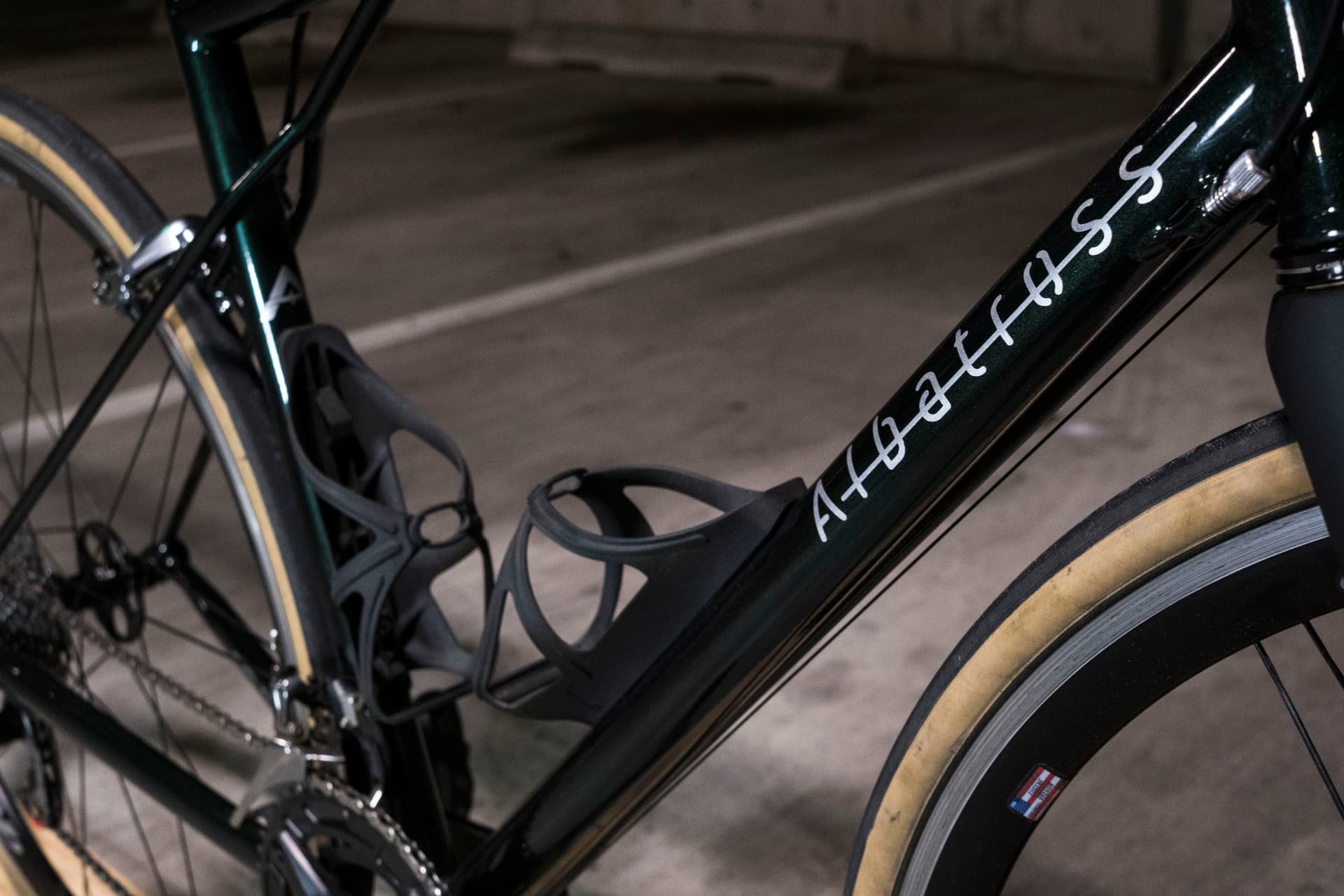

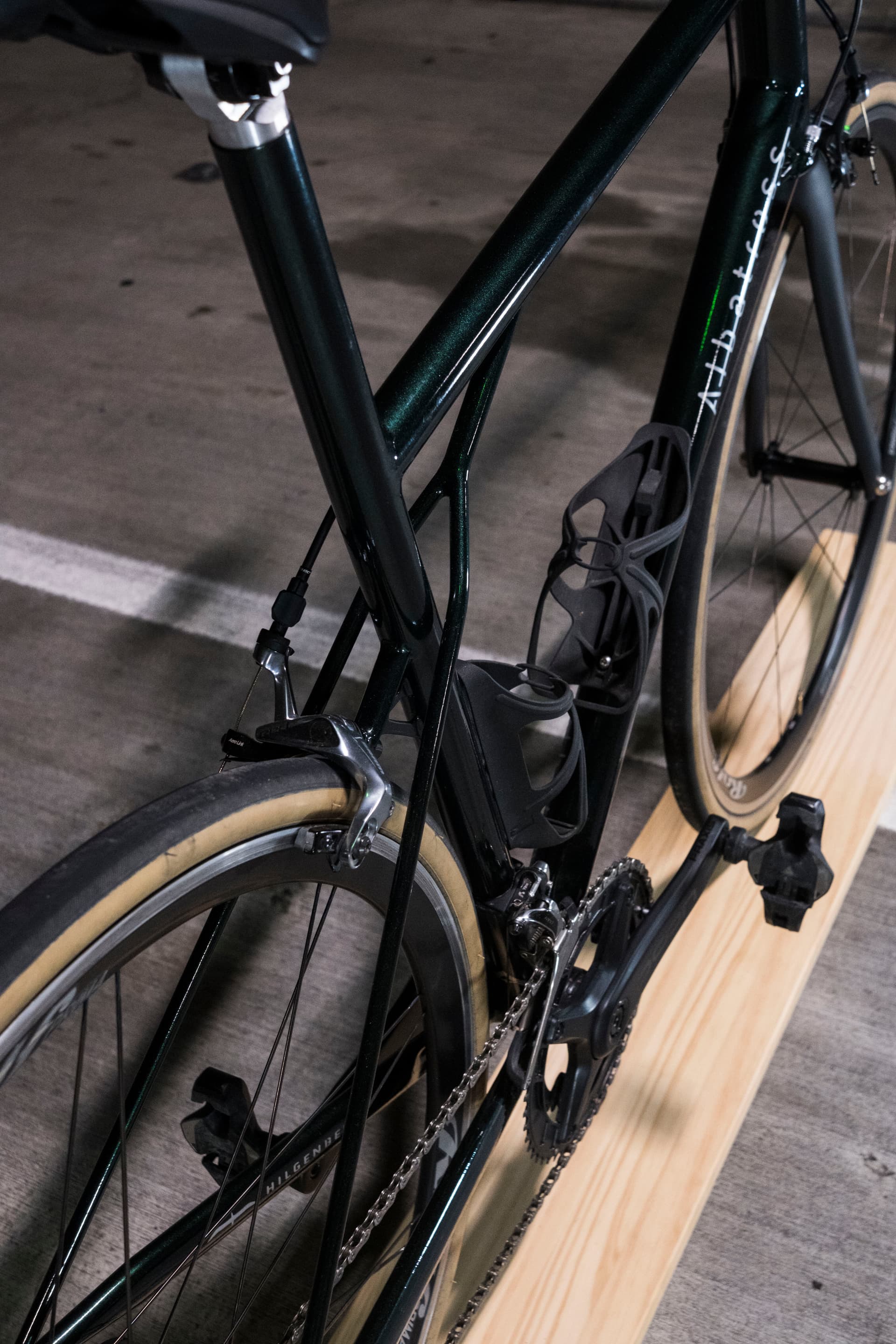

Recently I did build myself a “Modern Classic” road bike with 2x10 gearing and gasp RIM BRAKES! Amazingly, the world did not spontaneously combust. Here’s the result of the effort!
More details can be found here in a writeup on my website.

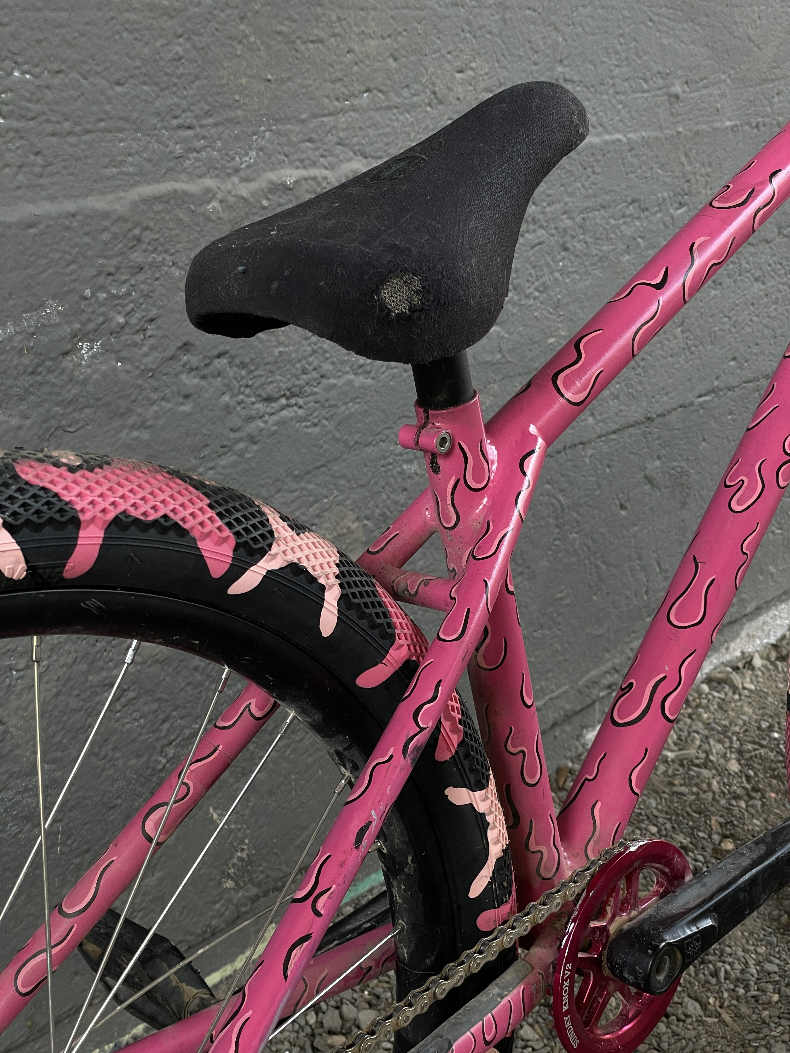

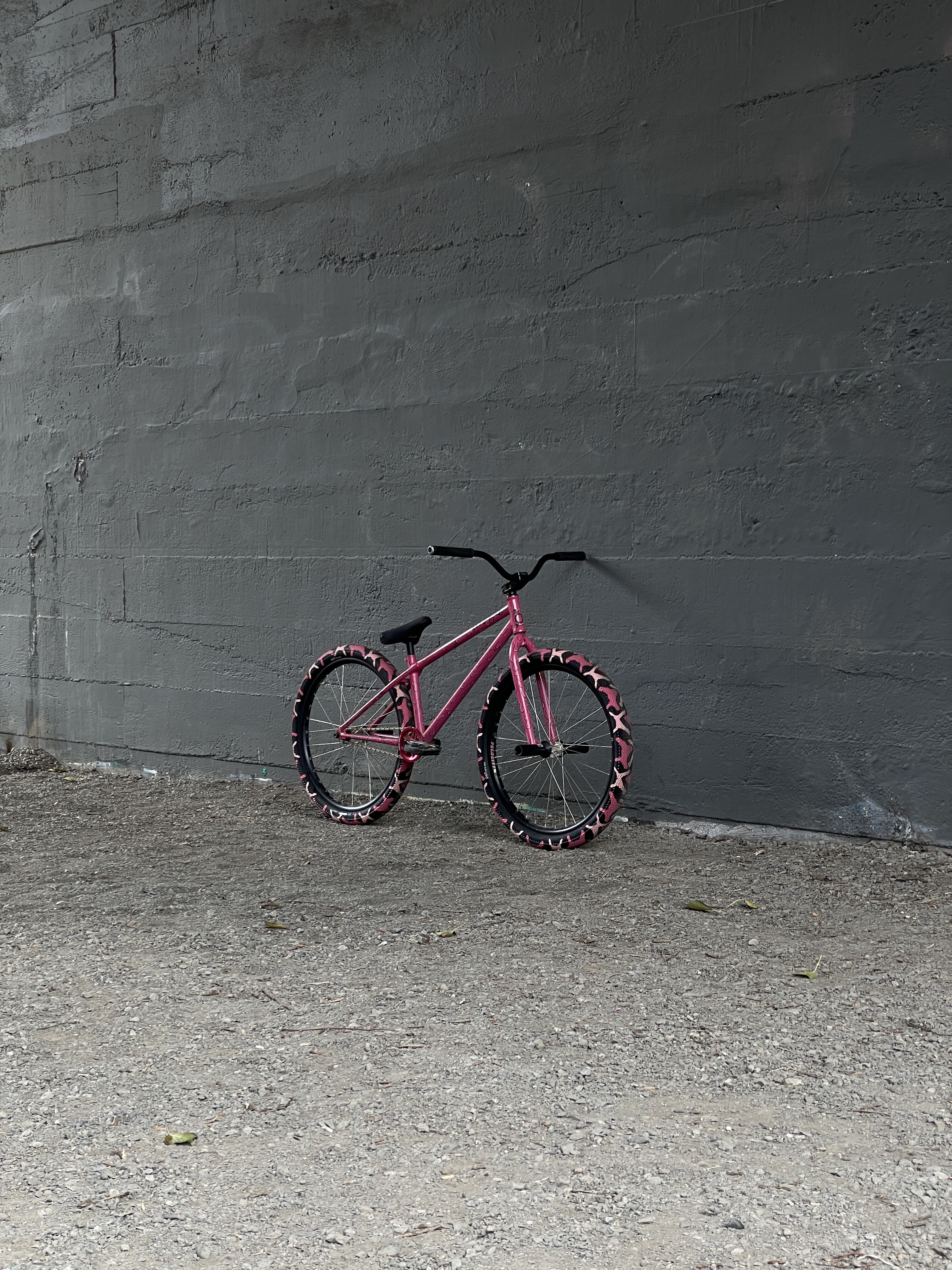

Here’s my 26” skatepark bike. It’s the second 26” I’ve built myself, and it is so much fun. The first one buckled on the top tube right on a butt, this one has a straight .9mm top tube.
It’s got a weird combo of bmx and mtb parts - bmx head tube, 10mm bmx front hub, 10mm mtb rear hub, mid bmx bb shell and a 27.2 seat tube.
I think my only regret with this bike is going for the mtb dropouts (my previous one had 14mm dropouts). I thought I would want a brake to ride pumptracks or dirt jumps more, but I have only put a brake on it twice. :woman_shrugging:t2:
As cool as the camo Cult x Vans tires are, they’re just for photos haha they’re way too heavy.
