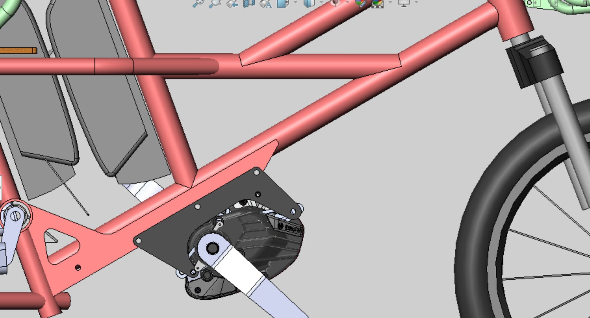

Yes, the constantly changing mounting points are pretty silly. There are going to be a lot of expensive paperweights in 10 years time. For my next cargo bike, I am going to go with a flexible design that uses different inserts to fit various motor models. It’s not pretty or light, but a cargo bike is more forgiving in that regard. I still have a lot of refining to do, but the goal is to have something future proof.
