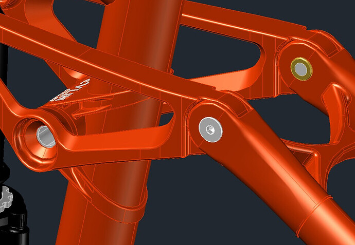

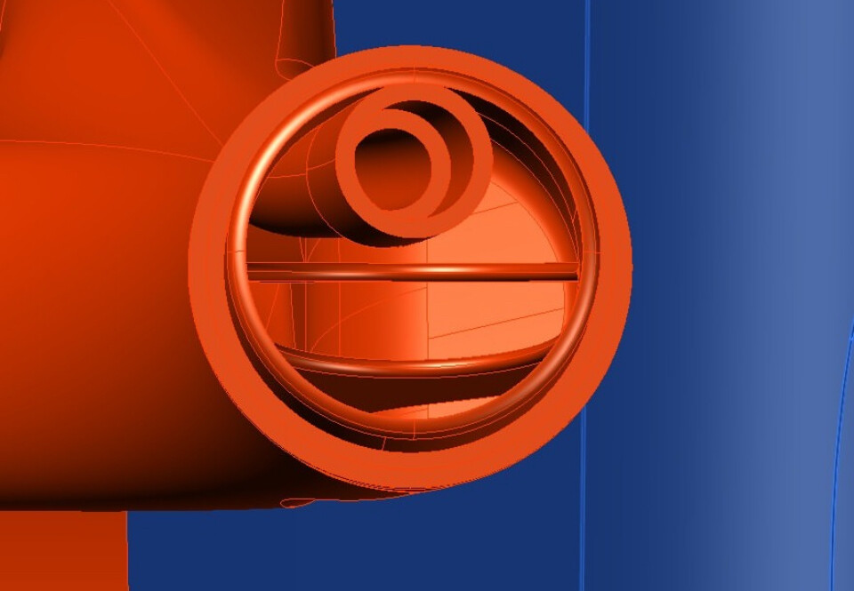

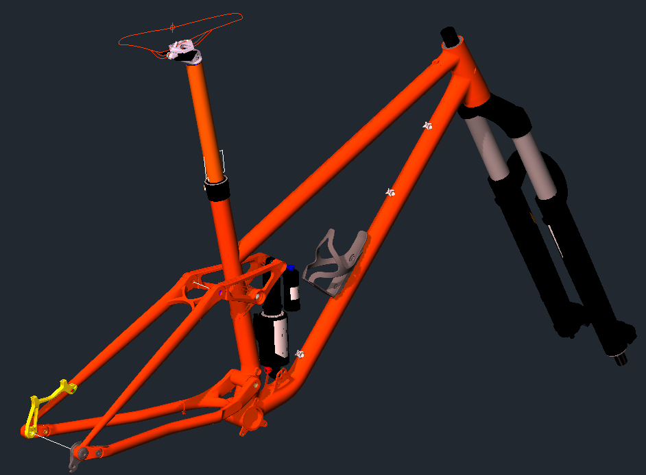

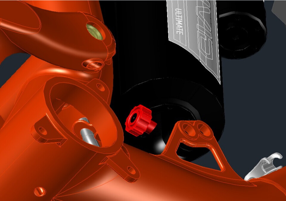

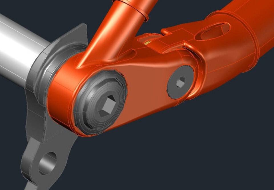

I use plain old AuitoCAD becuase Im a 35 year career draftsman and am proficient in using it as well as Microstation and a few other programs. I ahv’t had the time to learn Fusion yet but am also looking at maybe other programs.
The modelling below is in AutoCAD for reference.
