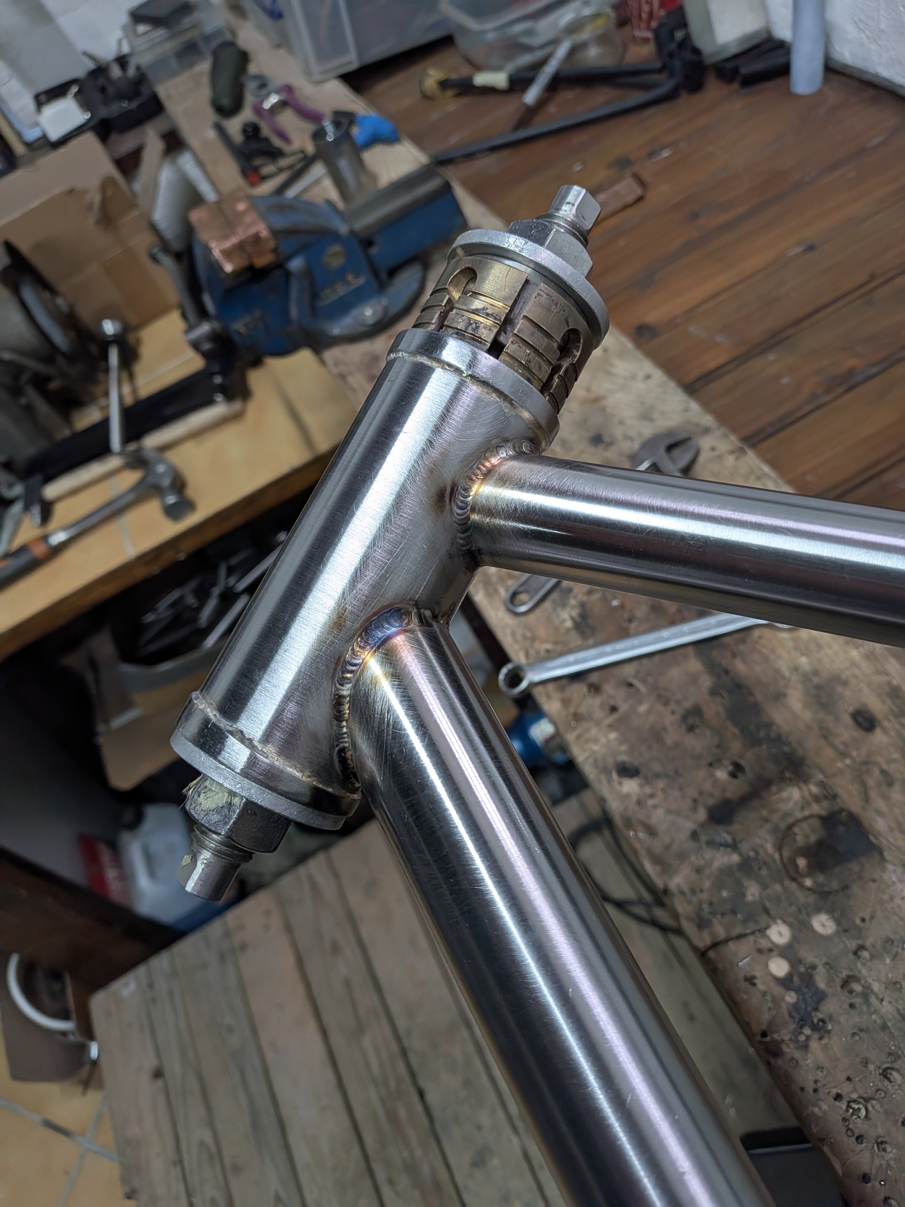

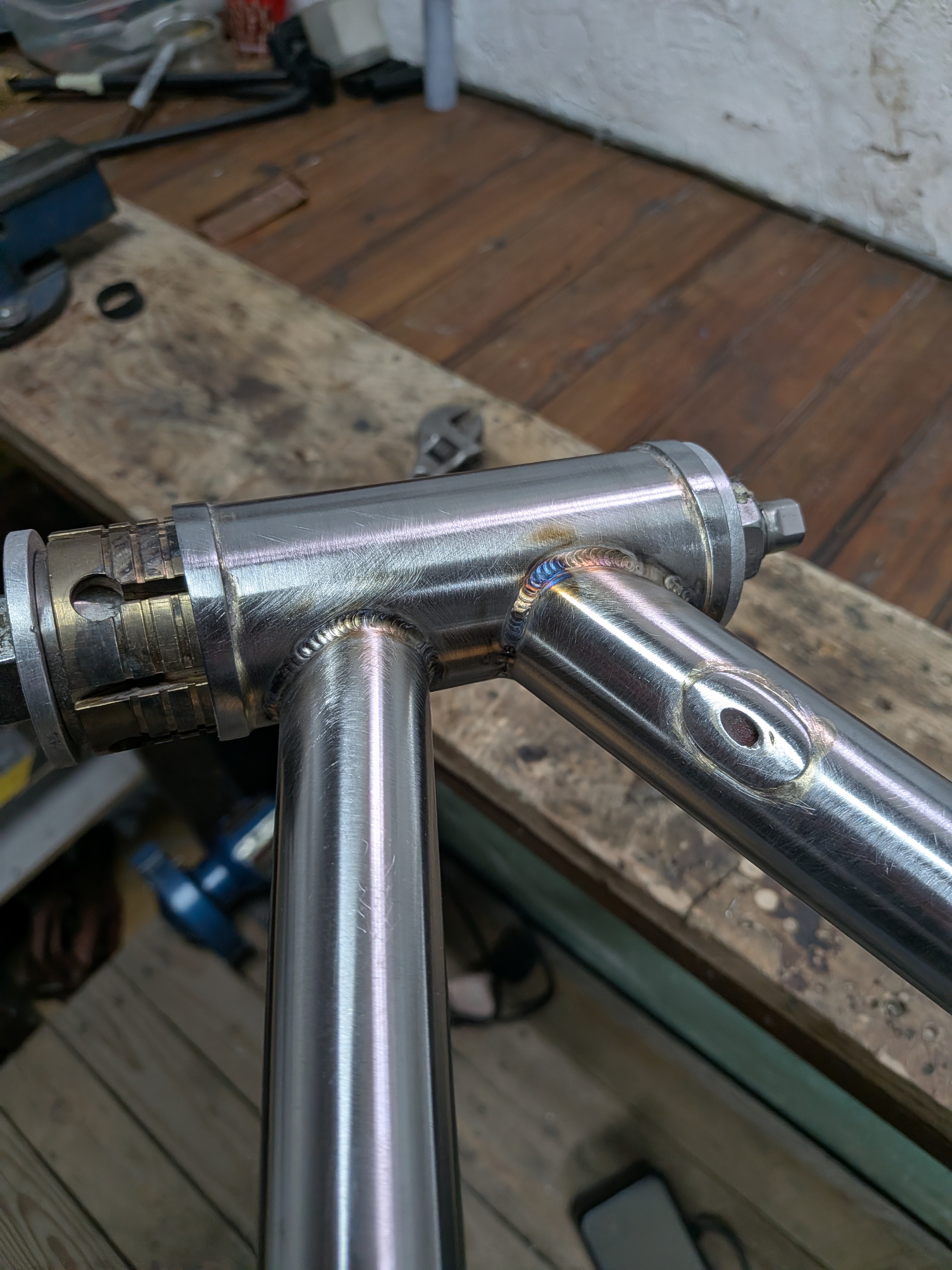

Frame is done now, no escape in sight for this top tube, thanks for the advise everyone.
Yeah, like I said, a good a bike is one the rider wants to ride. People ride all sorts of bikes and love them.
Nice work!
Out of curiosity, which tube did you end up using? Do you feel like there was enough butt left after you cut it to length?
I used Velospec AC28090609-630 :slight_smile:
It has really long butts! It’s heavier wall than I would have liked to use but otherwise it suited the frame nicely, also I was able to get it fast as I had to build the frame this week, leaving my workshop for a while sadly!
Nice welding!
