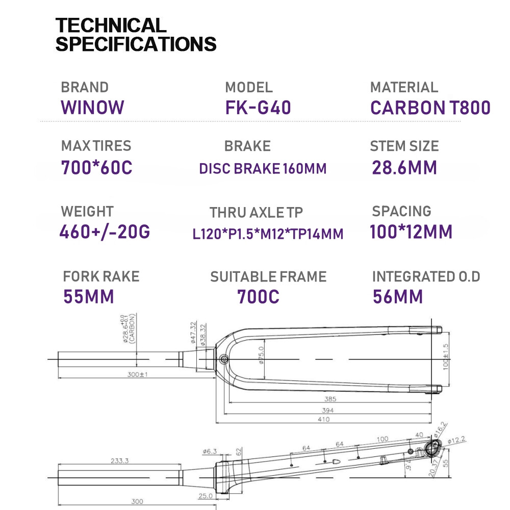

I’ve been planning a monster gravel build for a while and have been looking for a carbon fork that will clear 29er tyres. I found a Chinese factory that makes a fork that fits my needs. What I am suspicious about is the claimed Axle to crown length of 385mm coupled with a tyre clearance of 60mm for 700c. Is this at all possible? Here’s the link to the fork -
I think that dimension is from the axle to the bottom of the fork crown. It looks like the actual axle-crown is 410mm. I used a Winow Sports FK-059 on my most recent gravel bike and it’s held up great!
Why do you need such a short fork length? You’re making the frame, no? Then you can design for a longer fork, including the fork you linked to.
@liberationfab is correct, 385 is the crown clearance.
True axle to crown is 410mm

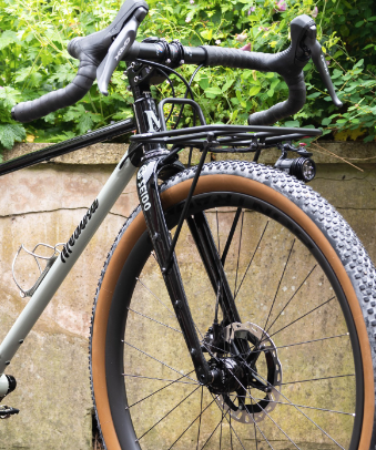

I would highly recommend the Seido MGV Fork. You can find quite a few for $300ish and they clear 29x2.25 with internal or external routing.

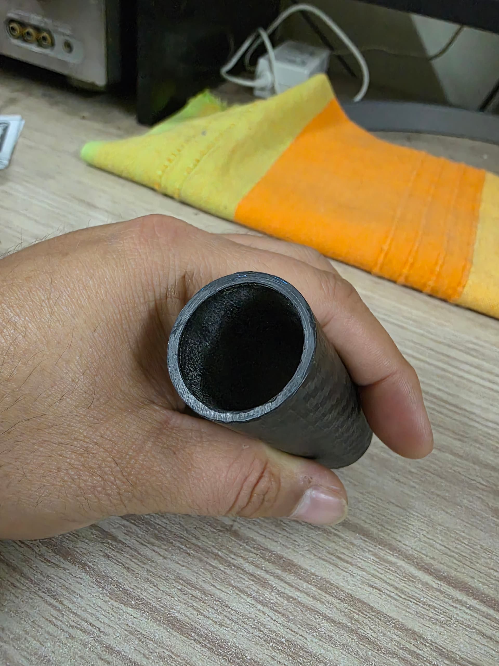

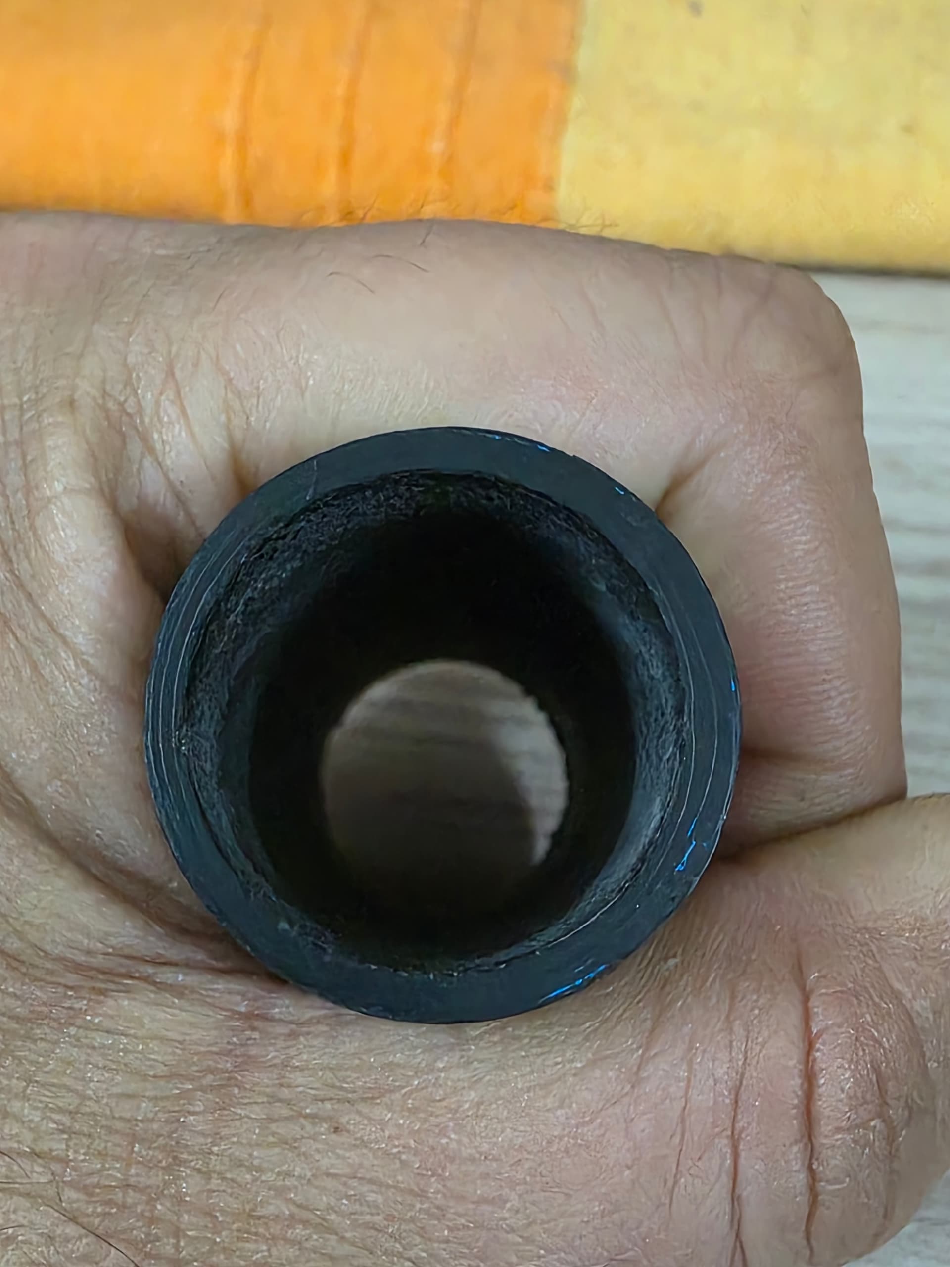

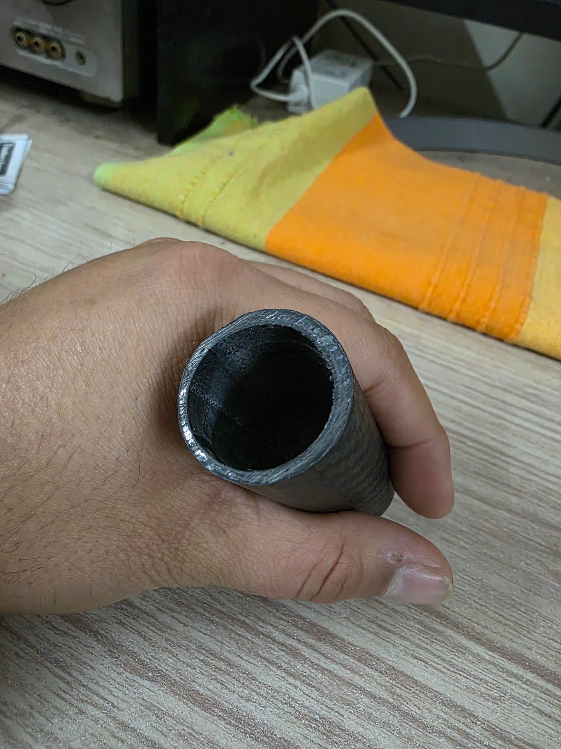

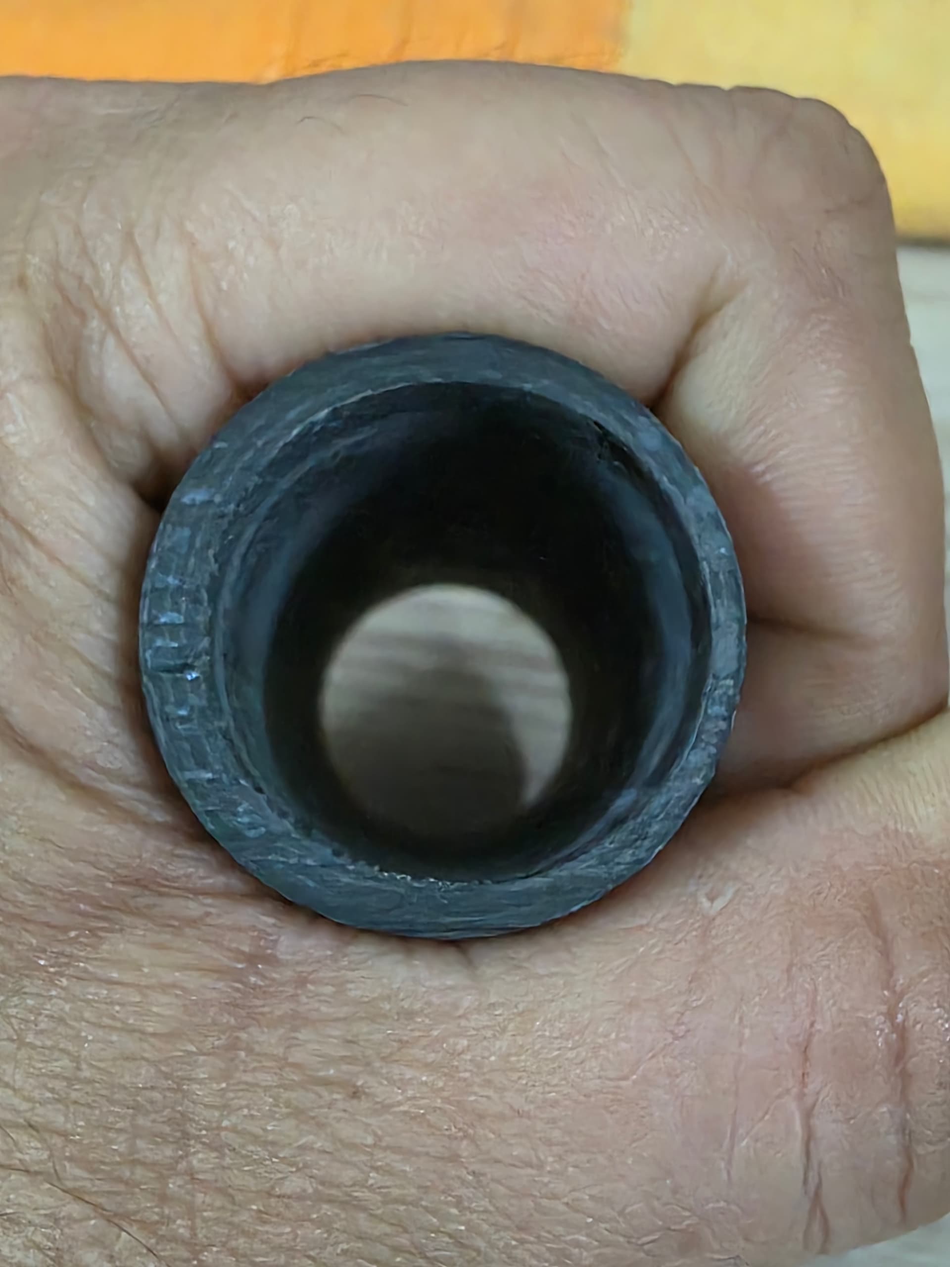

Just wanted to give an update. I got the Winow Sports fork. Unfortunately, I neglected to check it when I got it. When the bike reached me several months later from the frame builder’s workshop, I found the steerer tube was kinda eccentric! Thicker on one side than the other.
My LBS says it’s probably safe to use, but suggests that I replace it if I can.
I’m not a carbon expert but the ‘probably safe’ part makes me squeamish. :grimacing:

No. Had enough of this inconsistent quality control and switched it out with the Seido MGV fork. Been holding up great.
