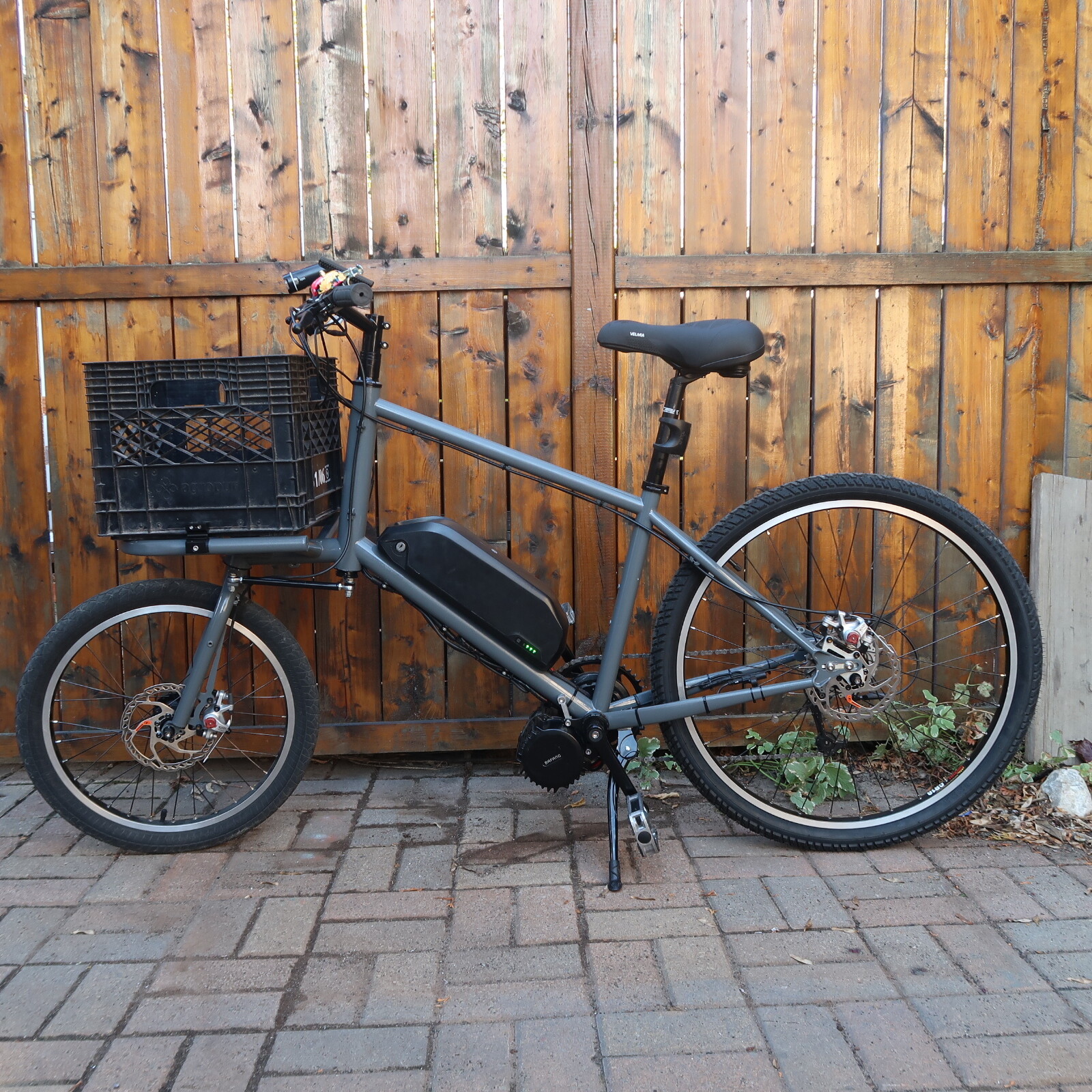

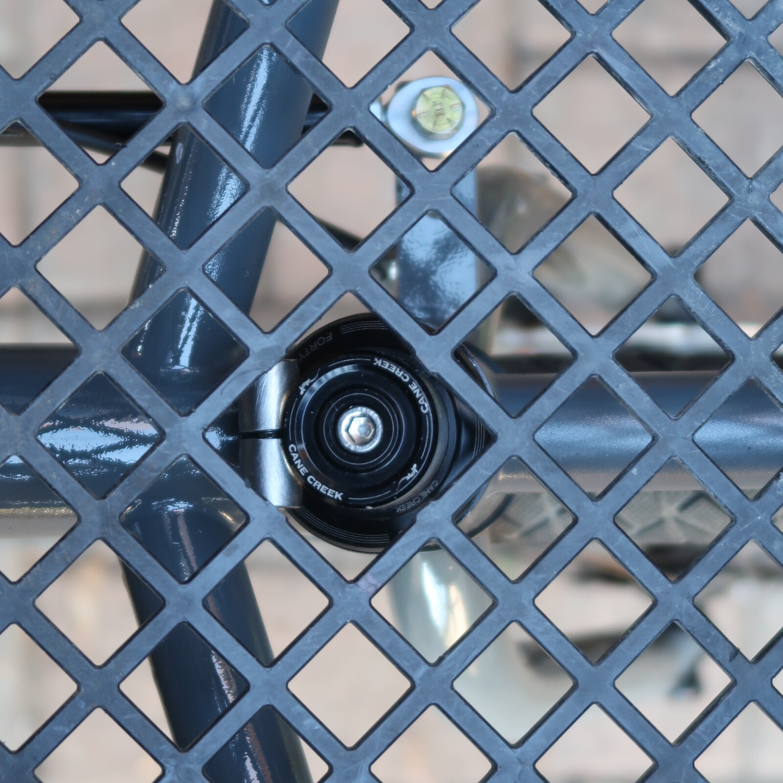

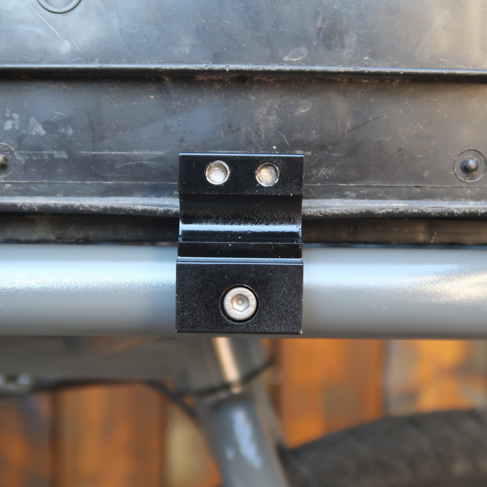

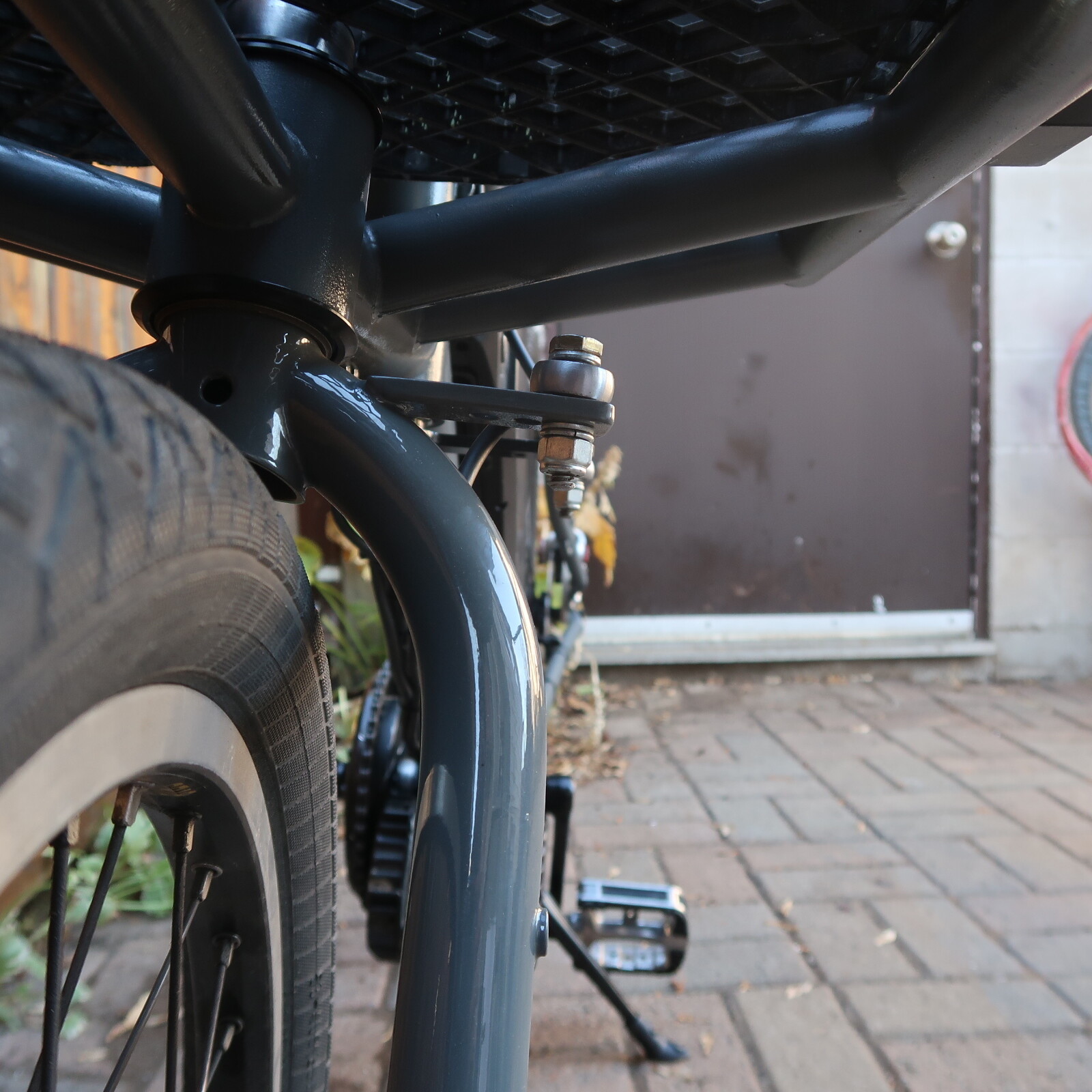

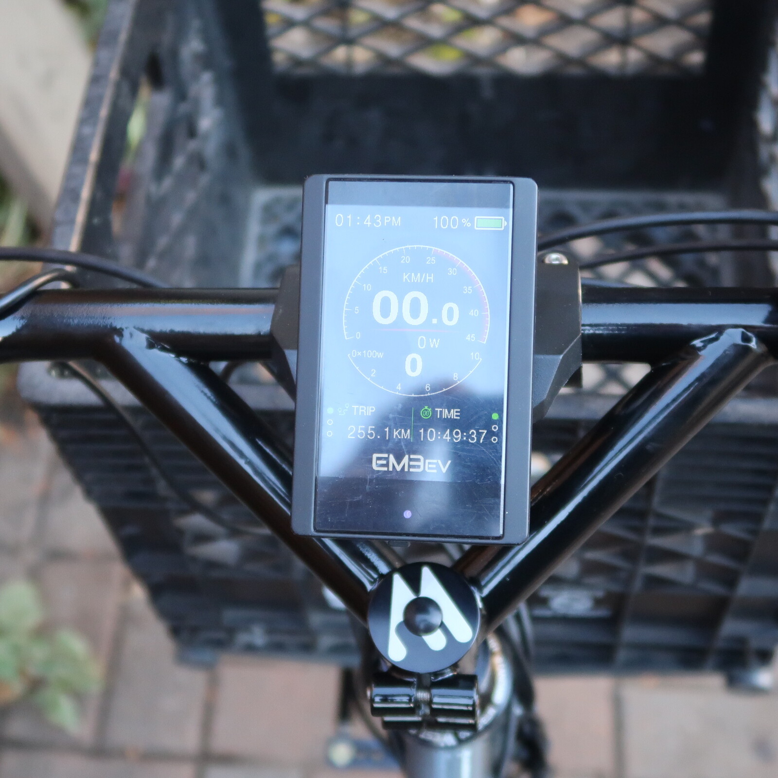

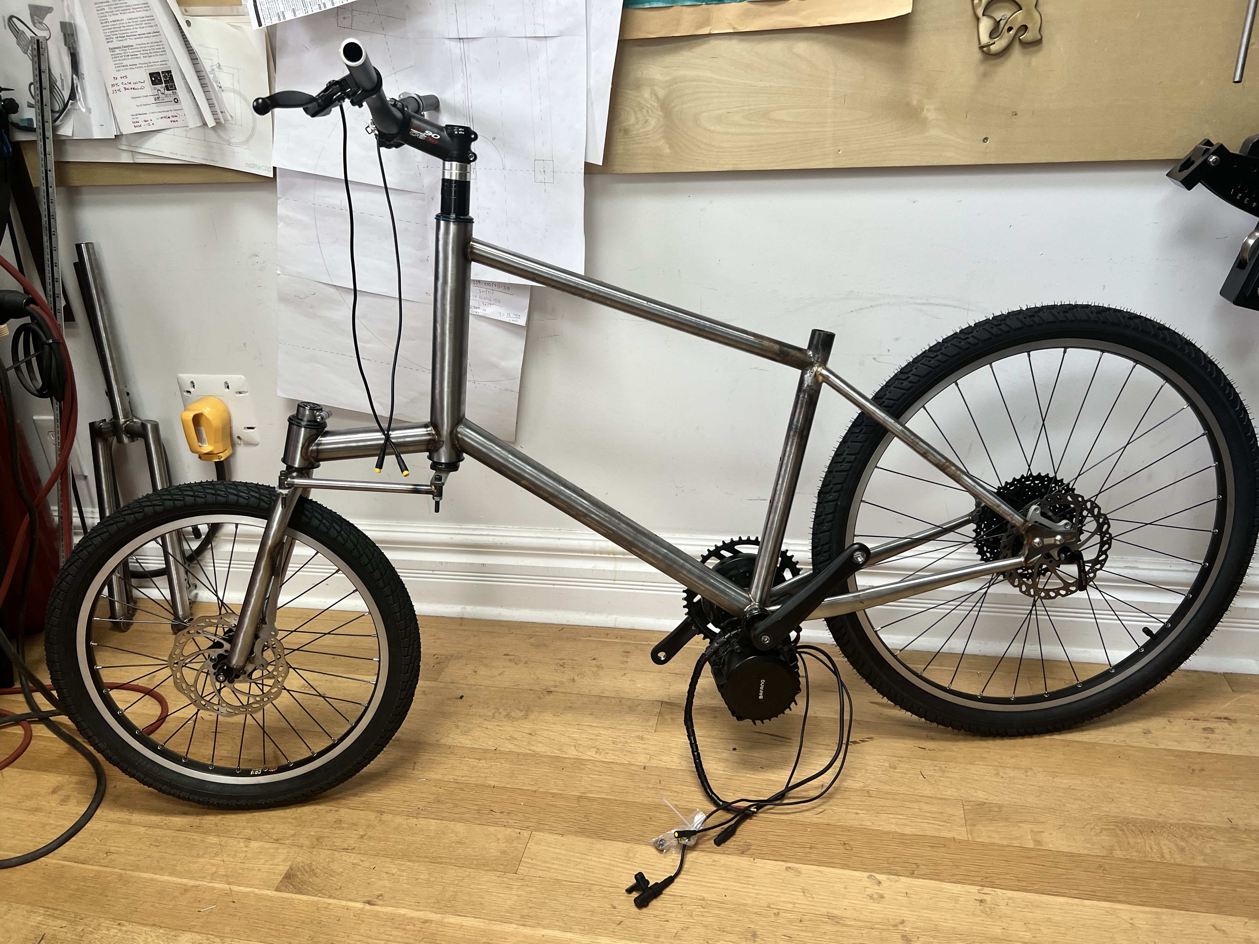

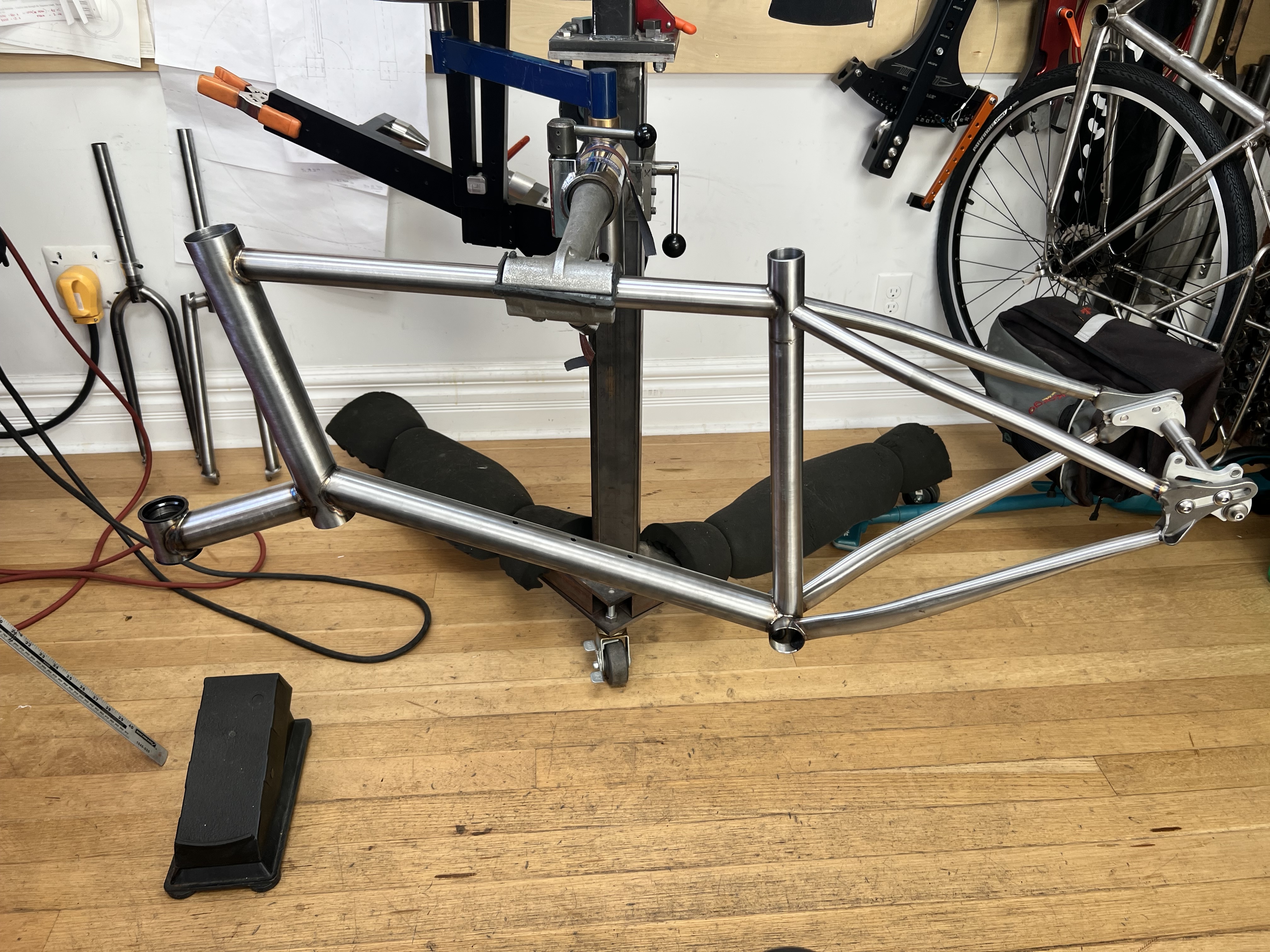

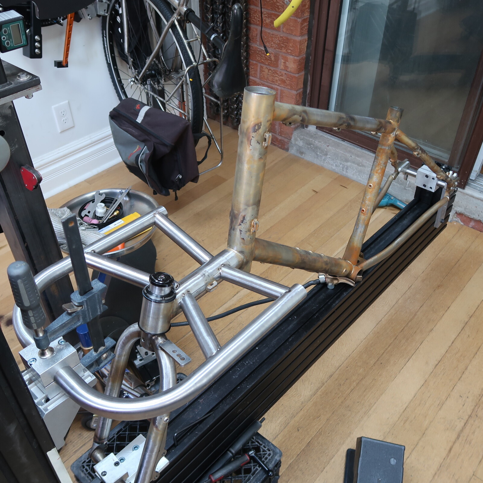

Hi everyone. Cargo bikes seem to be all the rage these days. I decided to make an electrified one for my wife. The bike is inspired by Bilenky cargo bikes. It’s a little heavy, I used straight gauge .035” 4130 chromoly for everything except the rear triangle (Columbus stays) and the downtube (1.625” .058”). The headtubes are 44mm. Bullmoose bars are .875” .049”. Also installed a Bafang BBSHD mid drive motor.
Overall the bike rides well and the BBSHD mid drive is more than adequate.

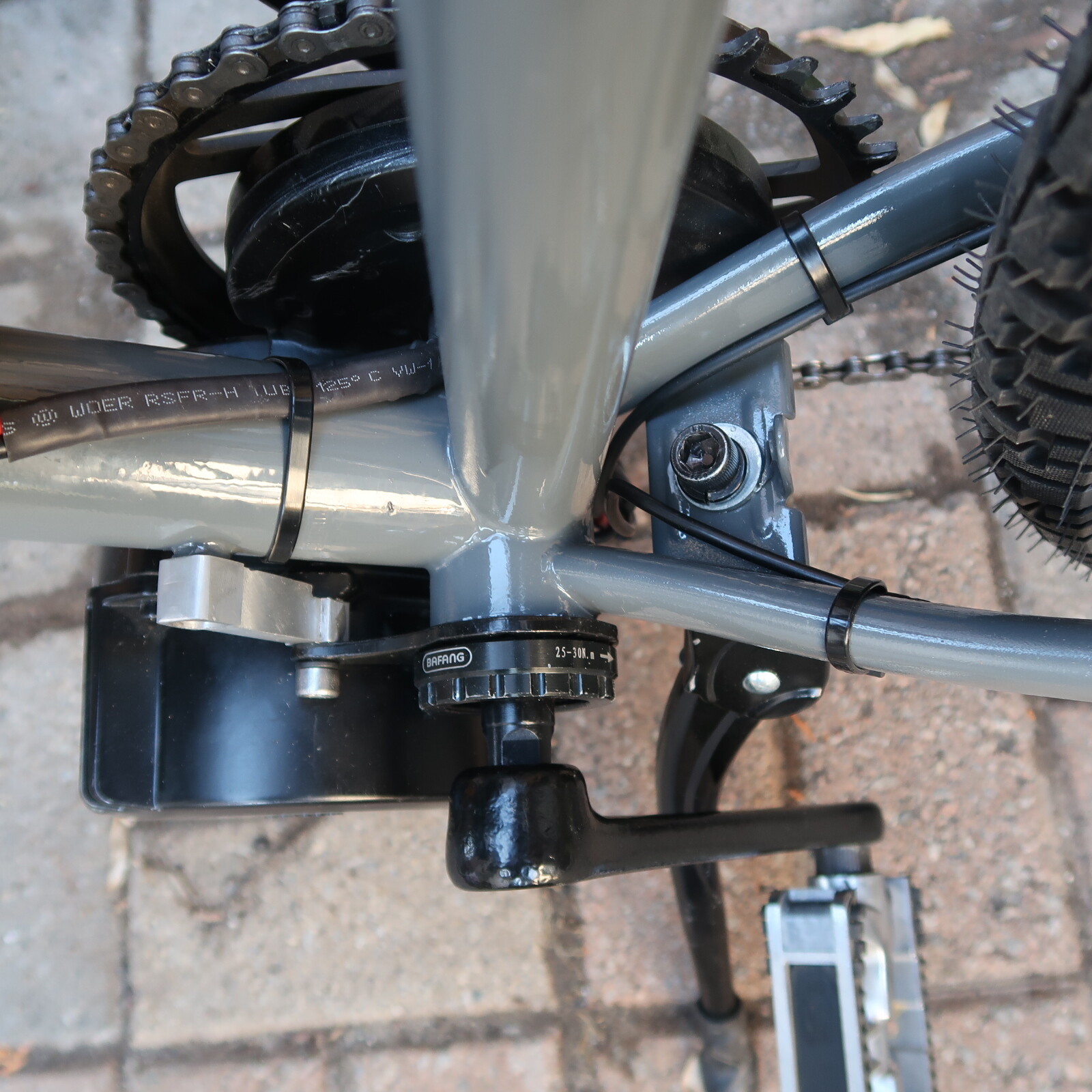

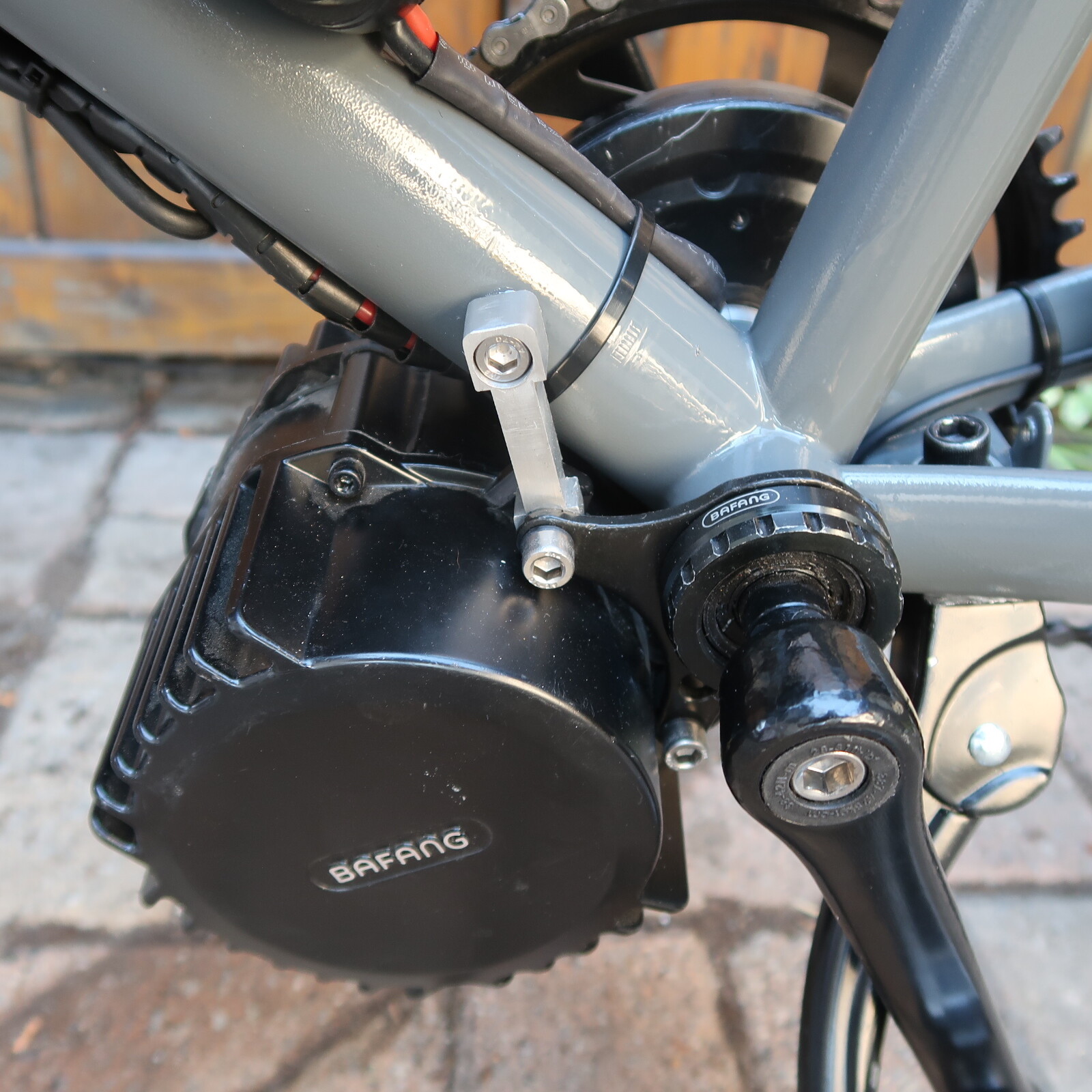

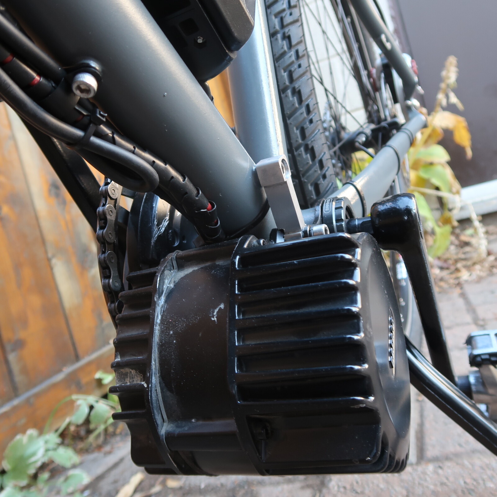

Added a 6mm threaded bung to the downtube and fabricated an aluminum dog bone to prevent the Bafang motor from spinning.

I have installed a bunch of front and rear hub motor kits in the past but never a mid drive. The BBSHD gets a lot of good reviews so I was curious to try one. The next Ebike I make will be with a hub motor. The BBSHD is great but expensive as far these DIY kits go.

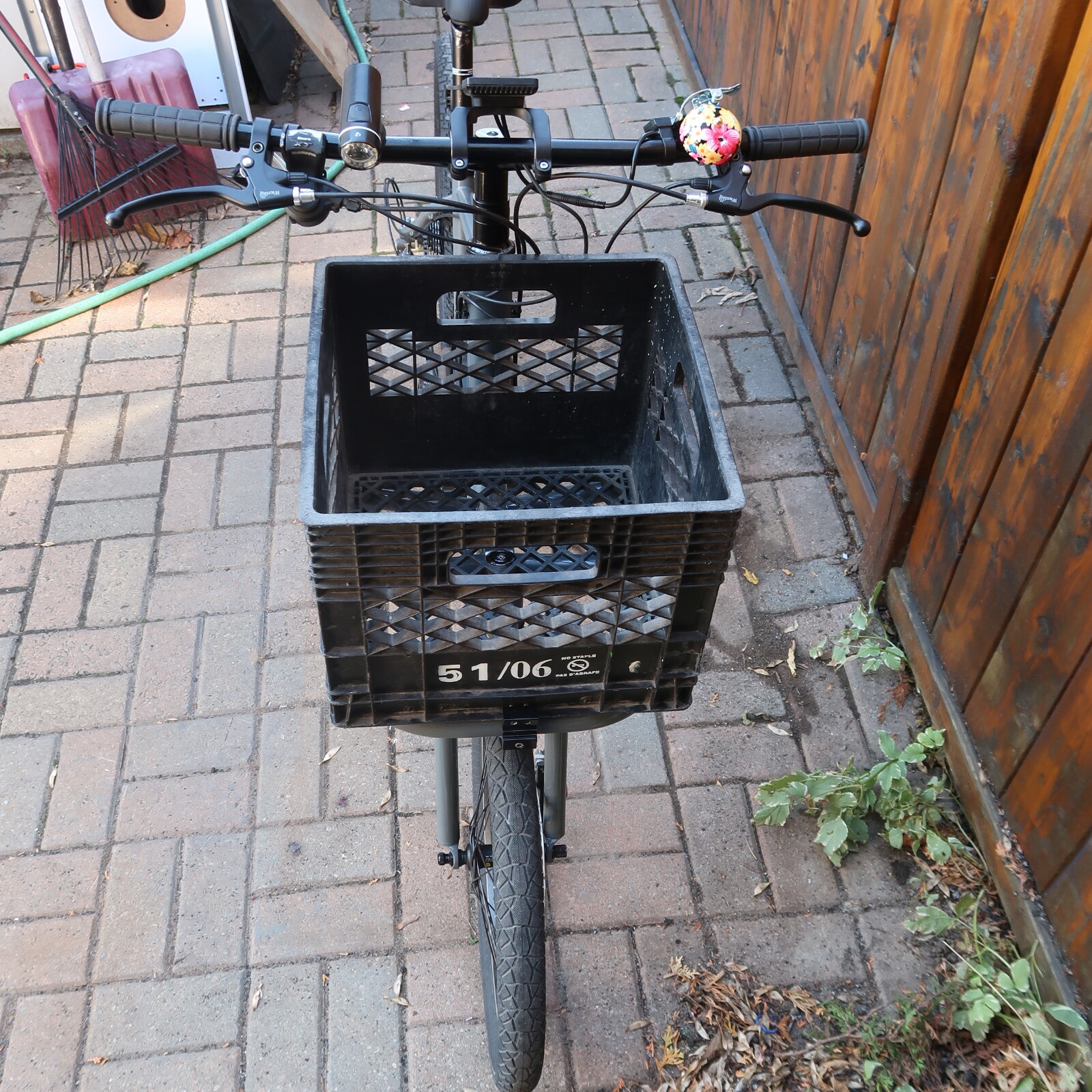

Great job! I love the front rack’s shape. The curve makes a big difference.

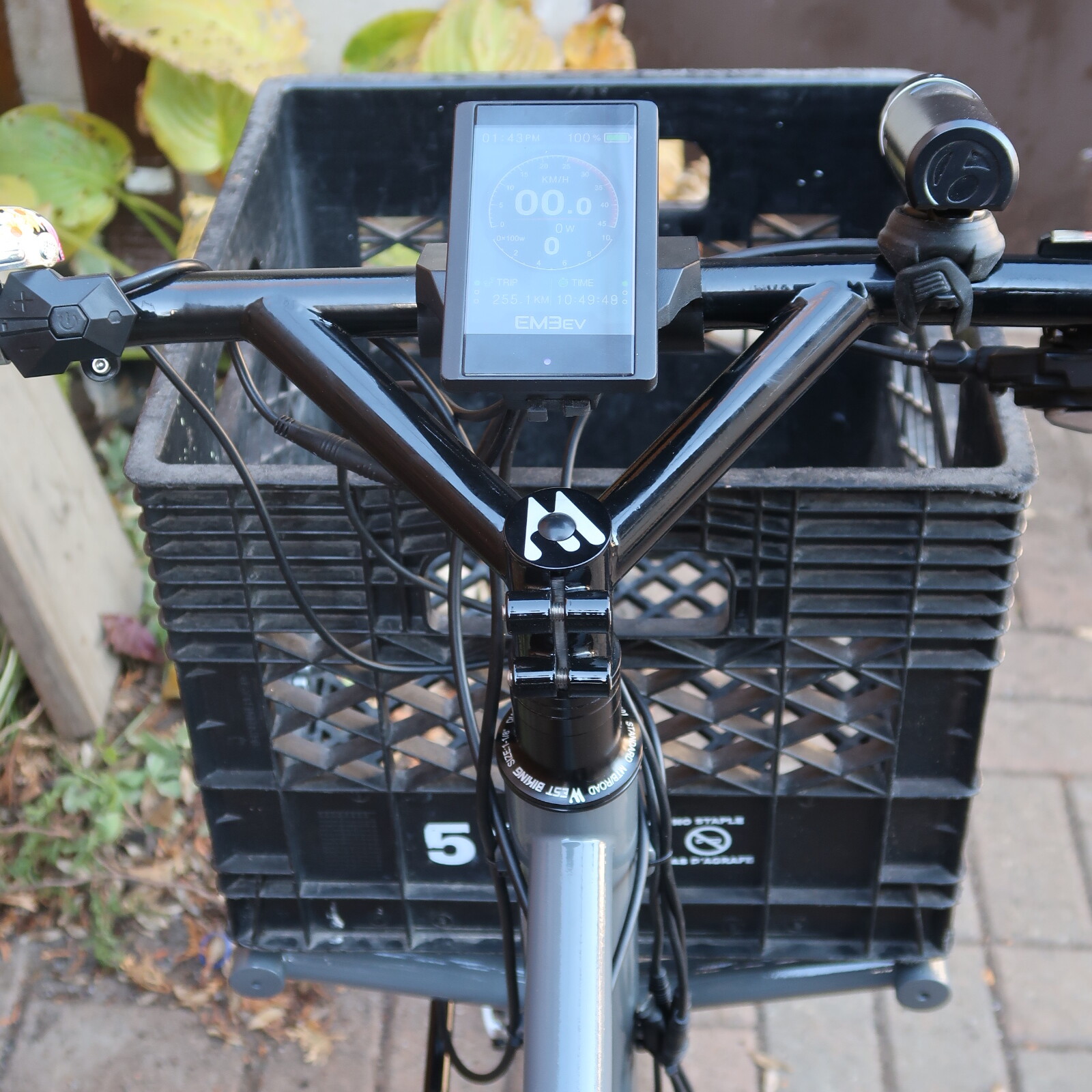

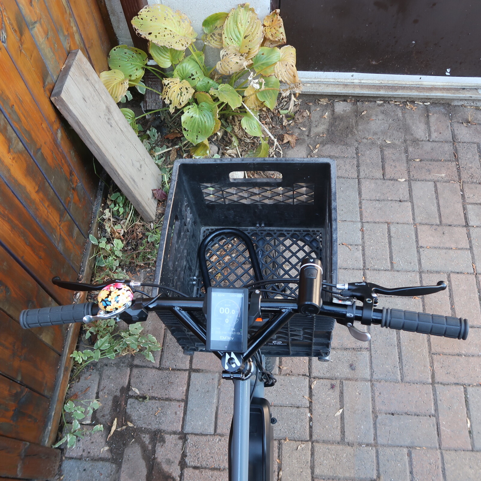

Do you find the vertical steerer tube feels weird when rotating the bars?
Other than looking a little weird it does not take any getting used to all. The bike handles normal, although the steering has a limit due to the linkage. It was a fun project.
