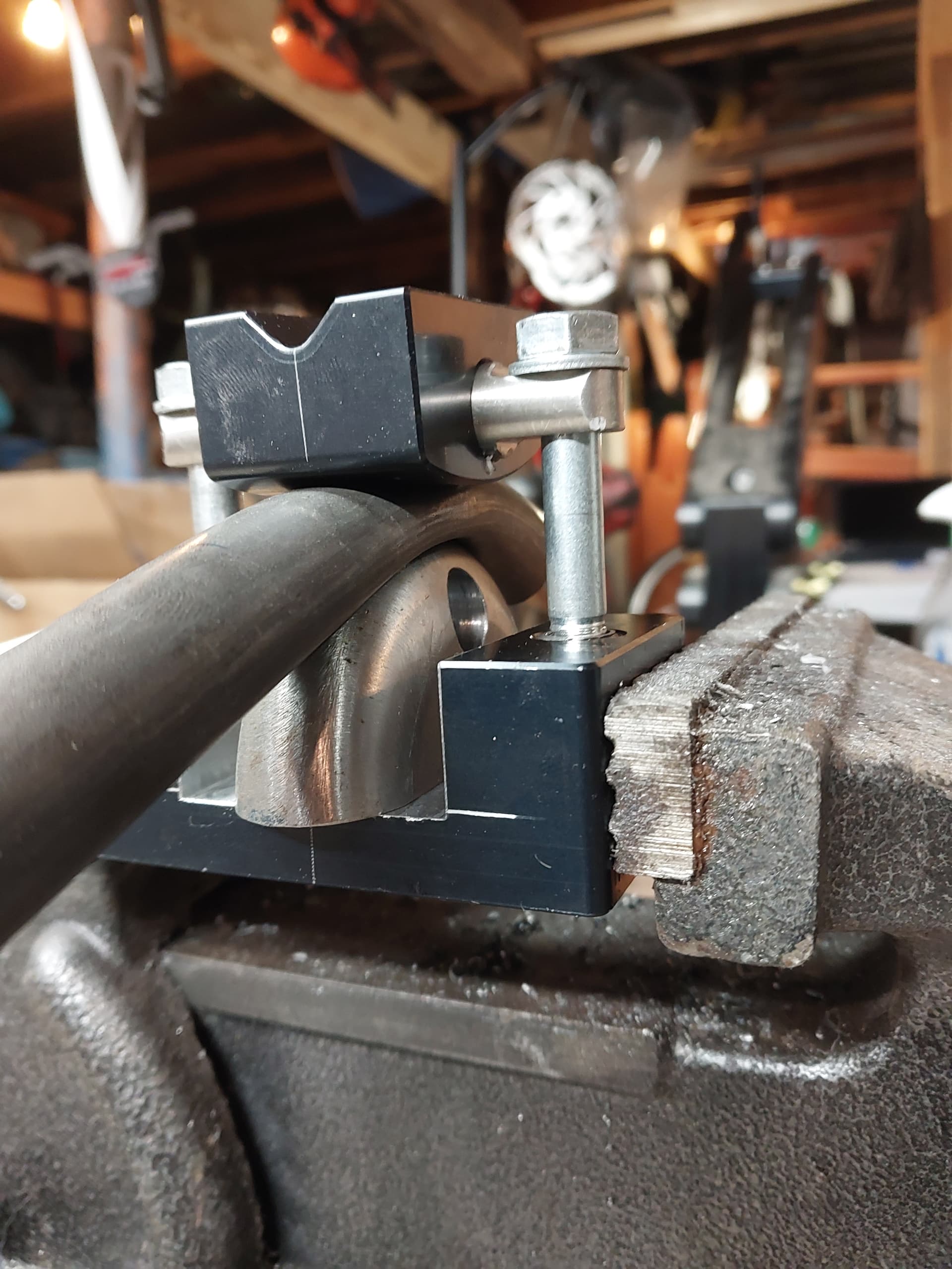

So trying to get my dimple game a bit less sketchy and was scheming many things..

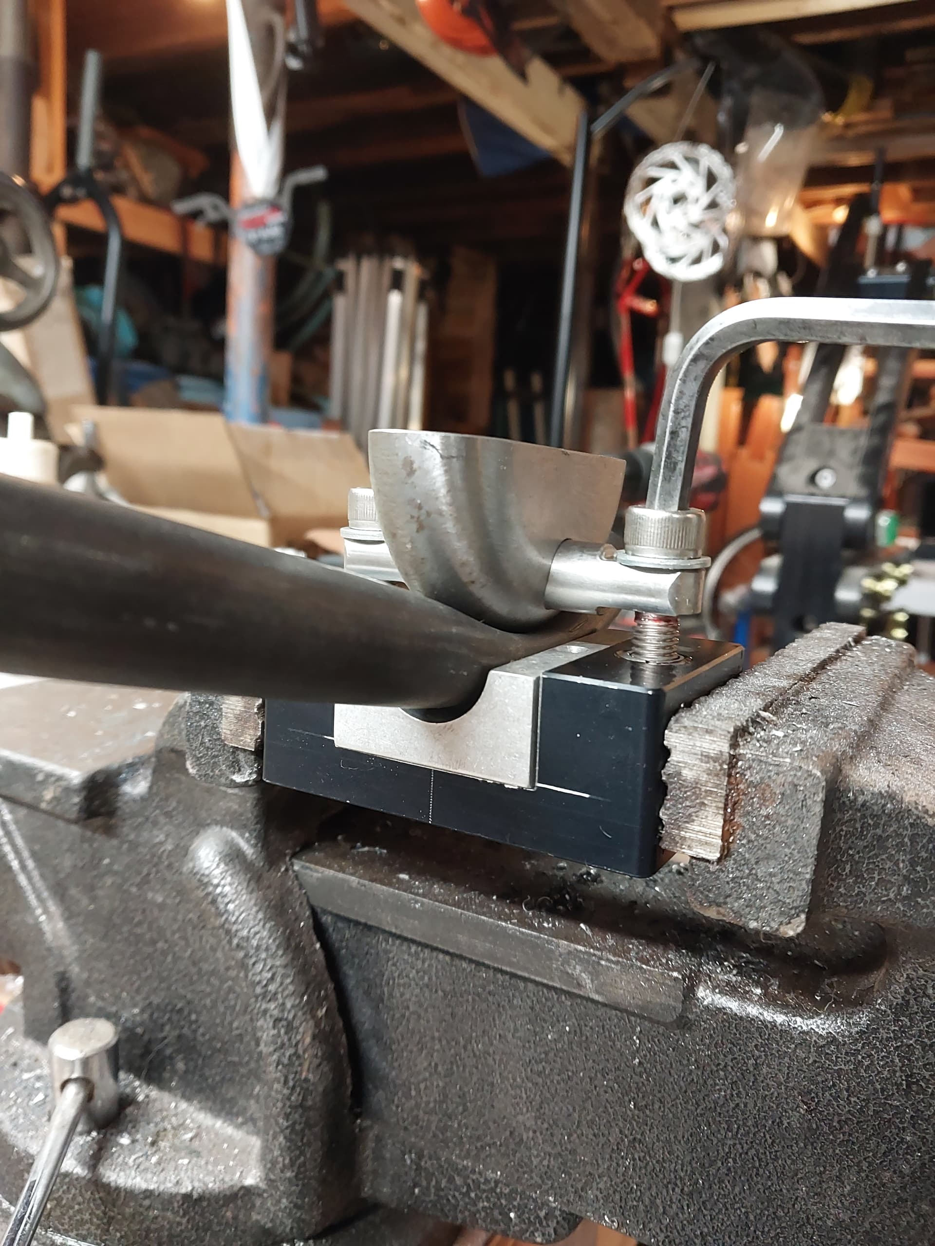

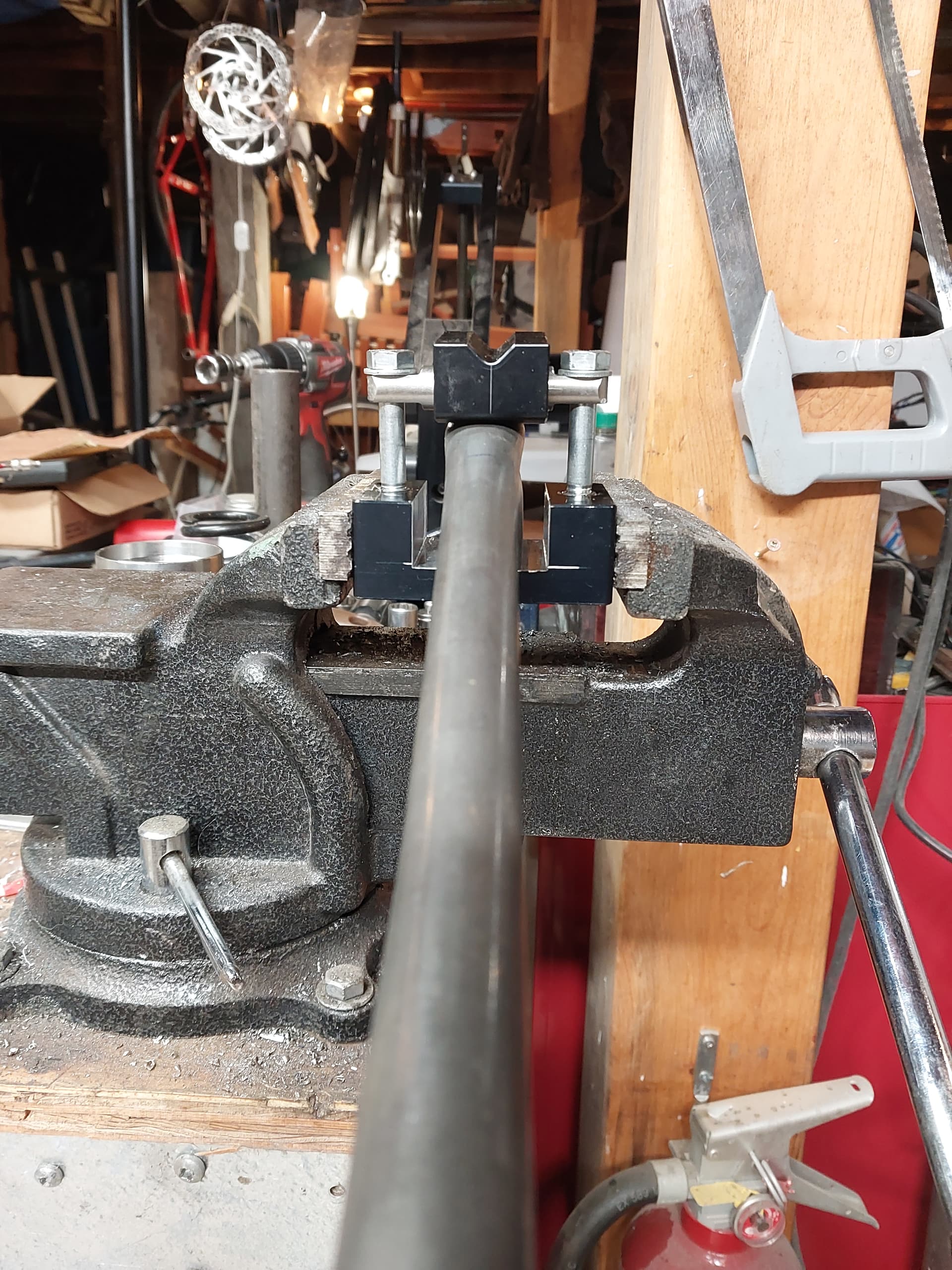

I realized I really never use my miter buddy that much from cobraframebuilding. So I decided to mod it to crush stays. it can still hold tubes also. Sorta.

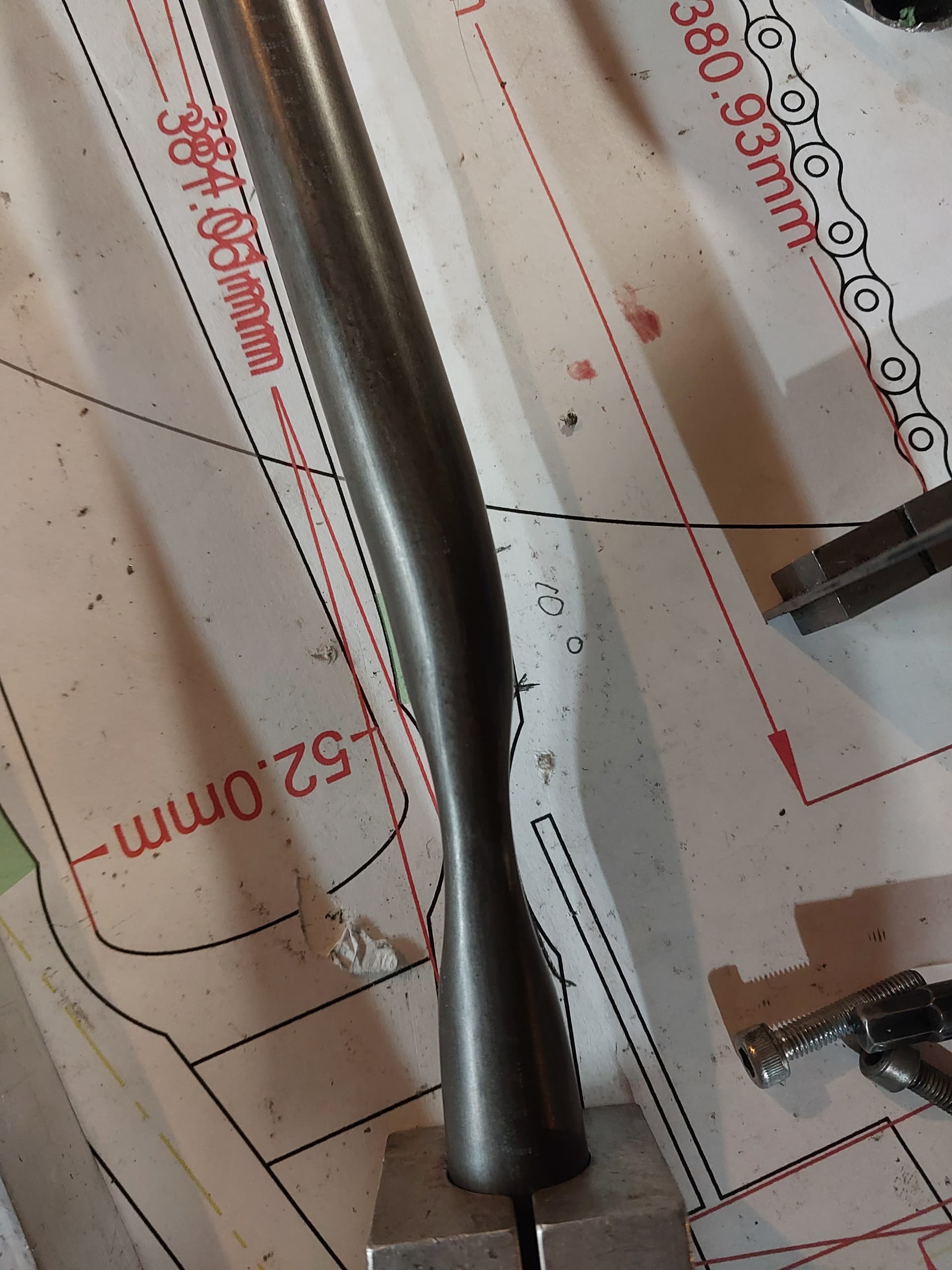

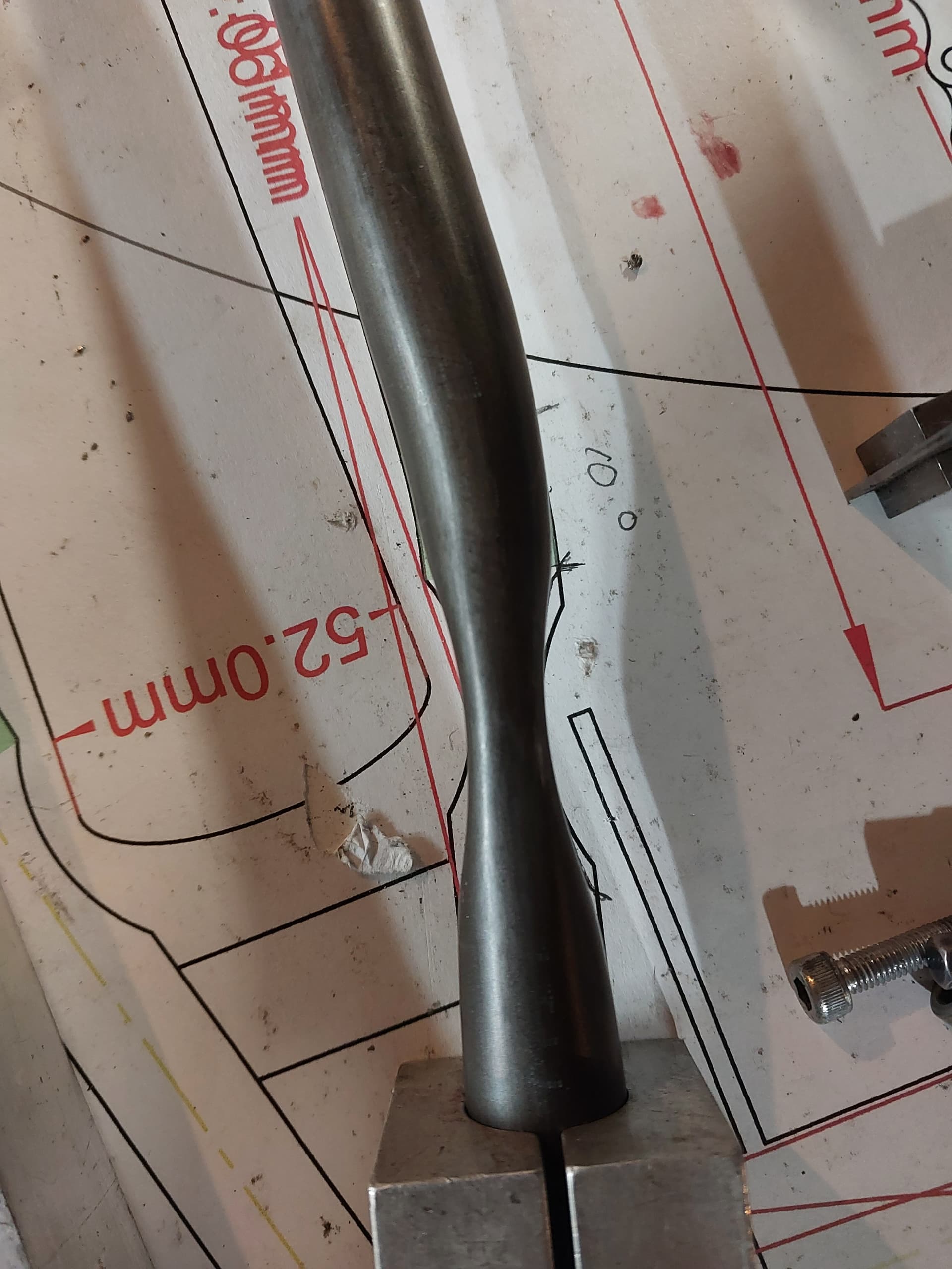

So I dimple 19 and 15 mm stays usually. So I milled out a pocket for the Paragon tube blocks in the miter buddy so I can swap blocks and dies out as needed.. so to dimple to 19 mm stays I use a 22.2 block as a backer support and so it can flair out unencumbered.
I had a steel dimple thing I aquired and modded so it can be used also, as its has a tighter radius.
Any way just sharing ideas maybe cobraframebuilding coud make something a bit more refined… TM. Aplomb Cycles… haha
