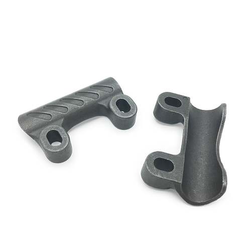

Has anyone used these CS before? I dislike drilling flat mounts and thinking these look good.
Looking for some good feedback.
Thanks a lot.
Brandon
Thanks a lot.
Brandon
I didn’t like the mount and the way the tube was squashed. Its why I use the front mount adapter for the rear.
I saw them when I was at metal guru open house. They seemed really nice but never used them

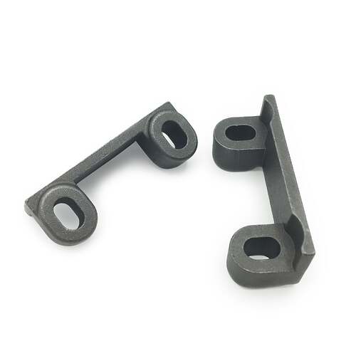

Would something like this be a better solution? I just came across them a few days ago and and not positive on how the brake geometry will lay out but I want to get a set in my hands and find out.
Or
As @DEVLINCC mentioned, front standard on the rear is a solution we are now offering too if you are interested -
Is this only for UDH/T-Type? I’d be going with Syntace.
I just saw the fixture. Please, please, please make one for use with Syntace!
This is intended for our SRAM UDH/T-Type Flat Mount Dropout, but the fixture and brake mounts could be used with Syntace (or almost any other) dropouts. Important: Most dropouts have a 12 mm hole on the left, Syntace has a larger hole. You will need to make a thin bushing to maintain concentricity between the dropout and fixture. If you want to be the Beta tester, we’ll loan you a fixture. Please post pics and return the fixture when you’re done!
I would love to be your beta tester for this.
OK, I’ll start pulling it together.
