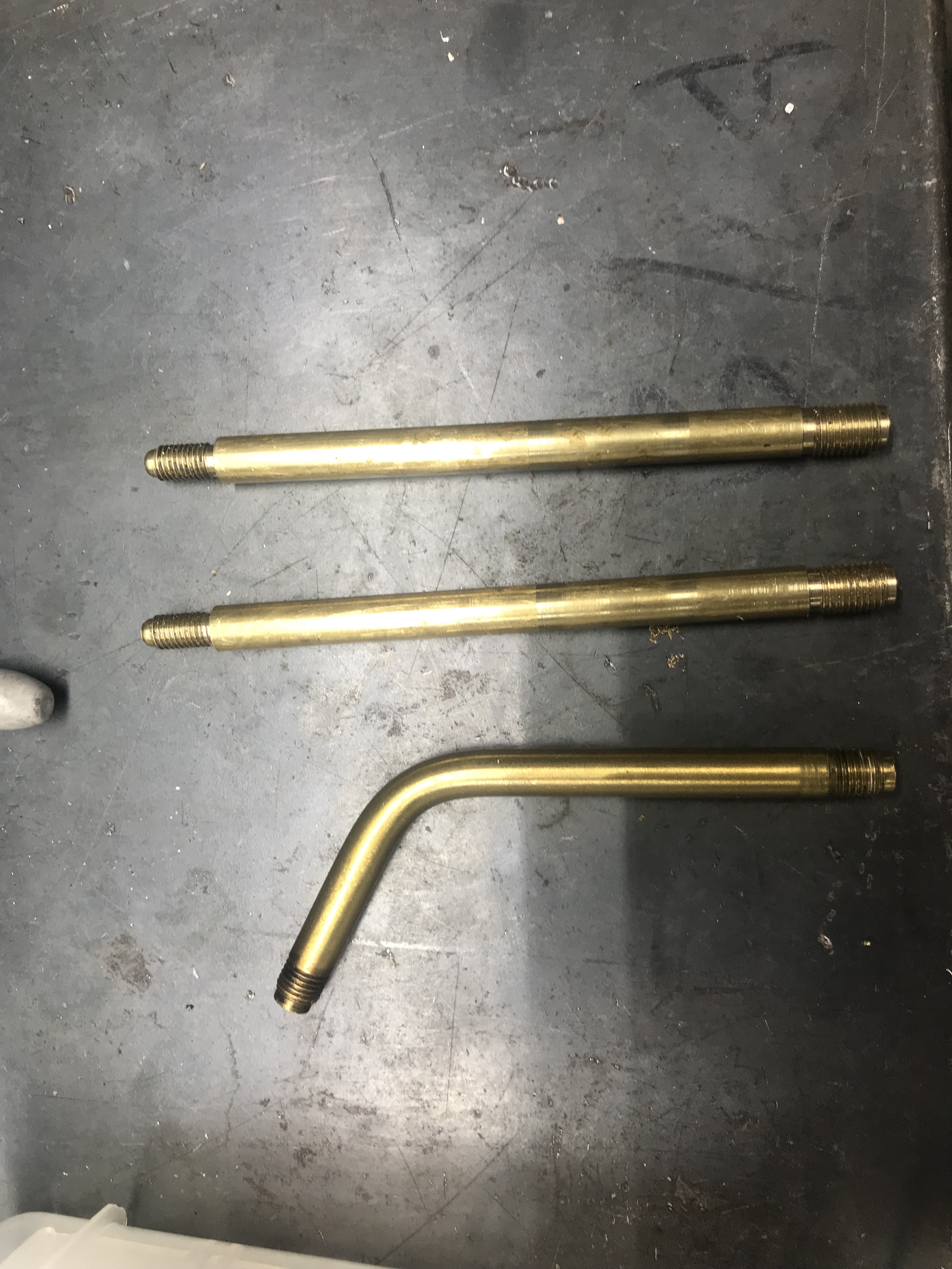

The Carlisle Machine OX series tips are the ones you want. They are still in business. The OX size 3 and 4 are the sizes used the most for fillet brazing and lugs. The problem is they only fit the Meco torch (1/4-28 thread). I made adapters for my Victor J28 UN-J.
The adapters I made in the photo above are shown before being bent, the one on the bottom of the pic is the original adapter neck removed the Victor UN-J adapter.
I have used the Paige, Welder’s Warehouse, Tin Man (identical to the Carlisle OX tips), Victor TE propane tips and the Smith propane tips. The Paige and Carlisle OX series are by far the best. Only the OX are still available from Carlisle Machine. Paige is no longer in business. Recently I replaced a few OX tips because they are fragile/precise so be careful with them!

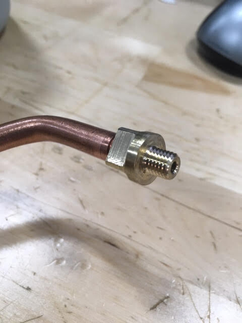

I made a prototype Meco tip adapter back in September. It worked, but some improvements are needed. There was a lot of interest in this over on the Framebuilders’ Google Group – if someone wanted to make a run of these, I’m sure that you’d be able to sell them.
-Jim G

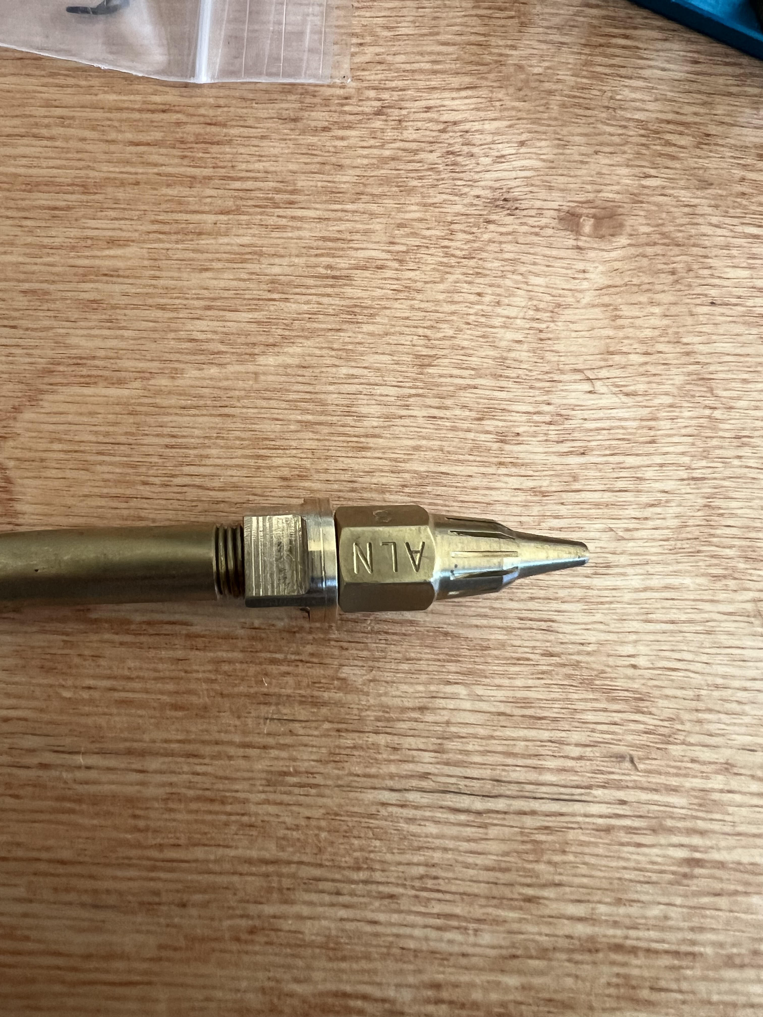

Interesting find:
Someone in the thread pointed out that 1/16 NTP is not the same as 5/16-27 as NTP is tapered. I put some yellow tape on it, and it is working, but you have to be careful not to over-tighten it as the thread in NTP gets wider. It would be great to find a proper adaptor, but I have not been able to so far. Certainly feels like there would be a market for it if someone made some.
Also, H01-6 tips are discussed here extensively, along with all the other options, in case someone is interested. I like them so far, but I am just learning.
