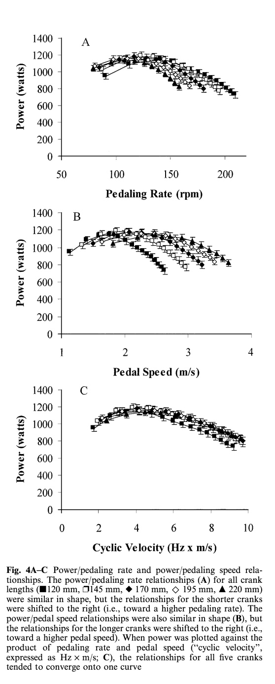

While that logic totally checks out in my head too, I only know what it’s like to be me, and I don’t want to make assumptions. Let’s reverse the scenario: what if the study cohort was average height south-east-asian females (5’1ish)? It’s pretty messed up to say, but I don’t think anyone would cite the paper.
I am not really taking a side in this debate, I just want to add more color and context to this crank-length discussion. I am trying to avoid what media does with research: condensing an entire study into a click bait headline: " Why Shorter Cranks Are Better (According To Science)". This gets consumed by the public and becomes the assumed truth for the next 20 years.
The complete headline should be: Shorter cranks can produce 4% more power for fit 5’10 males spinning at >120RPM for 6.5 to 9 pedal strokes.
How individuals interpret that result applies and apply it to their designs and riding styles is up to them.
When I read this paper, I draw these conclusions:
  • The optimal RPM of shorter cranks is faster
  • The optimal RPM of longer cranks is slower
  • Peak power was achieved with ~168mm cranks and 125RPM
  • The test had a very narrow scope and a very narrow group of subjects
I think that’s a pretty reasonable take and not stubborn just for the sake of being a contrarian.
I had not actually read this study, very interesting read. The authors found that the ‘cyclic velocity’ (product of cadence and pedal speed) produced similar power curves for each crank length. Peak power occurs at an approximate cyclic velocity of 4 for each curve.

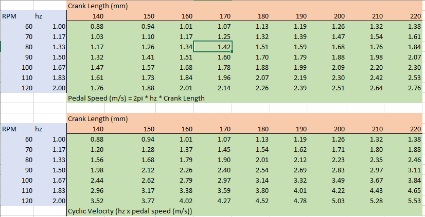

So, making the massive assumption that this narrow study is generalizable to anybody, I threw it into excel and calculated the cyclic velocity for a range of crank length-cadence combinations. The trend is that you’re going to need to spin faster on shorter cranks to get closer to the best cyclic velocity for power production. If something prevents you from spinning fast, like running out of gear on a steep climb, trying to clear rocks, or you just have a natural preference for a lower cadence, then the longer cranks get you closer to that peak power cyclic velocity.

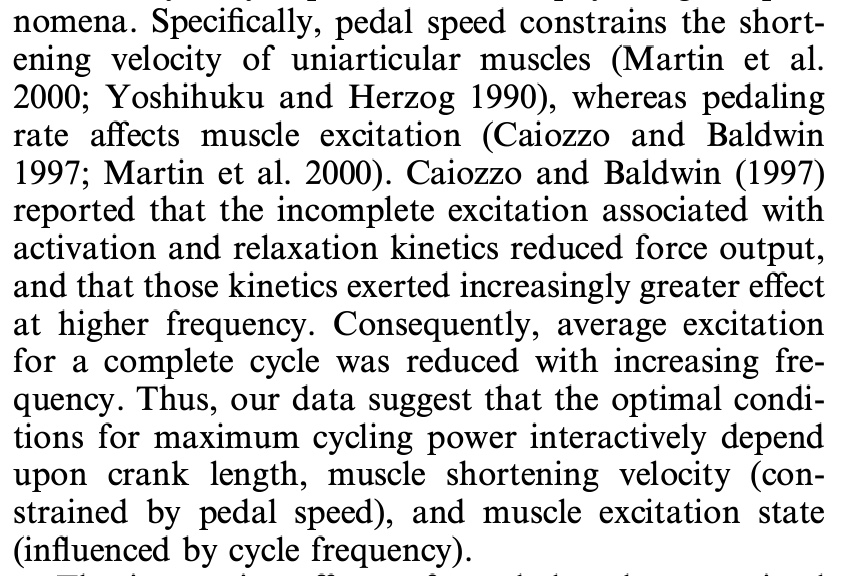

I found this info on the effects of pedal speed and cycle speed on the muscles to be very interesting. With short cranks (proportionally to me) I feel that the muscle shortening velocity is too slow, and muscle excitation state is cycling too frequently. That could be the inefficiency I was trying to explain.
