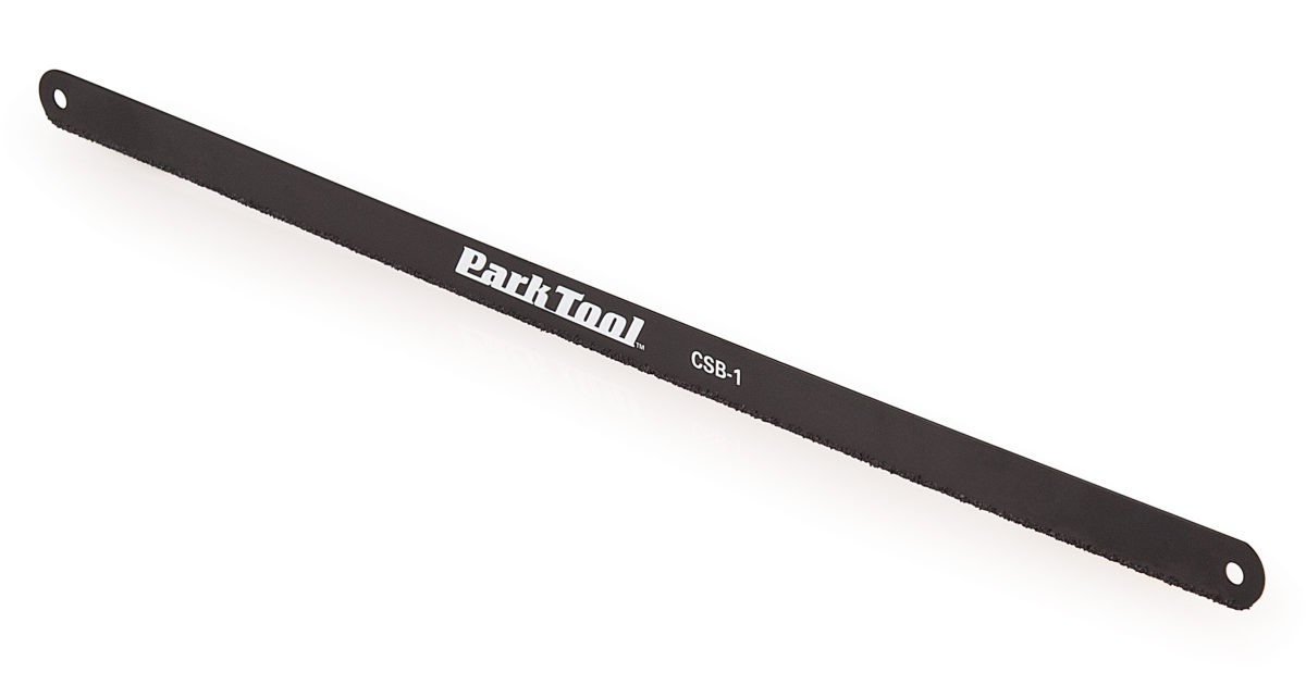

I have plenty of success using the park tool hacksaw blade for carbon fiber with a saw guide:
I’ve used my steerer sawguide for smaller stuff and 3D printed a simple tube block sawguide for nonstandard shape carbon. No splintering, clean cut, perfectly square.

Water jet is probably best, but not really practical for a home builder! Park carbon saw would be my recommendation too - you need to abrade the resin rather than cut the fibres (unlike cutting wood, hence why wood saws have teeth). You might find hole saws for cutting bathroom tiles work well too, but I haven’t tried it.
