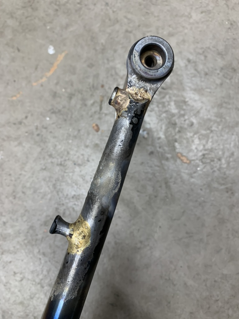

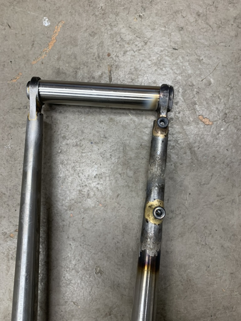

I started with 1/2" bar stock and turned the shaft down much smaller. Don’t remember the size though. Since the tapped hole is for M5, something like an 8mm shaft seems about right.
While brazing the bosses in I added a slug of bronze to the ends so I could file them into a more organic profile.
Not sure why I did it this way but it wasn’t too bad, although someone said it looked like a dinner knife :joy:
I used a 1/8” plate with bottle bosses. I faced the bottle bosses with an end mill post brazing since there’s no adjustment in flatmount (ISO FTW!).

Here’s my first attempt at a flat mount fork using hourglass rack mounts as the brake bosses. I left them proud with minimal threads available on the lower boss to avoid having to drill into the dropout tab. Next iteration I’ll come up with a better looking solution.
