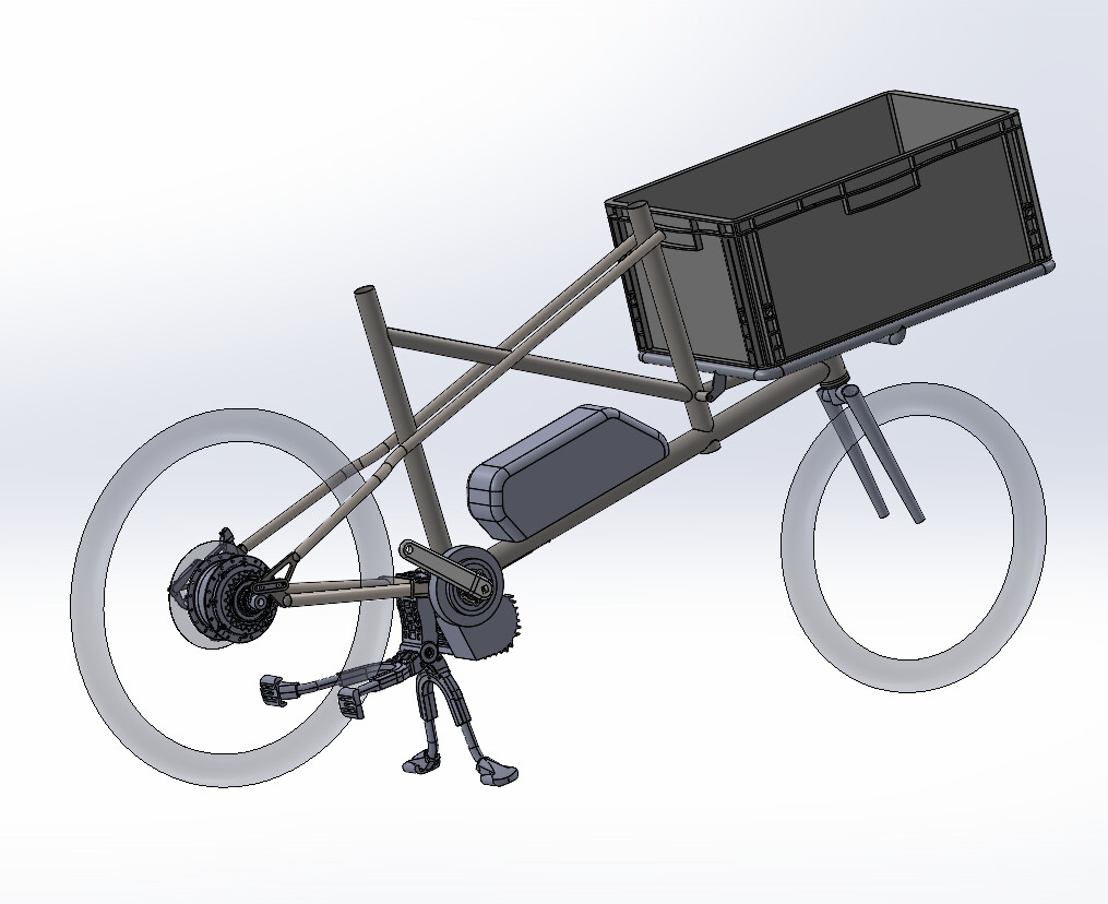

A couple of years ago, I was involved in the prototyping for a small cargo bike from Switzerland, the “monoPole Toolbike” and I really liked the concept: A cargobike that can fit a standard eurobox container but is not longer than a regular 28” bicycle. The general design however is trademarked, and I also didn’t just want to copy it so I had a look at my tubing stock and came up with a version of my own.
20/24” wheels, slightly forward secondary headtube, split TT that continues into the seatstays, a bafang 1kW motor and a 3x3 geared hub that can tolerate up to 250Nm of input torque!

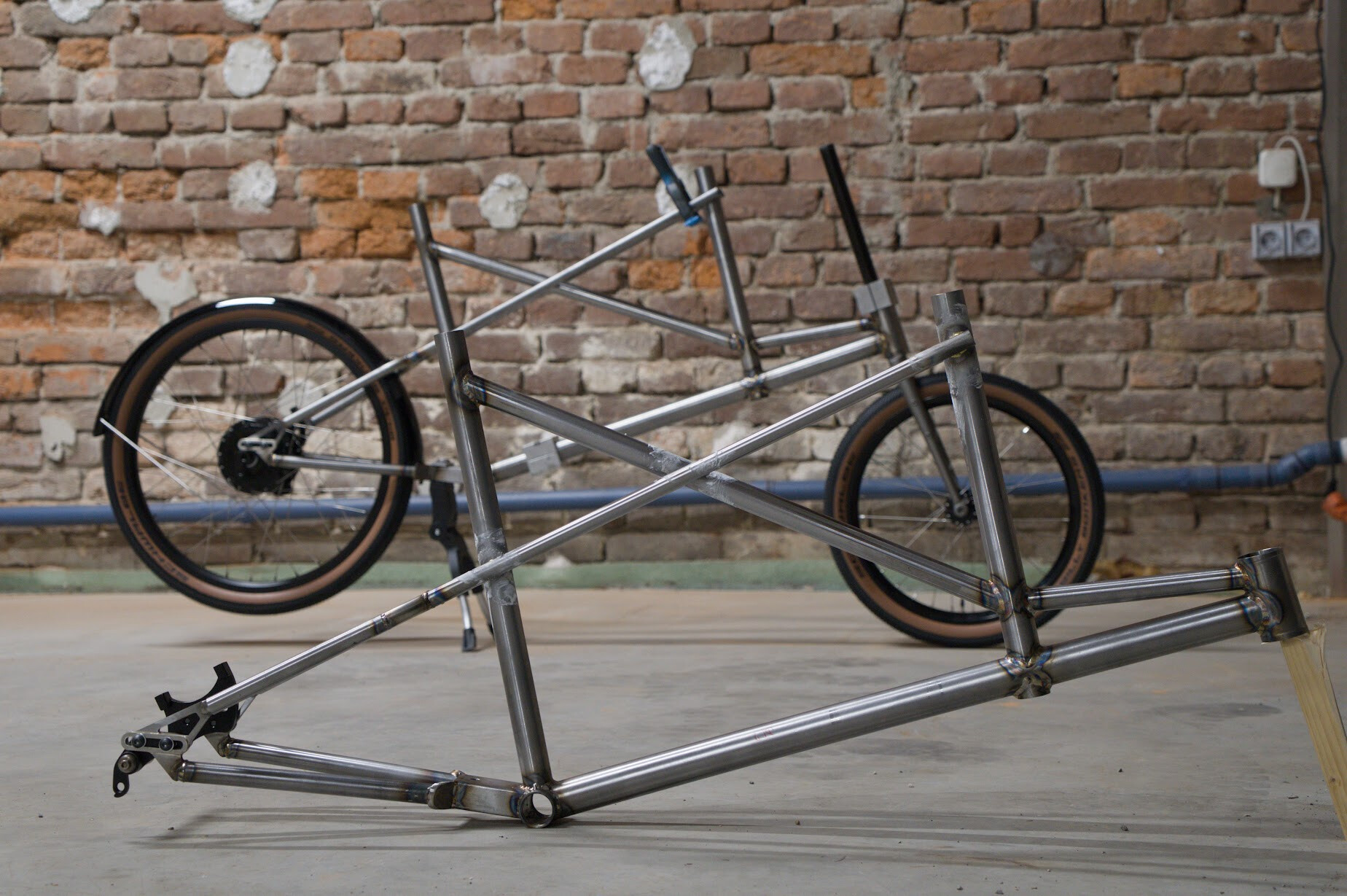

First task was to make an extension to my frame jig to accomodate the extra head tube
Two is almost batch production :wink:

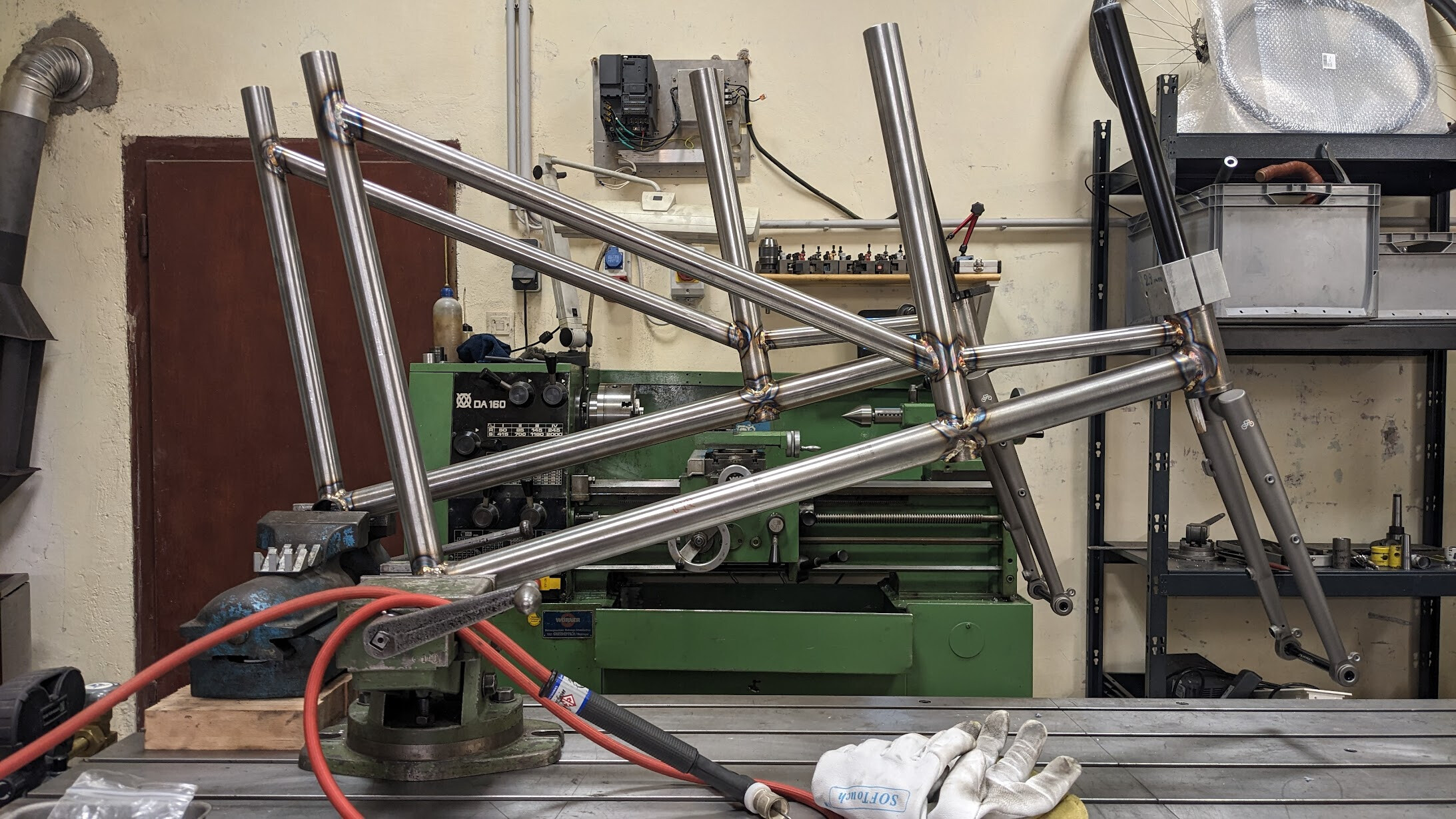

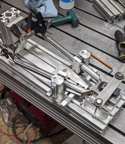

Quite a few mods were needed for the chainstay jig to fit this arrangement:

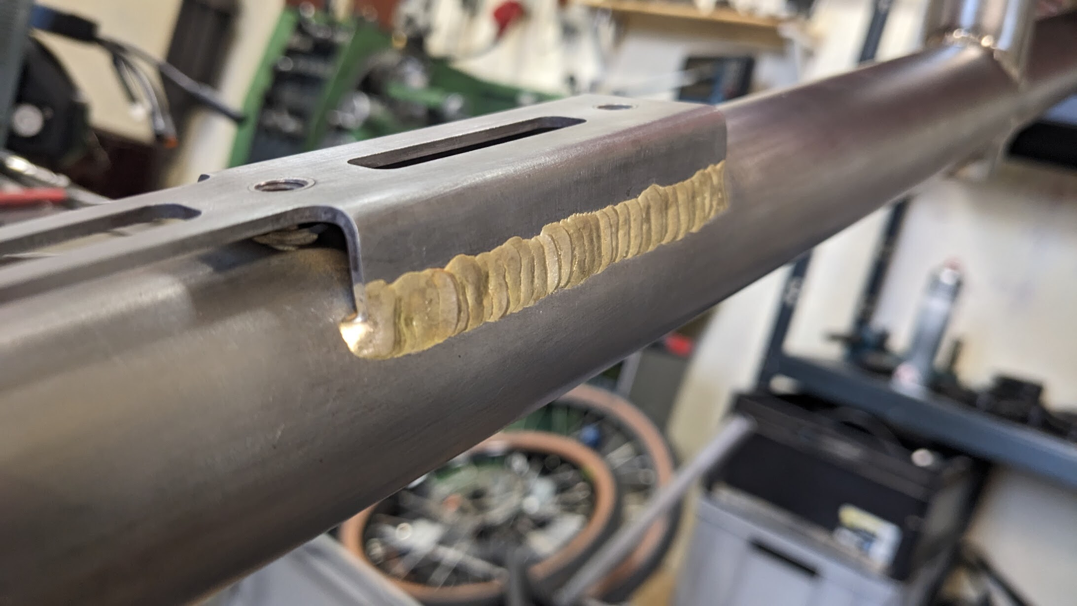

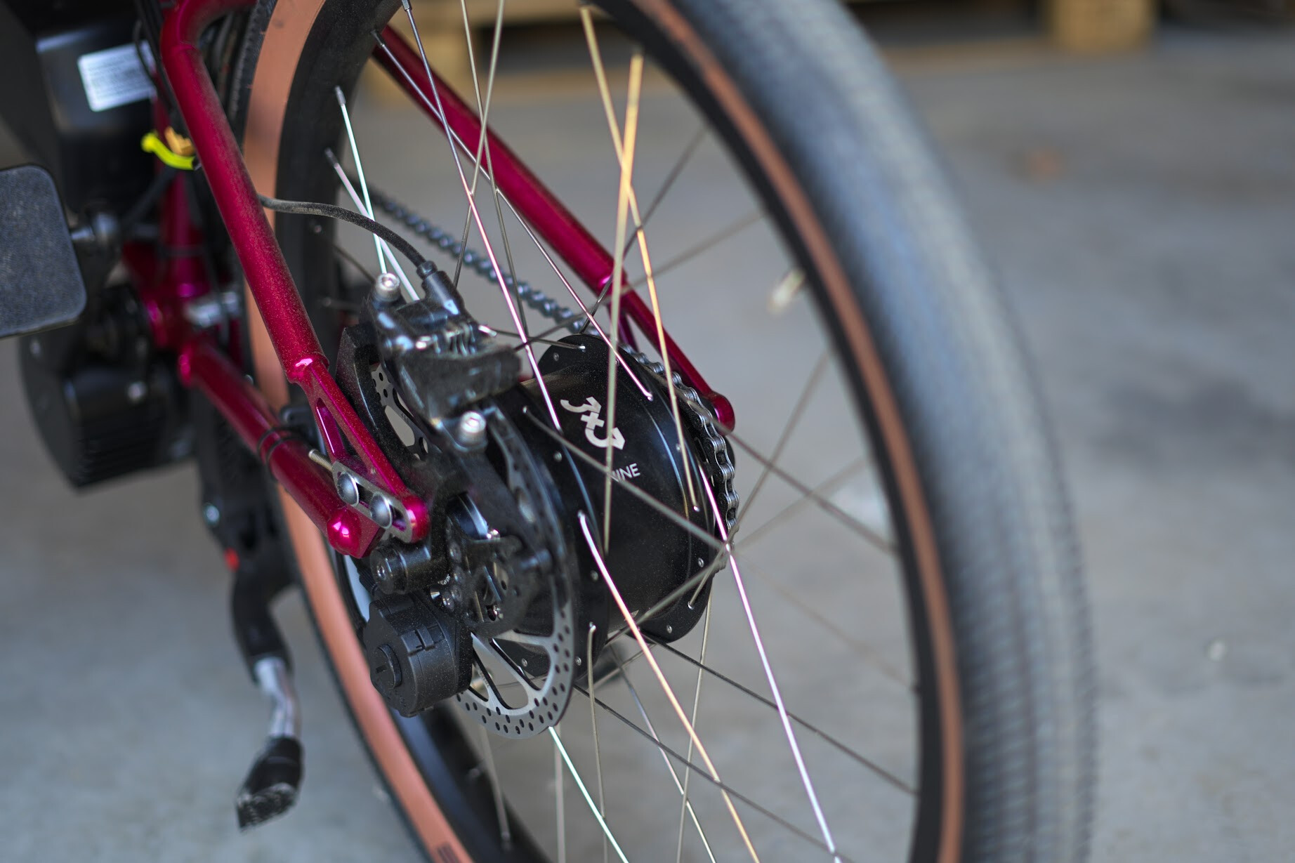

Dropouts are laser cut sliders with brazed on stainless friction surfaces and connect to the stays via stainless bearing balls

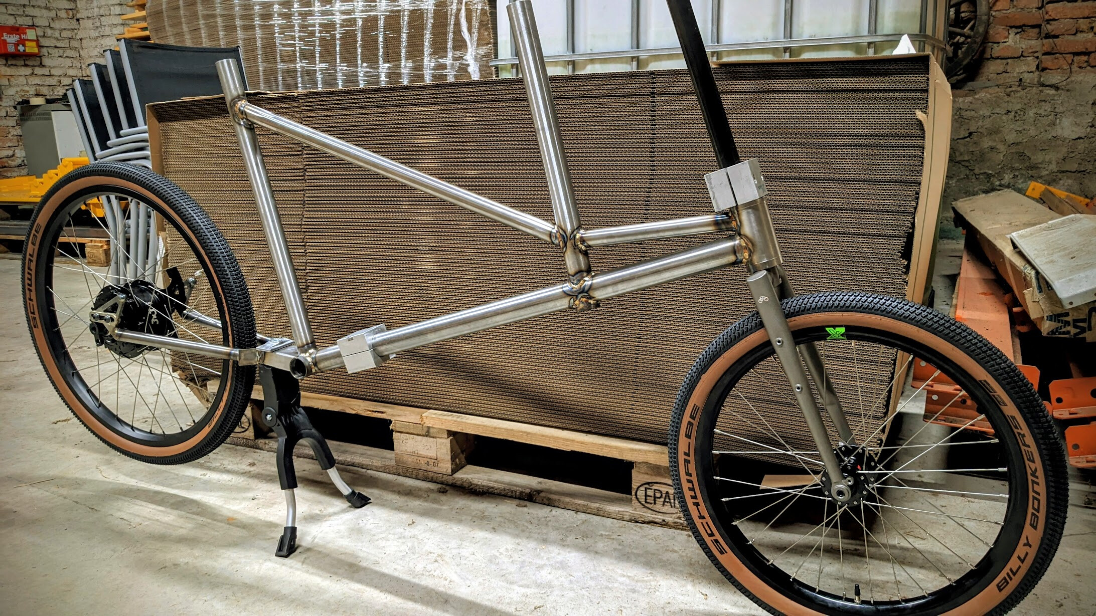

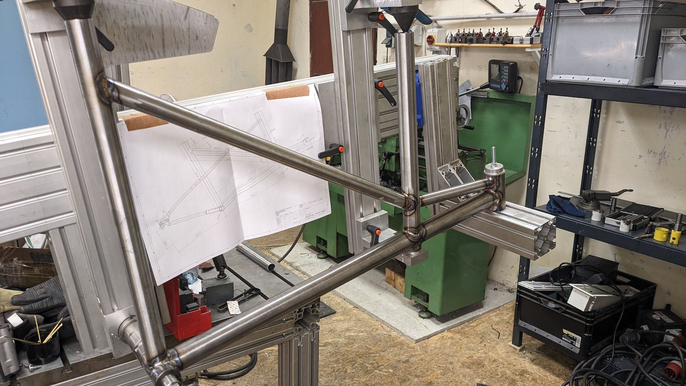

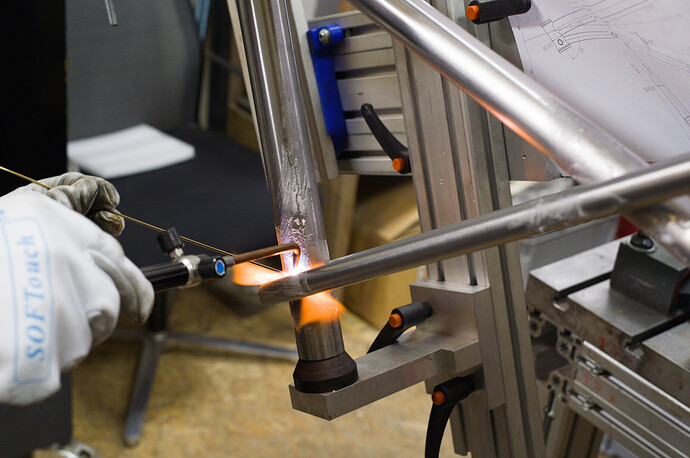

Yay, it’s starting to look like a bike!

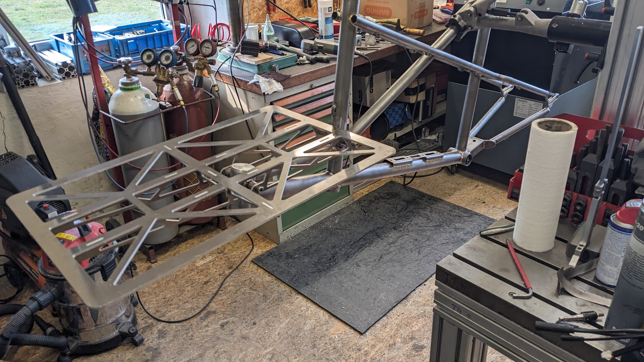

Test fit of the cargo rack went ok, aluminium tig welding not so much (first try went into the scrap directly…)

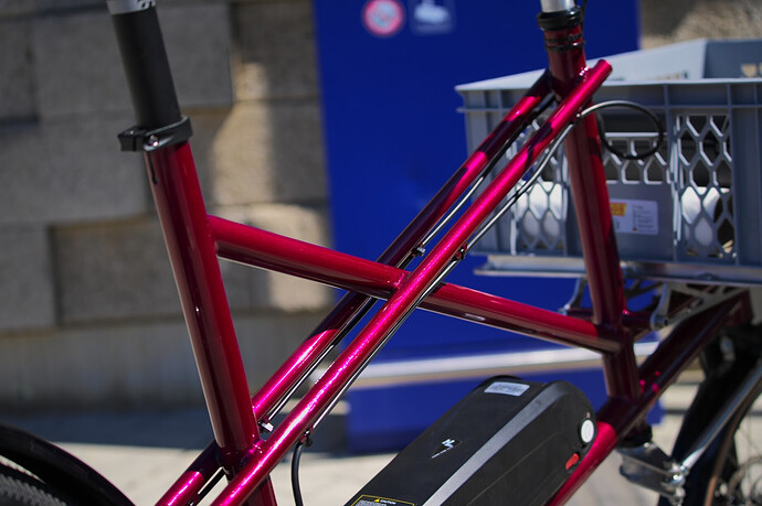

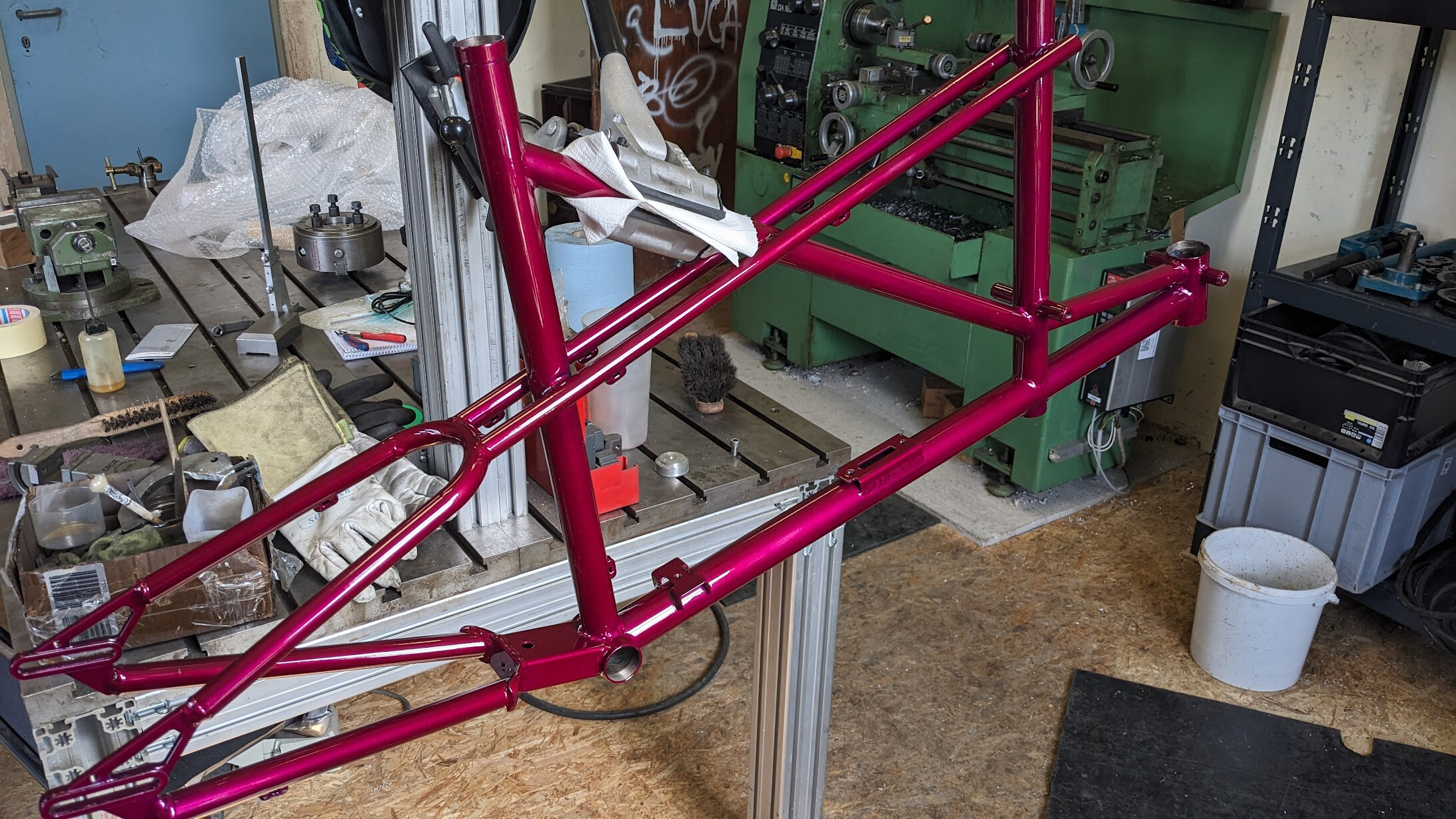

Back from powder coating, I couldn’t be happier with how the color came out!

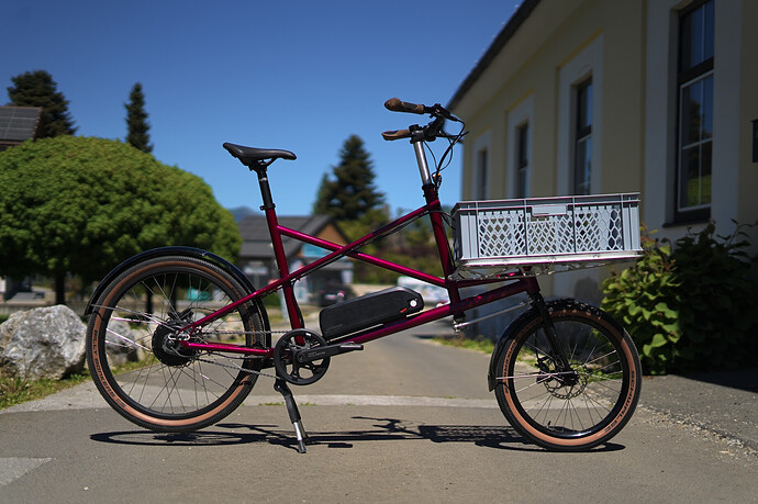

Couldn’t be happier with how it came out! Some little things like cable management are still to be done, and connecting light seems to be quite a lot more involved than on an acoustic bike (I’m not good with electrons…) but overall I’m looking forward to taking part in #carryshitolympics :wink:

Looking so good in that deep red!

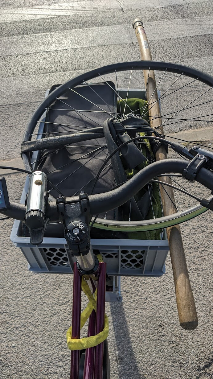

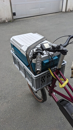

Is the Eurobox fixed to the platform in any way? or does the platform just lock into the base of the box? How’s the power? does it do skids and wheelies?
So rad! Thanks for sharing.
Right now the box is fixed with zip ties. But the cargo rack leaves a lot of room for improvement anyway, so there is a V2 on the horizon. And it would be really handy if one could “click” the box in and out of place easily…
Power is plenty, it can still go 20km/h up a 12% incline without me pedaling :wink:
I have to get familiar with the firmware on the controller, then I can probably make it do skids and wheelies…
So. Cool! Great job on the design. I like the twin top tubes and rectangular tube yoke. The battery mount looks quite robust compared to bottle bosses - great idea.

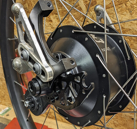

I haven’t seen any 3X3 hubs over here in the US yet (though VPL carries them…) I’ve had a bad experience so far with Alfine 8sp/11sp, but this seems like an interesting alternative, especially for electric builds. Is this your first time using this hub?

Hi Colin, thanks for your kind words!
The battery mount was designed because the idea of mounting a ~6kg lump of lithium to some bottle bosses in a 40x0.9mm tube made me a bit uncomfortable :wink: It makes me feel a bit safer on this death machine (I can make it go almost 60kph if I wanted…)
The 3x3 hub was a good but also expensive choice. Apart from the NuVinci it is probably the only geared hub rated for these kind of input torque figures. It has a torque support that feeds into the brake mount instead of some 10mm wide keyed surface inside a QR dropout (like the Alfine/Nexus and many others) and it can be configured in many axle standards. It is beautifully made and well documented. I was given access to their OEM portal where all the CAD 3D models can be downloaded.
Assembly and setup went smooth, and so far it has worked flawlessly. Can’t give any long term feedback yet though.
