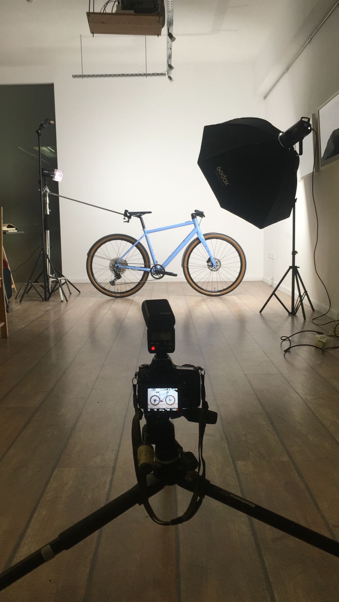

At Reynolds we offer full e-bike solutions including tubes, dropouts and small parts for the MAHLE systems but this is not suitable for MTBs. If anyone here is making other e-bikes, drop us a line… in the image one custom Commuter with MAHLE X20 with DT integrated battery, under 14kg complete.
